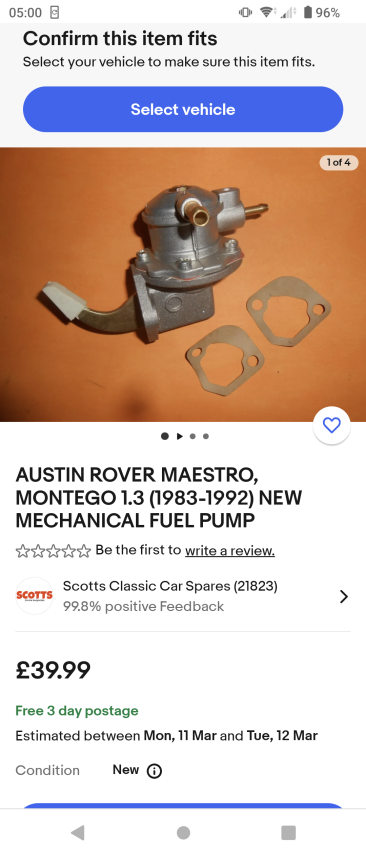

There are plenty on eBay, try this oneOriginally posted by V Newman View Post- fuel pump wanted. Maestro 1.3 Not long passed MOT etc. Found the fuel pump leaking badly today, unsafe to drive. Can't identify the part no yet, but doesn't match anything shown in the Haynes manual. Now have it off the car. It looks as if it can be taken apart, however the manual states it can't. Any suggestions? It's my only everyday car.1958 Ford Consul Convertible. I love this car
Some of them were crimped together & can't be dismantled, if it looks like the one in Jeff's link then it can be dismantled. If the leak is around the area with the 5 screws in it could be the screws loose, if it is coming out of the small hole near the bottom of the casting then the diaphragm has split. The diaphragms are available for some of the 5 screw pumps, but if it is the diaphragm probably easier to get a new pump, then dismantle the old one at leisure.

The Rover parts list (which predates your car a bit, but should still be right) just has two numbers on it for the 1300, AZX 1812, replaced by AZX 1820, so car & van should be interchangeable..interestingly the picture on parts list shows a crimped together pump, but this https://www.ebay.co.uk/itm/176272966934 nos one on ebay is screwed together. Seems like a reasonable price too, may even be the same as your original one?

Various numbers on it. BZX 1093; BZX 1063;BZX 1102; ZX 1820 02 T; AUB5030
