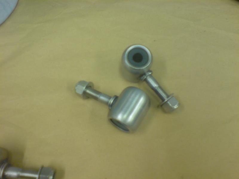

I wonder if another smaller rubber bush will do. Slip this over arb and tight fit into the VW bush. ie 16 or 17mm od with say 12mm id? Rubber to rubber should have better friction and so not slip out?
Brand new!
13mm ID rubber tubing should be a tight fit onto end of arb!? Pretty much a standard size and loads on ebay @ £2.95 per m. This in turn should be a tight fit into VW bush? I'm not ready to try yet, but if anyone else does, let us know.

Wonder if there are any thinner 13mm hosing available, say with 1.5mm walls?

Had another idea. How about using sheet lead strip wrapped round ends of arb to form a tight fit into VW rubber? Once in place, the edge of the lead could be bent up around the back of the VW link to stop it slipping out. If it is tight enough it shouldn't slip out, but the lead could even be stuck to the arb with silicone during wrapping.
