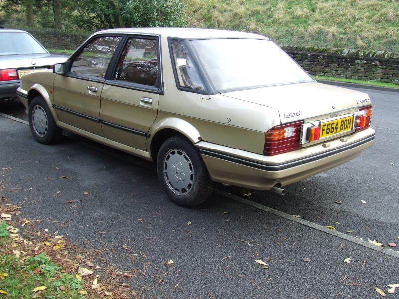

                              well just got back from picking it up and drop it off at mal's barn,i've put £20 as it was very low and drained about 1/2gallon out from the fuel rail so it has clean fresh fuel...took out all the plugs check the plugs they are ok...
                              i put my spare diesel battery on and my bmw with jump leads hooted up ready...
                              check the cap that not so good so changed that with a spare+cleaned the rotor arm...check the spark with all plugs out has great spark...
                              put 2 plugs in so 2 where out and turned the key it tryed to start so i put one more plug in so it had 3 in so turn the key and it started on 3 pots....
                              so i put the 4th plug in and turned the key and it was running on tick over for about 30mins till it got hot and took it for spin down the lane and found it has a flat spot at 4000rpm and die's when i put foot to floor...
                              so will have to see wots wrong with throttle bodie that just may needs a good clean out...
                              but its running and has a blow on the middle of the exhurst some where(will be a quick fix that)
                              here's few more pic's and more on its was soon as the upload has finished as i have a vid done aswell...
                              auto gearbox is brill aswell smooth change..
                              brake's need doing allround and tyre's needed
