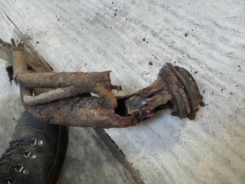

    Hi have removed the fuel filler tube i have 3 pipes that go into 1pipe the top part has rotted away does any one know what should be on the top? Also does any one know where i might be able to get a filler pocket from?
      bloody hell dave thats well rusted.
      i wish you luck getting new filler panel
      they rearer then rocking horse poo

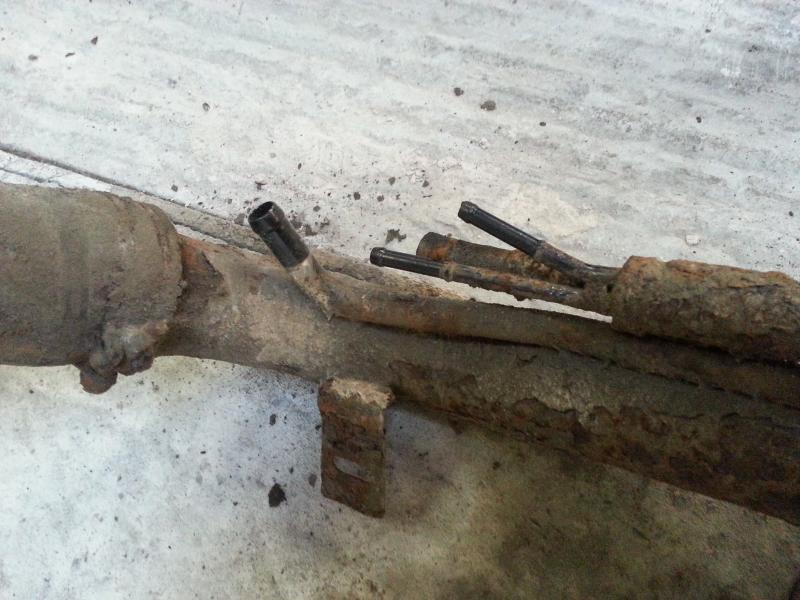

        Tell me about it droping it of to a fabricators next week who hopefully can make a new one really could do with knowing how the 3rd pipe finishes the one the top has completely rusted away on
          Hi does any one know what the tube with 3 pipes going into it does? Could i replace this with a T piece?
            I imagine it is the vent, but my filler only has a single pipe running up the side.
              could the other pipes be breather/return vents for the catalyst converter system as fitted to the later 1.3 cars of 1992/1994 era

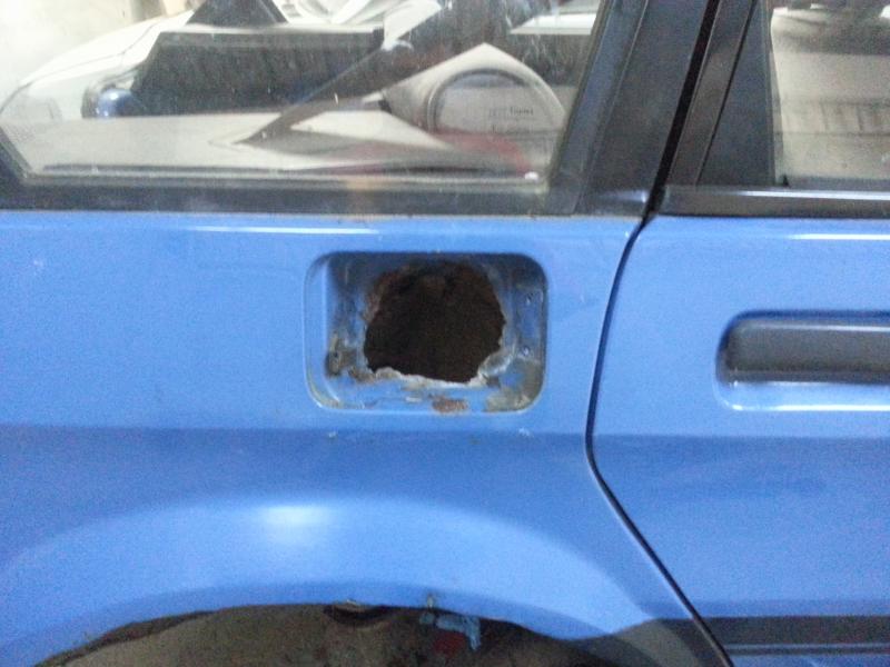

                fuel filler pocket
                the MGM club have a carbon fibre replacement,on their parts list.
                  Could well be. I would guess it might be to do with the carbon cannister under the bonnet too.
                    I will follow them back tomorrow and see only thing i could think is 2 of the pipes go to the top of the tube the other is only at the bottom fuel maybe goes up the 2 tubes drops down then back to the tank possibly but no idea why only ones ive seen have just the 2 normal pipes
                      Bit more research ETV is correct its to do with the carbon canister for venting the tank only mine was well vented lol
                        And as for the fuel filler pocket have managed to locate from northern ireland a complete rear wing
                          That will be the £400 for a pair of wings?
                            Ours is cheaper if it was the one Jeff mentioned abive and in the right country.
                            Rover 200 and 400 Owners Club (for wedge shape rovers, including coupe, tourer and cabriolet). - www.rover200.org.uk
                              I just bought the right one for £200 plus 30 postage
