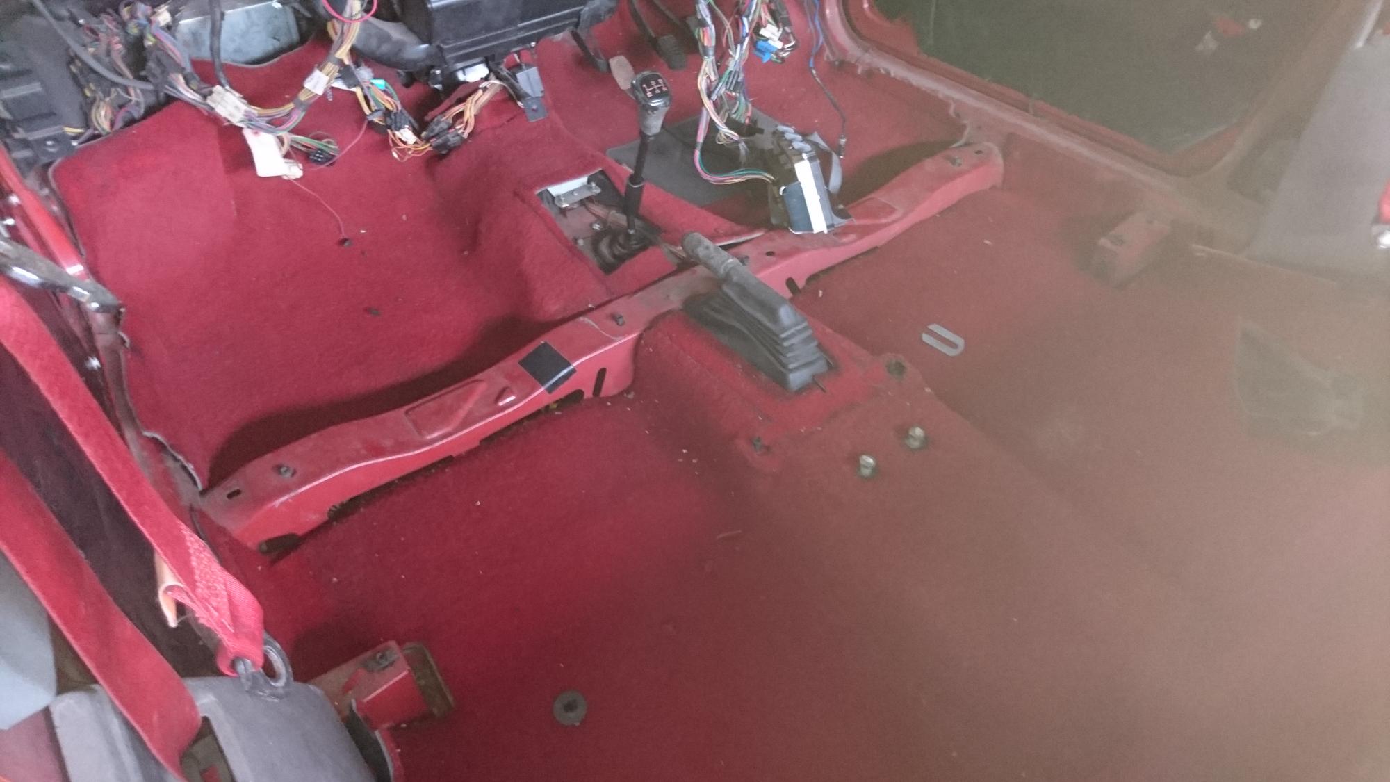

        • Alarm removed, was all over the car and a pain to remove. Display plugged in and all working.
          Before I put the dash in I need to know if the car starts and, nope, no spark so that needs looking at next time.

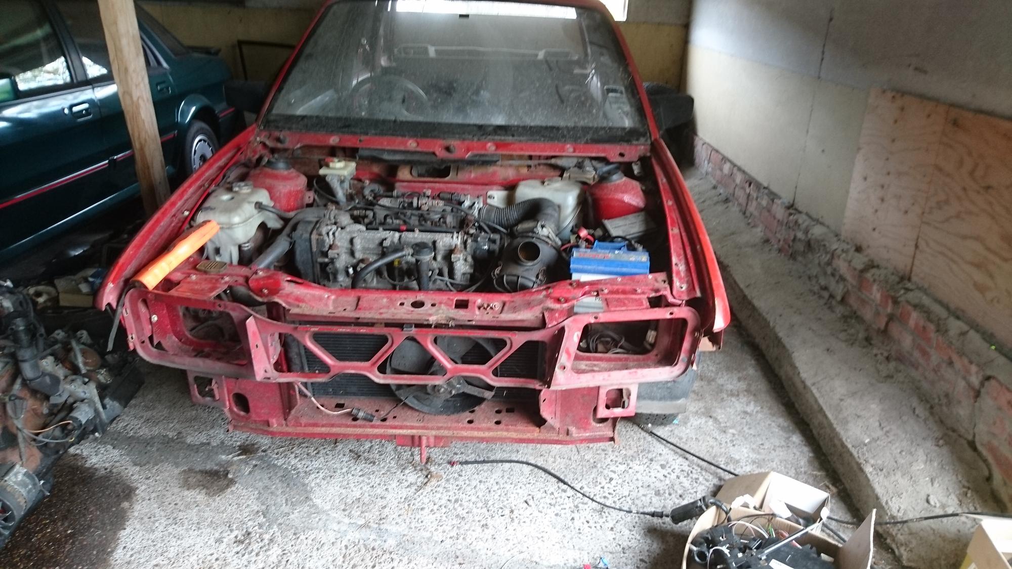

              • Taken the long way round to post these on as it won't post up pictures from my phone. The engine still has no spark, put my fast check on it and all works according to that. As I didn't have my multi meter with me I could check to see it there's any power into an out of the ecu. Have checked rotor arm, distributor cap, coil, swopped another ecu but still no spark. So I continued putting the car back together. The car will also come with my spare early engine and a new cylinder head, exhaust and a few other new parts. Progress is slow as i'm having problems with my arm and don't get enough time to put it together.

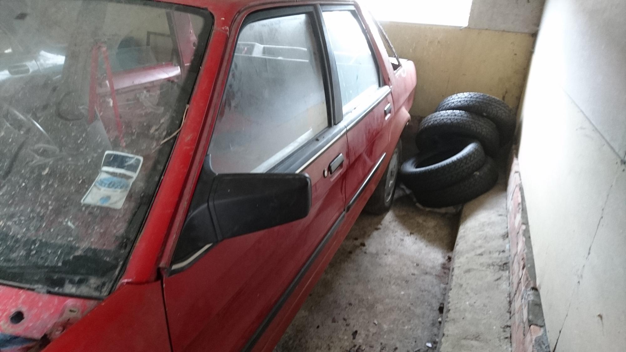

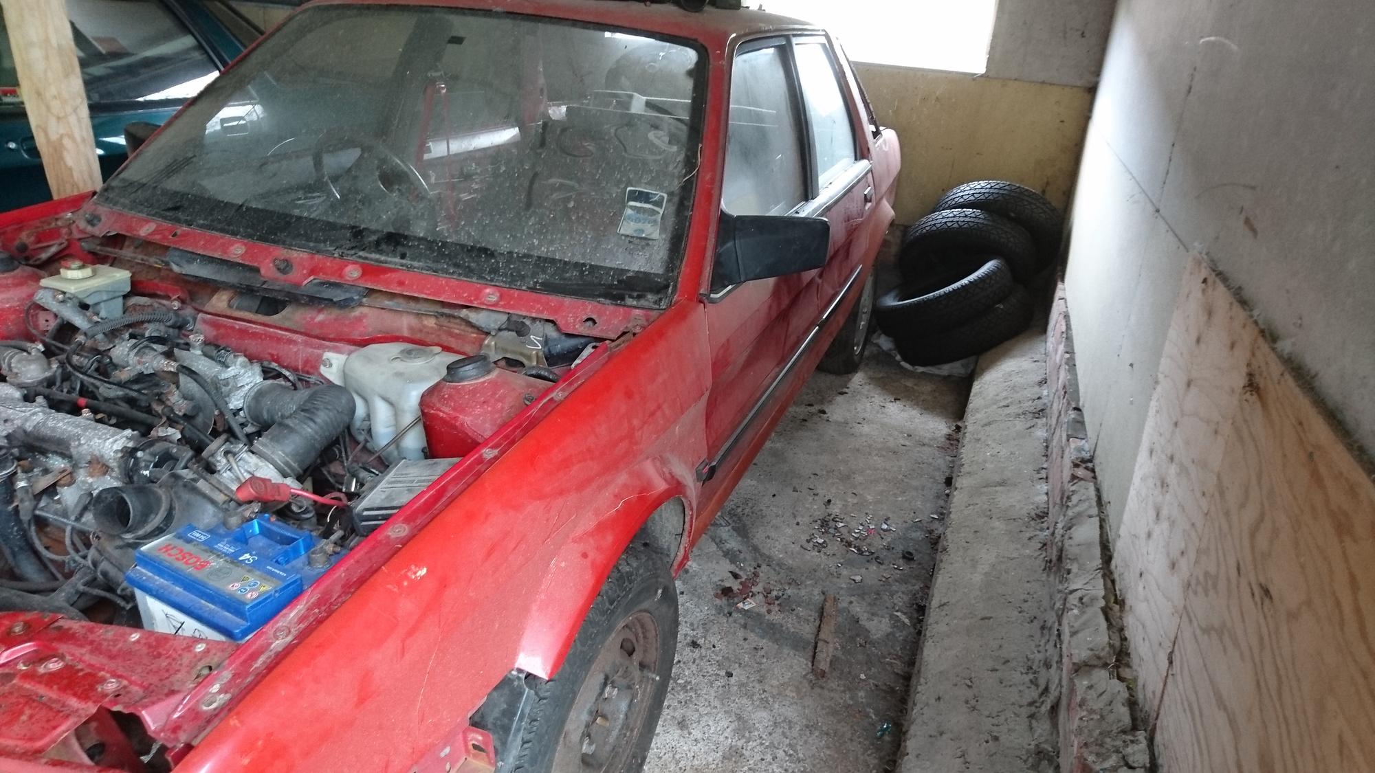

                    • The car will now finally be heading for my garage next month to continue the resto
                      • Finally sorted the non running and ready to come home on sunday
                        • Sorting door cards, lights and more
                          • Problem with not starting. Crack in a coil wire, sized fuel pump, resistor knackered, crack in a wire to a fuel relay, and both fuel relays. after that it started
                            • Came home to my garage sunday.
