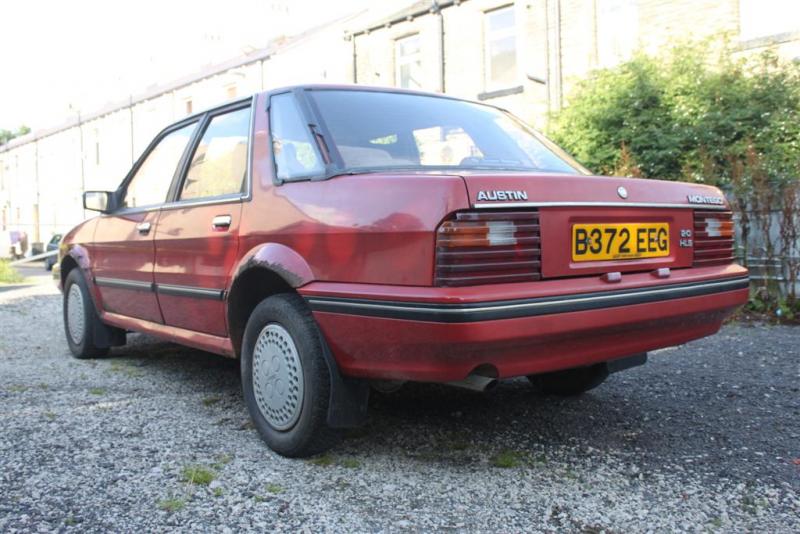

    Here's a couple of pictures to get you going, some more showing its condition in a bit more detail will follow...

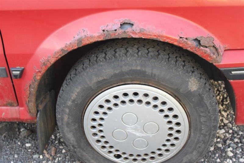

          As promised, a few more pictures in detail.
          I know that the car looks pretty horrid 'as is', but look at it a little closer and it's not all doom and gloom ( I hope!)

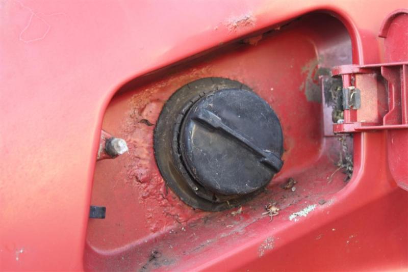

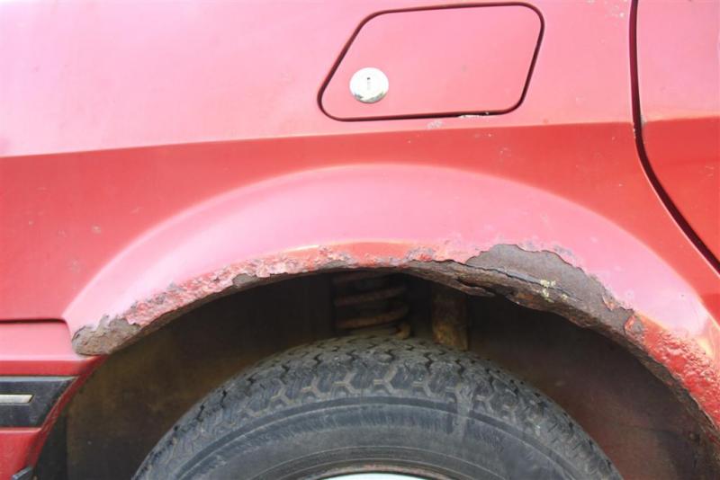

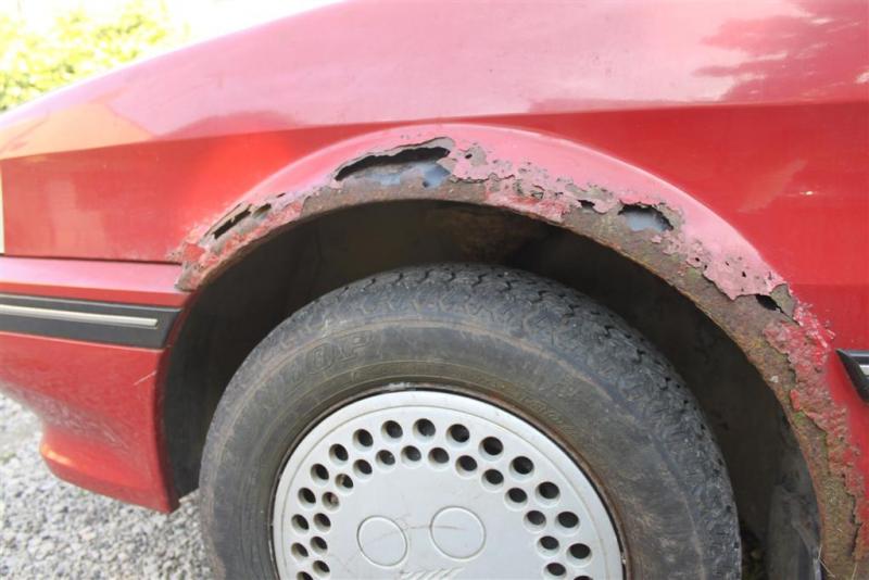

          To start with, the worst parts by far are the rear wheel arches. The offside one being the worst of the two, with rot to the inner arch extending all the way up to the filler pocket. It's bad, but not being a visually critical area, hopefully not too hard to make a sound repair.

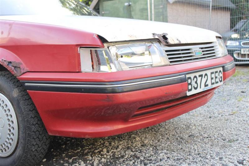

          The next bit that makes you go 'eeeuurgh!' is the front end. Thankfully, though, it's all bolt on stuff. The ventilated front wings will take a one way trip to the skip along with the bonnet. Unfortunately, the only spare wings I have come with side repeater holes...
          Moving on to the doors, n/s/f, n/s/r and o/s/f doors are all rotten. Some more than others, and the o/s/f door may live to fight another day. Frustratingly, the o/s/r door is totally rot free...but some daft sod has taken a flying kick to the top of it!
          Now we move on to what makes this car not as bas as it looks...

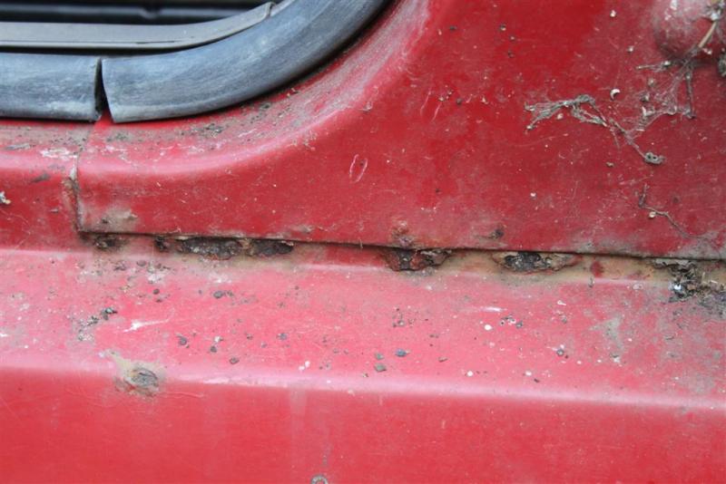

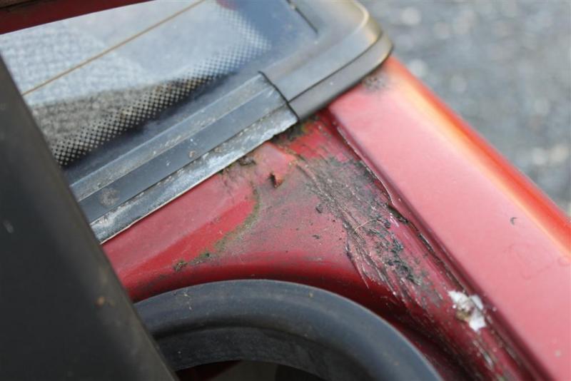

          The seams in the door shuts, barring the one at the bottom of the n/s B pillar (which has a minute amount of bubbling) are all in excellent condition. The rear screen surround, apart from a couple of scabs above the rear screen (they all do that, sir) is rot free. Around the boot aperture is similarly rot free. Also, the boot floor and wheel well. The suspension turrets...same again!. So far so good...

                    I've never seen a Maestro or Montego with front wings so rusty before.
                    A bodyshop could easily plate the indicator-holes on your late-style wings. I'm hazarding a guess that they'll be the wrong colour so you'd have to respray them anyhow, so the bodyshop could plate them at the same time.

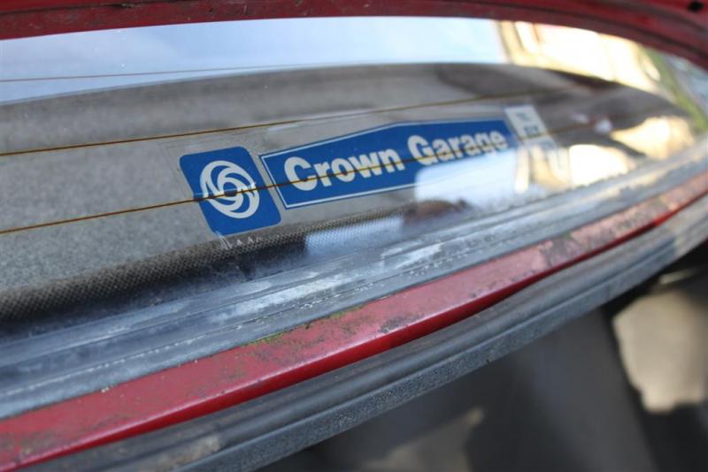

                    EDIT: Loving the BL 'flying plughole' dealer sticker from Crown Garage. That would even have been old and outdated when it was fitted!
