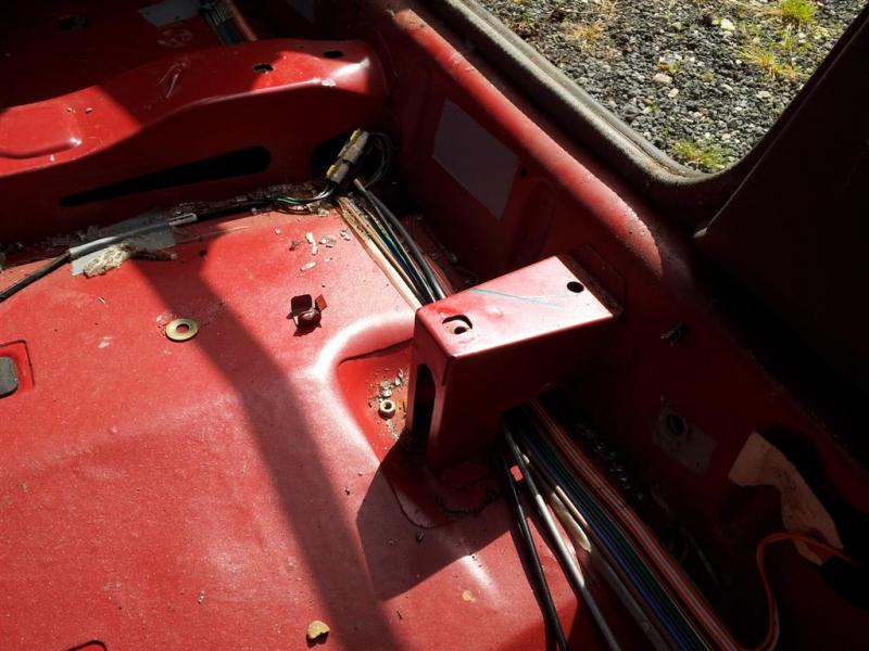

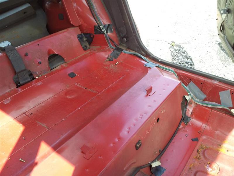

                It's been a couple of weeks since I last got to work on the HLS, but when I was last there I managed to strip out completely the rest of the interior, which allowed me to asses the condition of the car more closely.
                One thing I forgot to mention last time is that this car came with its very own colony of ants! They'd made a home inside the inner arch on the driver's side (and are quite good at defending themselves as one poor sod who got his hands bitten found out!) Since their arch-nest was disturbed, the day I went to strip the interior out, I found them in the process of moving into rear foot well under the carpet - larvae and all! Marching orders were given and hopefully when I next go back they will have taken the hint and moved out completely.

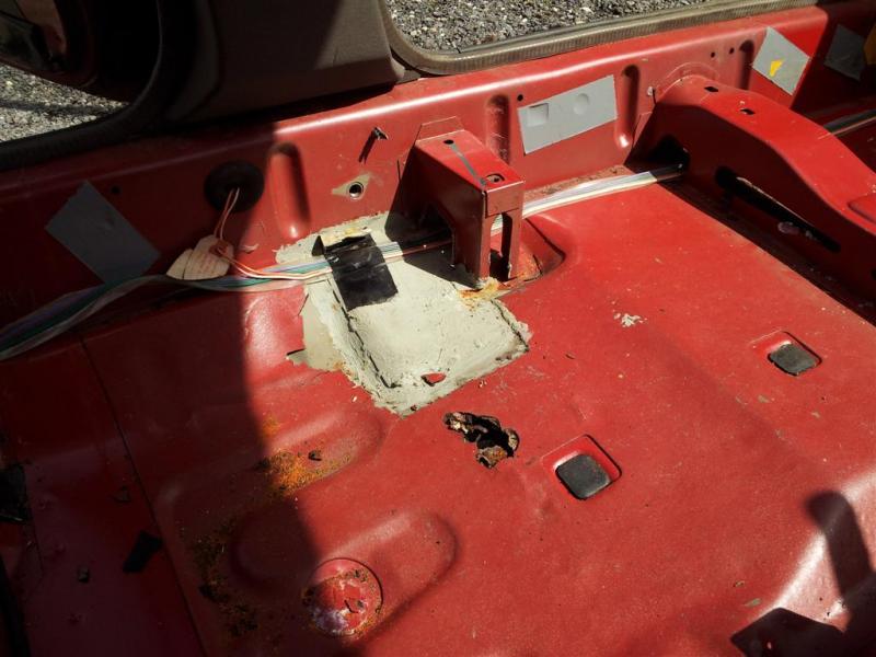

                Anyway...overall the news is positive. There's been some welding to the area at the bottom of the B pillar on the passenger side, and close by is a random hole that should be easy enough to sort. The rest of the floor pan is fine, and just needs a bit of a clean and tidy for when the interior goes back.

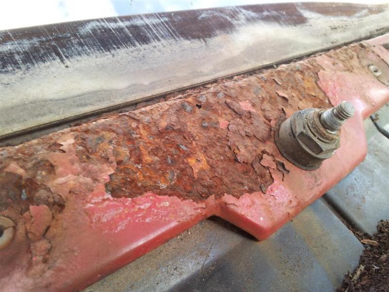

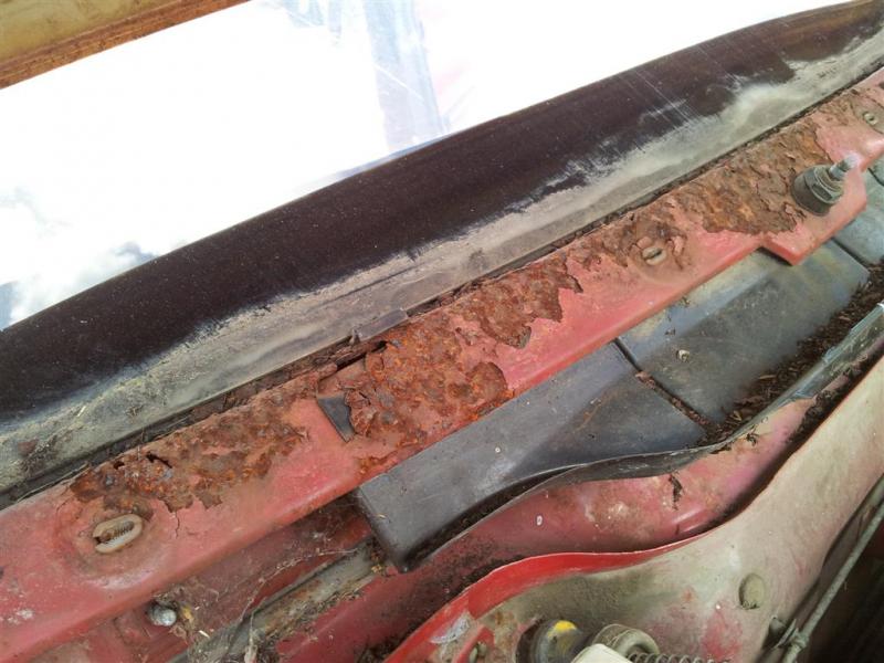

                Once I'd sorted the interior, I thought I'd check under the wiper scuttle panel to check the metalwork underneath. It's not pretty to look at and the screen is going to have to come out to sort it. Ideally I could do with sourcing the lower part of the screen frame from another Montego to have welded in. I figure though, that it can't quite be as bad as it looks as even though the car has been uncovered and exposed to the elements, the carpets inside were dry.
