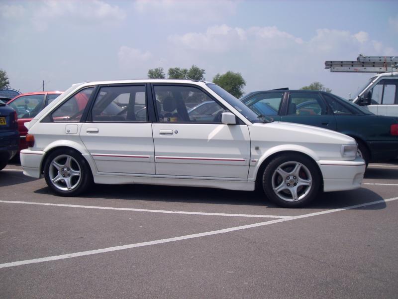

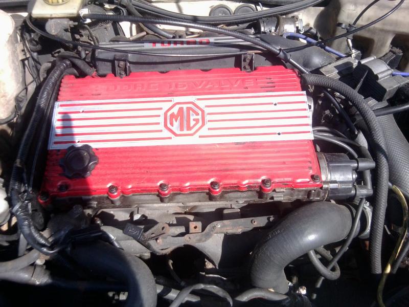

      hi charliecosworth
      here is my white t16 turbo, although not this clean now but working to get it on the road again
      kevin

          MG Maestro turbo 437
