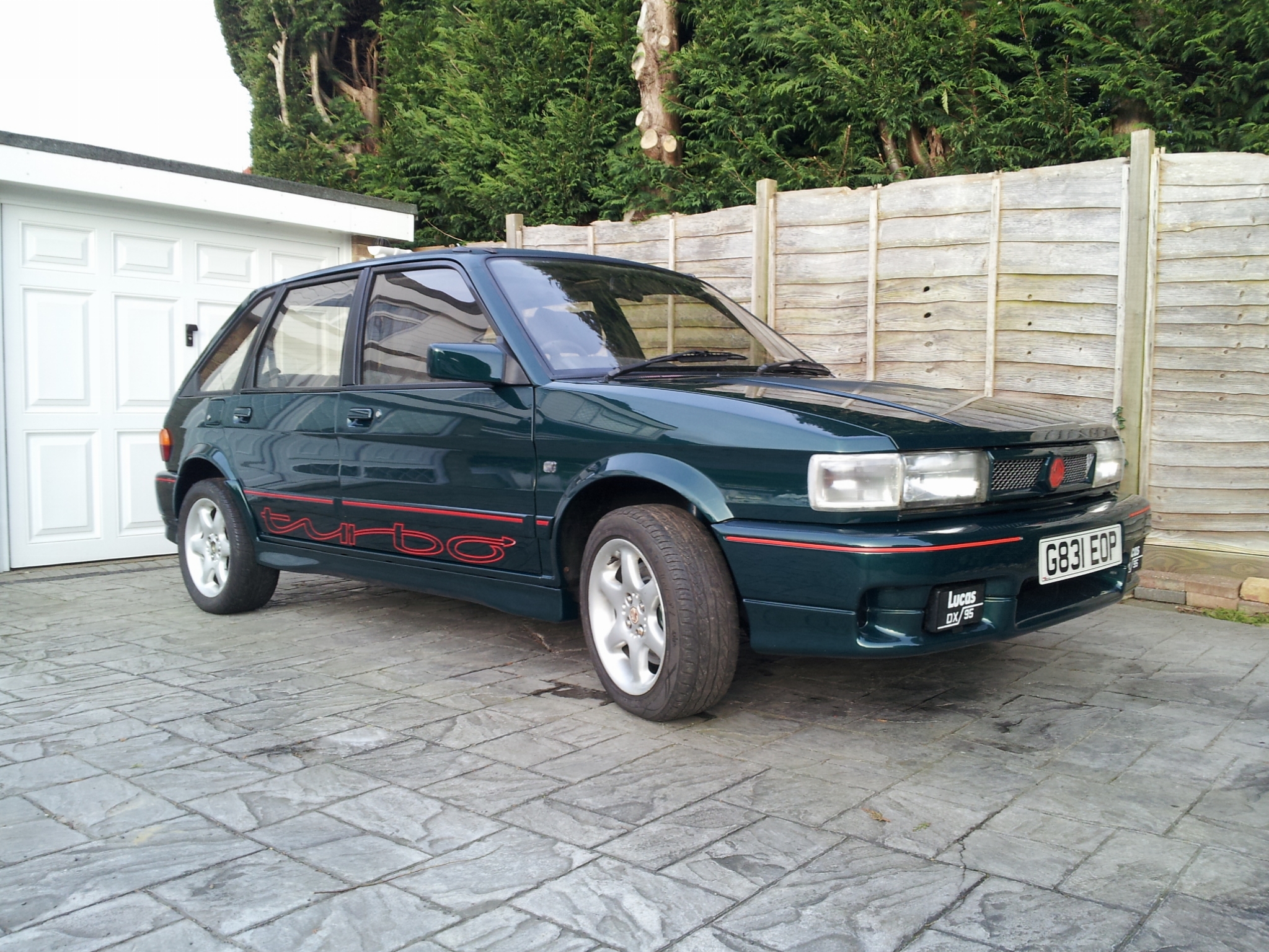

                              Well it made it to the NEC as a (visually) finished car. The problem with overfuelling and failing to get the engine started, compounded by a leaking brake caliper, meant that it was a non-runner at the show. For those who didn't make it to the show this is how the car looks today: Click image for larger version
