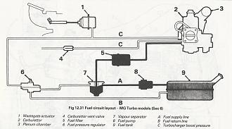

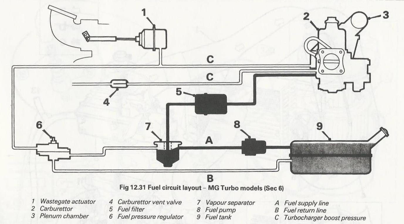

    As I'm still suffering with fuelling issues, I posted on the Maestro Turbo FB page looking for some help and guidance. Lee and Dan came back with some suggestions, but what I'm really struggling with is an understanding of how the Turbo fuel system works. Using the diagram below, taken from a Haynes manual, I can see that the fuel is pumped directly from the tank to one side of the vapour separator. Once that fills the fuel is sent to the float chamber through the top outlet. Once that fills, any excess fuel is returned to the tank via the third vapour separator outlet and the pressure regulator to the spill return pipe and the fuel tank. However once the turbo starts to apply boost pressure, this is seen on the pipe from the plenum chamber and applies the pressure to the top of the diaphragm in the pressure regulator, which in turn is applying pressure on the line into the vapour seperator that the fuel normally returns along. Now there is an increae in pressure to force the fuel into the float chamber and limit the fuel being returned to the tank. Am I correct in that description so far?
    Thats then brings me to me problem with the mixture going excessively lean as soon as the turbo starts to apply boost. Could it be that the fuel pump is just not good enough to overcome the boost pressure, so I end up in just sending a dribble of petrol and boosted air to the float chamber? As far as I am aware the tank is good, and there are no problems with the gauze or swirl pot, the pressure regulator is brand new as is the carb balance pipe, the pump is Ok and pumps at a reasonable rate (when using it to drain the tank), the vent valve is working when igntion is switched on and off, although I will test with the valve being replaced by a bolt. With the vapour separator being non-serviceable, should I look to change it, even though it looks OK, in case something is wrong internally? Other than these, I'm at a loss to understand why it only goes lean with the turbo on boost. The car drives fine as long as I don't exceed 2000-2500 rpm, and if I do, then letting the engine return to idle speed for a few seconds, brings everything back to running fine. The mixture is about 4%CO at idle at the moment.

                      You might have already realised but the diagram is incorrect. The fuel pressure regulator has 4 connections not 3 as in the diagram & the vapour separator is not supplied directly by the pump it is fed regulated fuel pressure from the pressure regulator.

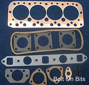

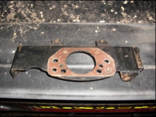

                      It is the plenum chamber to carb gaskets that are turbo specific, the turbo type gasket has extra holes as the float chamber needs to see air pressure from the turbo. See images The first image shows a set of A series gaskets but you can see it has the N/A carb elbow gasket.Note the extra holes on the plenum gasket in 2nd image.

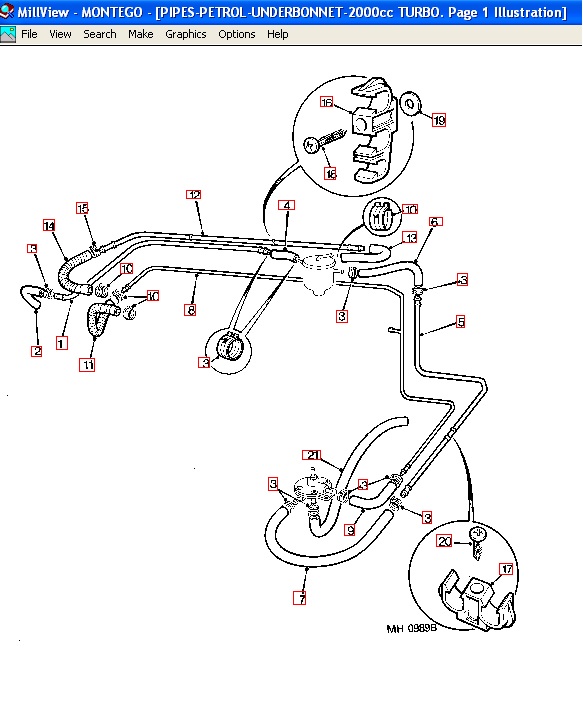

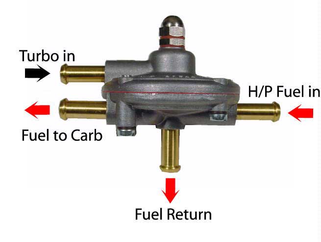

                        Thanks Gary. When I first read your post, I thought you may have spotted my problem. BUT, I think you may be confusing the set up for the Mini and Metro Turbo set up, that uses an FPR012 regulator with the four connections. The regulator for the Maestro/Montego Turbo is an FPR013/ADU9217. This has just three outlets. I was also a bit nonplussed that AR would have misprinted the diagram in their official workshop manual for the Maestro and that it would be then copied by Haynes for their Montego manual. Just for the record I have attached a screen grab from the EPC for the fuel pipework for the Turbo setup. There you can see that the pipes do relate to the diagram and, I hasten to add, to what I've got under my bonnet!
                        To clarify Pipe 1 is fuel feed to vapour separator; Pipe 5 is vapour separator to regulator; Pipe 8 is regulator to plenum chamber; Pipe 12 is vapour seperator to carb and Pipe 21 is regulator to spill return
                        Having written all that, the Mini/Metro system does look simpler in that turbo pressue is being applied directly to the fuel supply and its that I was scratching my head a bit with, as the Maestro uses turbo pressure indirectly, via a pipe that seems to have two roles, pressuring fuel in the vapour separator and returning unused fuel to the tank.

                          Diagram looks right to me...the regulators I've seen are just normal 2 port, like an ordinary hydraulic system, with a third port over the diaphragm ie on the spring side) connected to manifold pressure, thus increasing fuel pressure on boost. The entire fuel system should be maintained at manifold pressure +4psi, apart from the return pipe from rgulator to tank, which should be at zero or thereabouts

                              I'm glad I wasn't too far wrong with the turbo specific carb gaskets. (well plenum to carb - near enough!). Worth checking you have the right number of holes in yours.
