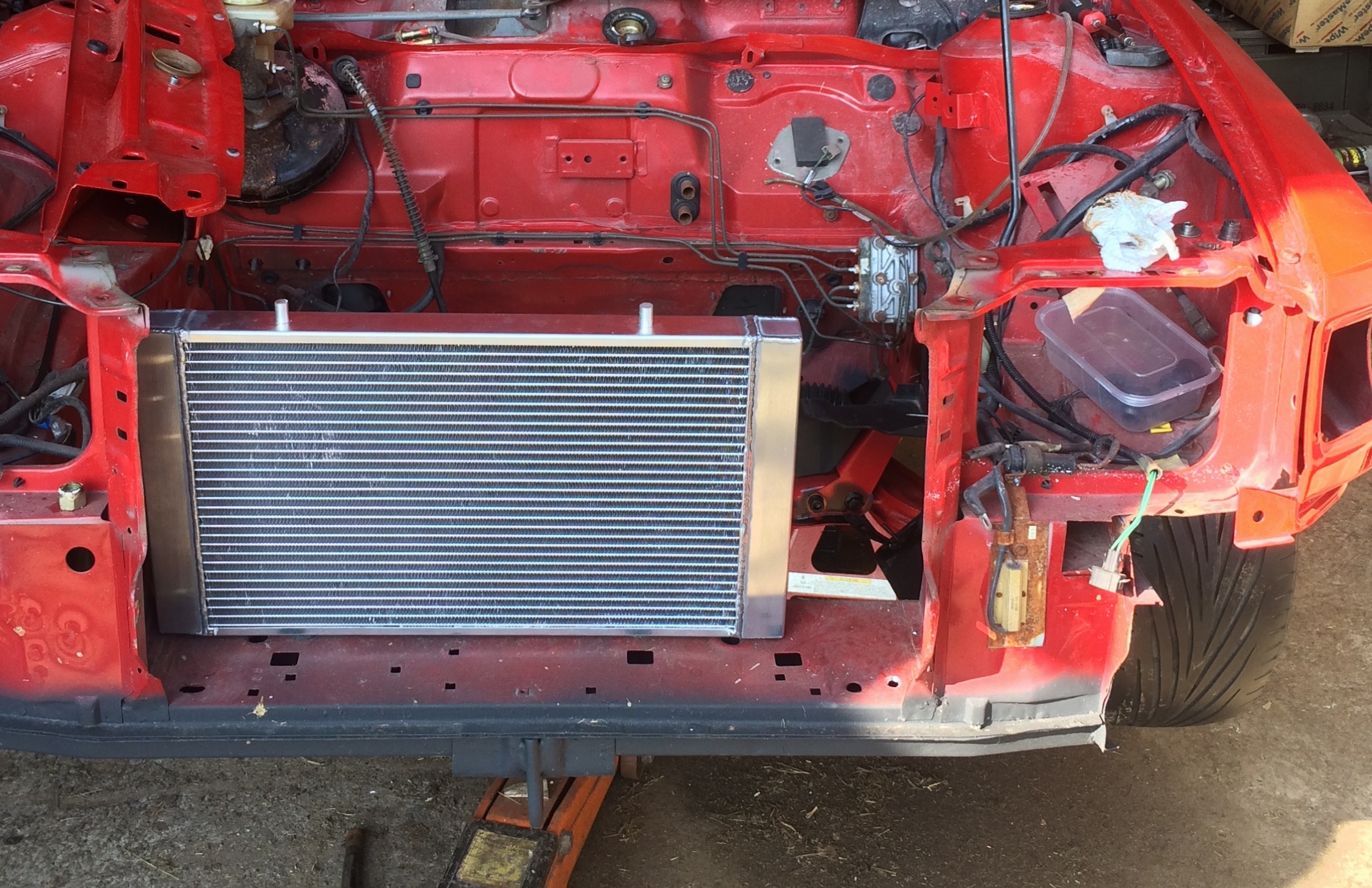

              if your interested in the Intercooler I can send you some more photos of it, it's used but in fairly good condition. I'm using a intercooler over three times lager than that now its actually larger than the uprated Radtec radiator, I'm working on the car tomorrow so will take a pic of that as well for you

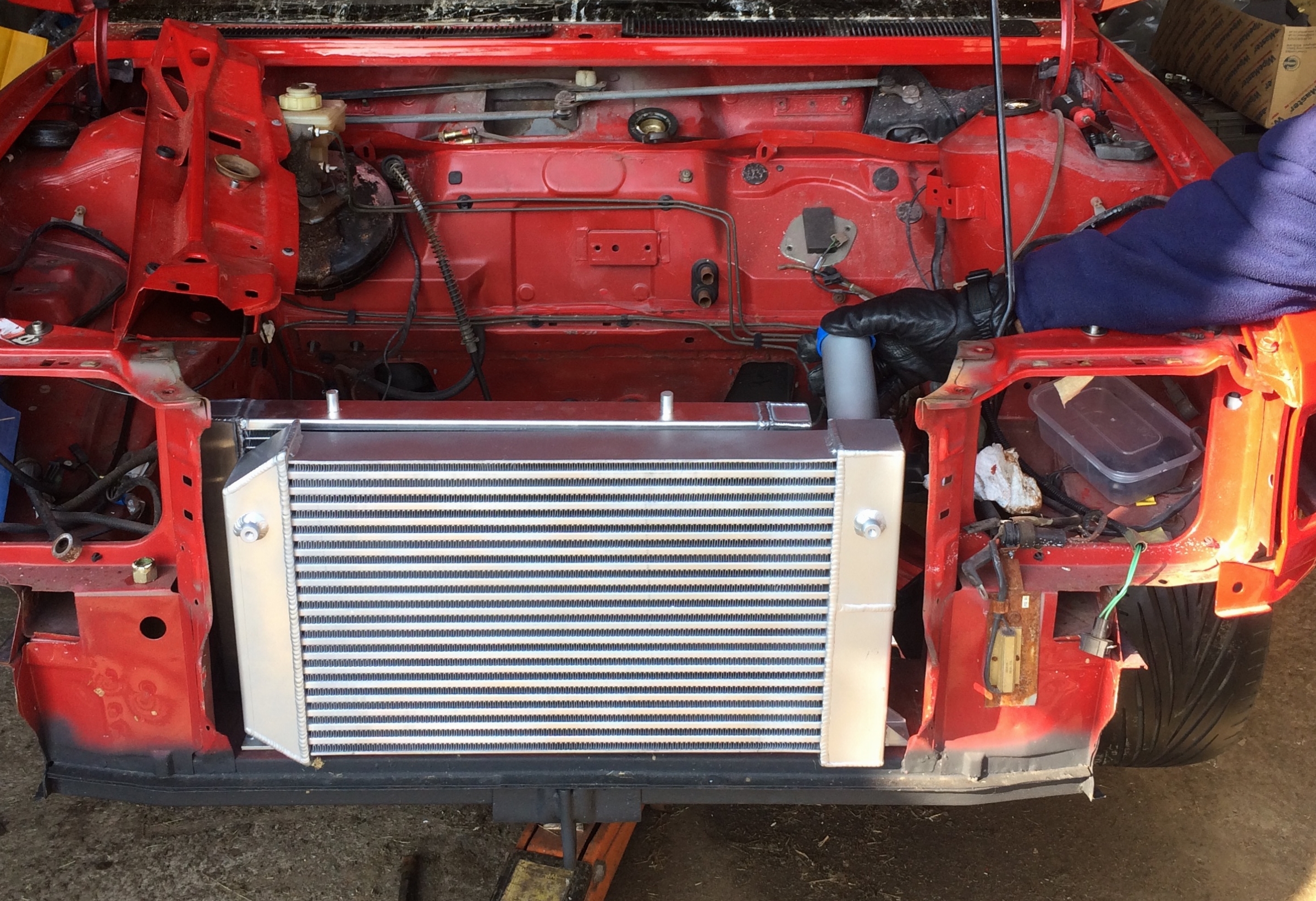

                  here's the photos of the Radiator and intercooler
                    Fits like a glove...looks like a top job.
