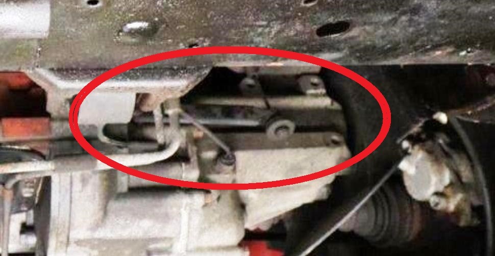

                      does your clutch lever look like this one?
                        Looks like this :
                          Thanks
                            Are you sure that is a UUC005073EVA? Looks like a later type cable and a later type clutch lever, and might be fine and in good order, did you try adjusting it?

                              [QUOTE=robert1;n337529]Are you sure that is a UUC005073EVA? Looks like a later type cable and a later type clutch lever, and might be fine and in good order, did you try adjusting it?
                              That's an older photo before we changed the cable, it's a 1986 car and that part number is correct. We're just about to do that adjusting.
