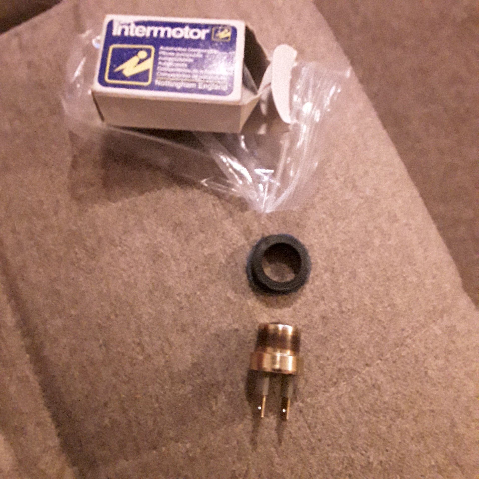

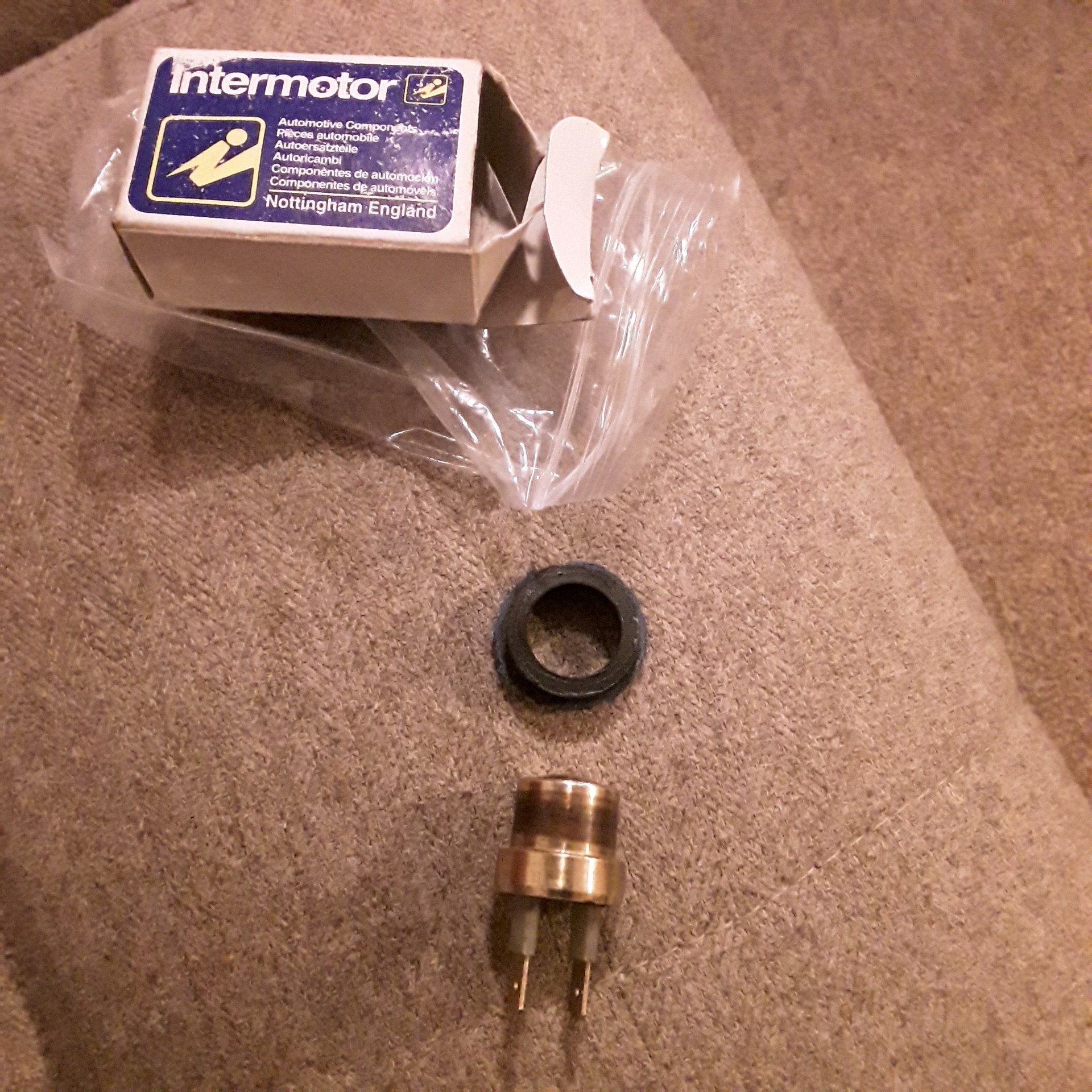

    Hi guys after a week of the radiator fan switch has failed again this time it is burnt see the photos attached put a new one in again still got loads of air in the system how do I get all the air out?
