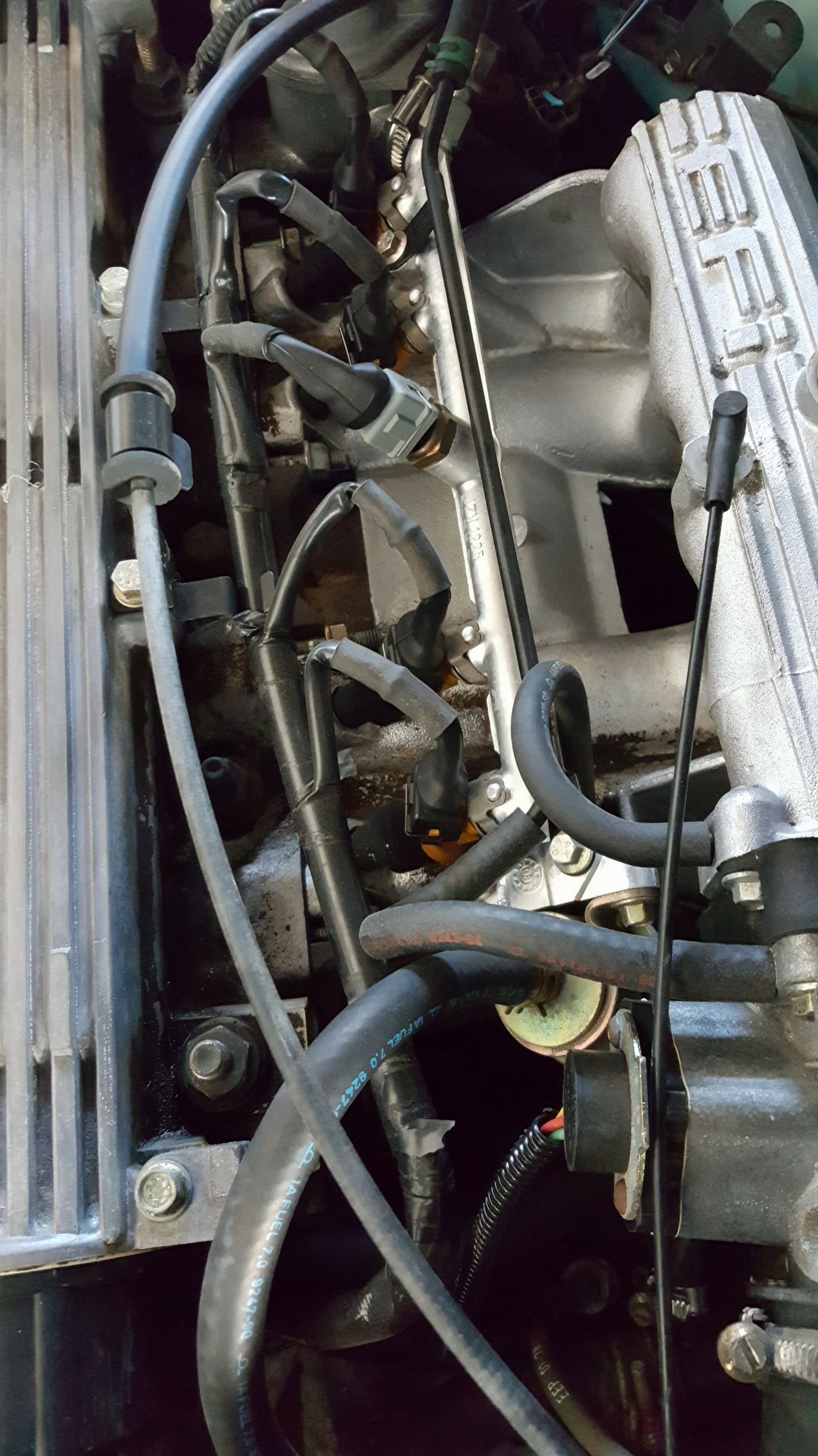

    do you have photos of it?

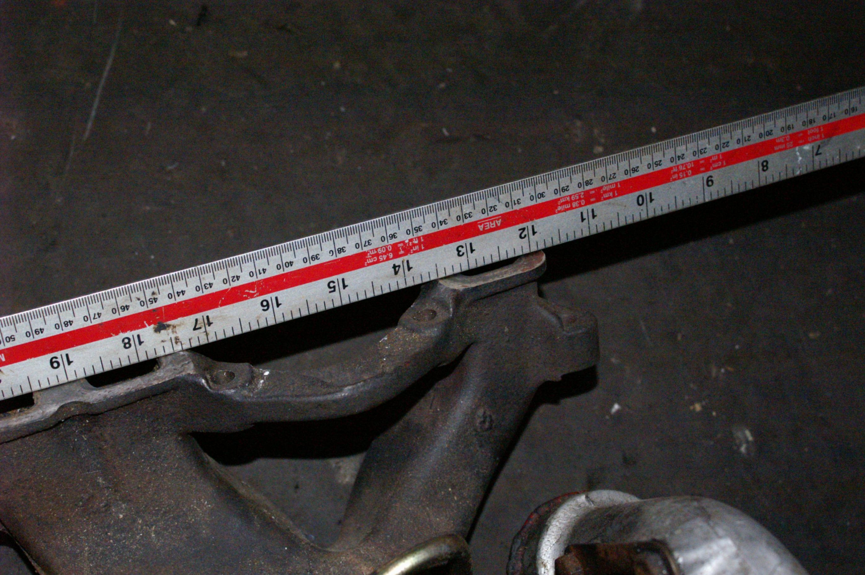

      I would guess he is referring to the injet/exhaust manifold gasket which is blowing. I would suspect the manifold may be warped and need its face machining flat again if the correct gasket was used.
      Does the EFI have any braces on the inlet manifold like the turbo does?

        sounds right, not sure about the braces, the carb ones had them I think, so Efi probably would too, I guess, I'll have a look in the morning, I've got one outside...

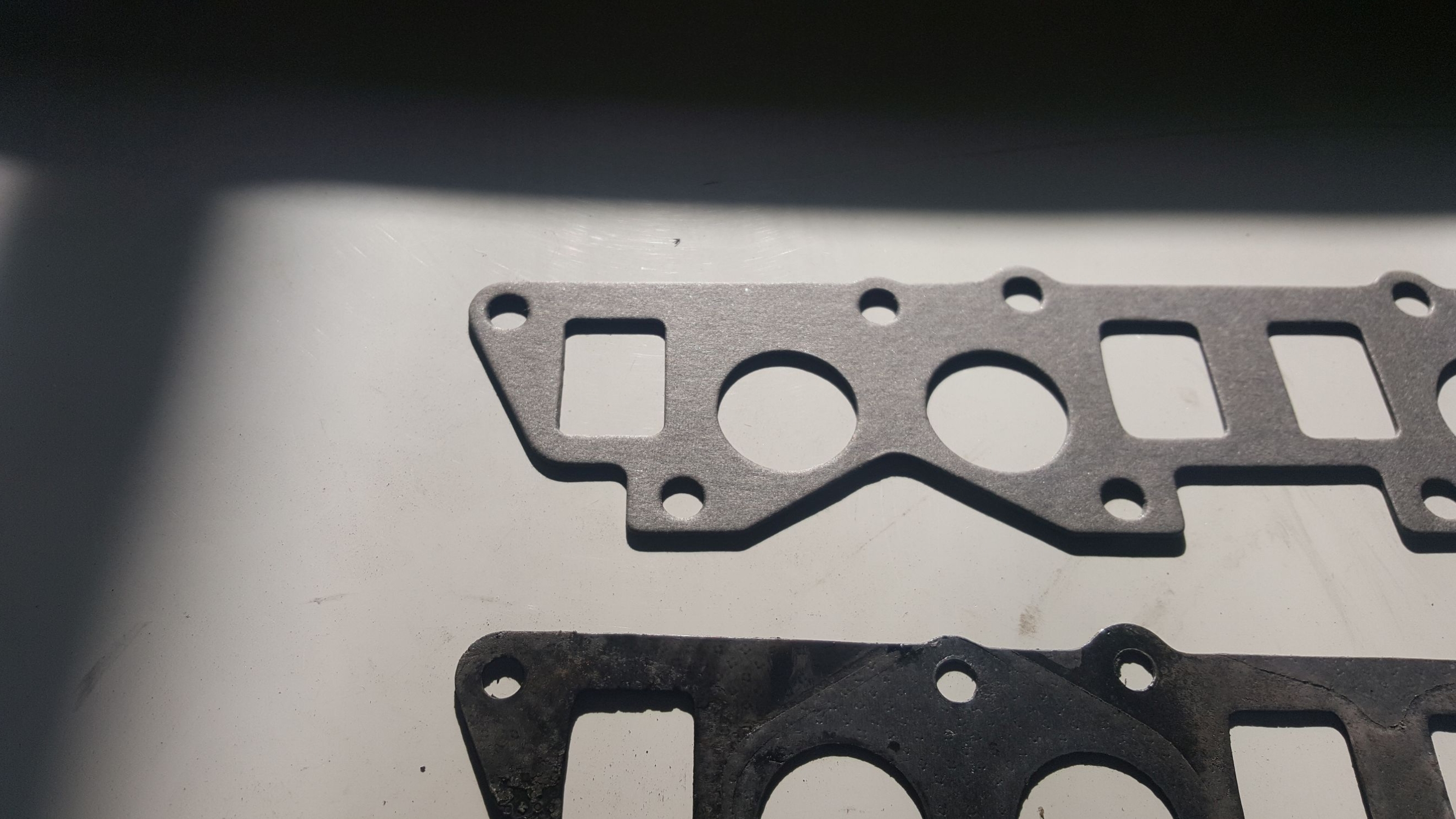

          Now the damage is low, but in 200 or 300 km go up.
          We have the same problem in the previous gasket.

            yes you are right it does have braces, not as many as the turbo though, I've also added a photo of a turbo manifold that was warped....not so easy to check when it is in the car....
            have just refitted this and also noticed that the correct torque for the bolts is not as tight as you would expect, 18 ft .lbf, but I don't know if overtightening would cause it to fail so quickly..

              The old gasket is ok. When I go out it I looked the problem.
              I make erroneous installing, I don’t make a correct installation, you can look that don’t press all parts.
              I think it
                I installed a Spanish reseller gasket, now I install a English reseller and make most force (press or “tor”) .
                You can look the difference in the photos

                      I think that most of the information you need will be in the haynes manual, making sure that the surfaces are flat is quite important, the one in my photo is from a turbo, and was not flat. It had done exactly the same as your one, I repaired it with milling machine, but it is possible to make them flat by hand, using a concrete floor or paving stone. I'll post photos of the pages from factory manual, just in case it says more than haynes

                            I think that somebody might have flattened the exhaust manifold, so that inlet is being clamped tight, but exhaust is not...If you measure the thickness where the bolt holes are, each manifold should be the same. If there is a big difference you will meed to make them the same
