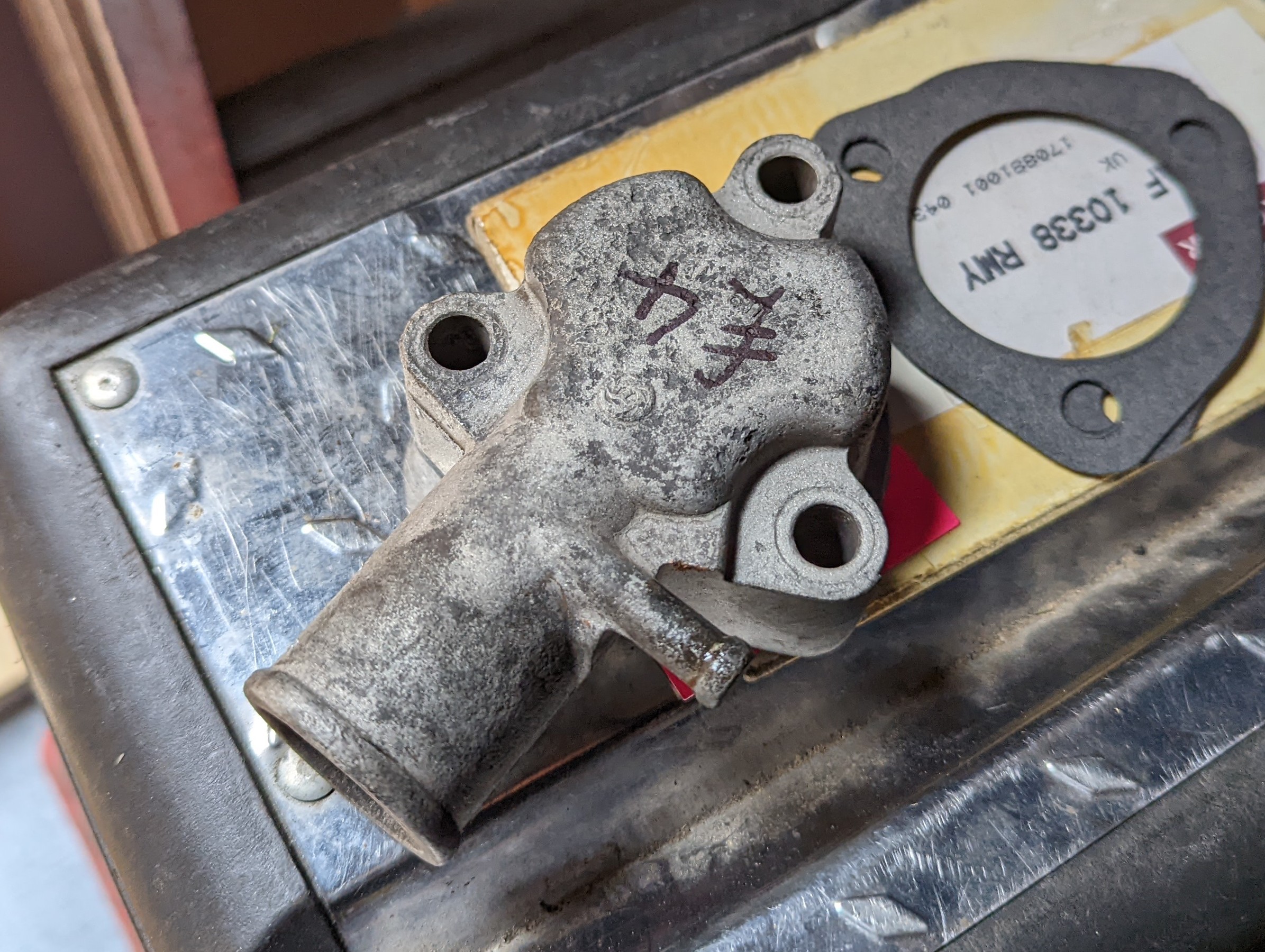

I went to the Mini Riviera Run at Pentewan yesterday, got a few smiles for the Maestro in the car park but also picked up a couple of things for my A series Maestro, a few gaskets, a thermostat housing for a late Cooper which is the same as the Metro 1275 housing except the expansion pipe isn't drilled (but is drillable).
I picked up the housing as I was worried about mine being a pain to get off and had been putting off checking the thermostat without having a spare in case I broke it.
£4 was a bargain considering the cheapest I can find a used one online was £20. A new MPI mini one is £60-£70 which also had the expansion offtake. Apparently the tooling for the originals was scrapped, as far as I can tell so were metro and maestro ones. New ones are CNCed alloy.
Turned out I didn't need it, I got a new thermostat at the show and fitted this morning and now the engine does as expected but mine came off easy enough with a bit of wd40. I did check the mini one fitted though and it does except the hose fitting faces toward the wing more, there's loads of room but may need a longer top hose to the radiator, I don't think mine would have reached the extra couple of centimetres.
I put an 88c thermostat in and took out a 75c one which I think was my cold running problem. Someone had also siliconed the housing to the sandwich plate which was fun to clean up.
