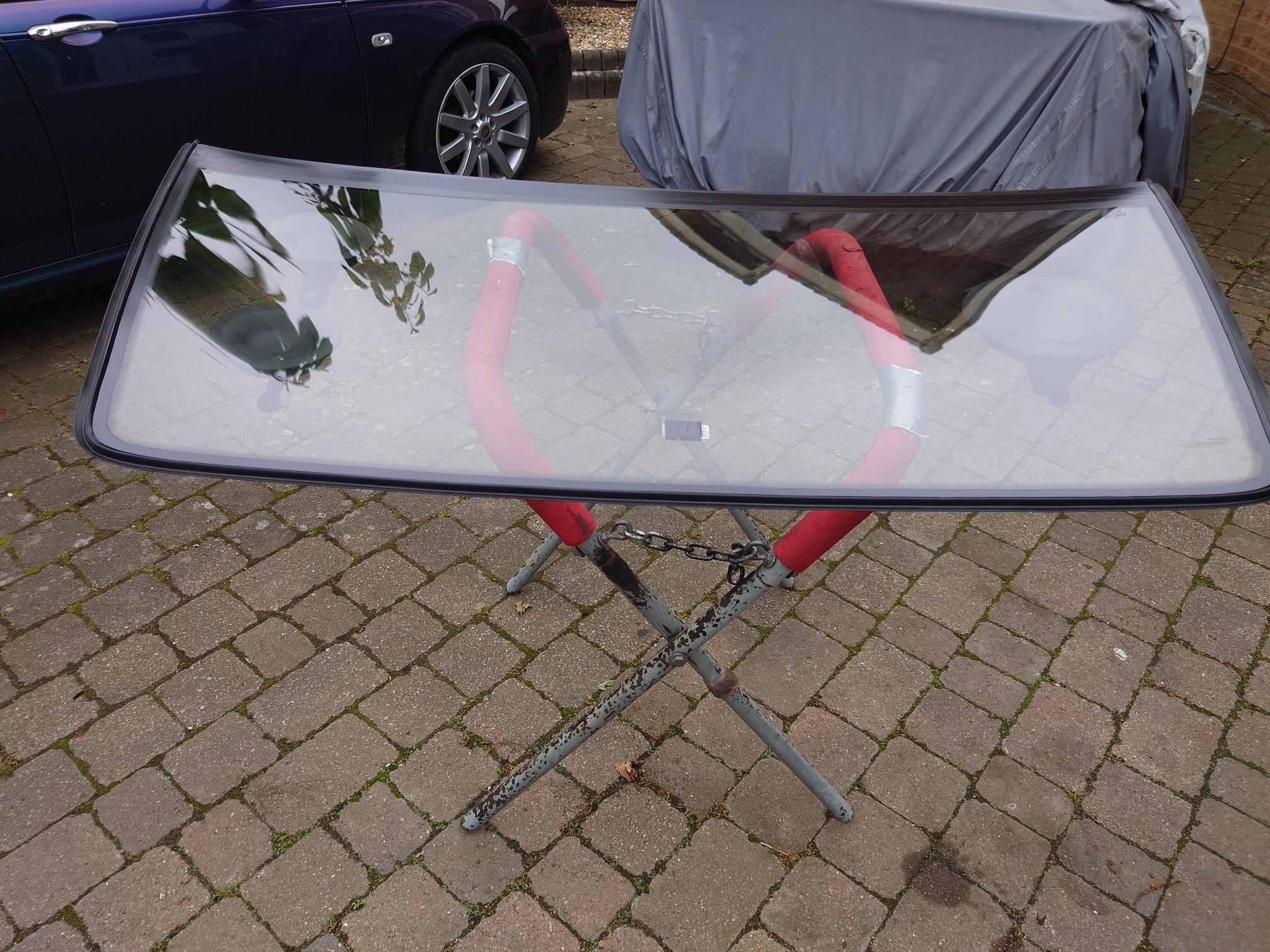

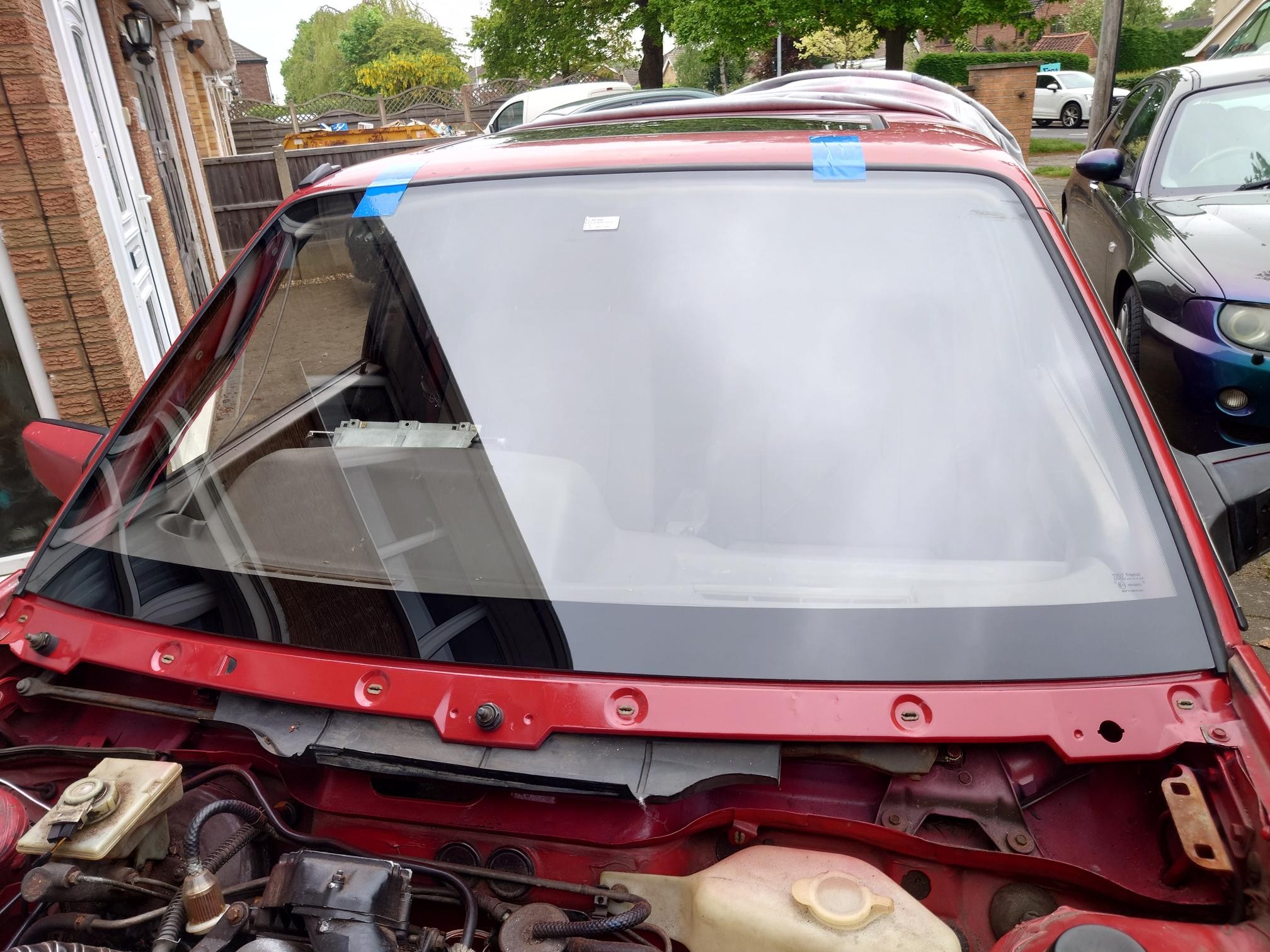

  • Annoying that the windscreen surrounds are rubbish, I've got a couple of them for mine...I may have to replan...
      The problem is not enough material to attach to the windscreen, the 2mm cut out isn't enough. If they made it say 6mm it would work

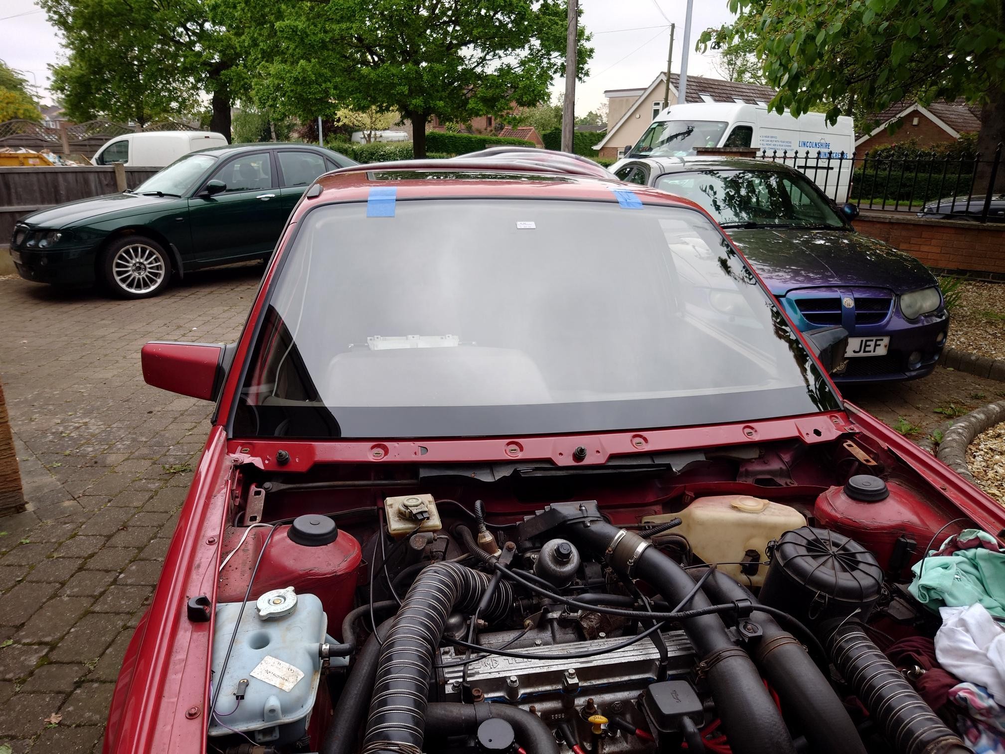

      • Windscreen went in today, the generic trim I bought off ebay fitted lovely and was the same size as the one that came off it. Very happy

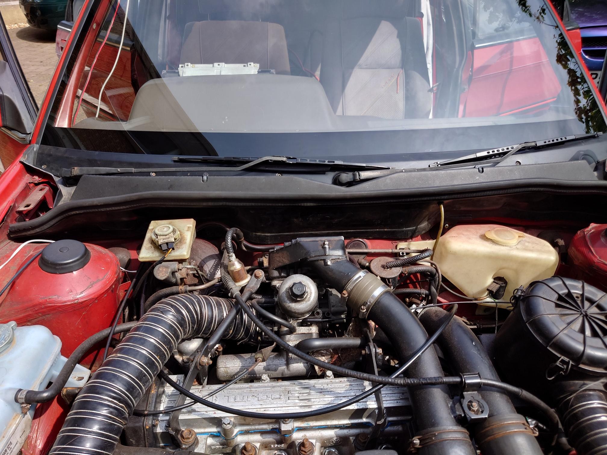

        • Scuttle on and without cracking the windscreen, wipers on, started the car up and the rev counter still isn't correct, turned the heater fan on and that's now not working. Removed the dash yet again and dropped a nut that went under the passenger seat, couldn't find it so as things are not going well I stopped for the day. On a good note the car started on the button.
          I may have an earth issue somewhere but I am not good at electrics, the fan was working before I removed the dash so no idea atm. If I turn the fan on a light comes on at the display and another on the heated rear window so I'm at a loss atm
          With the rev counter it should be just coil from memory so I will have another look at that. The trigger lead is connected to the coil -ve terminal and receives pulses from the ignition system, The multifunction unit receives the pulses and drives it so maybe a lose connection?

              • Cleaned up the earth leads behind the dash and alls working again now but no idea why I had to do that as I didn't touch it, seat removed and the small nut had fallen in between the carpet and bottom plastic panel under the seat, seat back in, dash back in. Before I put the dash clocks back in properly I checked if all was working and the headlight and side lights were not lighting up, so I changed both bulbs and all's good now, steering wheel back on, bonnet back on and new rear tyre fitted. This was the old one and badly cracked. Next thing is to sort the non working offside rear window, then tune up the carb as it's running rich

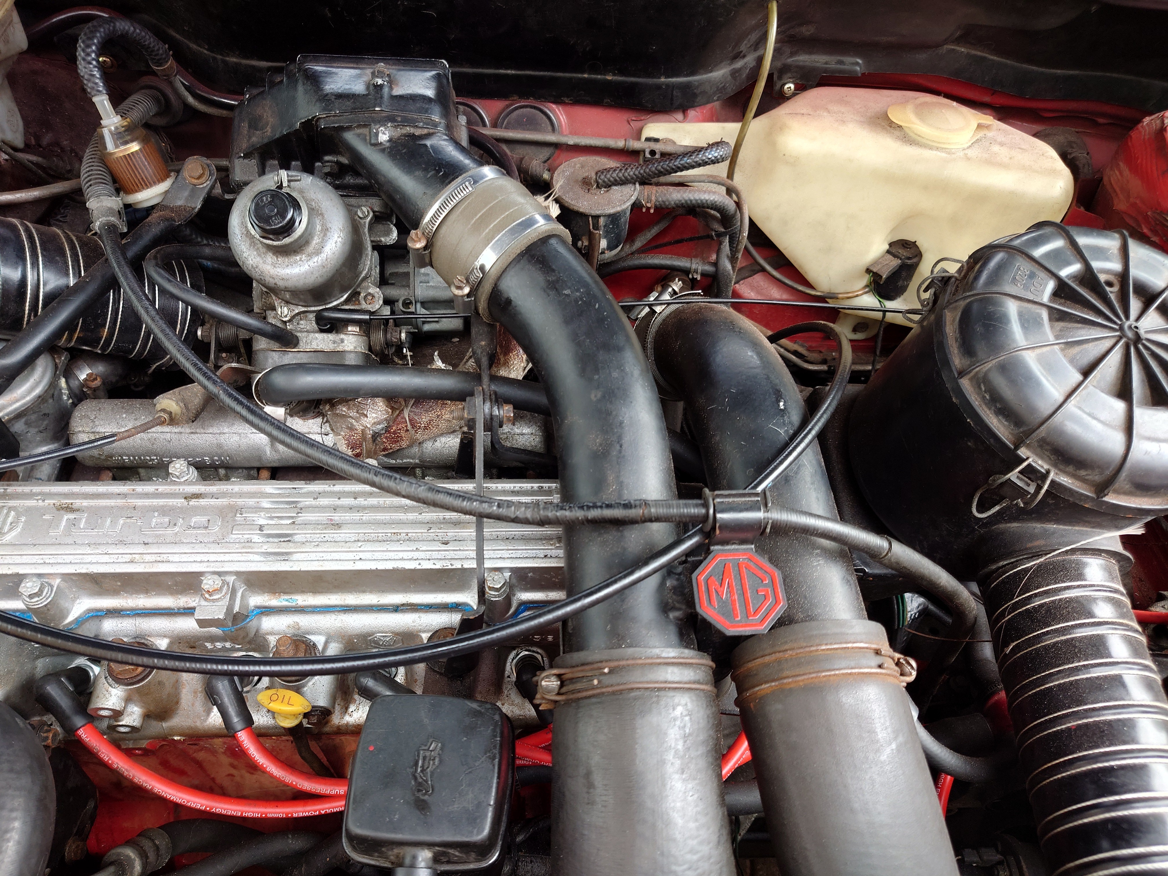

                      • All working now , my emissions tester was broken as it goes straight to the highest level when you turn it on. So I removed the plenum and unscrewed the mixture screw one turn, started on the button and running well.

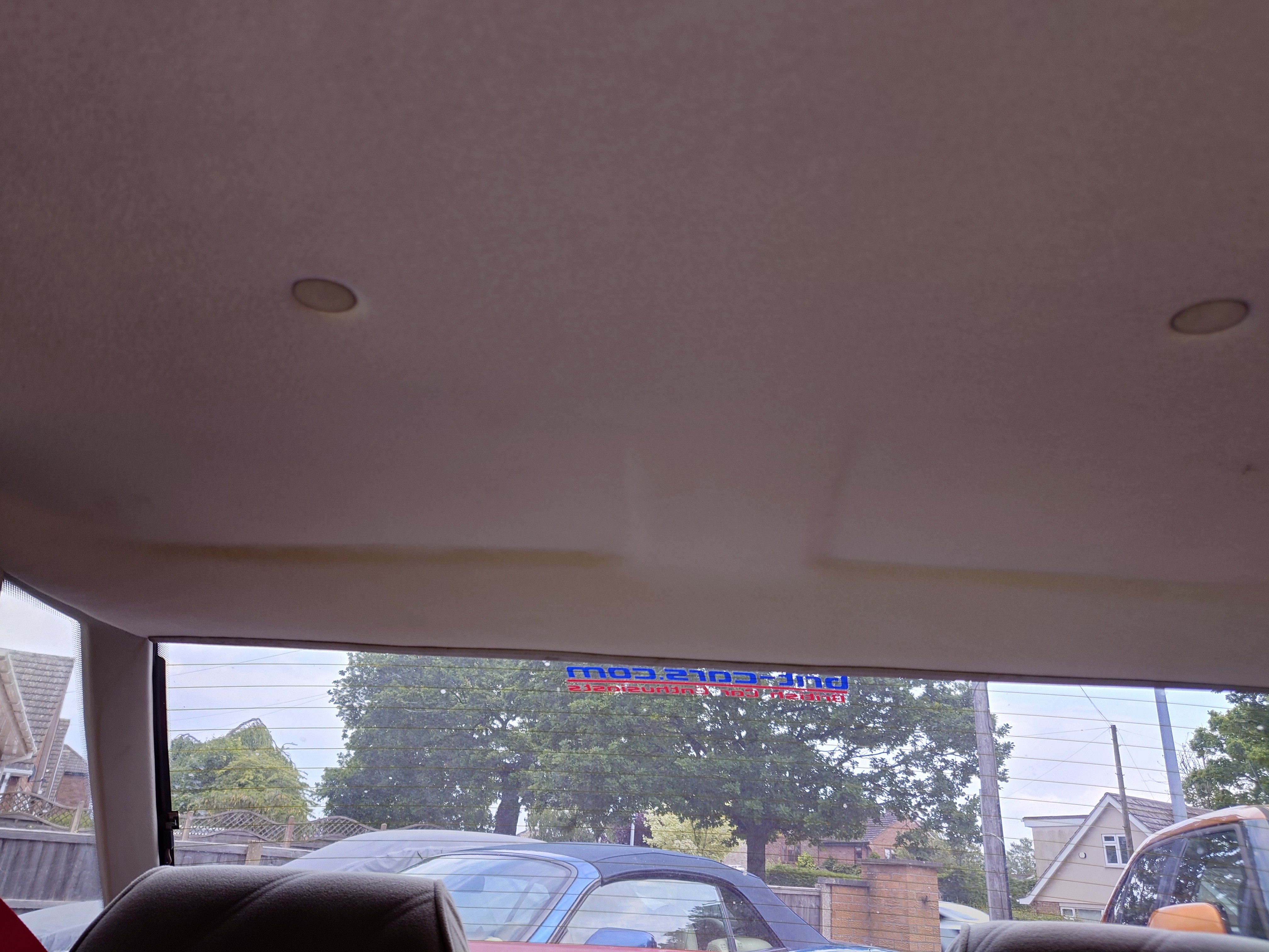

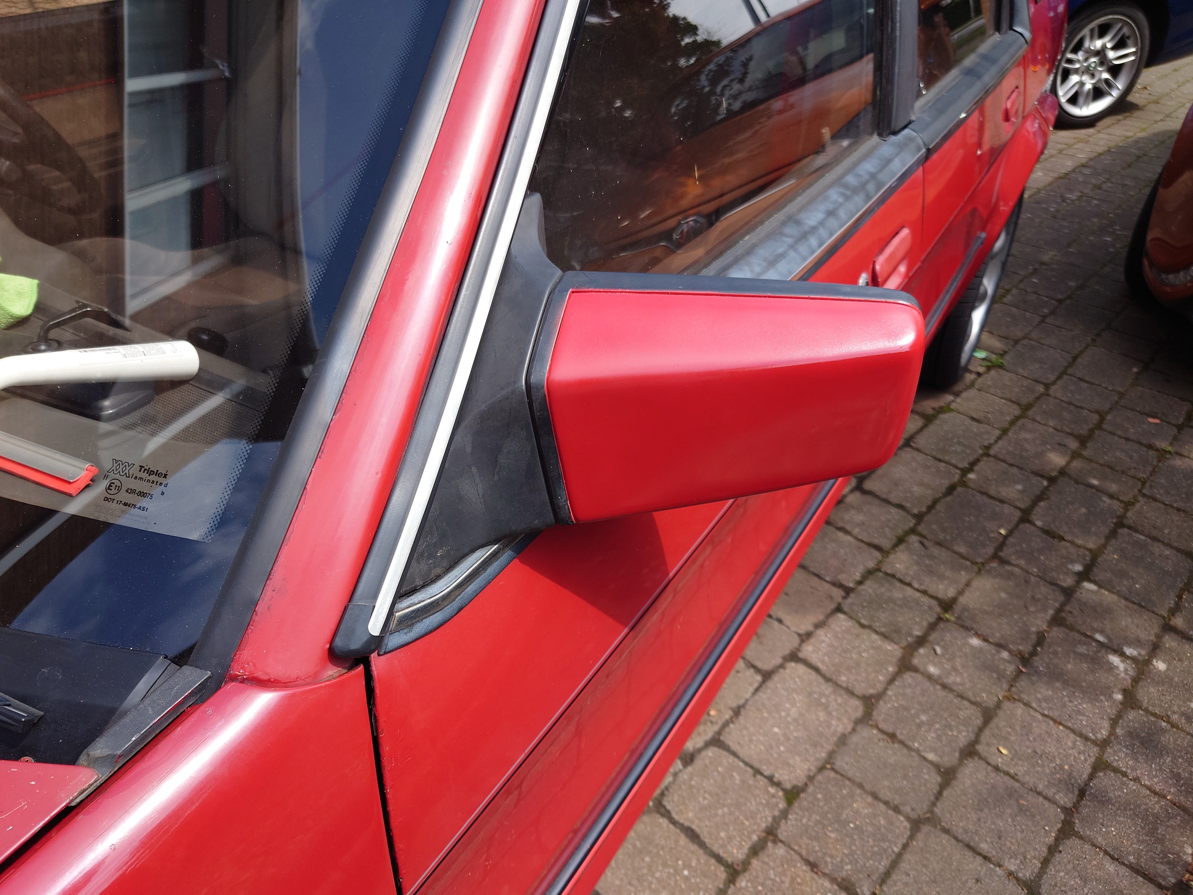

                        Last bits also now done, door mirror now on and the interior cleaning up, headlining finished. It's now ready for an MOT after Chris has washed it and polished it

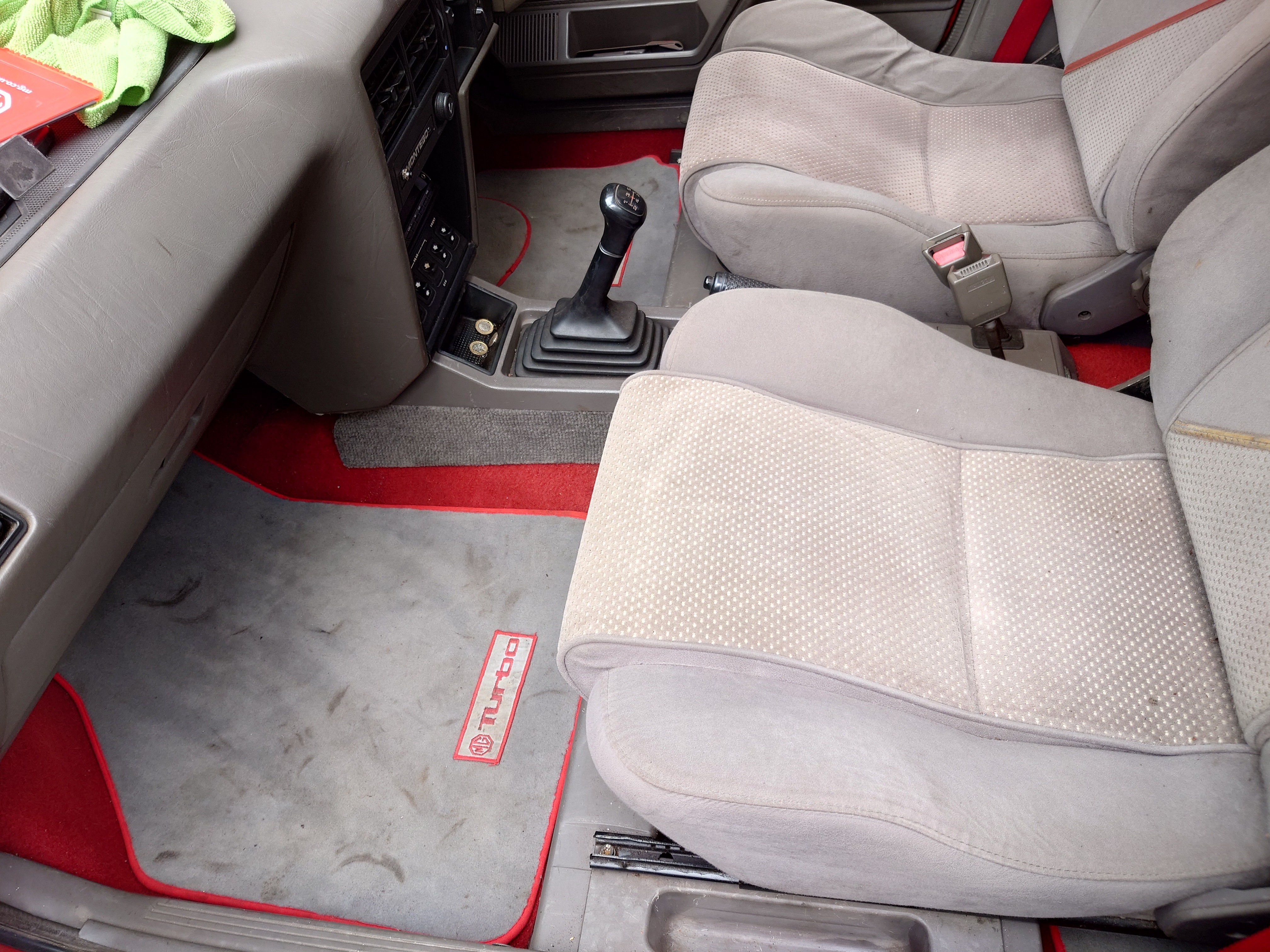

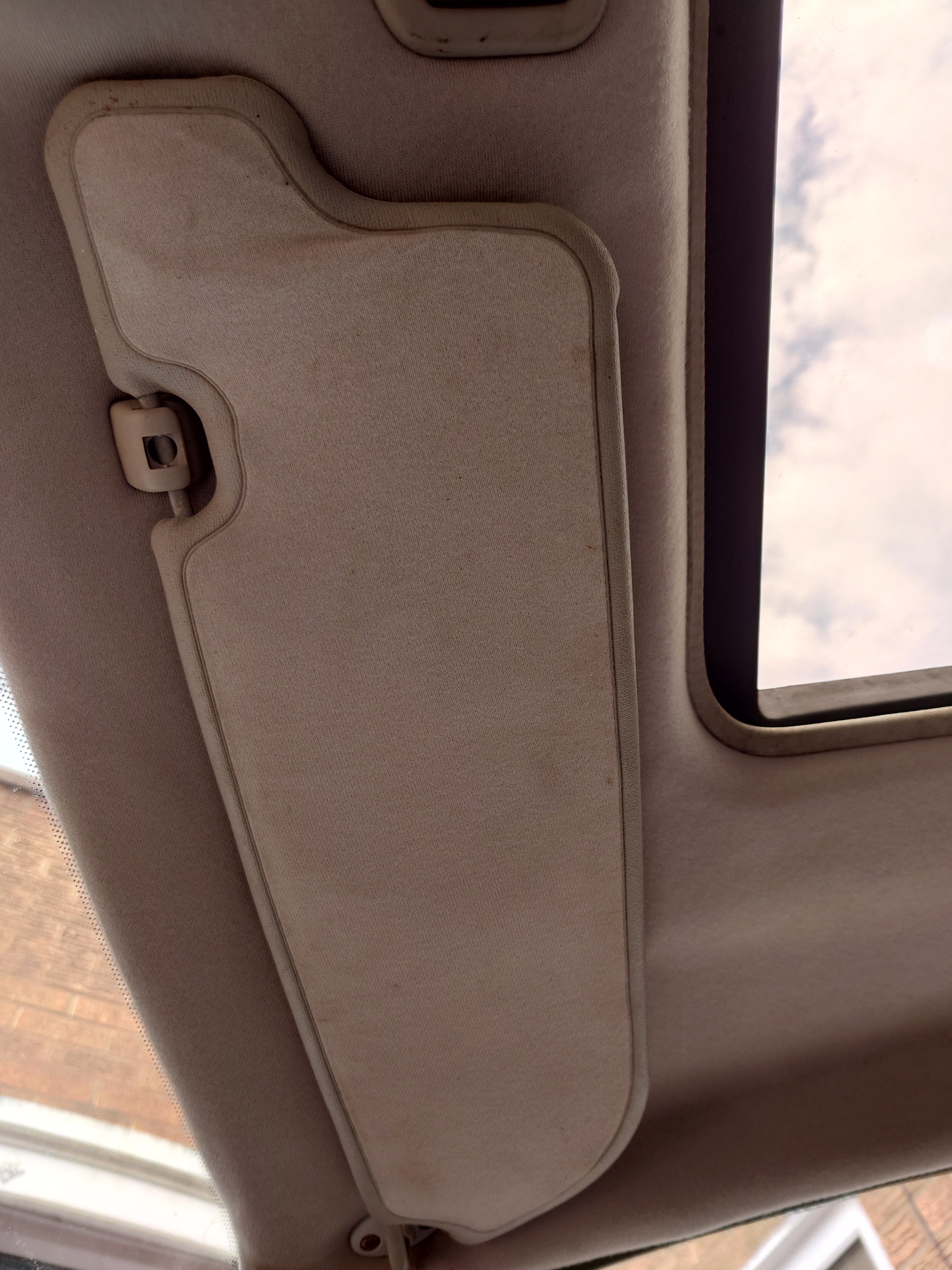

                        • Interior finished
                          • Engine now also finished , well hopefully and hoping it's not broken again this year
