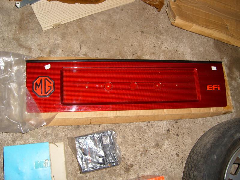

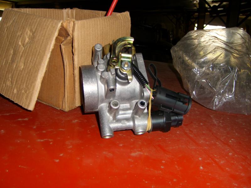

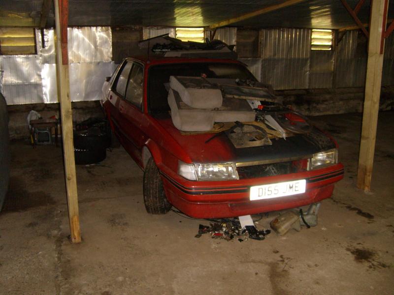

        Went and had a proper look round the car today and listed a few things that came with it including my prezzy from Mal.
        New Throttle body
        New ECU
        All four wheels have been re-furbed
        New horns
        New rear plinth
        New outer CV unit
        New boot lock mechanism
        New rear brake cylinders
        2 new front wheel bearings
        New front MG badge
        2x new front electric window mechanisms

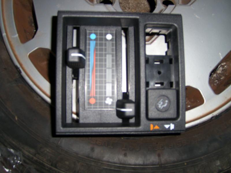

        New heater dash display
        New rear seat base cover

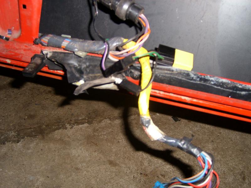

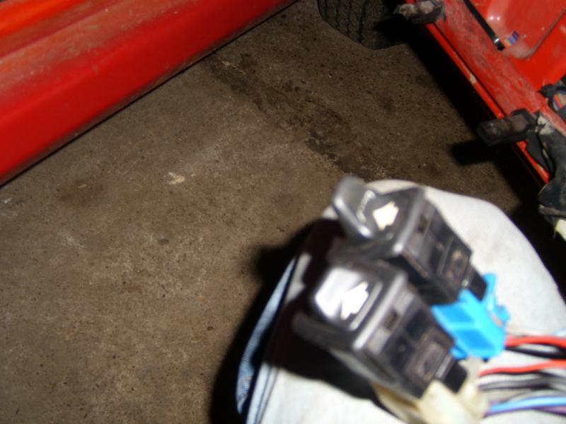

          • #35
            Note the switches on the door cards
            Plenty of thick wiring and a relay in the door
            Note the old style dash
            Note the longer 'one shot' drivers window switch

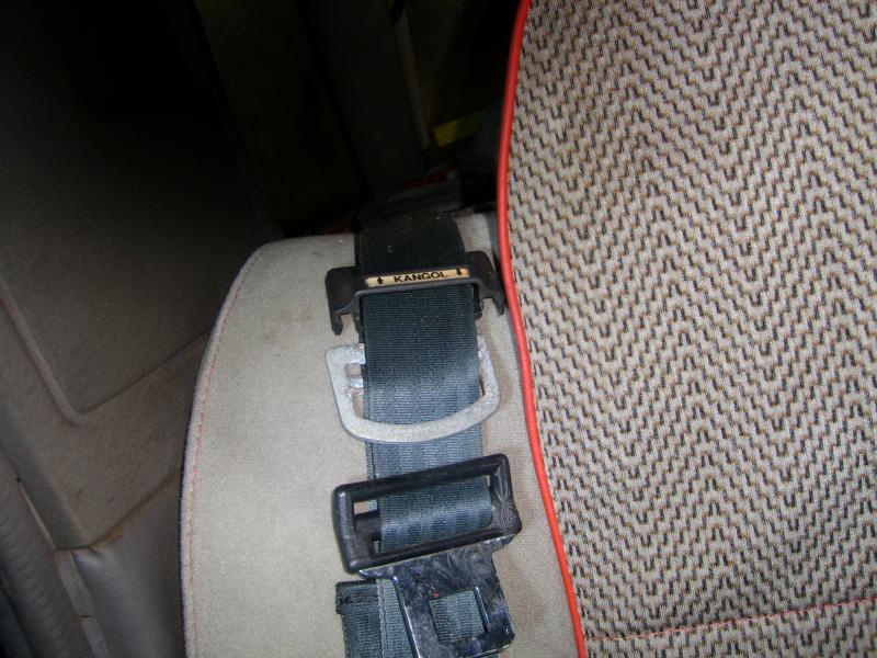

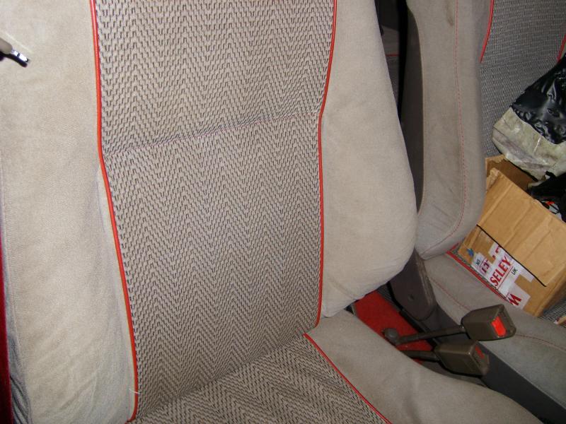

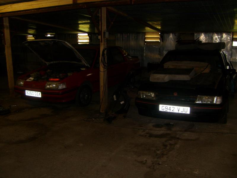

            • #36
              Note the rear black seatbelts, fronts are red
              Fronts seats just need a clean really but I have 2 spare
              The projects next to each other
              My sons Turbo project

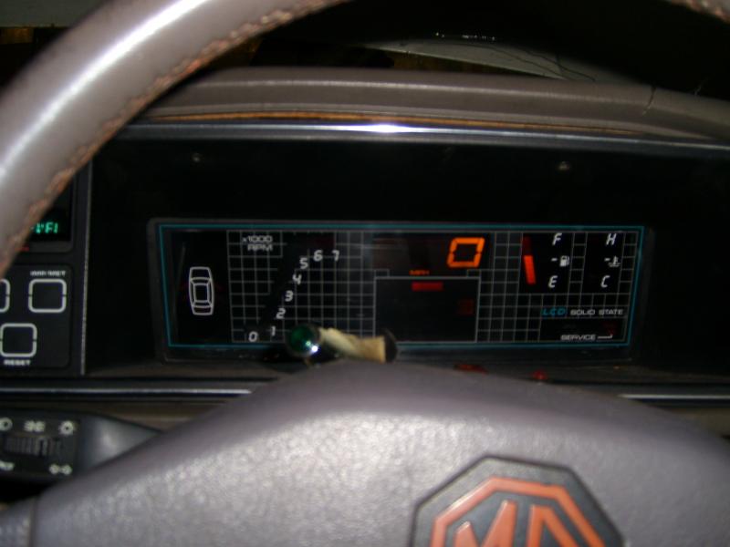

                • #38
                  look forward to seeing this finished. i would love one of these or a 1985 turbo. I see the service light is on, how do you go about reseting that?
                  By the way i have a brand new rear light bulb check module for one of thoses should you need it
                  • #39
                    Might take you up on that, how much?
                    To reset the service light as follows:
                    Switch on ignition and ensure date is correct
                    Press and hold SELECT untill it displays english, briefly press SELECT again until screen goes blank
                    Press and hold RESET until OIL CHANGE appears, should be about 6 seconds release RESET
                    Press and RESET again until SERVICE RESET appears on right hand drive packs, again for about 6 seconds
                    Release RESET and press SELECT to revert to time and odometer.
                    Easy really according to my manual that Mal found for me. Ta Mal
