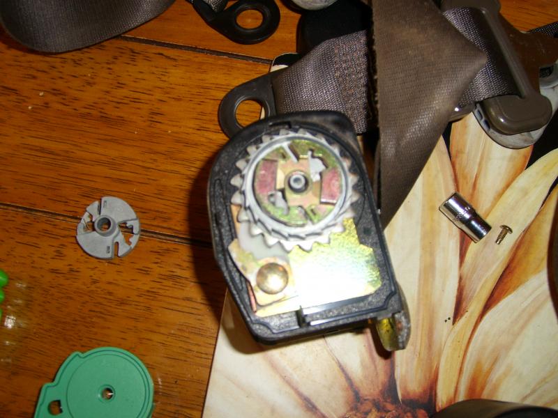

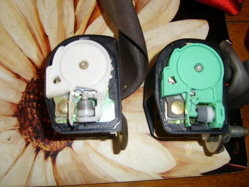

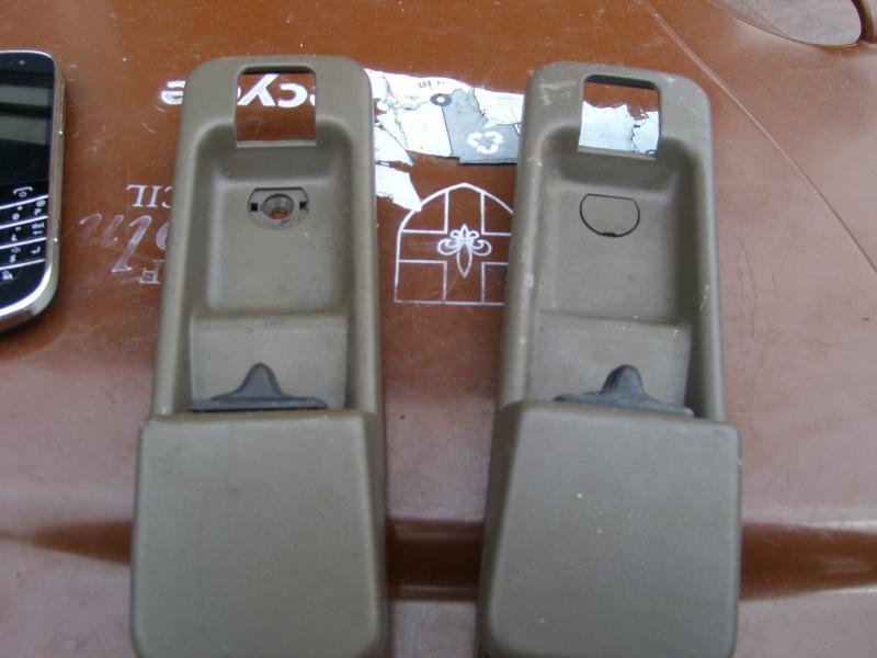

      Internal workings of seat belts that I modified.
      On the left is a front belt, on the right is a rear belt.
      Remove the screw on both belts, pull off the workings and attach to the other unit keeping the spring where it belongs and tighten the screw. Re-attach the cover and it works perfectly.

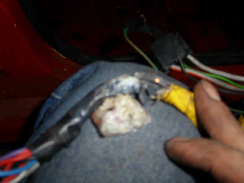

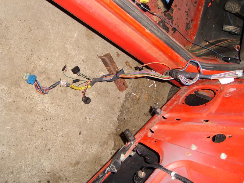

          This much wiring in the door, jesus that was loads
          Earthwire nearly in two, so now I know why the windows didn't always work

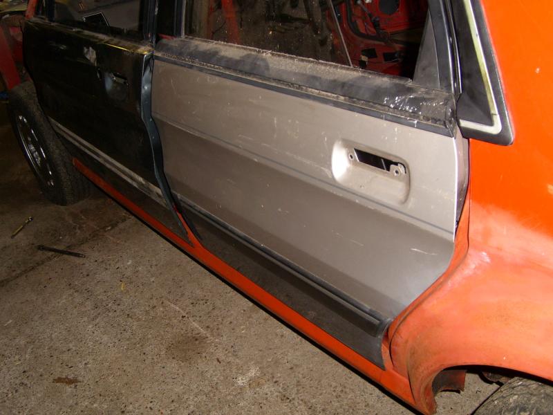

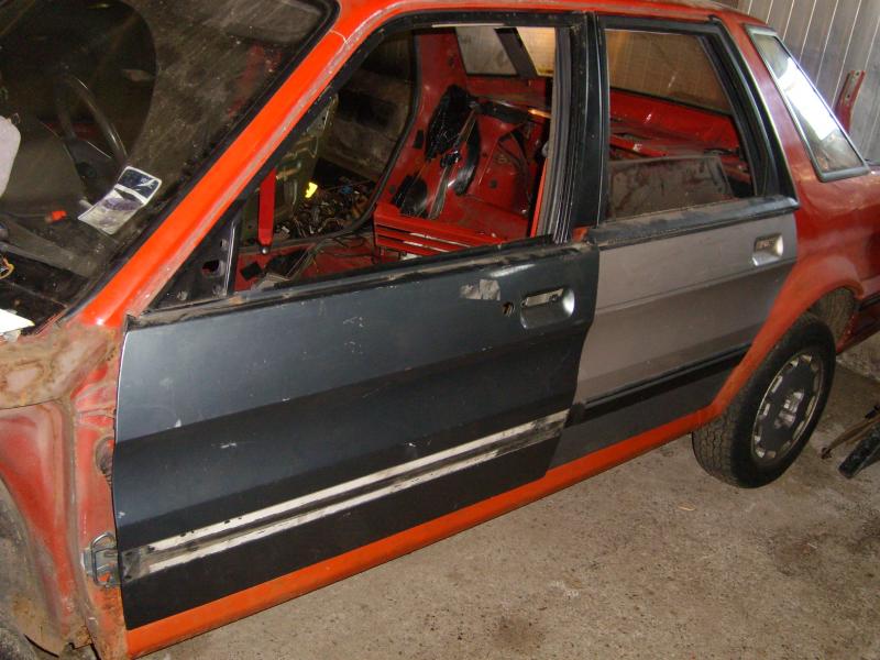

          Front nearside door on, off a VP
          Rear nearside door on, again off a VP
          Both doors lined up

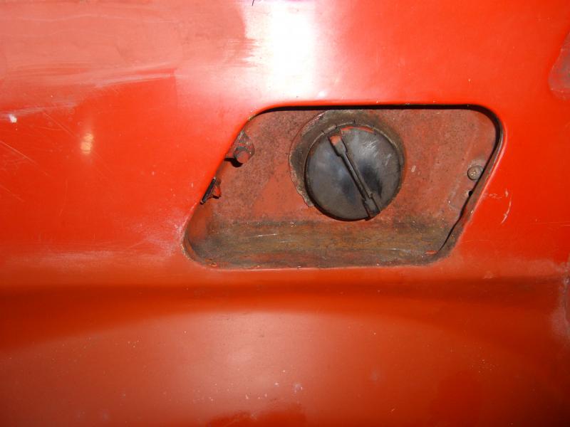

            More progress

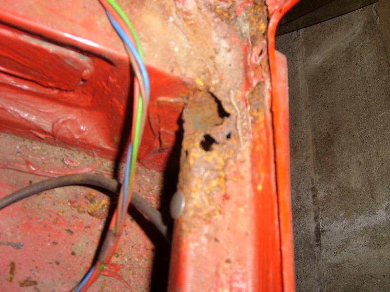

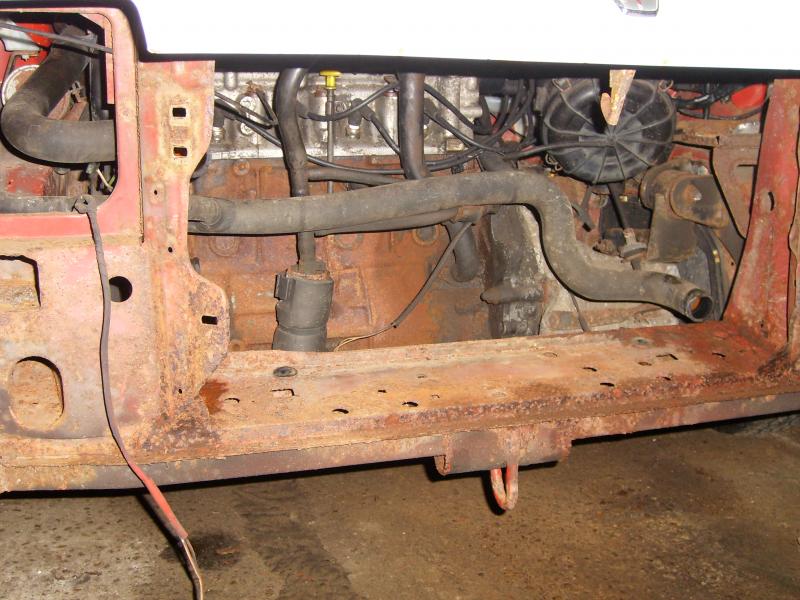

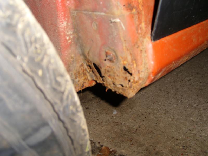

            Needs welding here
            But doesn't need any here

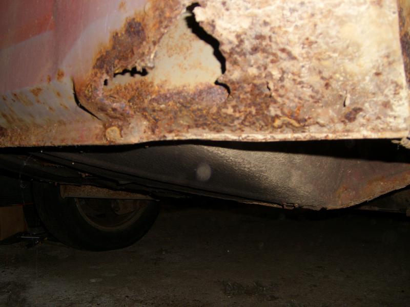

            Solid but heavy surface rust

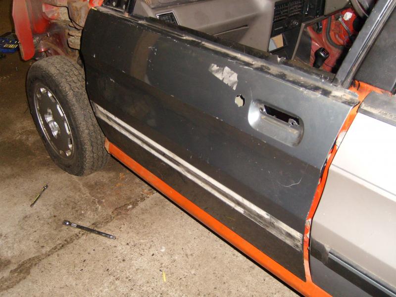

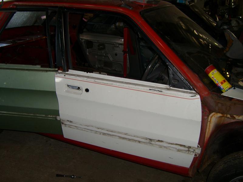

            Offside rear door on, off VP
            Offside front door on, off GSi Executive

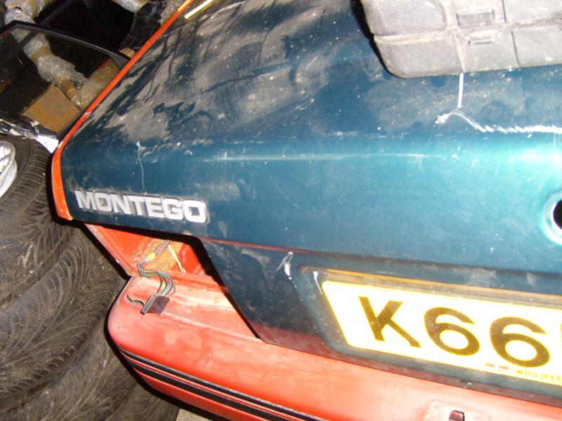

              Boot on, off DLX
              Check the fit

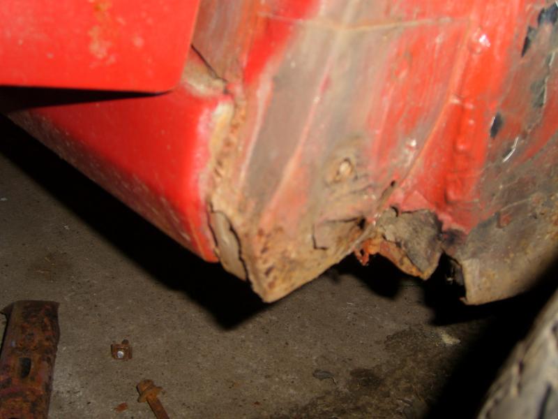

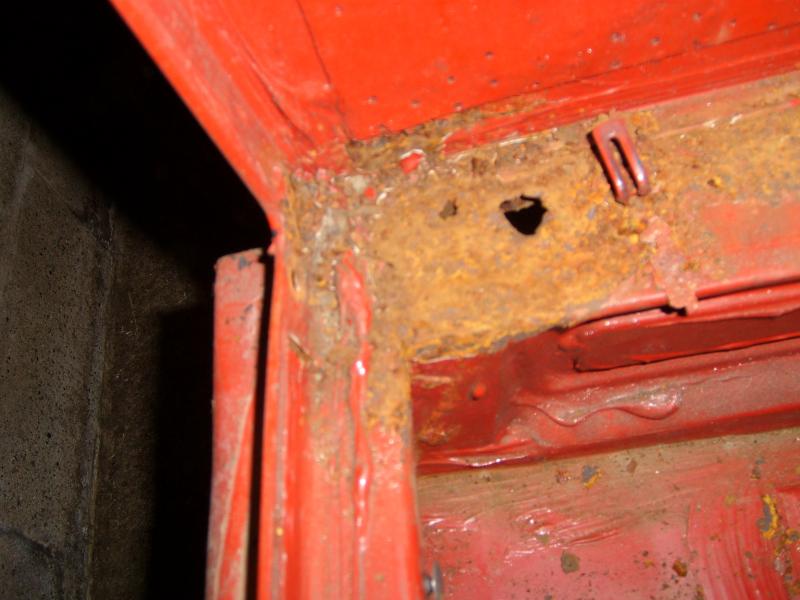

              Needs welding here

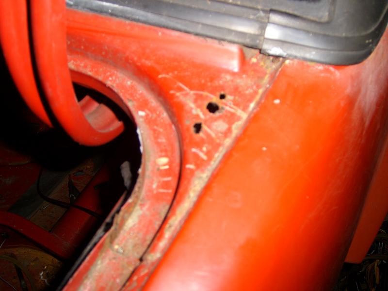

              Small hole here
              And another

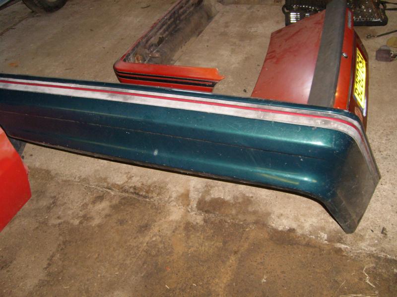

                Replacement bumper, off DLX
                No welding needed here thank god

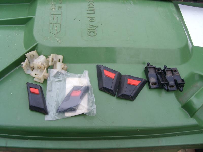

                          Cleaning out one of my sheds todays to get to these.

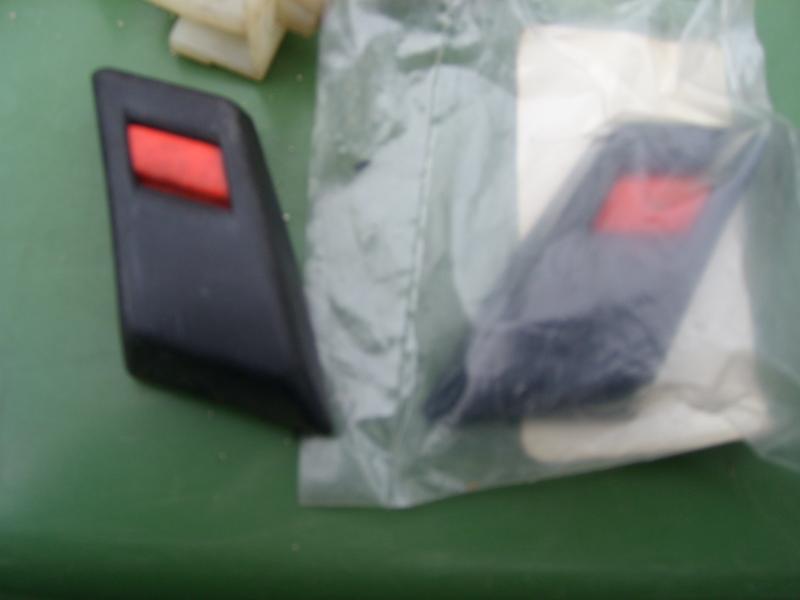

                          Various small trim bits.

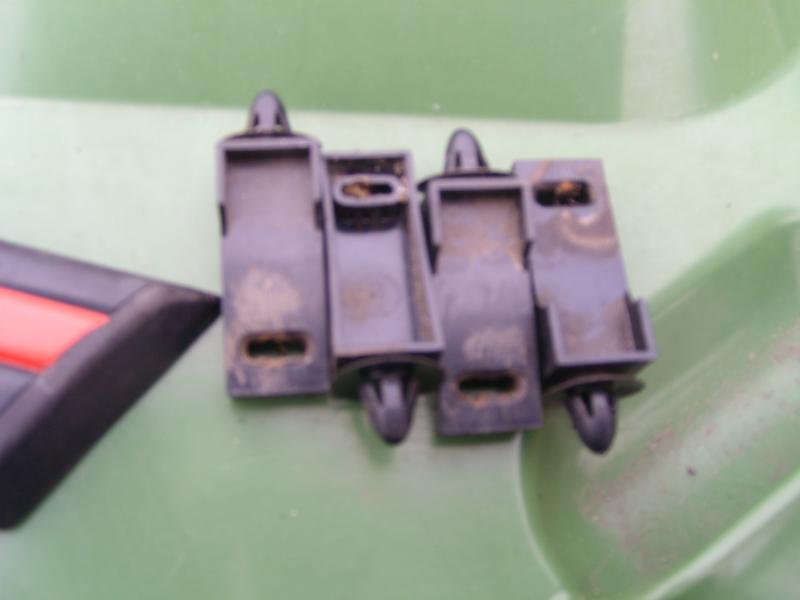

                          Rare front door trim clips that hold the door tray
                          Rear arch trims. New one donated by Richard (mgmonty&mgf) Ta Rich, old one was the last part needed to complete

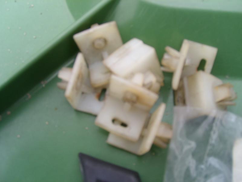

                          Many many door clips. The first doorcard holding clips were glued to the doorcard and rather useless, the upgrade were these door clips.

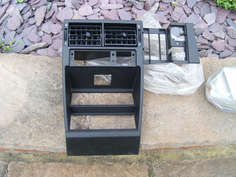

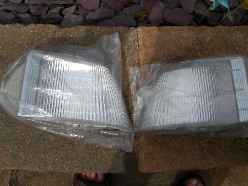

                            New front indicators. One from Andy, ta Andy, the other from MGMal
                            New dash surround from MGMal, ta Mal.
