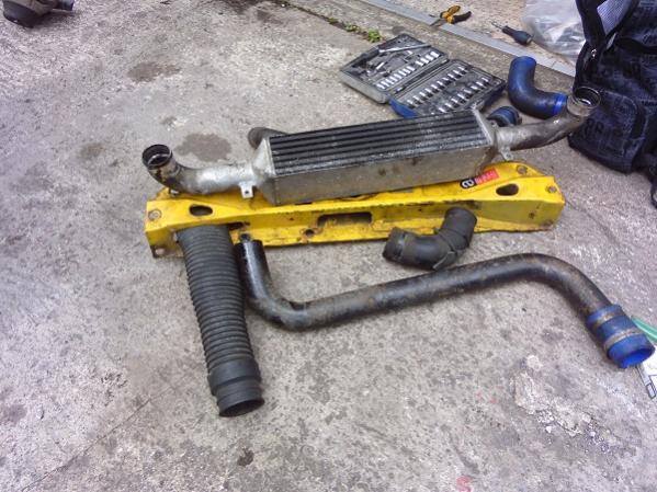

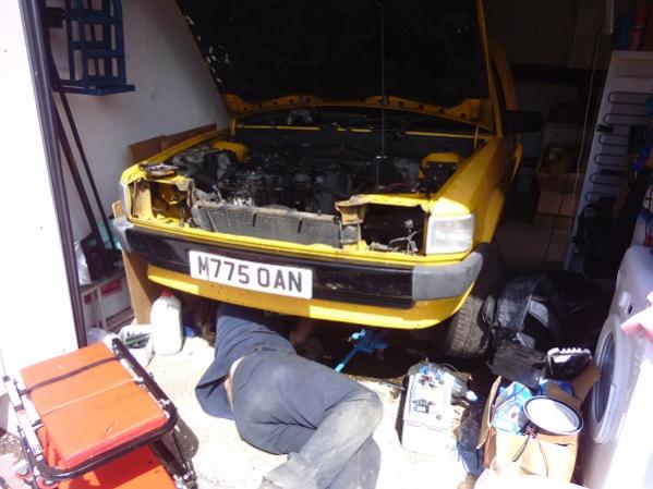

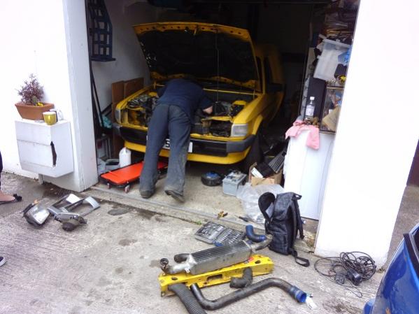

                      Been a busy day today

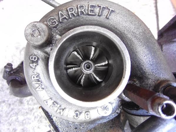

                      After many rusty seized bolts, scraped knuckles and swearing the turbo is out!
                      Many thanks to my work colleague Rich for the help!
                      The turbo is infact a GARRETT BC1 M27 A R 48, i'll let the pictures do the talking
                      So refurb/new turbo time........
                      • #41
                        Jesus, that comp wheel has taken a beating. K&N filter perhaps?

                          • #43
                            After a quick google it appears to be a Saab 2.3 turbocharger?? No wonder it was so quick!
                            • #44
                              What is the number on the plate on the turbo. The casting marks don't usually give away a lot (other than the A/R).
                              The compressor wheel does look to have taken a beating - probably as a result of running no air filter for an extended period of time.
                              • #45
                                There is no plate present....
                                I am keen to put the same turbo back on there, how's best to move forwards now?
                                Is this too far gone for a refurb? Or should I try and track down another good used unit etc
