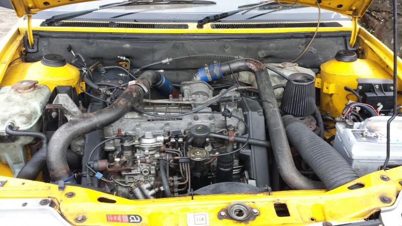

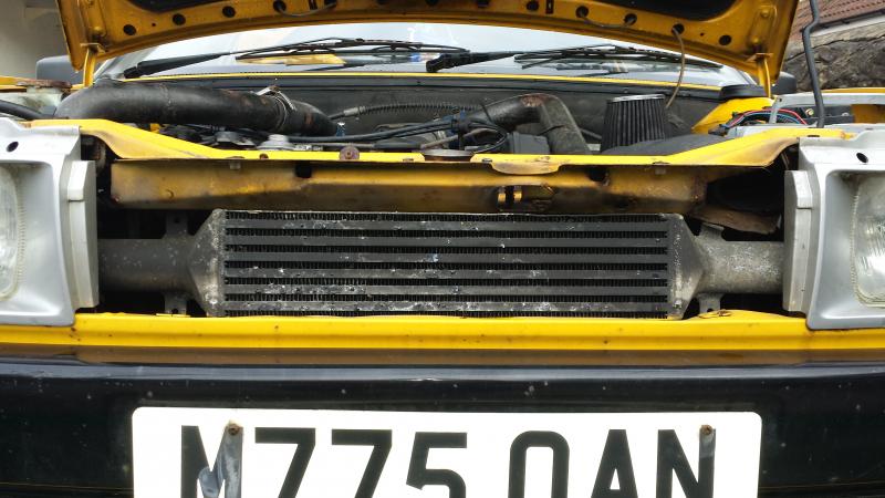

    The previous owner has upgraded it to the Turbo version of the Perkins diesel engine, also upgrading the turbo charger, injectors and intercooler. This is one fast van!
    It is smoking like i have never seen before though, i think the turbo seals are shot.

                          Ben who i bought it from said something along the lines of it must be the turbo seals because when he took an intercooler pipe off it had loads of **** in it?

                            The intercooler will always have some oil mist residue in it. It shouldn't be half full of oil though! (You'd know if it was as the engine would run away with itself)
                              Attached are some pictures of the setup.
                              I got it running in daylight today and it dripped loads of what appeared to be thick black oil out of the exhaust, does this mean the turbo seals as my friend diagnosed? ?
                              Need this on the road asap and unsure where to start...
