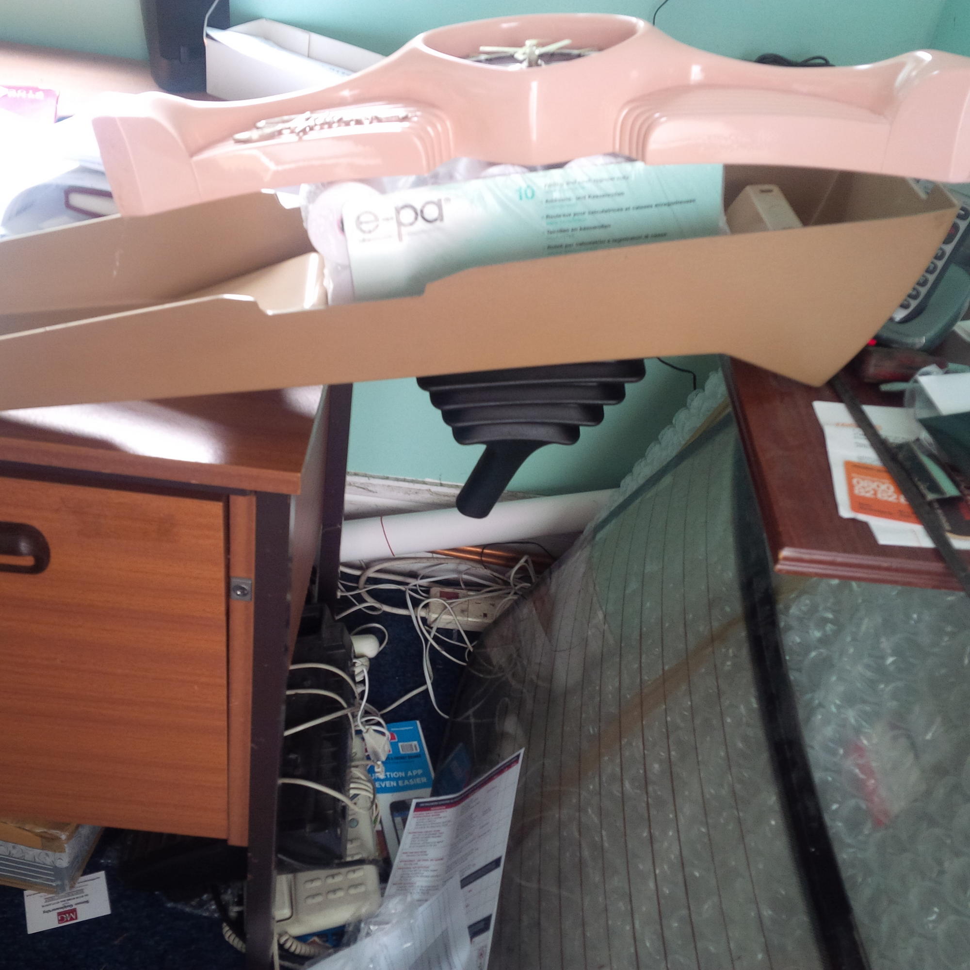

                              Next fix, hoping this will fix the centre consol.
