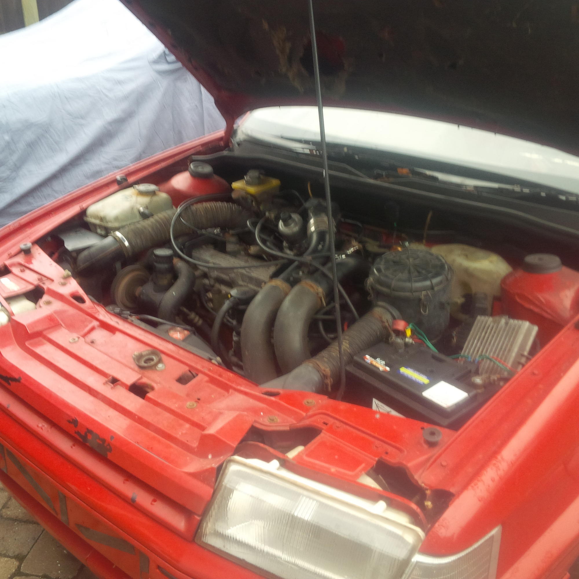

                    After it seems an age I had a bit of time today to spend on this
                    All from my spares
                    New waterpump on
                    New cambelt
                    New powersteering belt
                    New Turbo sparkplugs in
                    Time to change the rotorarm as it's over 10 years old and I suspect faulty as the car wont pull away.
                    New distributer cap
                    New HT leads attached
                    Dremel off the rotorarm as its stuck fast, new one on and...............it moved.
                    Now the complete arm in my hand and now having to glue back on. not a big problem but running out of light and no glue.
                    Oh well next week is another week

                        Drove well for 50 yards then didn't run properly again.
                        Loss of power, kept starting easy but kept loosing power.
                        • This wouldn't be the inertia switch would it? My turbo will run for approx 60s then die when the intertia switch is in the "crash" position. It will continue to do this as while cranking the switch is bypassed so you get a float chamber full of fuel each time.
