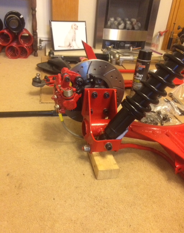

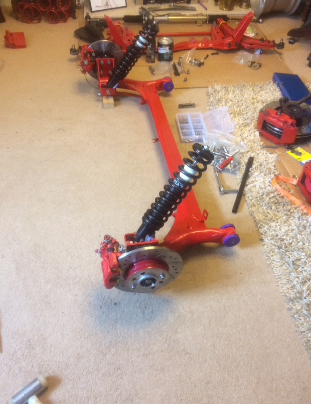

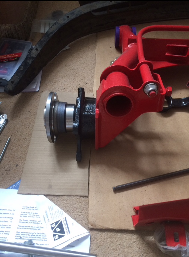

    I just noticed that I've not put any photos up of the rear suspension and more work done on the rear disc brakes, so here they are all, thats left is to drill the new stud holes. then its ready for fitting

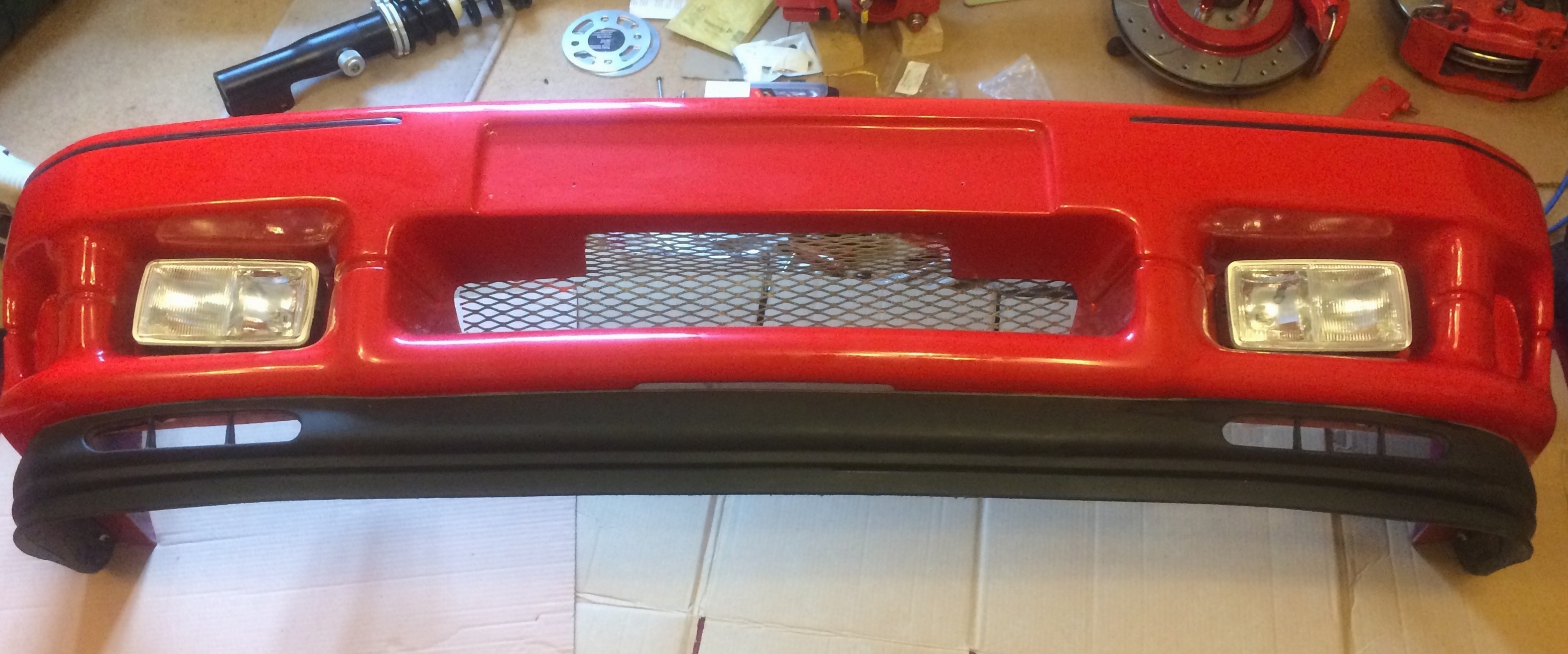

      and I'll just post this to show the lights I've fitted to the Bumper, there a Fog and driving light in one unit, as it dose get foggy where I am in Somerset. to control the front fog lights I'm using a front fog light switch from a Classic Range Rover, as it's the same style of switch as used in the Maestro

        they look very useful...are they easy to find?
        • #49
          Their PIAA ones, they do a few size of duel units, the size I’ve used are the same height but 5mm narrower than the Lucas one, last time I looked there were plenty on eBay
          • #50
            PIAA lights are fantastic pieces of kit, used to have some on my old rally car, tons more light output than the Cibies or Hella.
              cheers! I'll have a look, last search I did came up with Hella units that are oval and had mixed reviews, as well as a million dodgy looking led ones..
