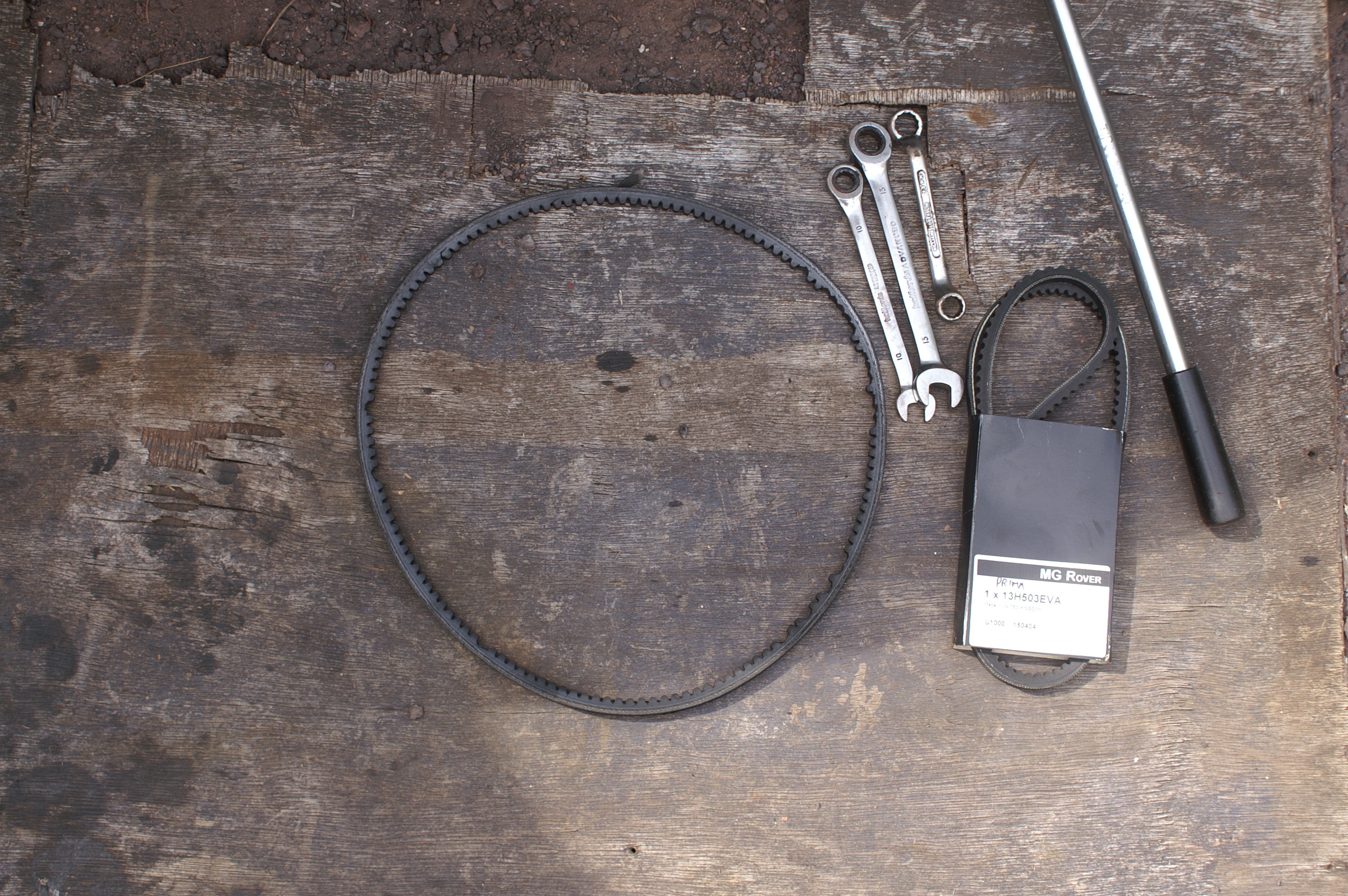

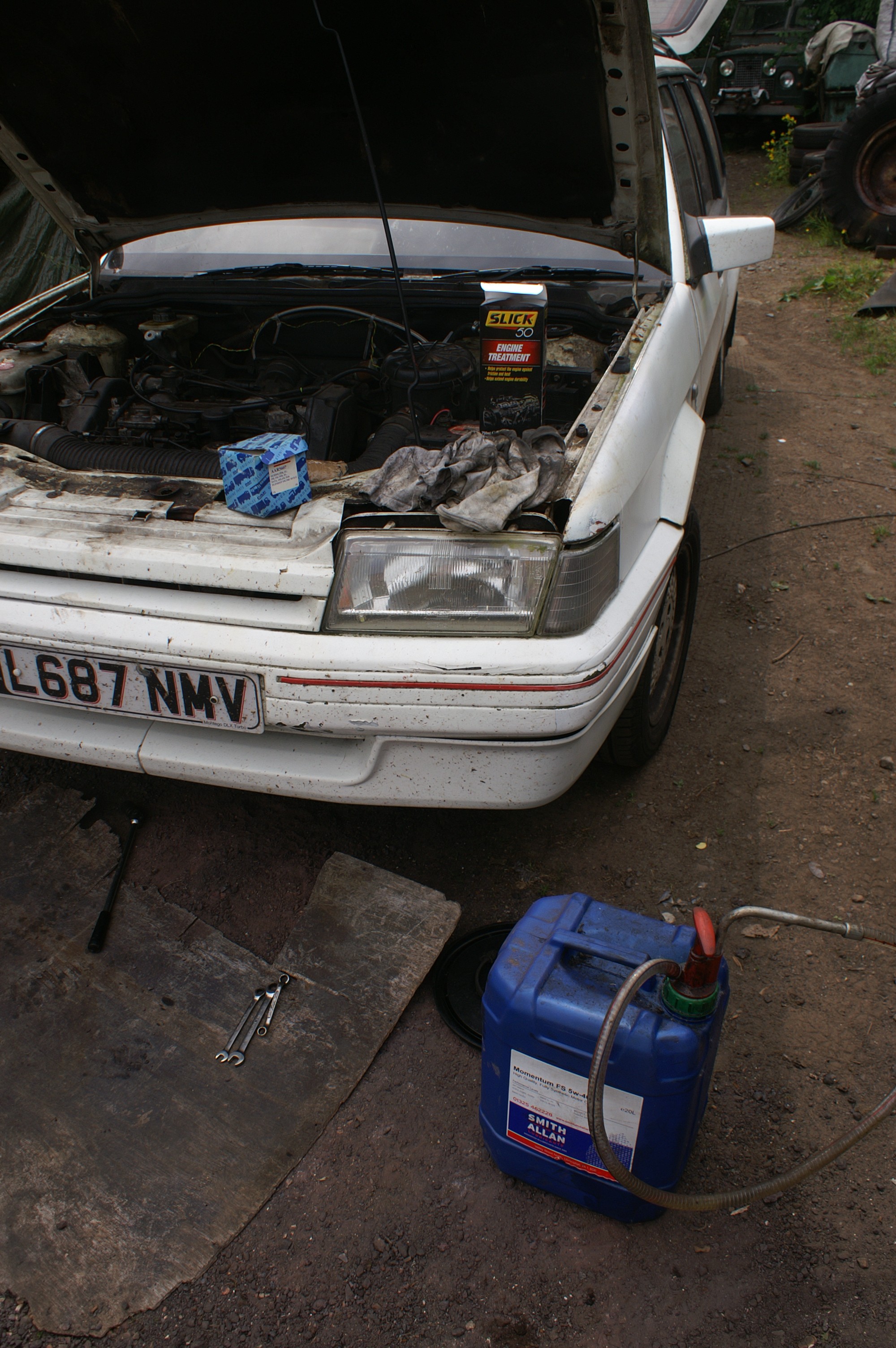

    Just done its 1,250,000 mile service, since it is run in now I treated it to some Slick 50 which my old SD1 seemed to like. Be interesting to see if it makes any difference in these days of modern oil. The fan belt looked a bit tired, so changed it, annoyingly I have several of the longer (bigger alternator pulley) belts, but this takes the shorter one, must restock!

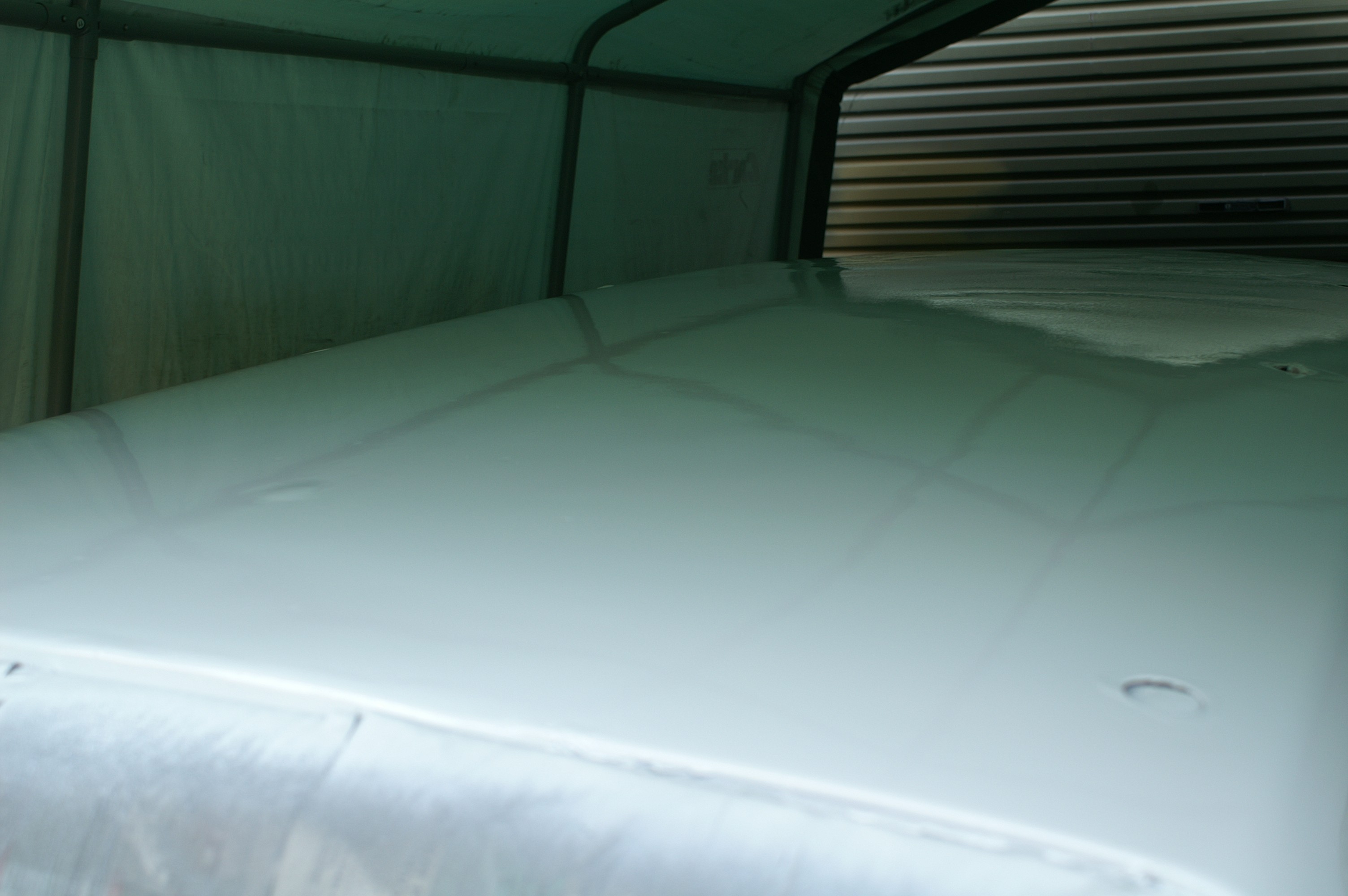

              Did a bit of welding in the roof/screen pillars, painted the roof, replaced the passenger front door and fitted a heated windscreen.... The heated windscreen was the same thickness as the one I took out, but must be thicker than the original. I had a genuine NOS seal and a set of genuine spacers which I got from XJ Rover, the only possible source these days! The seal was for a thinner screen & if I'd used the spacers without checking sizes and juggling the kits, the screen would not have been as flush as I'd like it to be. The L shaped spacers for the bottom of the screen are the most useful ones as they take the guesswork out of the gap at the top. Was worth the effort I think, now to wire it up.....

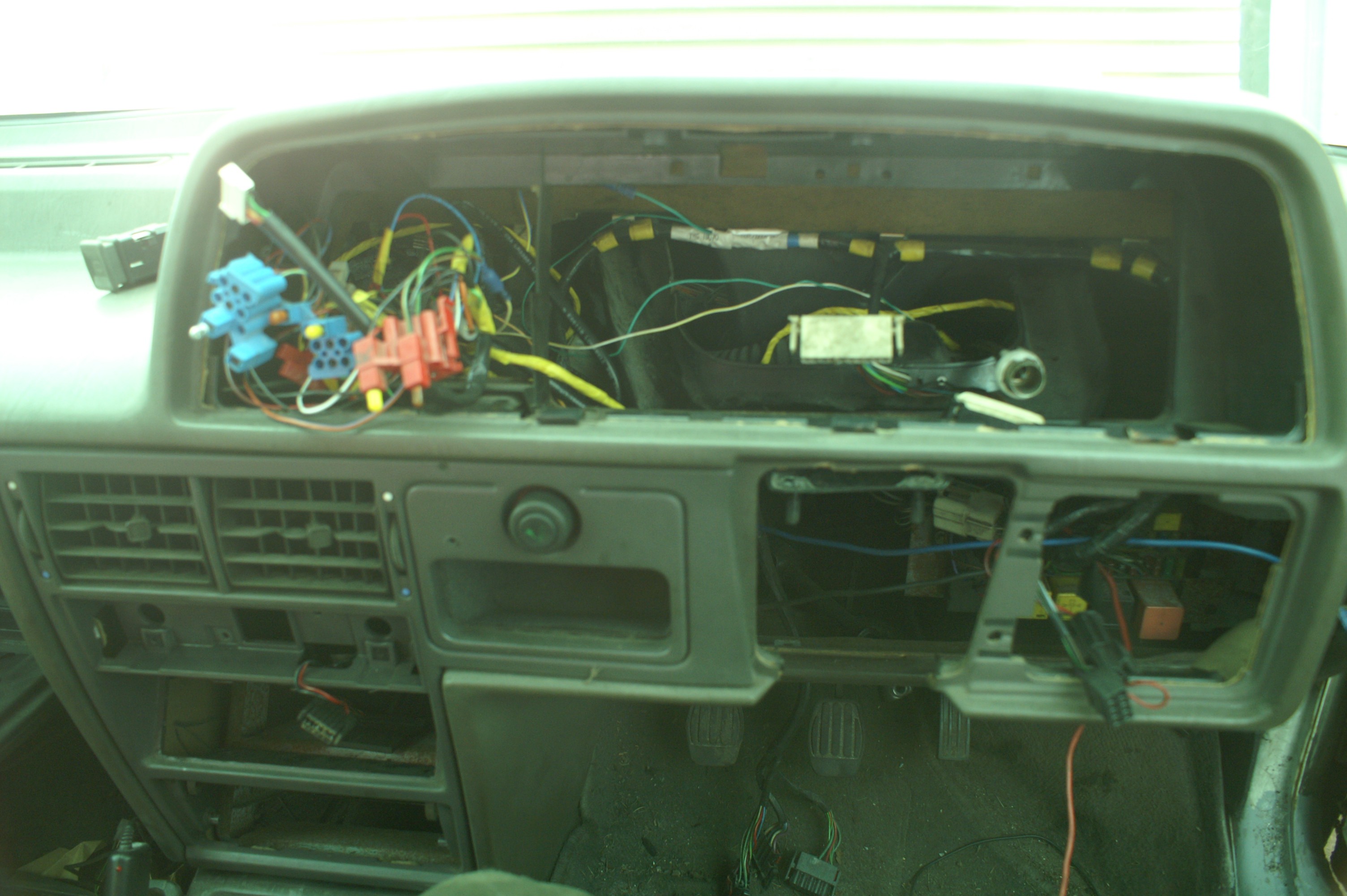

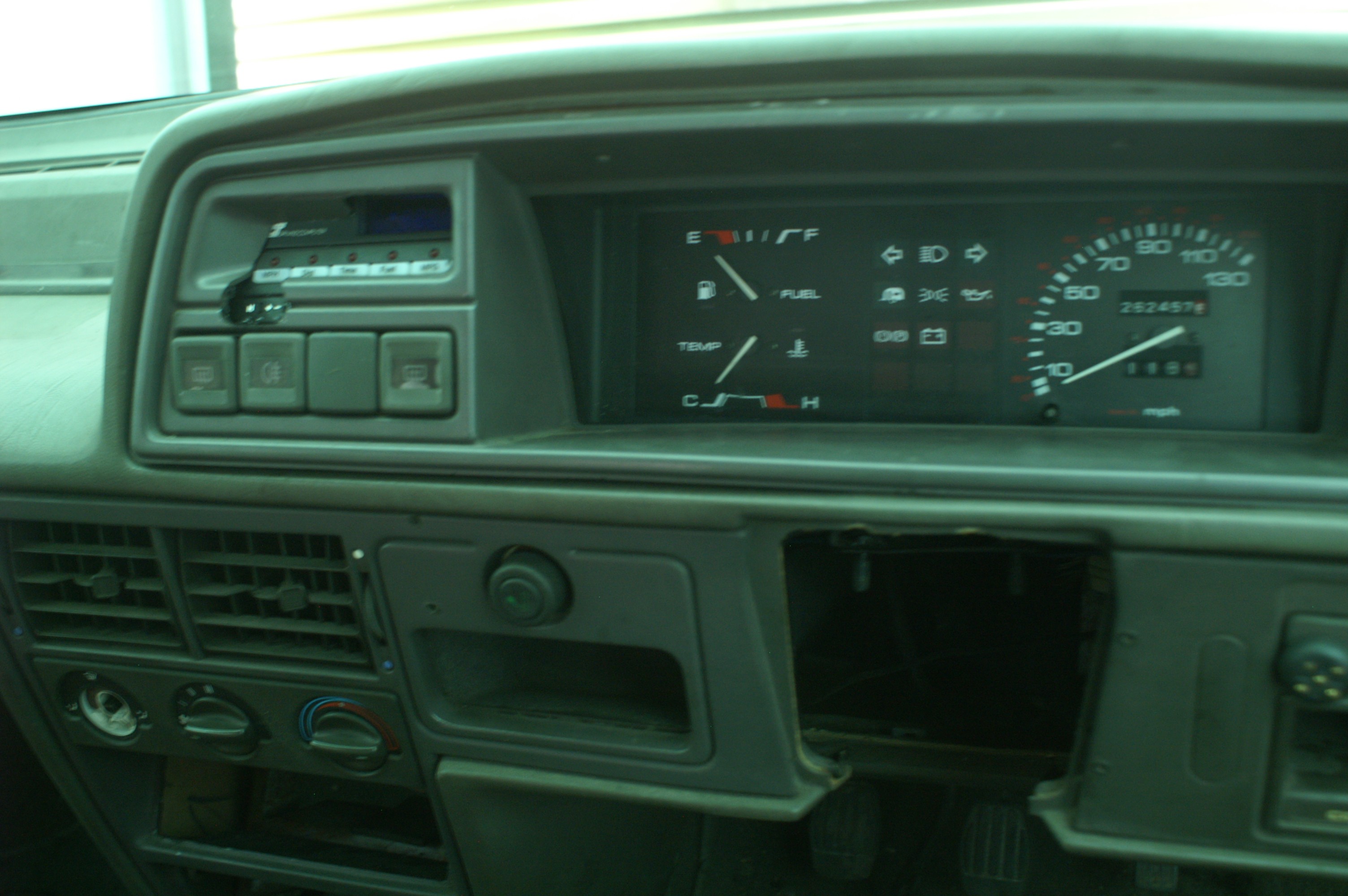

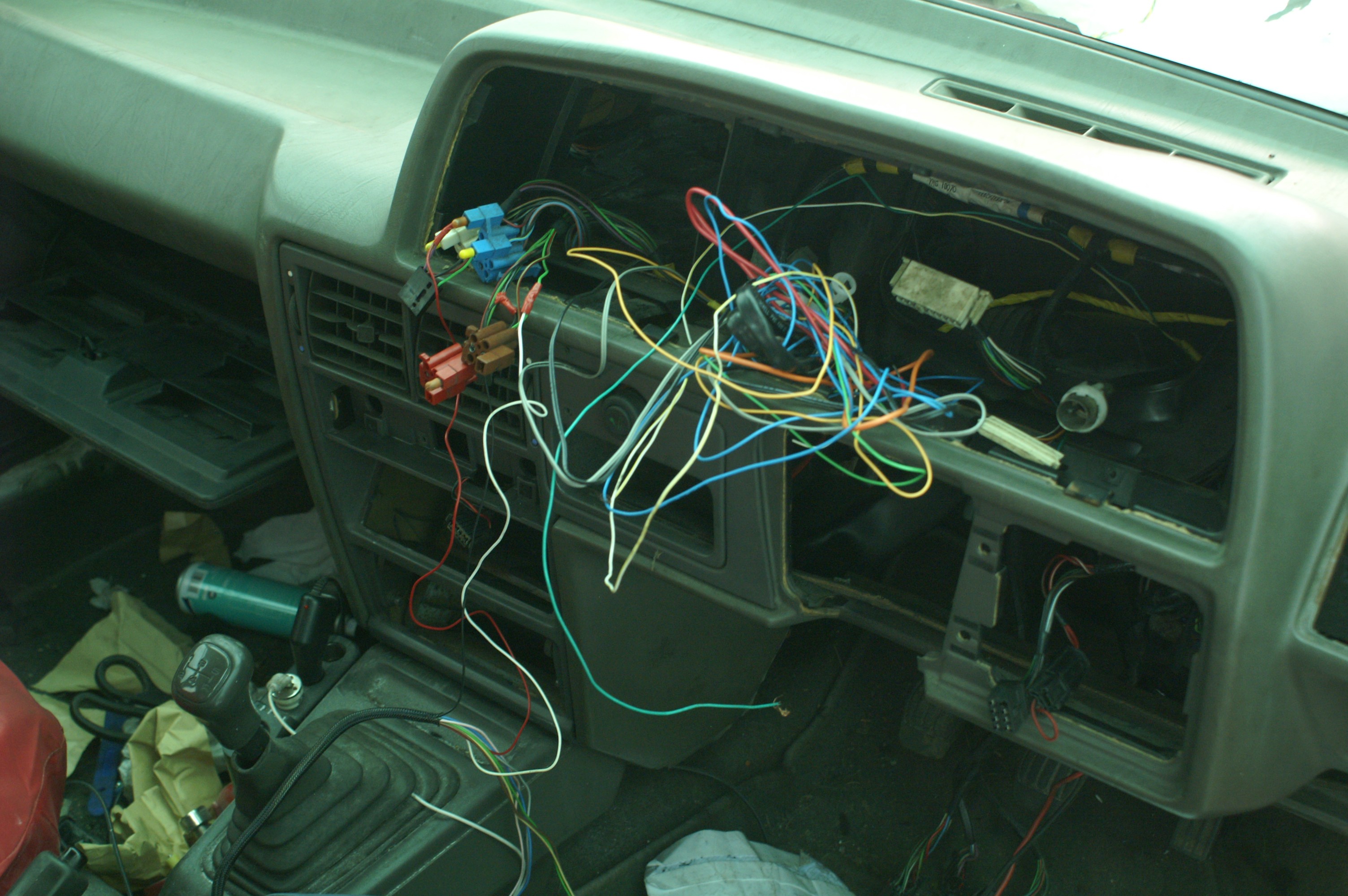

                    Got the switches for heated screen wired up. I took the heated rear screen buttons off some spare switches and fitted them to ones that latch in as I'm not using the timer relays. When I was doing this I noticed that the clear plastic covers for the illumination had melted and bits of them had fallen inside. I didn't worry about this, just chucked the bits out and carried on. I replaced the clock with a Zemtec fuel computer (which also has a clock function), this involved a bit of pruning with a die grinder. Having wired everything up and put dash back together I tested everything...all ok bar the passenger electric window and rear fog lamps. Window was easy, bad connection on door multiplug. Fog lamps were a bit harder, shorting connector to switch made them work, as did shorting the contacts inside the switch after I took it to bits. Didn't work when reassembled though, despite innards of switch looking ok. Eventually turned out that the clear plastic cover had fallen to bits & a sliver of it had got into the switch & stuck to the grease on the moving contact, I'd not seen this as it was transparent & shiny, annoying, but fixed now.

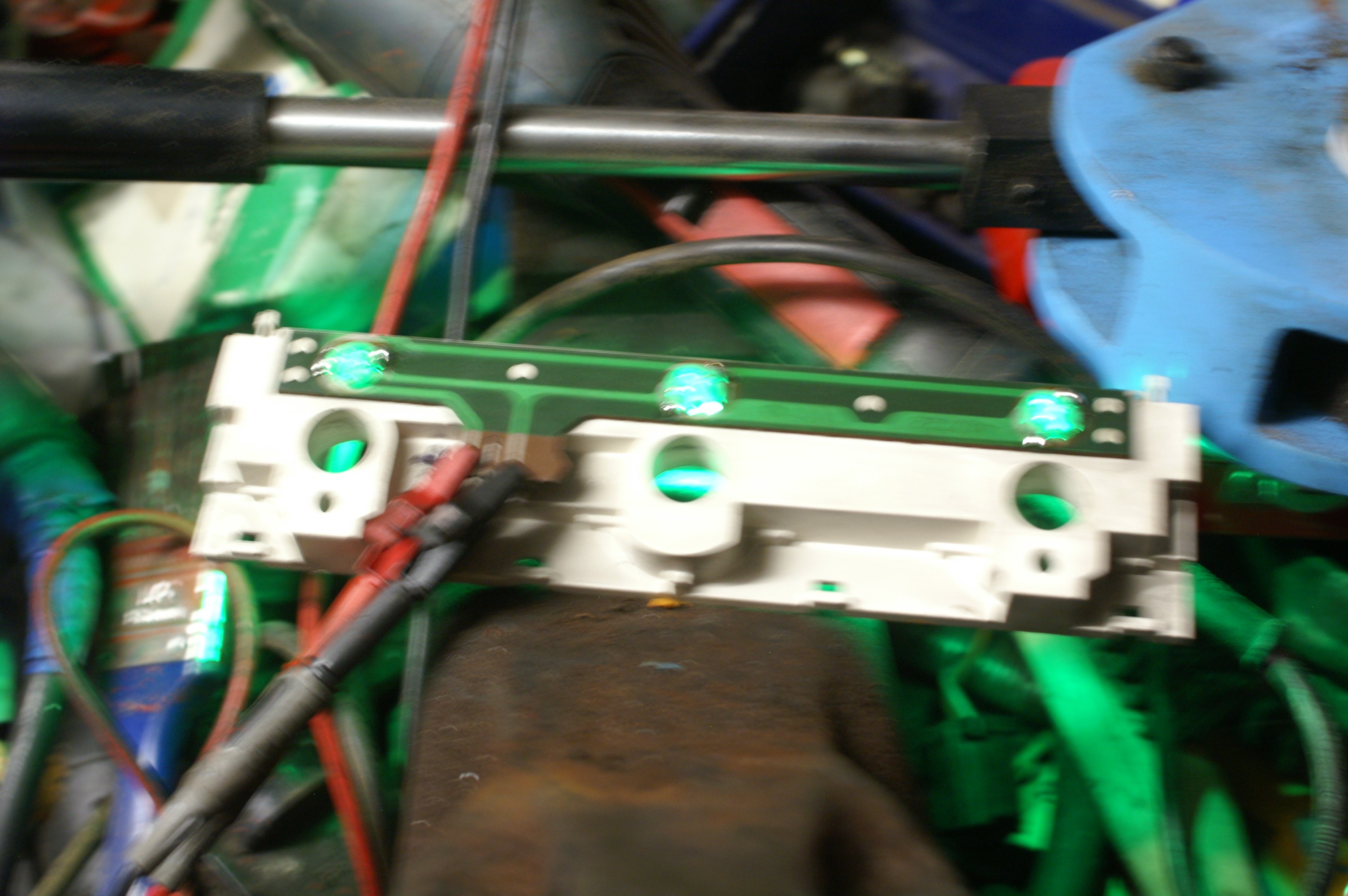

                      The heater illumination didn't work bar one bulb, so thought I'd fit led bulbs, which should last longer and run cooler. They were a bit small, so I had to solder them in, all 3 used less power than the single old bulb, 3 hundredths of an amp would take about 3 months to flatten the battery! The tailgate wires were a bit mashed, so I fitted a new rubber protector, not an easy task, even with the wires snipped off ready to solder back together. I guess they must have put the wires through the sleeve before putting connectors on in the factory, should last a good while anyway, even without the sleeve they'd lasted 9 years that I know of.

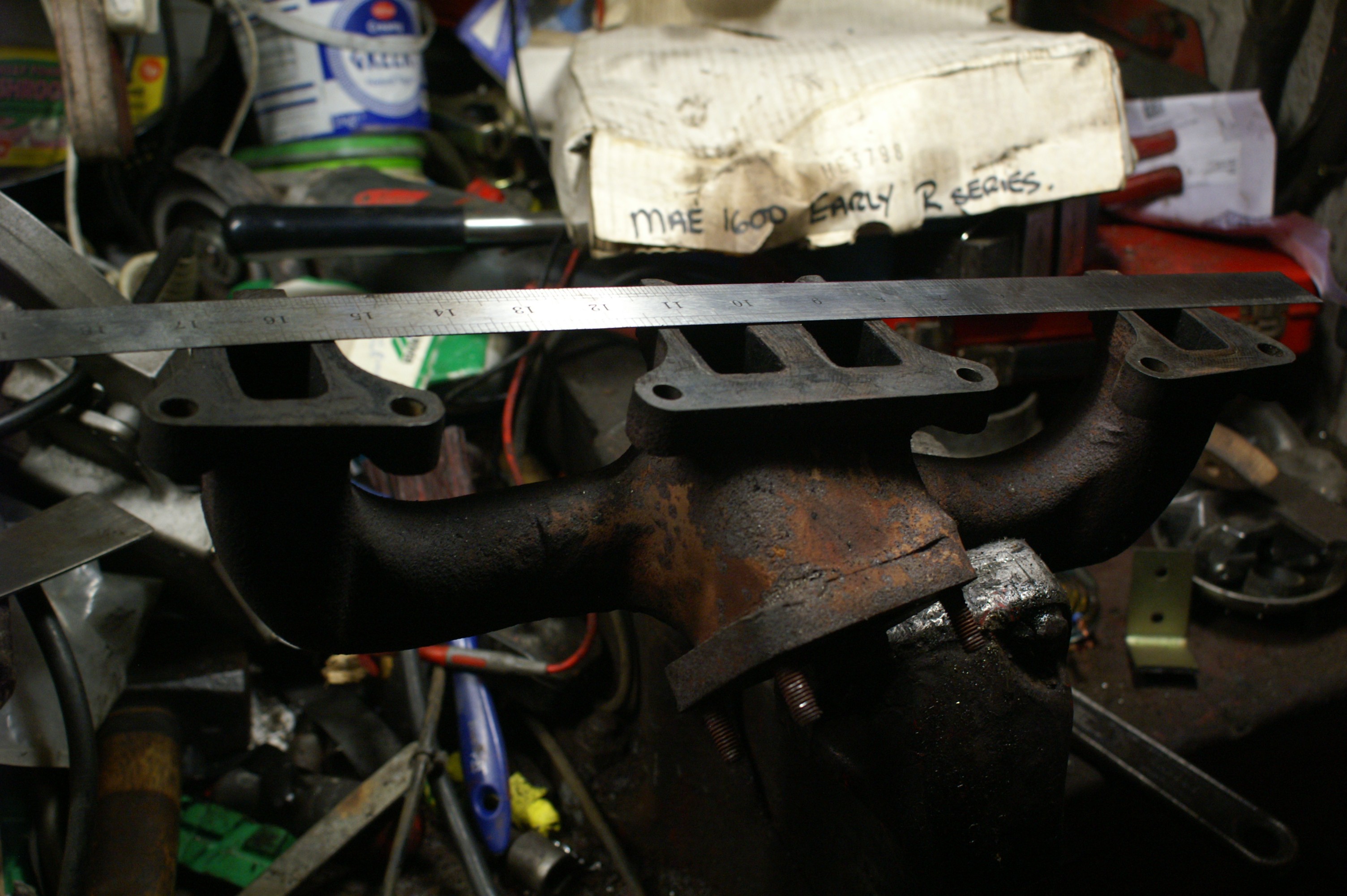

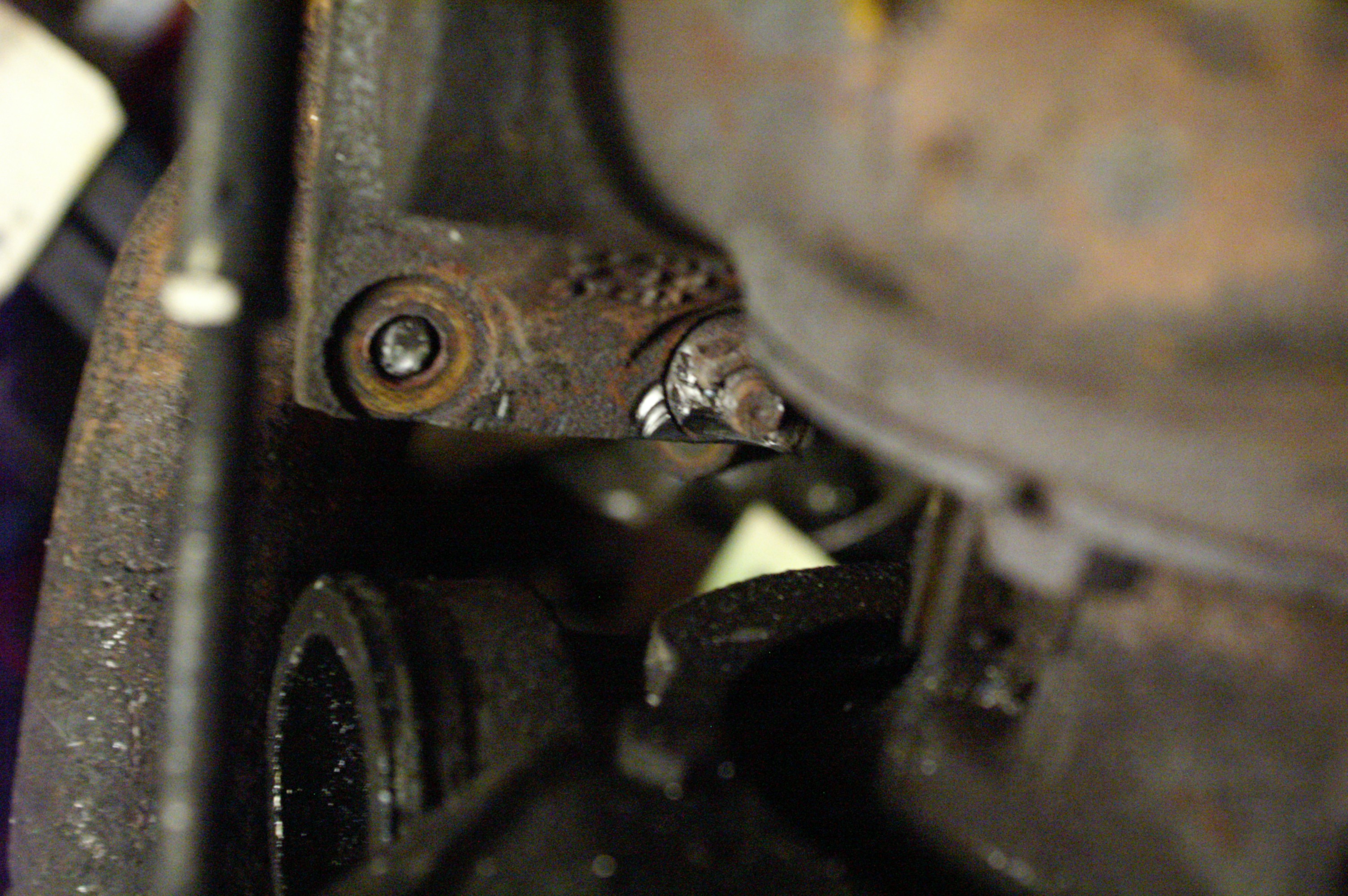

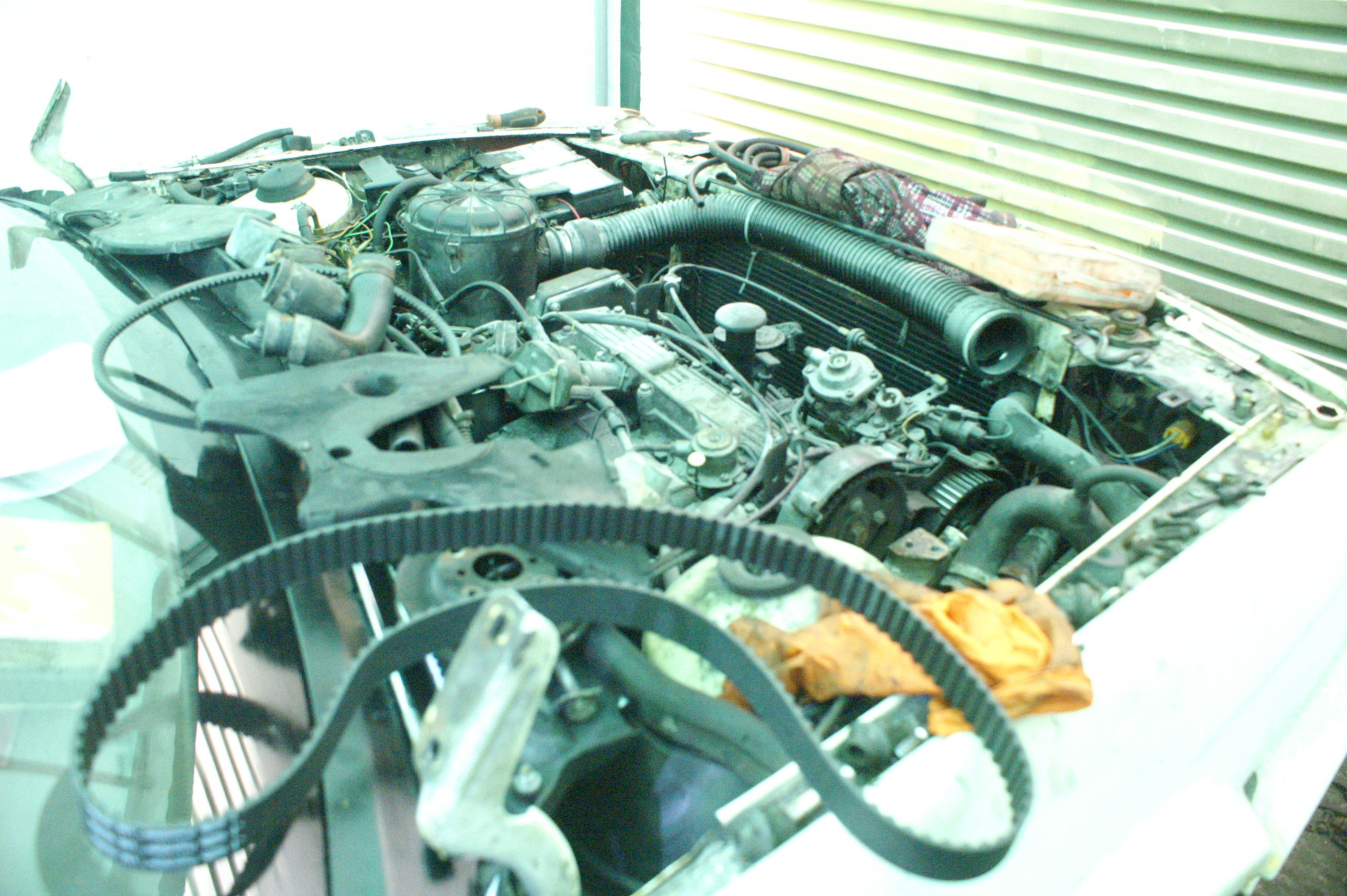

                              While the car was getting a bit of maintenance I thought I'd best change the timing belt, it has been on for 9 years / 42,000 miles. Recommended interval is 80,000 miles or 8 years, old belt didn't look bad, but there were tiny cracks on one side of the teeth, so glad I did it now, timing belt failure is not something I want to experience on a diesel... One of the former Perkins engineers that was at the NEC suggested that it had probably had a few turbos in its life, as far as I know it hasn't, so thought I'd best put a new one on 'just in case'. This seemingly simple task did not go entirely according to plan....induction heater, die grinder, sds drill and hammer and chisel were what I ended up using to get exhaust elbow off turbo and turbo off manifold, still snapped one stud, then noticed that manifold was a bit warped.....
