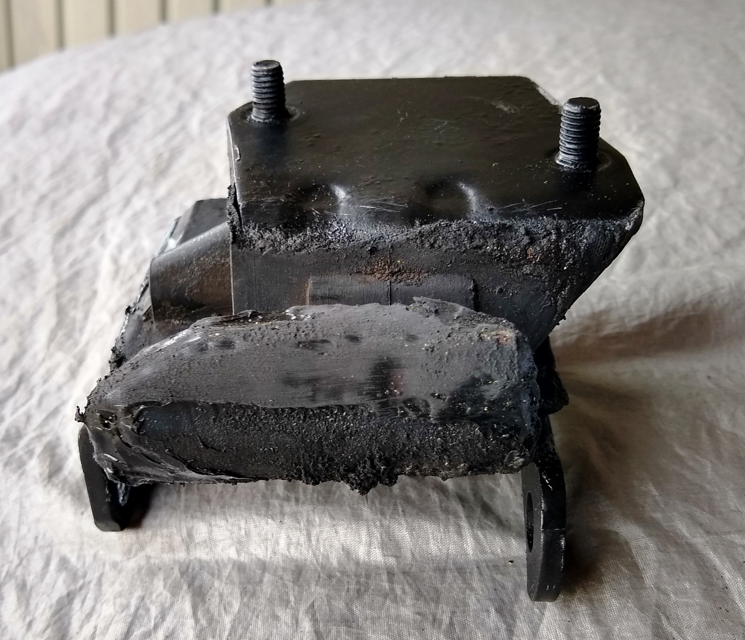

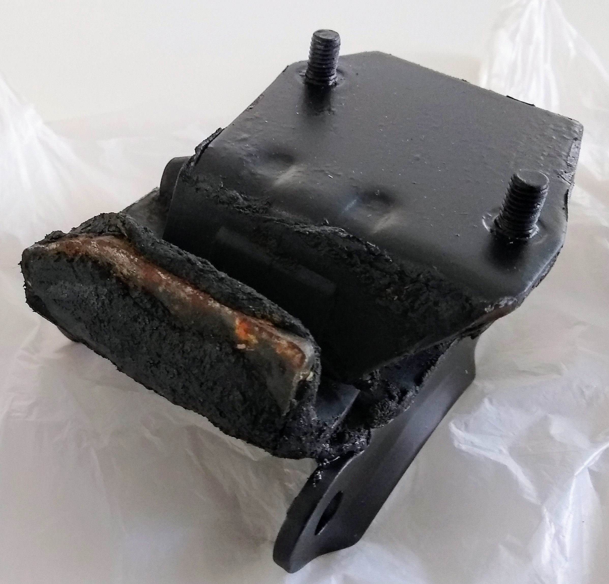

                After some 5 months of looking, I managed to find a decent 2nd hand one. Cleaned it up, added some Tiger Seal rubber to the rubber parts that were worn away, that super decent chap Ruben De Lauw fitted it and low and behold - vibration be gone !!

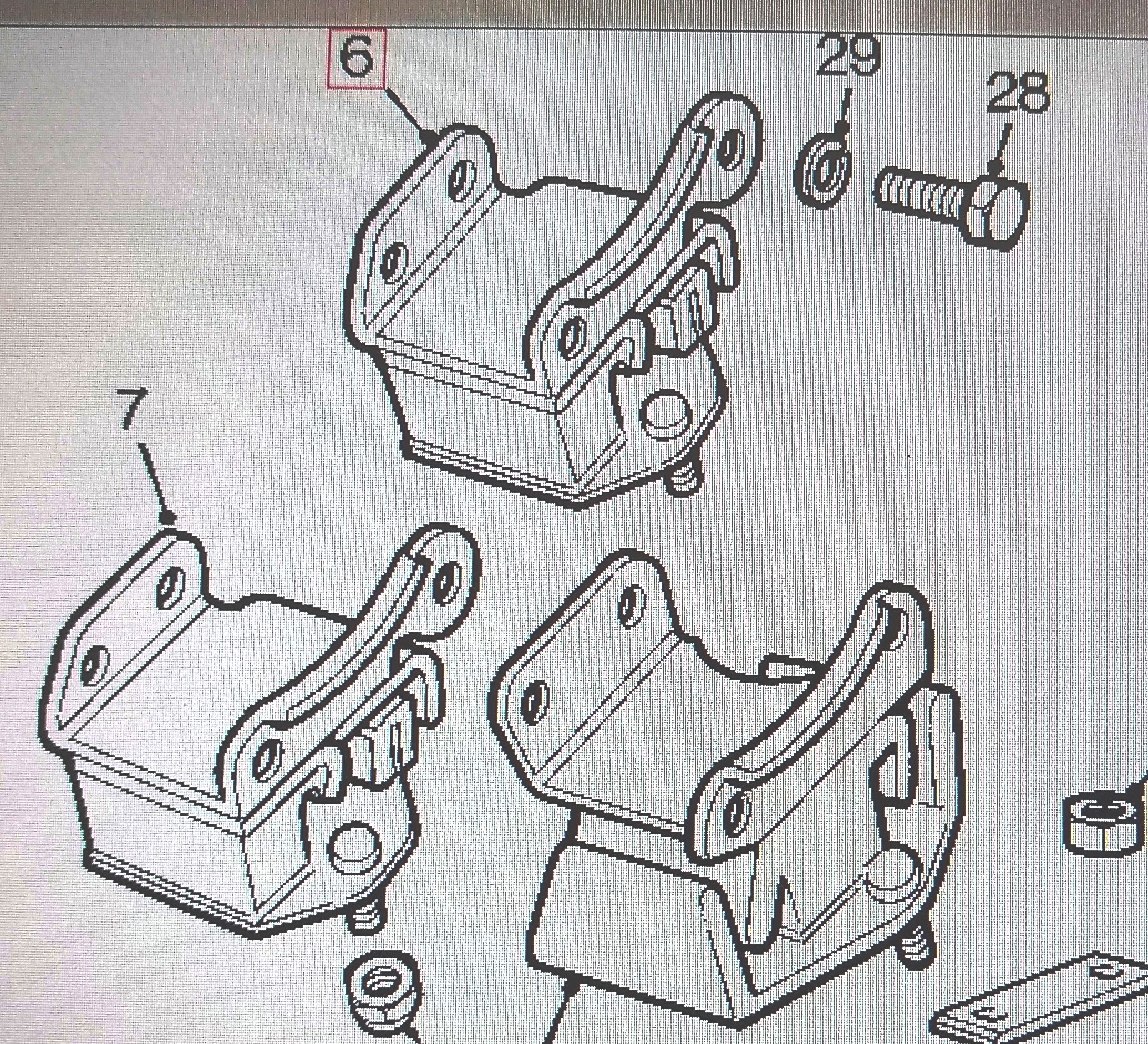

                Whilst making that search I discovered a couple of things. Firstly that one particular mounting (gearbox to sub-frame) does deteriorate and causes a metal sounding knocking noise. That means/meant that the part gets replaced and is the most difficult to find as they've mostly all been sold. What I also found is that there are 3 different types that fit the 2.0 engine/PG1 gearbox, all are in the 1991 AR parts catalogue BUT when you look up the part number you can only find CRC6445 I have to assume the other 2 were inferior and through typical AR practice the customer trial and error system weeded them out. See picture, CRC6445 is the bottom right one, my original one was the top left one.
                Glad I finally got to do it car's a real joy to drive now.
