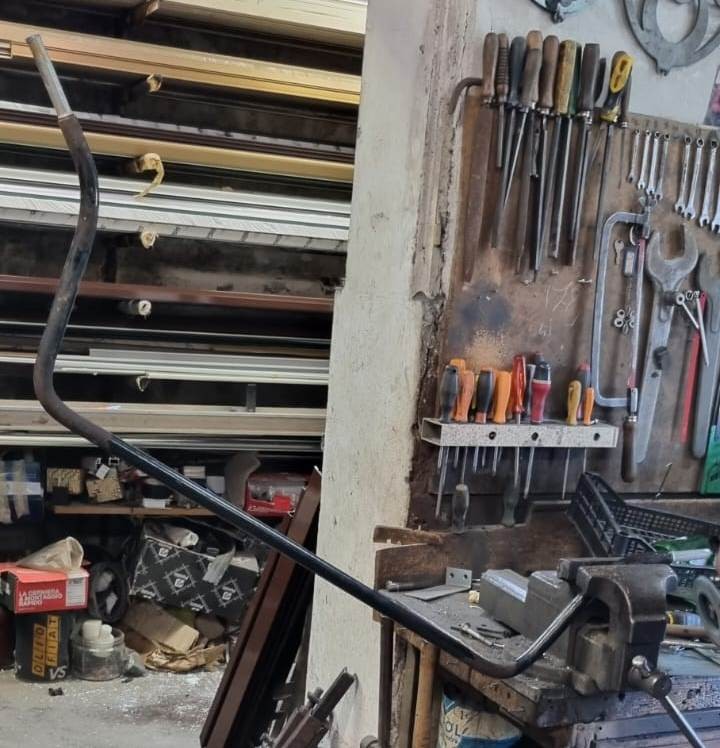

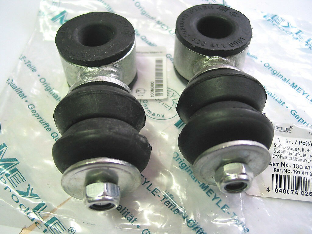

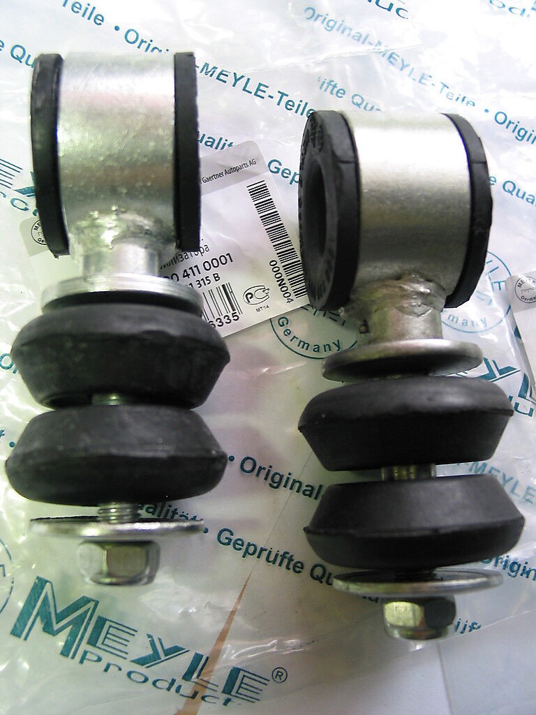

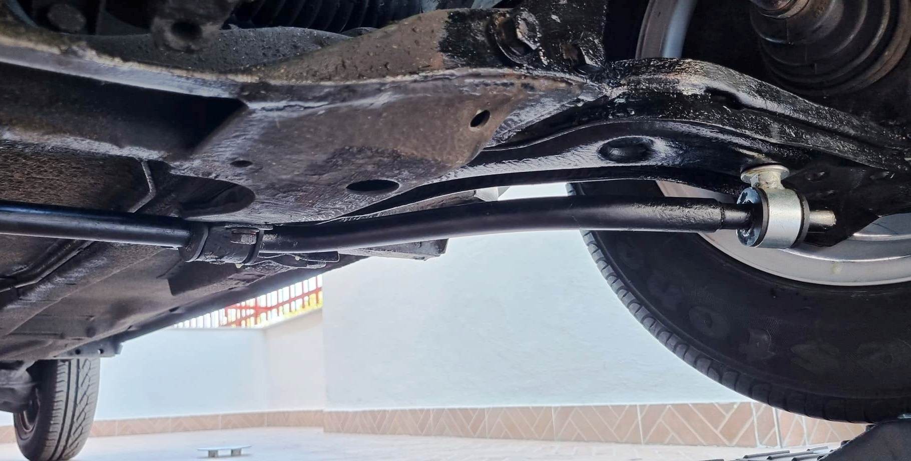

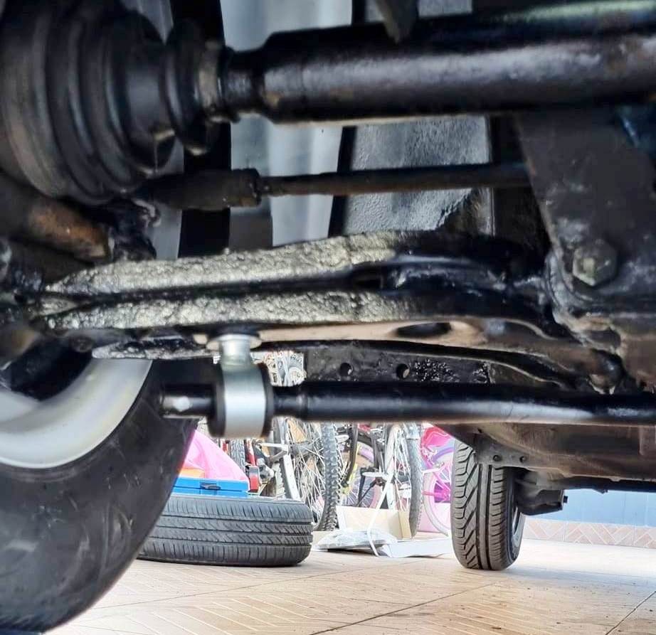

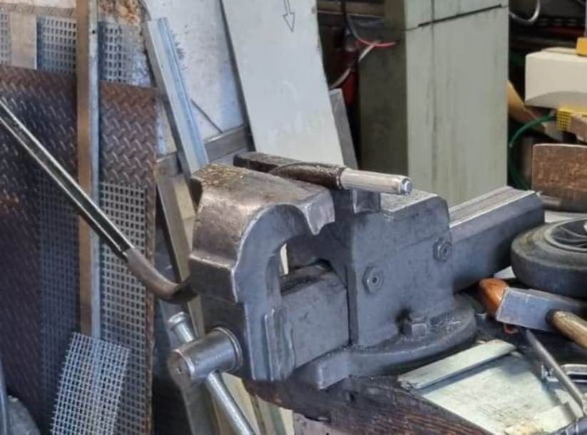

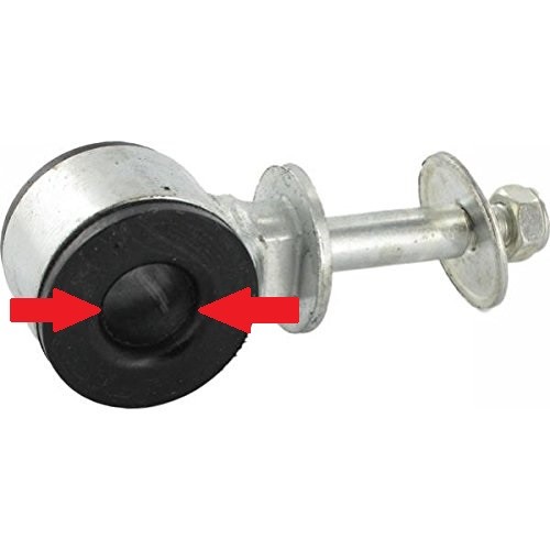

    Roberto Magno has a super 1.3HLE that he wanted to put a front anti roll bar on. I had a spare 2.0EFi roll bar, managed to track down a set of U clamps and sourced the 2 rubber bushes FAM4493 (still available at Rimmers and elsewhere). Of course the real challenge was going to be the drop links. I knew about the use of VW Golf Mk.II links that fit, also knowing that the inside diameter of the rubber bush was larger than the diameter of the bar. It does need to have a thin piece of tubing placed along the bar to make the drop fit properly (see photos).
    Roberto made the adaptation by putting a short length of tube on the end of the anti-roll bar (see photos). He did a great job. Roberto used a pair of Meyle Golf II links.
    So no need to scour the internet trying to source those hen’s teeth OEM parts, the Golf links can be found almost everywhere for about £15.00 or less..

      George, I'll assume you'll only need to purchase the drop links, I got hold of a pair of Meyle VW Golf II for Roberto. You'll need to measure the inside diameter of the drop link you buy (there are 4 or 5 manufacturers selling them) the VW part number is: 191 411 315 A, the Meyle nr is : 1004110005/S
      then find suitable tubing.

        dimensions are on here https://maestro.org.uk/forums/forum/...solved-i-think and a few more pictures. The sleeve is about the same size as old 1/2" copper pipe iirc
