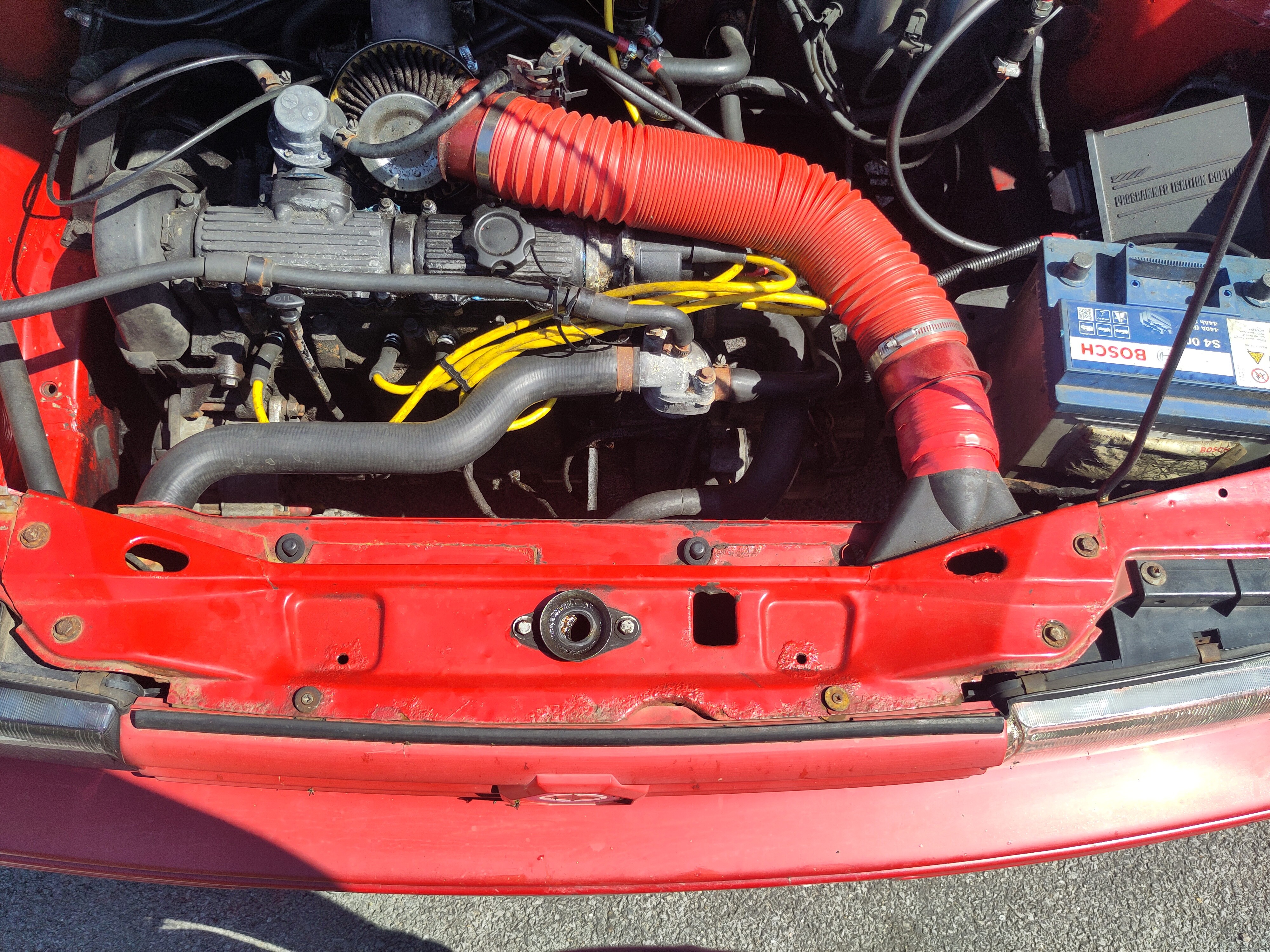

                    Here is a photo of the engine which is on my car at the moment I noticed that the oil filler cap is not on the rocker cover
                        revised breather + unleaded compatible = filler cap on rocker cover.

                            Why haven't the engine on Ebay got oil filler on the rocker cover?
                              Because it has the original type of breather system, not the modified one fitted to the unleaded fuel engines. It does sound as though it might be a better bet than trying to fix your old one though, unless you can find a later one, I think the Rover 216 engines were the unleaded version, but they aren't that common now either.
