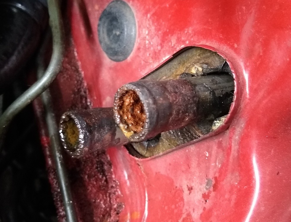

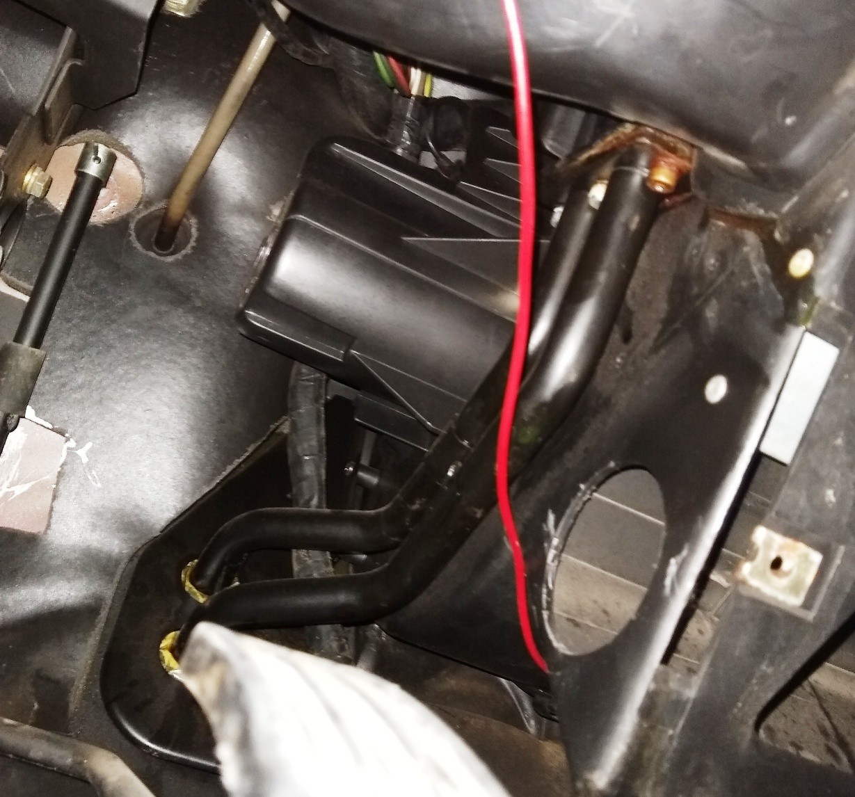

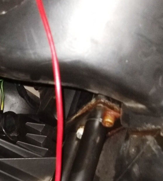

                      Just to let everyone know that these pesky pipes are still alive and leaking !! 4 days ago just returning from the weekly blast and saw foot well awash with greenish water. So as quick as a cat whipped mats, carpet and underfelt out. There was some damp on the outside where heater pipes stick out. Out with the front seats, off with the 2 radiator hoses and will wiggle myself under the the dash (my LHD car) to undo the pipes, they're in good nick but the joint with matrix is brown/rust. Got me some new wire hose clips, new gasket/flange from Rimmers on its way to me and a 90 silicone connector to connect the 2 rad hoses if it turns out to be a bigger job. Oh Happy Days!! Click image for larger version  Name:	IMG_20200629_162751034.jpg Views:	0 Size:	67.8 KB ID:	330936 Click image for larger version  Name:	IMG_20200629_170136715.jpg Views:	0 Size:	187.5 KB ID:	330937 Click image for larger version  Name:	IMG_20200629_162635317.jpg Views:	0 Size:	323.0 KB ID:	330938

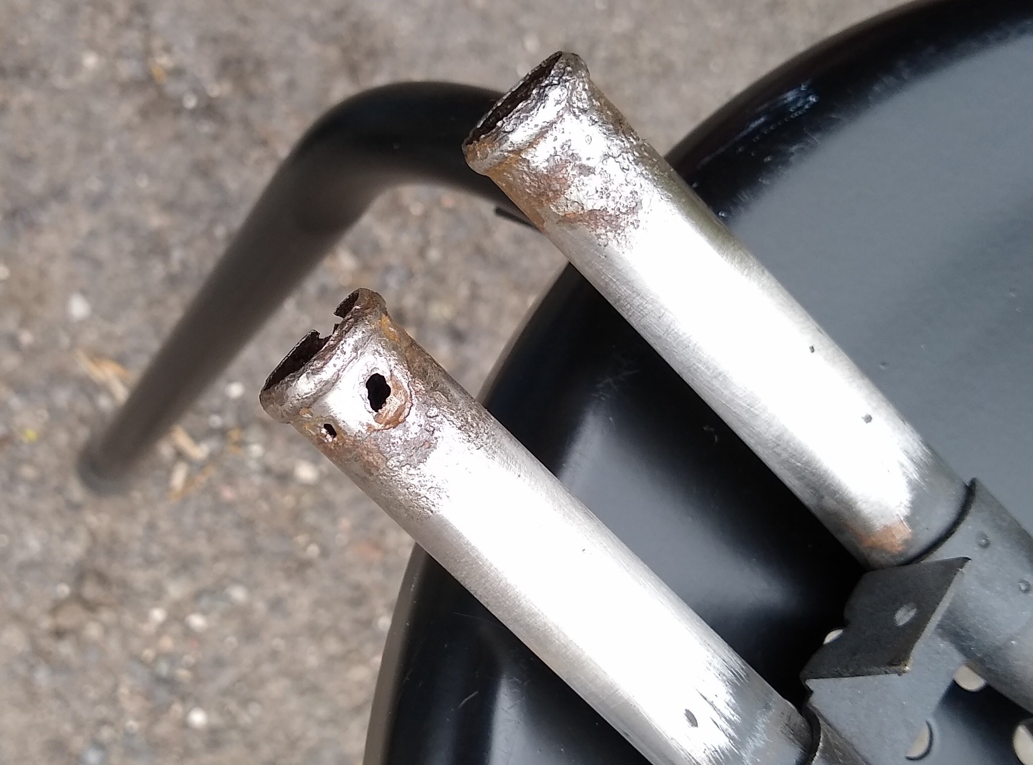

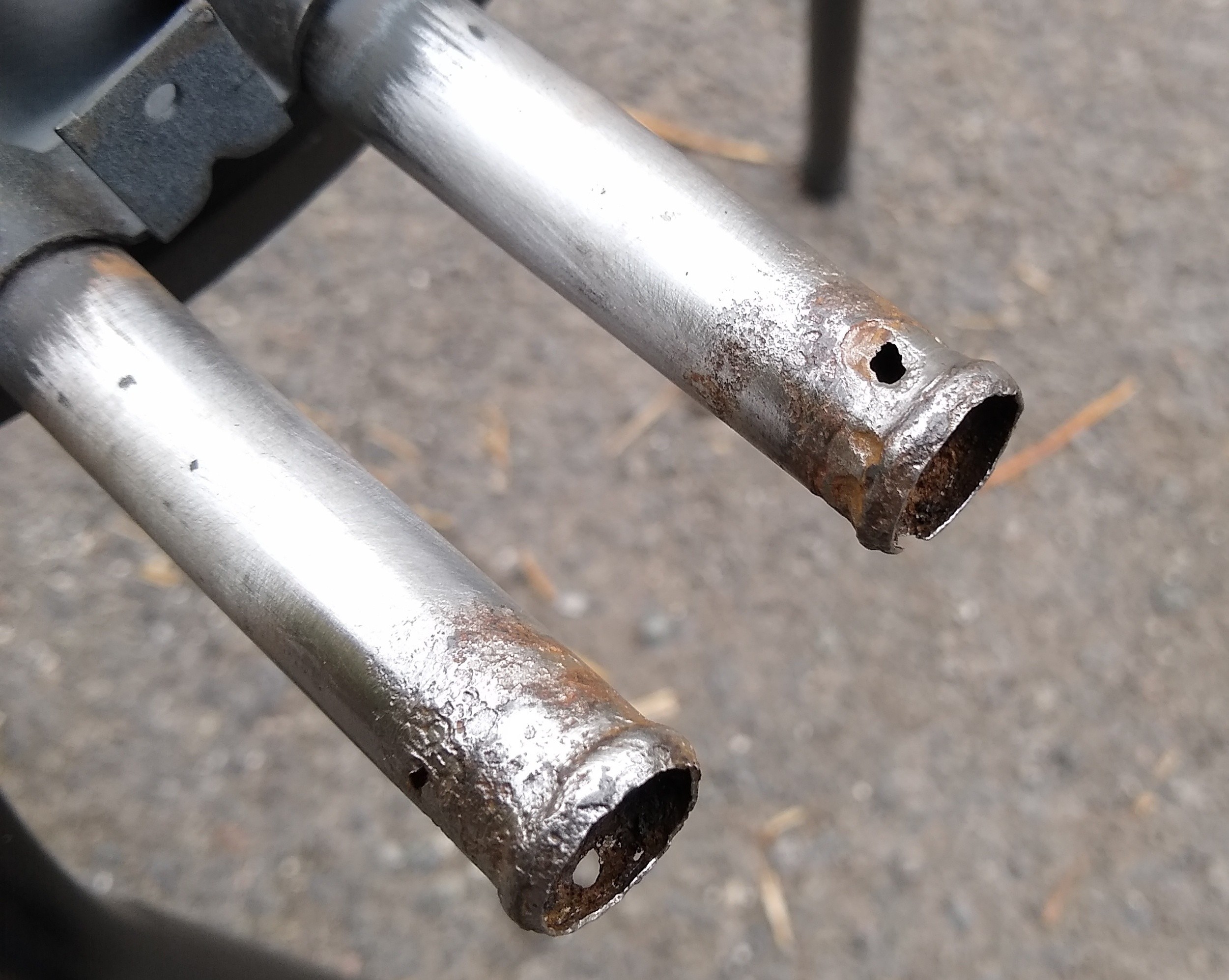

                        Took my pipes off and gave them a clean up...........hey-ho !! Rubbish bin for these meethinks and try and find a replacement. Click image for larger version
Name:	Stripped down heater pipes (7).jpg
ID:	331441 Click image for larger version
Name:	Stripped down heater pipes (2).jpg
ID:	331442 Click image for larger version
Name:	Stripped down heater pipes (3).jpg
                          Can you use liquid metal on those to plug the holes?
                          1958 Ford Consul Convertible, now being used
                          1965 Ford Zodiac Executive. now being used
                          1984 MG Montego EFi in black. Digital dash, putting back together
                          2004 MGZT V8. Back on the road. now being used
                            That's a good question, the previous owner had done that, when I started stripping of the paint I could see that they had done that. I believe I've found a set of new/old ones so may be OK.
