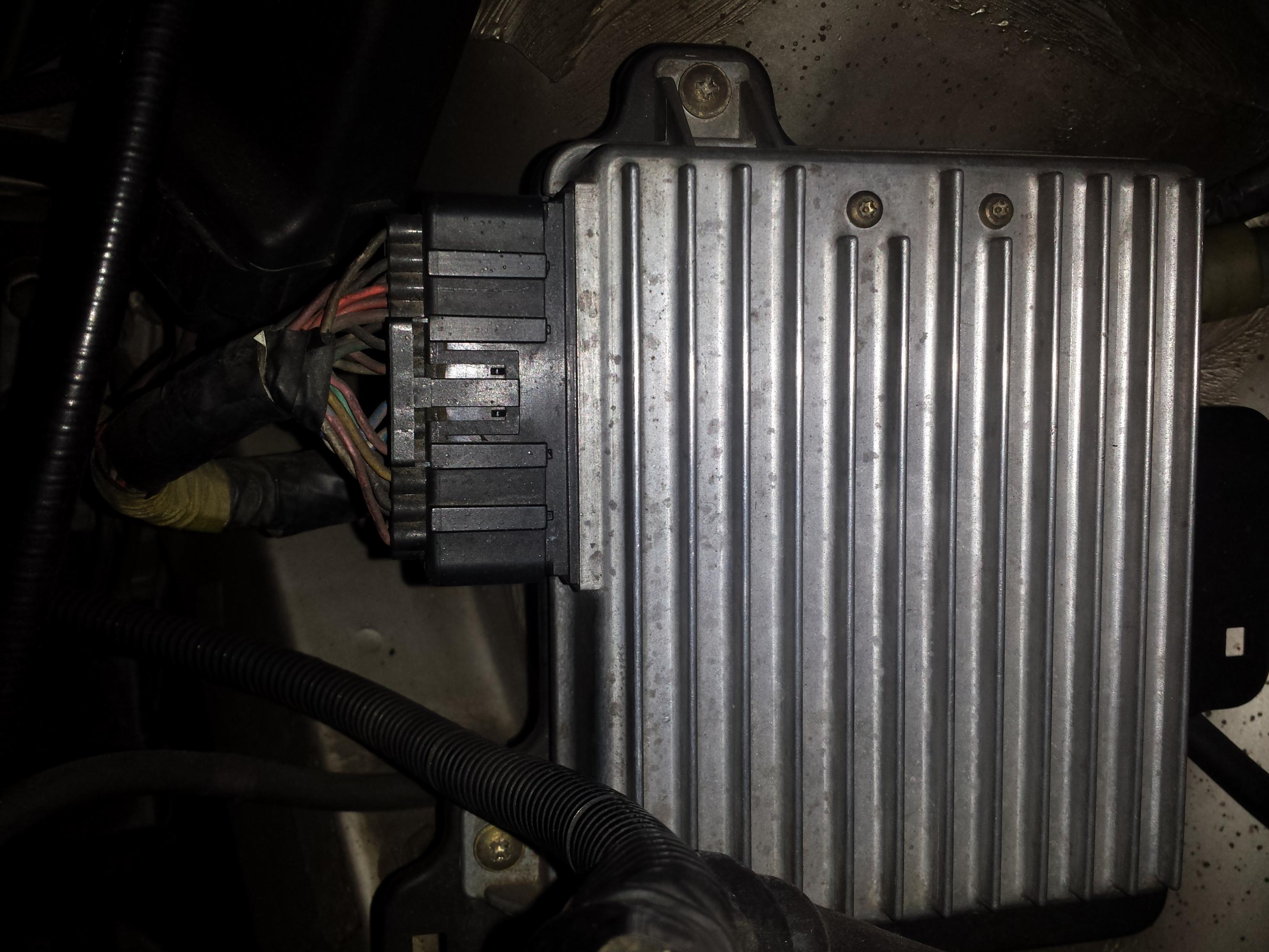

                      Do you have a black ecu box or silver? If black you need a Lucas diagnostic Programmed Ignition Analyser. YWB133. That covers the coil, crank sensor, knock sensor and temperature sensor. There is a Fuel management Fast Check, SMD 4049 for carb models, that covers throttle sensor, coolant sensor, air temperature sensor, stepper motor, coil and solenoid. This unit covers the 1.6s series engine, Rover 1.6, Montego 2.0 and Turbo models and Rover SD1 2000/2300/2600 engines.
                        These units are for a Montego/Maestro etc with a Lucas black ignition ecu
                          Thank you Jeff,
                          My ECU (MEQ 10060) Is silver, it has a 3 conector, I reckon that I need a microcheck but I don't know if it is better buy a microcheck (it cost a 250 euros) o to buy a new carburettor with manual choke ( it cost 400 euros) and I forget MEMS.
                          Now I have changed ECU for a new a it seems that car starts better.
                          Thank you very much.

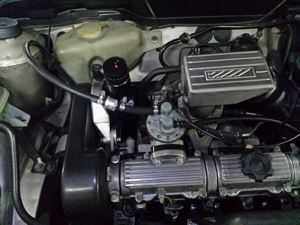

                            First, then I have changed the ECU, car started better, but now it has the same problem. It ocurrs only when car it is stop for a day. The mechanic installed a non-return valve before the fuel pump, but it doensīt solve the problem.
                            Have you got any idea?. Thanks a lot for your help
                            Montego 1.6 SL 1989
                            Golf V 1.9 TDI 2004
                              Might be worth trying one of these http://www.gunson.co.uk/product/G4074 it will not tell you exactly what is wrong, but will tell you whether it is lack of fuel causing the problem, when engine is cold it should burn with very yellow flame, if you see spark & traces of blue flame then there is not enough petrol, if you see spark and no flame, there is no petrol at all......colourtunes often turn up on ebay quite cheap, can save a lot of time in diagnosis as you can actually see what is happening...
