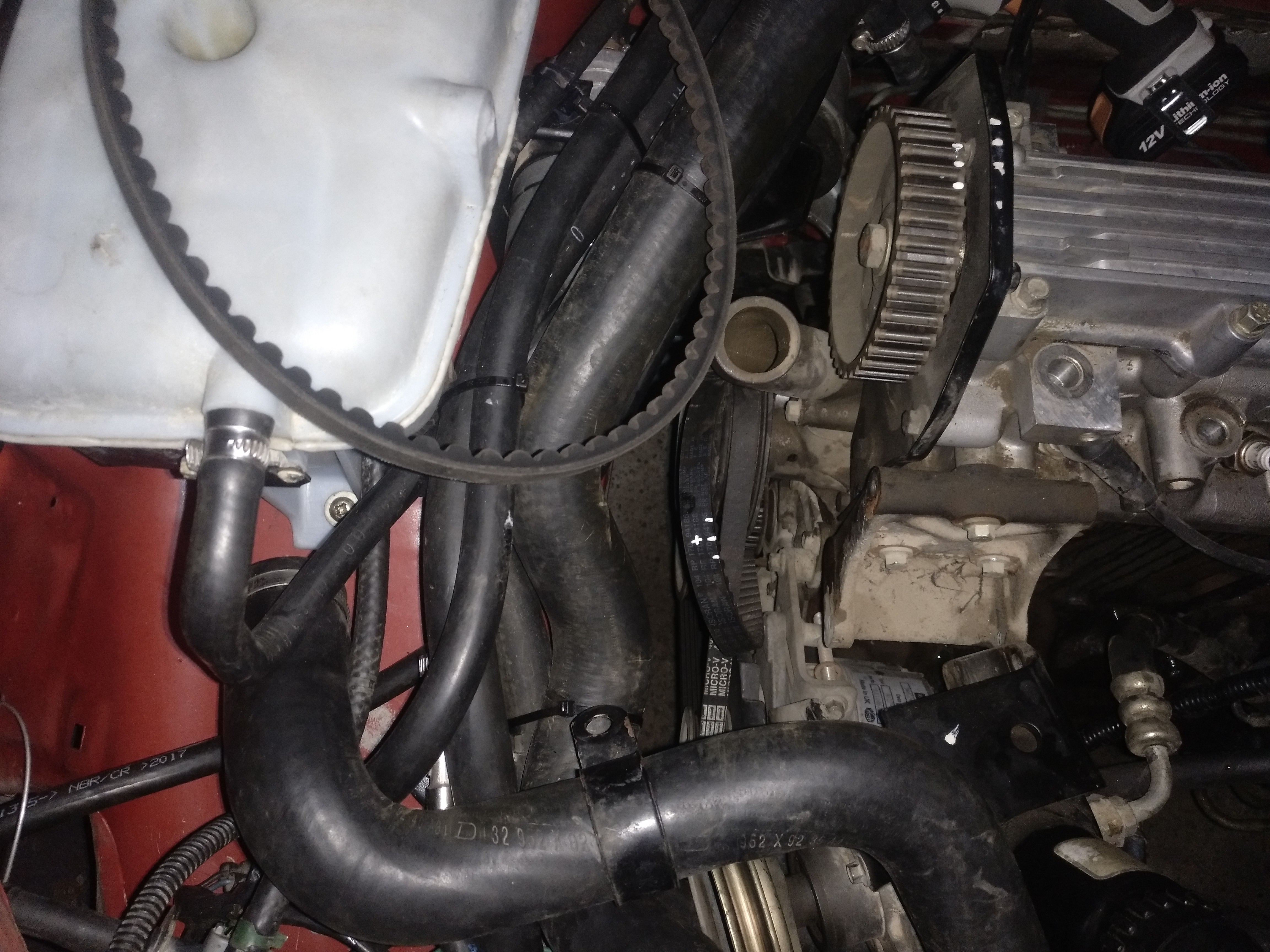

If you have water stains there, it's either the thermostat housing leaking at the joint with the head, water leaking out from the headgasket so check the water ways in the head, or rear water pipe can cause that . If oil stains then leaking headgasketOriginally posted by Juanmacandel View PostI have disassembled the collectors since I split the bolt, also observe a small stain came from the head gasket, is this possible? Or are they simply stains from the old drain of the collectors?1958 Ford Consul Convertible. I love this car
Whats stopping it from coming off is probably the 2 metal dowels that centralize the head to the block. If you push the head back and forth or hit the head with a soft hammer it should loosen the dowels. Also check the bottom bolts on the inner cam cover plate. (The black metal plate) as one might bolt into the engine block. You do not need to remove the cam cover. You also have not timed the crank and cam pulley before you removed the cambelt. The 2 dots on the cam pulley should line up with the hole at the top of the inner cam cover plate and the crank pulley has a small cut out that should line up with the pointer from the engine block so I hope have marked the crank pulley aswellLast edited by Jeff Turbo; 8th June 2018, 12:09.1958 Ford Consul Convertible. I love this car
