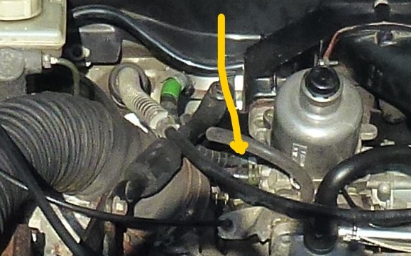

                1. All Turbo models should have the mixture adjustment screw shouldn't they? The mix isn’t just adjusted by the fuel ecu and cold temperature sensor is it? You should be able to adjust the mixture by the carburettor as well shouldn't you?
                2. As per attached picture showing the bypass connection pipe. Should fuel pass through the bypass connection pipe?

                  All HIF carbs for maestros and montegos and metros had a mixture screw at the same point, the fuel ecu has nothing to do with that.
                  Bypass pipe shouldn't have fuel in it
                  Carb Pipe's. Fuel in pipe is the centre inlet, nearest the front is the vent valve, plenum is other to the fuel pressure regulator
                  Fuel ecu and temp sensor control the cold start and continued running, stepper motor is controlled by both
                  Before the mixture screw is adjusted the carb needs to be set up for cold start etc so it's a simple process after that, you can't just adjust the mixture properly if the cold start hasn't been set up first
                  Your mechanic will need to remove the carb to remove the cap to the adjustment screw, once removed the cold start set up can be done before the plenum is re attached

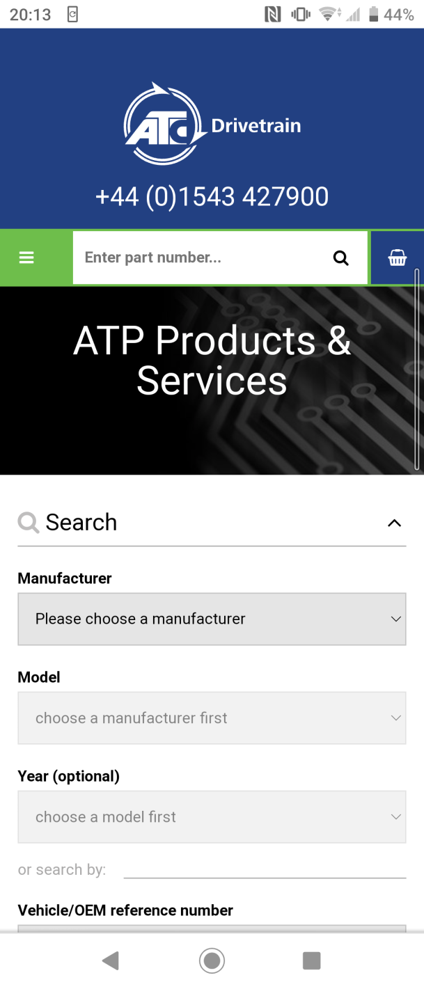

                      That sounds very much like faulty fuel ecus. If nothing is work that ecu doesn't work at all and from the sou d of it your replacement is also faulty. By all means change the coolant sensor as that's an easy thing to do. You can send off a faulty ecu to have it repaired but I can't remember which company repairs them
                      • #26
                        Found it, try these, part number adu8499
