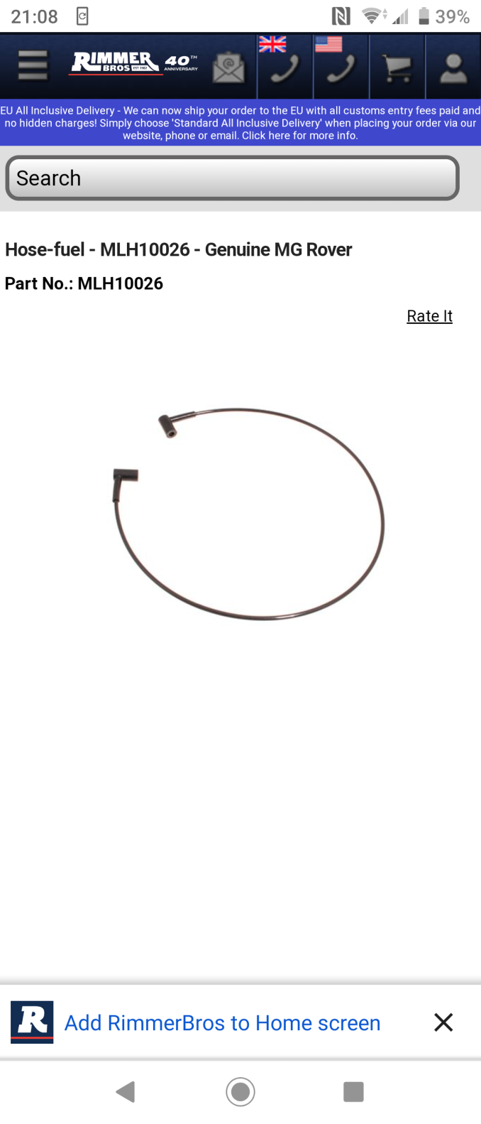

ID:	335623 I have an 1987MG Montego Turbo and i am in the process of trying to sort out various running issues with my car.
    1. I am looking at vacuum pipes;-Can anyone advise where i could get the correct replacements ,correct size and what should i be looking for. In particular its the one that runs between the ecu and fuel trap. As shown above. As well as this i am also interested in the 90 degree connector originally but i take it these are no longer available .Any ideas welcome.
    2. The same goes for breather pipes to the carburettor again welcome advice on where to obtain and what i need.
    3. I intend to also replace the cold temperature sensor. Am i correct in think that what i require here is a Lucas SNB101.
    Thanks
    Nice to see you back Glyn. Coolant sensor should be SNB151 from memory and is available in various ebay sites or you local car spares maybe able to supply. Check first to see if the same as some are advertised as the same but are different. Breather pipes are available from your local car spares. Are the pipes from the fuel trap damaged or is it just the elbows? These pipes for minis should do the fuel trap, has elbows but I'm not sure of the length so check first

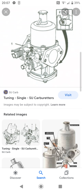

                          Finally got the carb back and it was fitted to the car today but that's when the fun began. I just require some confirmation that my conclusions are correct. I am correct in thinking that there should be a mixture control screw on the left had side of the carb just below the fuel pipe?(ie the opposite side of the stepper motor). Once the carb was fitted the mechanic tried to get the car up and running but couldn't find the mixture control screw. It appears from what he said that it just a blank hole?He couldn't find the the mixture control screw and said he was looking at the area i had said.??????
                            As you look at the carb. On the left side about 10 o'clock there is an inset near the bottom under the fuel in pipe It's in there and can be tricky to see if you're not used to it
                              It's here Glyn
