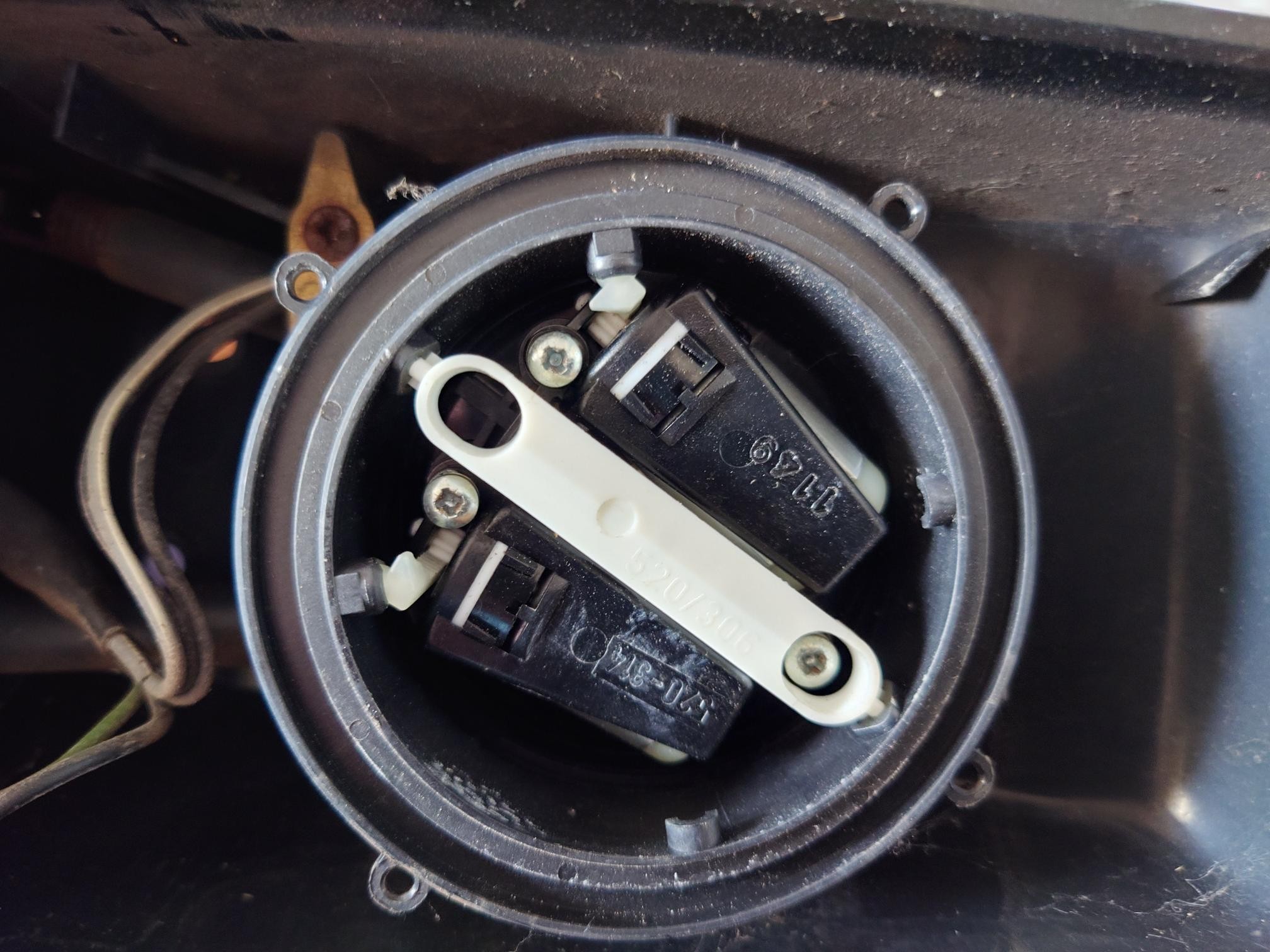

                  I can't remove the glass to check connections behind as I can't move it to extreme positions to access the clips. However, I have removed the entire driver's mirror and the cables here look fine. One of the retaining nuts was too short though so I'll change that.

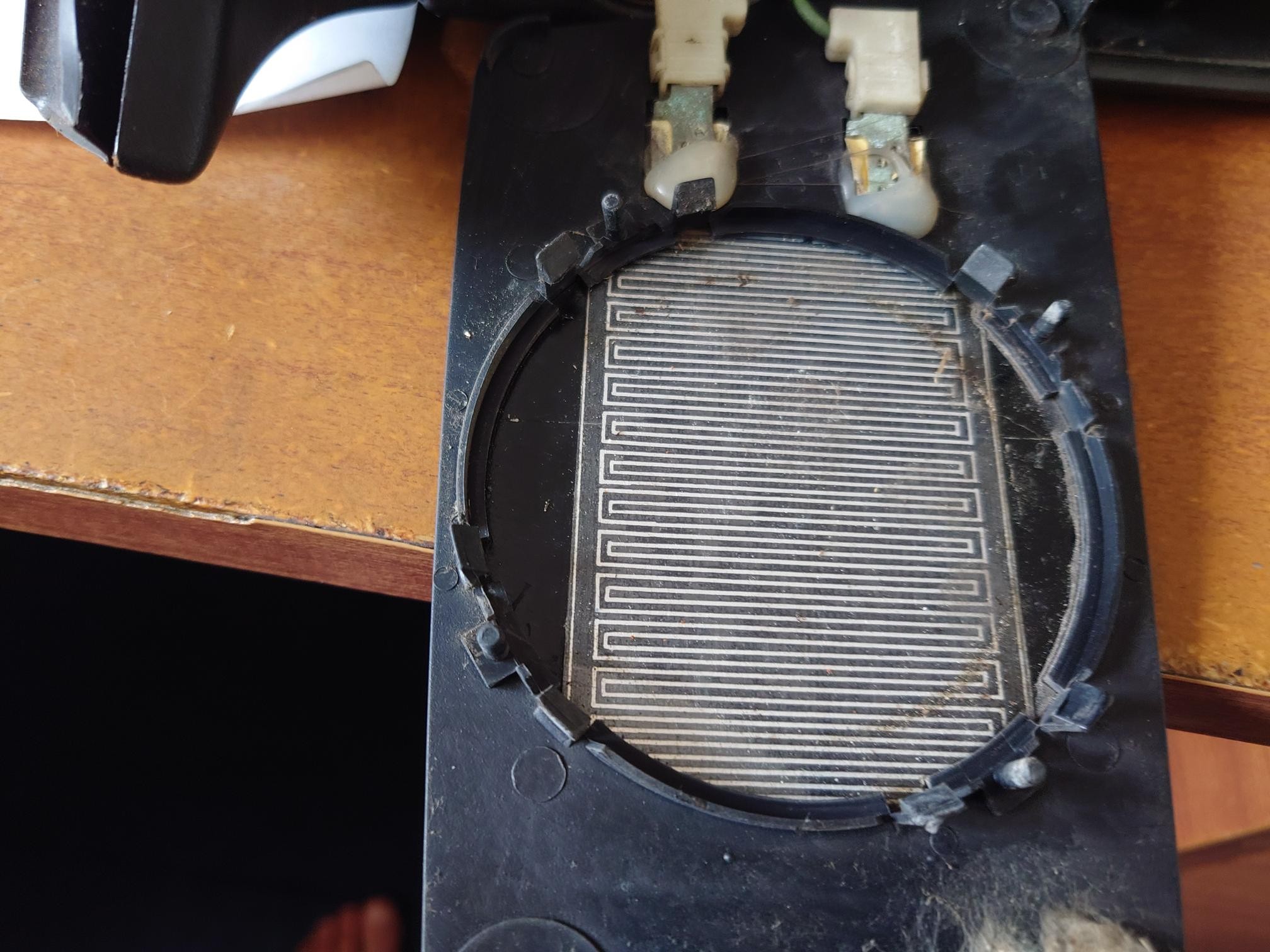

                    Sounds as though you've had a busy day! If you still have the driver's side mirror off it may be worth checking that there is 12v at the green wire on the heating element, it is fed from fuse f6, which also feeds the switch, if there is no power there then it could be a problem with main feed to the switch.

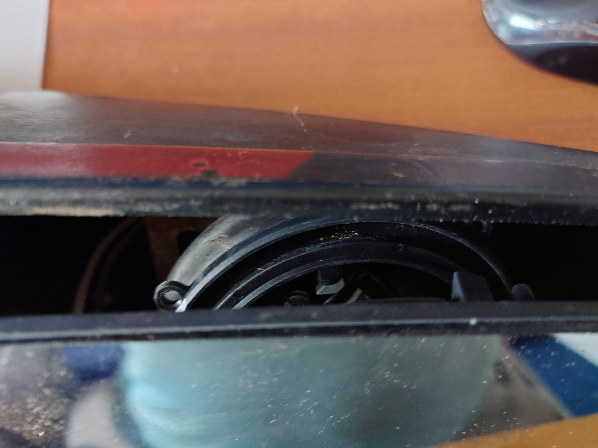

                      To remove the mirrors part themselves can be tricky as they're held in by 4 plastic lugs it is advisable to remove the whole mirror unit from the door to do this.
                      You should be able to push in the mirror to the very top and you'll see two of the four lugs. you'll need to lever out the lugs with a small screwdriver then pull the mirror gently out a bit. Then you should see the bottom lugs, again lever those out and the mirror should release. 5 times out of ten though you might crack the mirror so before trying that do as the good doctor suggests and test for power to the connection in the door. If both motors are not working it's not those but either the switch or wiring

                        As per this, to fix back in you push in at the top lugs positions until they click then the bottom. I did this earlier twice to test it as I haven't done this for awhile so I know it works and didn't break anything but don't force it

                            .....and also, the situation ain't helped by the fact the driver's side mirror glass has broken in the past and an aftermarket glass has been stuck over it. So, I won't touch the glass for now, just focus on the switch itself and power to it
                              ......as Johnny says, think this is the key to it all - "If you still have the driver's side mirror off it may be worth checking that there is 12v at the green wire on the heating element, it is fed from fuse f6, which also feeds the switch, if there is no power there then it could be a problem with main feed to the switch."
