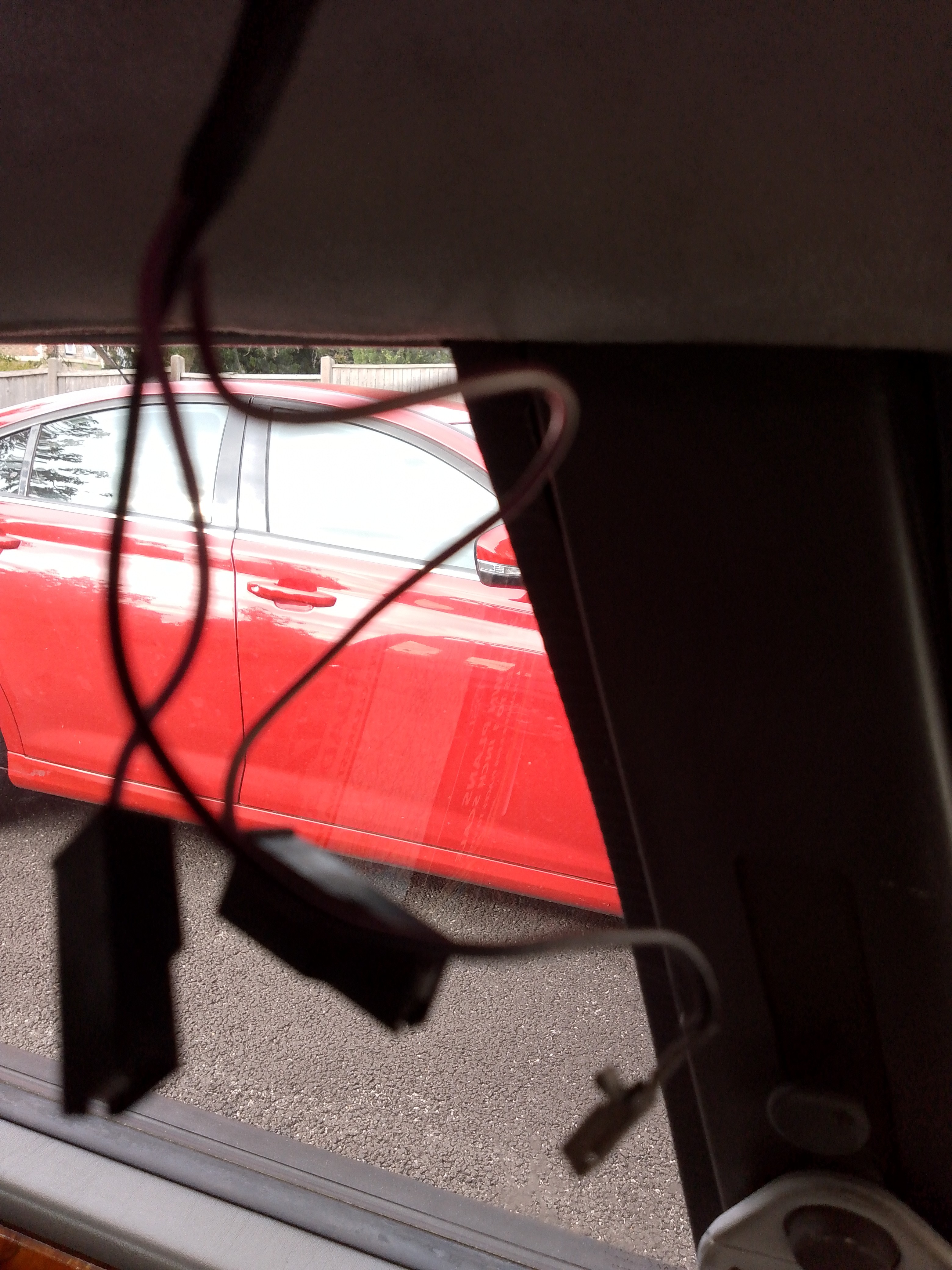

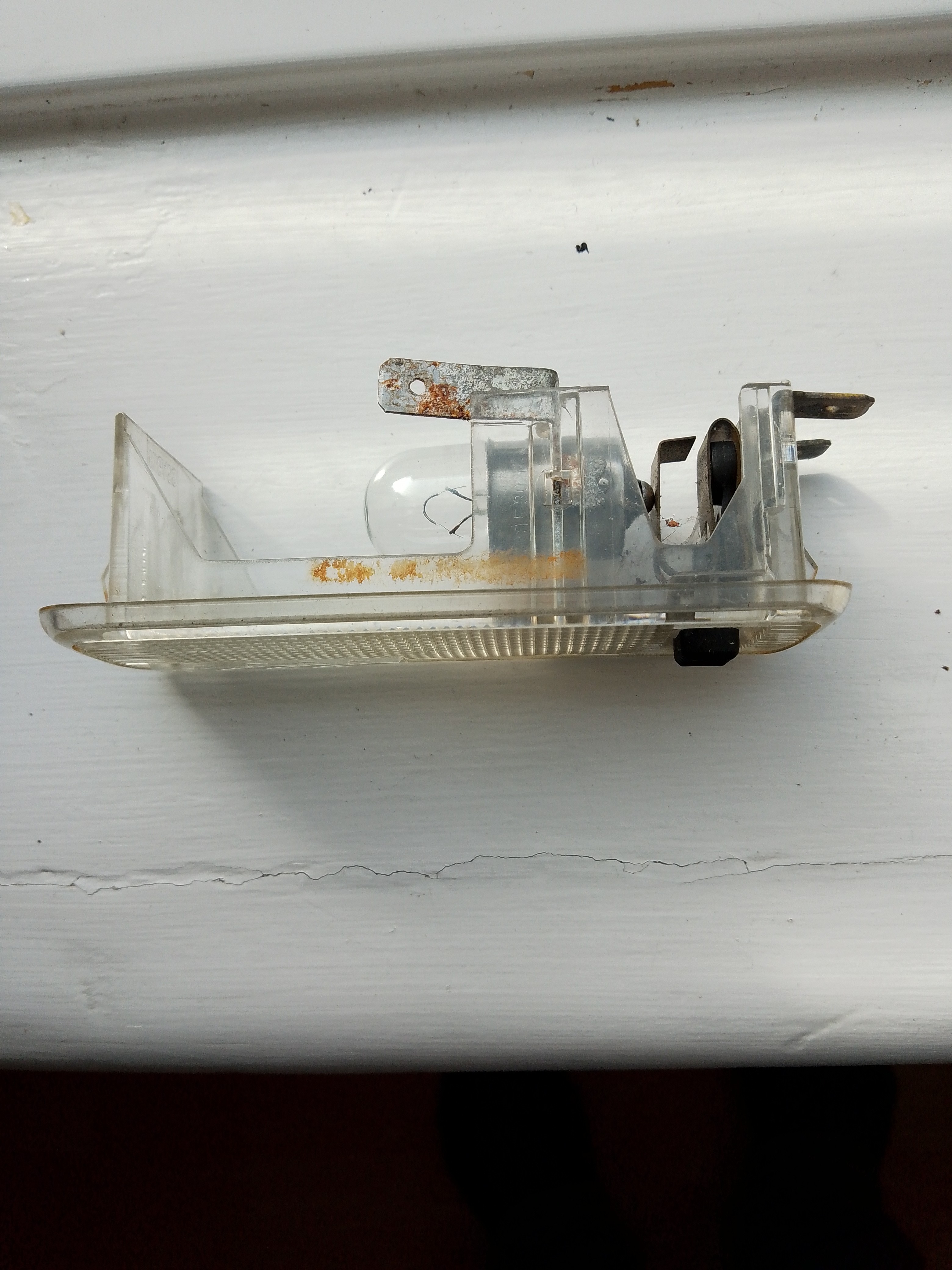

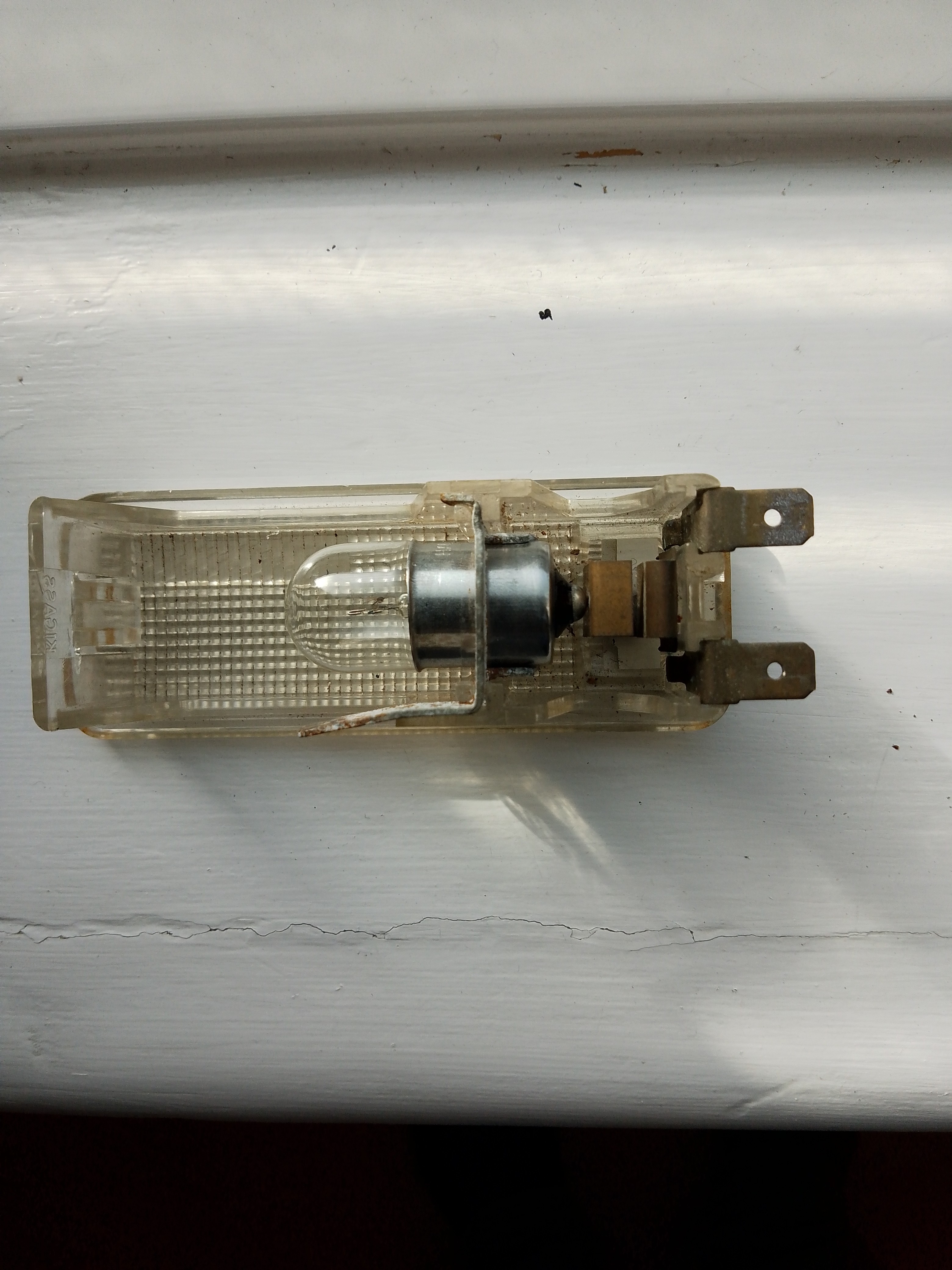

    I bought some new bulbs first thing this morning......but no wonder my courtesy lights were not working!! Each one wired differently, a cable hanging loose from one of them!!
    The guy who last replaced the headlining must have "given up" on the job - to be polite about it!
    I have a black cable, attachment/plug not surrounded by plastic. I have two cables whose 'plug' has a plastic surround, one cable red, the other red with another colour, line.
    I'm assuming the earth attaches to the clip which extends from the bulb holder. Is the bi-colour cable the earth? Does it matter which way round, which clip I attach negative, positive to?

      It is actually not wired the way you'd expect, as the earth is switched, so the solid purple (which may have faded to red by the sounds of it) which is a fused live feed goes to the single connector on the bulb holder, the black (permanent earth) goes to one of the connections by the switch and the purple/white wire which is switched to earth by the door switches goes to the other. Switch on the lamp in centre position, lamp off, no earth, switch to side with black wire, lamp on, switch to purple/white, lamp on when doors are open. Switches and bulb holders are prone to corrosion, so worth giving them a clean/moving them on off a few times to polish them up. The bulb being wired the opposite way round to other bulbs means that you'll need to modify things a bit if you ever fit led bulbs.... I have seen them wired up in a wide variety of 'not quite right' ways over the years! If you are going to be doing much with the electrical system you might find something like this useful https://www.ebay.co.uk/itm/407045400531. I don't know how good this particular one is, but for occasional use I don't think you'll want to spend 70 odd quid on a Fluke one, they are available with a crocodile clip on the lead, which can be useful sometimes, but the two pointy probes cover most jobs.

                          The two torches sound like a useful safety net! It might be worth checking the delay unit, but looks as though you might be playing 'hunt the wire' first. It should be possible to see/feel it going into the top hinge hole if you take the fusebox cover off. The wire has a black sleeve on it at this point, so not easy to identify, other than by knowing it is the only single wire in that area. It might be dangling in amongst the fuse box, but more likely that it is still in the door pillar. If it is & you take the draughtproofing sponge out of the hinge hole, you should be able to wiggle it about & see it through the switch hole, then hook it out with a piece of thin wire. If it is hanging inside the car, you could feed a piece of stiffer wire through the holes & tape the switch wire to it then pull it back into place. fun fun fun!
