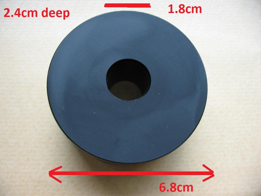

        NAM 1181 is the 'hard to find ' one, I seem to remember someone using Rover 200 ones, but not sure if they were to prune to fit. Golf ones from the same era are supposed to be quite similar too, but I've not tried either of these yet. This ebay listing contains a full set, but also includes a few things you don't mention, which makes it look a bit dear for the bushes, on the other hand, changing all of the bits might not be a bad plan!. https://www.ebay.co.uk/itm/195027371...kAAOSwPsViD5PQ
          NAM1181 will be a nightmare to find. Here's one of my old ones measured up, this will help when looking for something to replace it. Have you actually checked the condition of your old ones? We naturally assumed ours were shot but in fact they were quite usable. Click image for larger version
