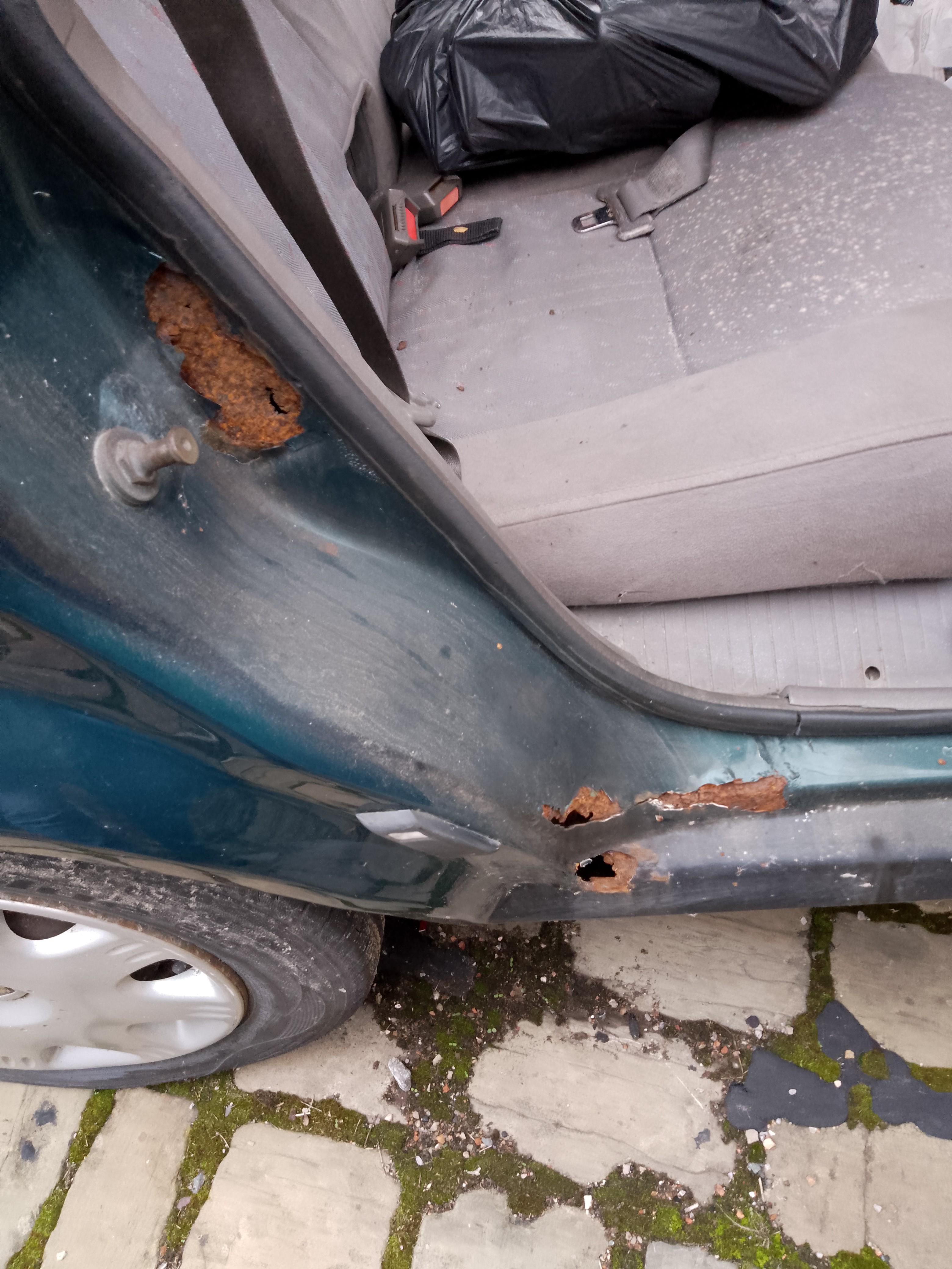

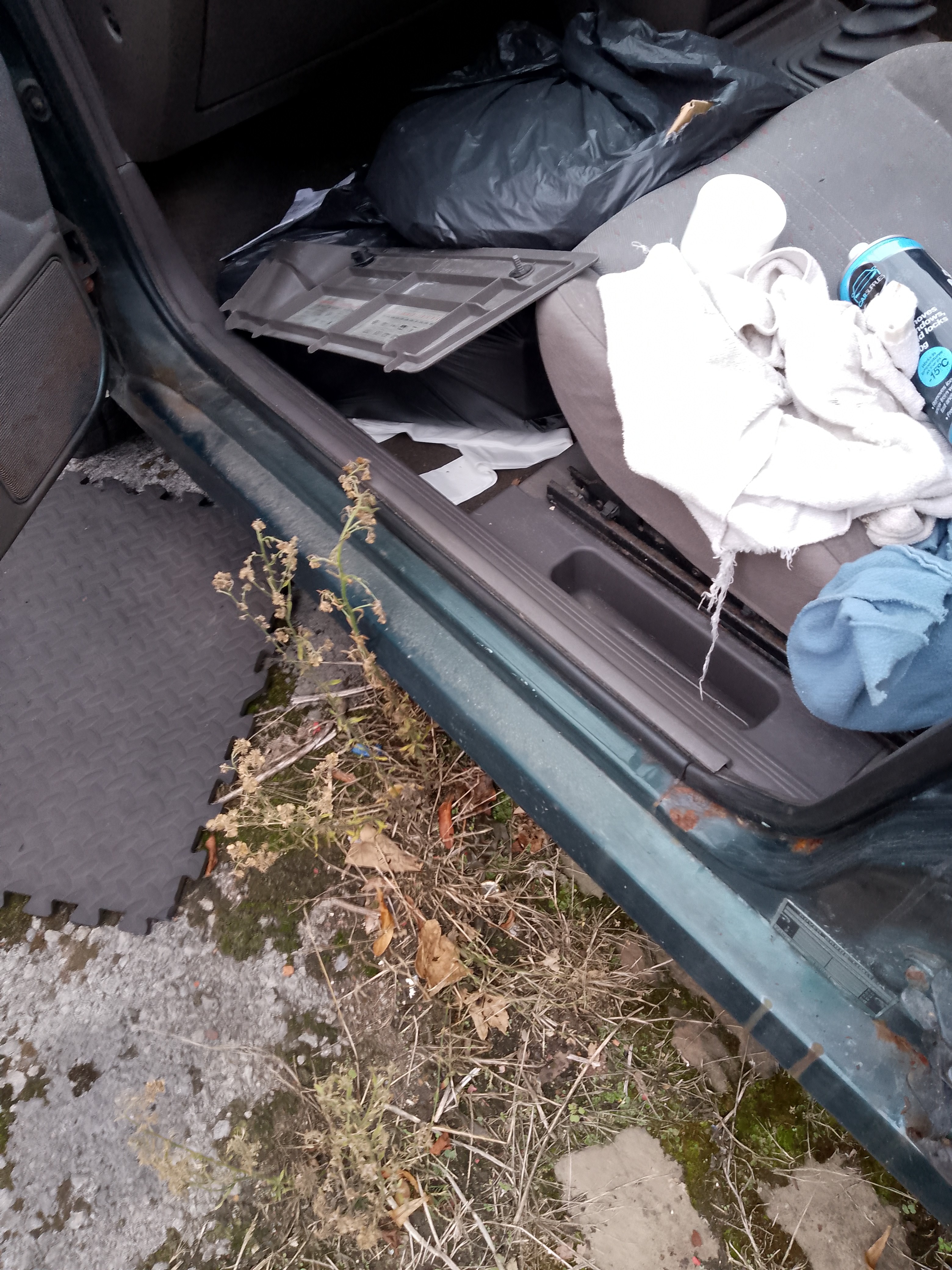

              Wheel arches already done, replaced but sills need attention, were MOT failure. Worst on rear doors, driver's side especially with a couple of holes.

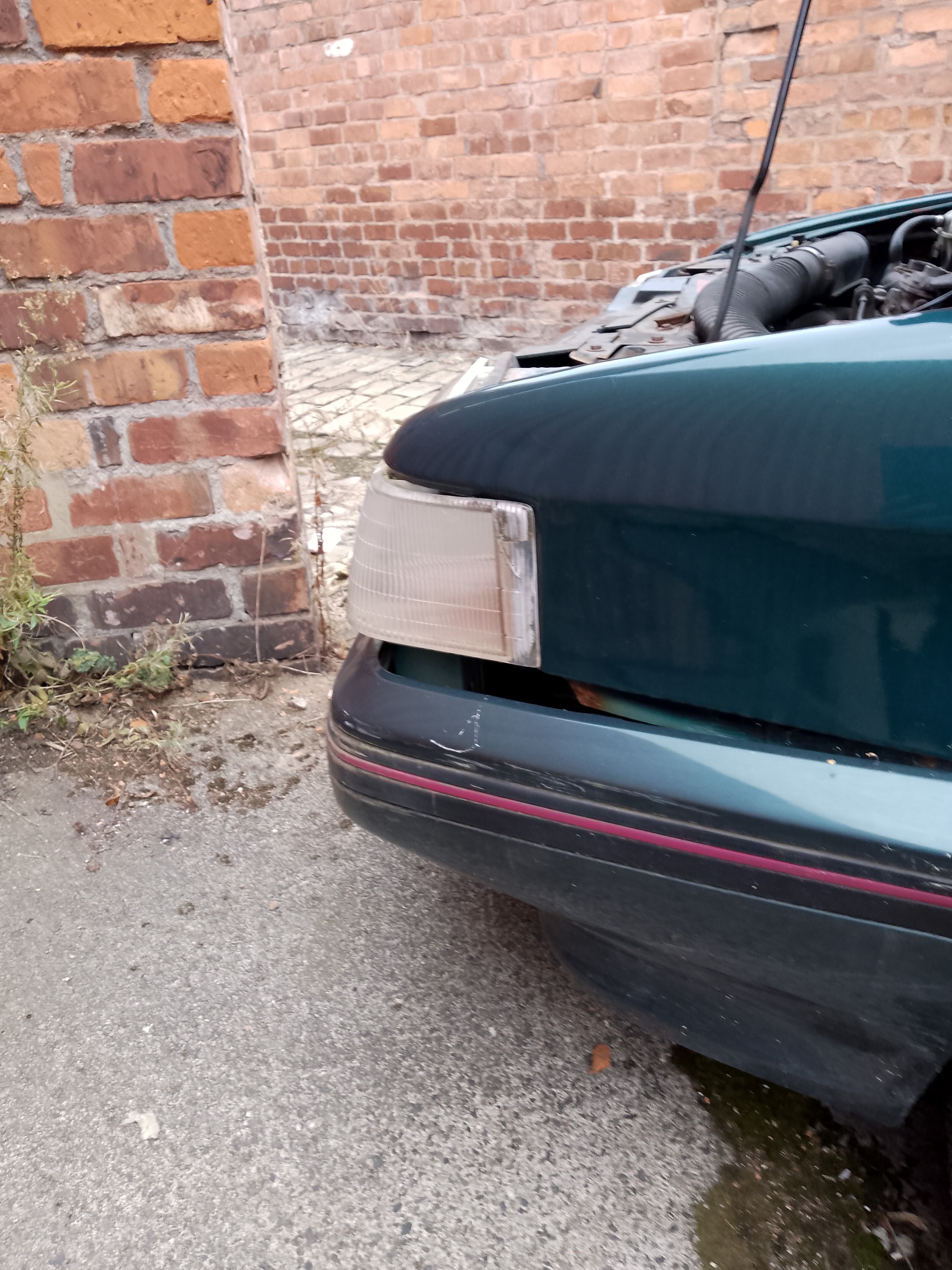

              Front valence, bumper dropped

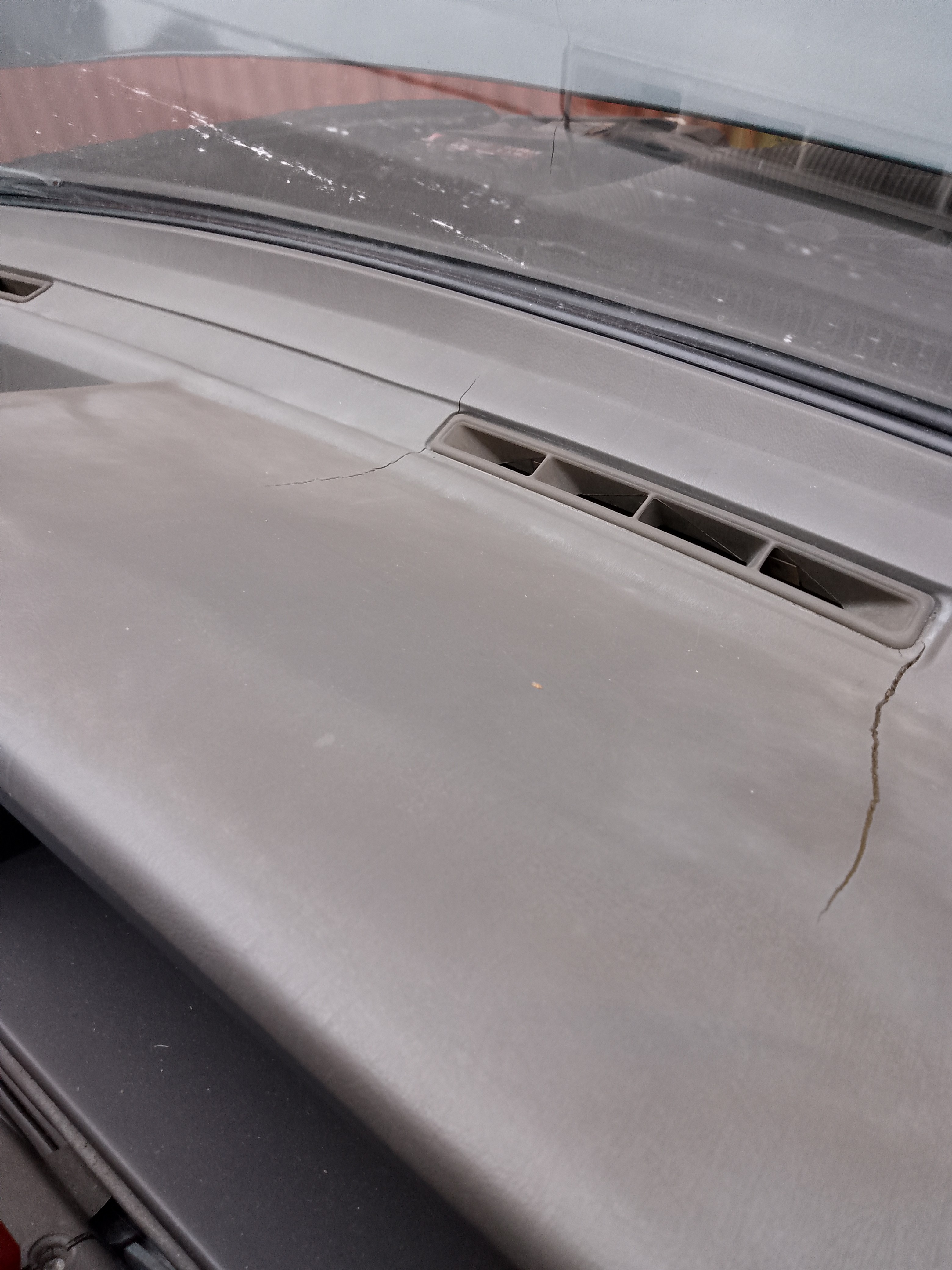

              Only slight cracks in facia.

                      I too wondered how the hell did it pass previous test - rear of o/s sill had actual rot holes. Not a bad jacking issue.
