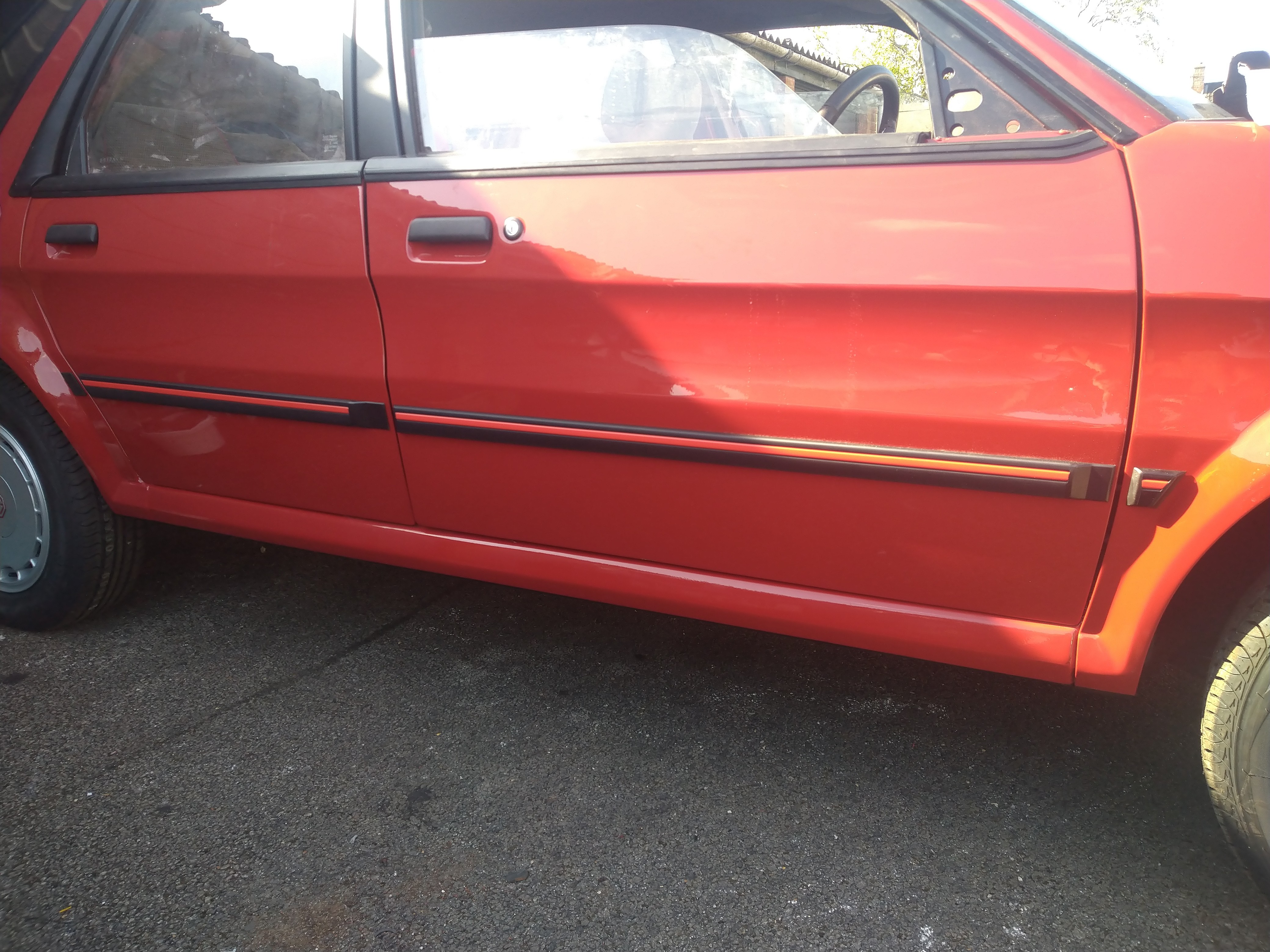

And the lovely door trims on. Measure twice, put on once

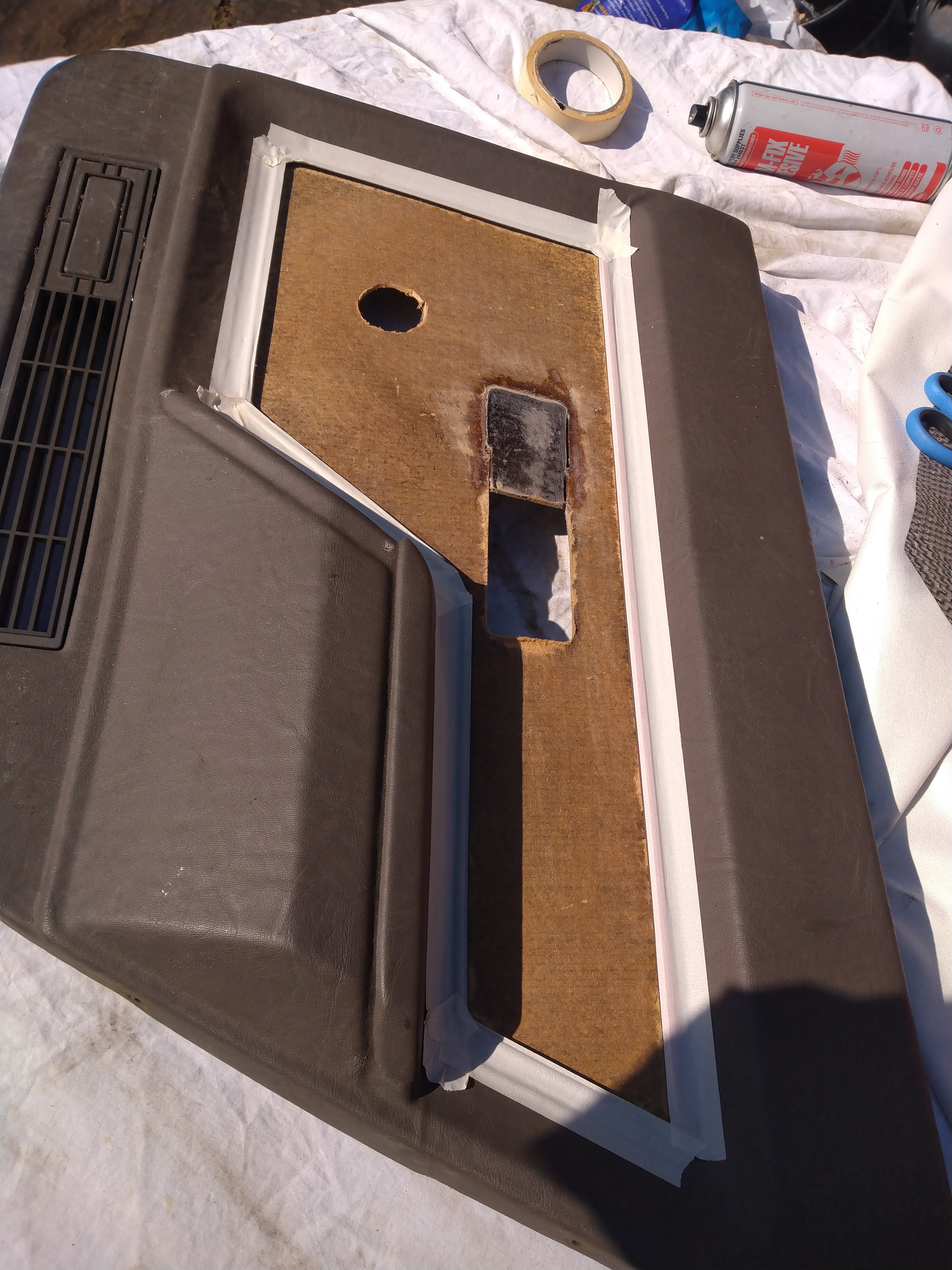

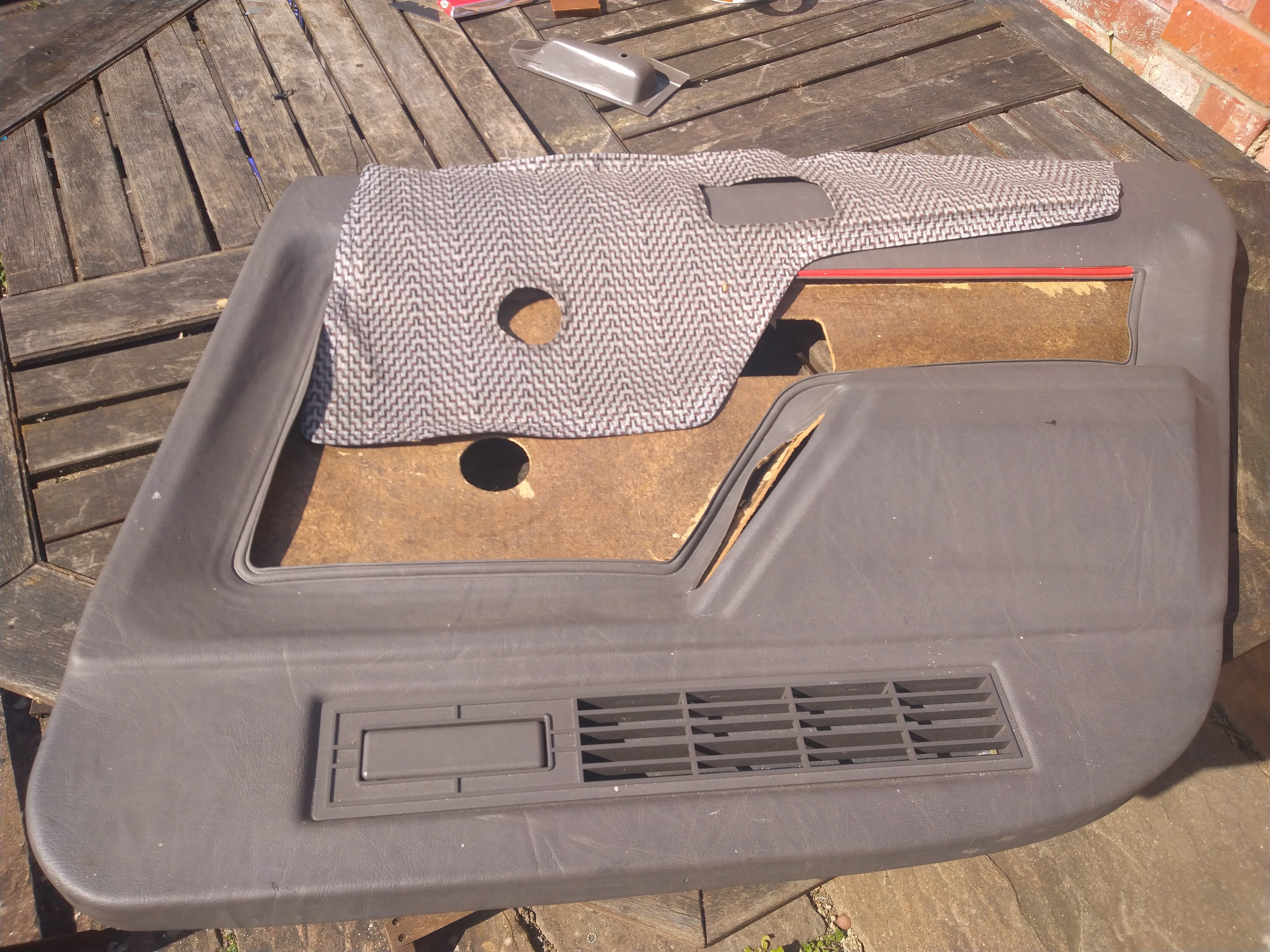

Drill holes for door cards
Attach door plastic insulation
Attach door cards

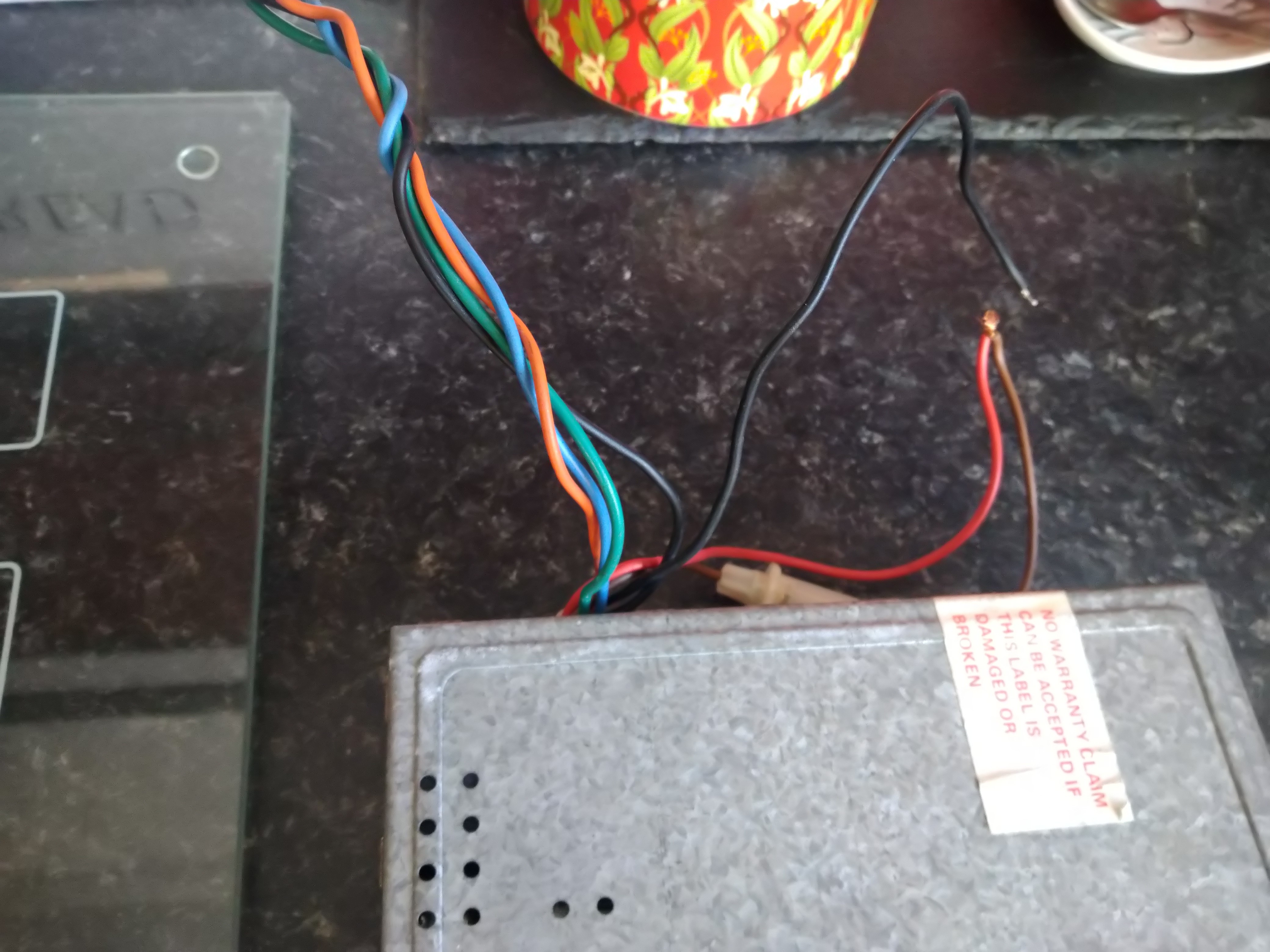

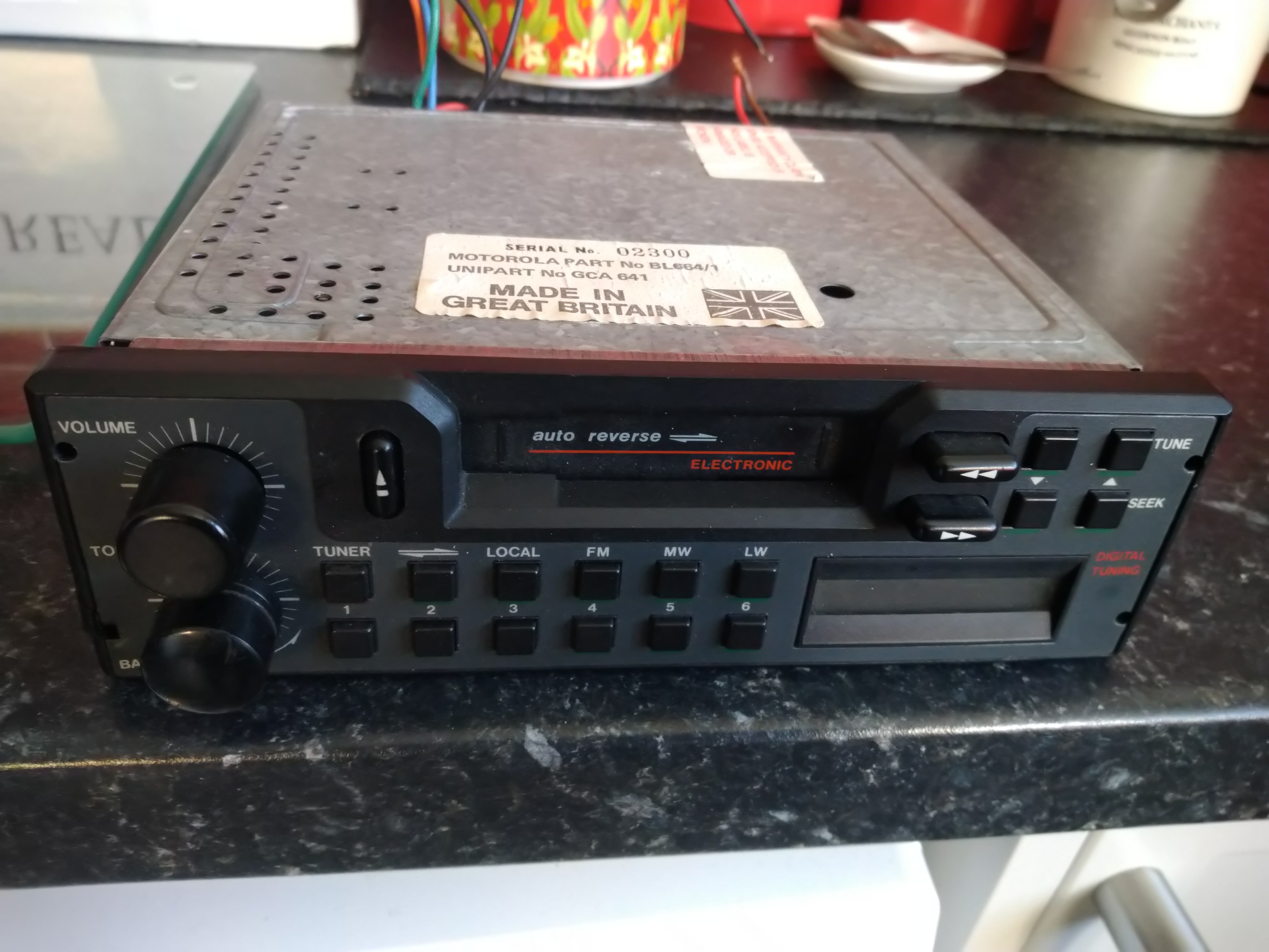

Also wired up the radio to a battery, FM not working but AM does, tape deck also works, unfortunately all sound comes out of one speaker so that to sort.1958 Ford Consul Convertible. I love this car

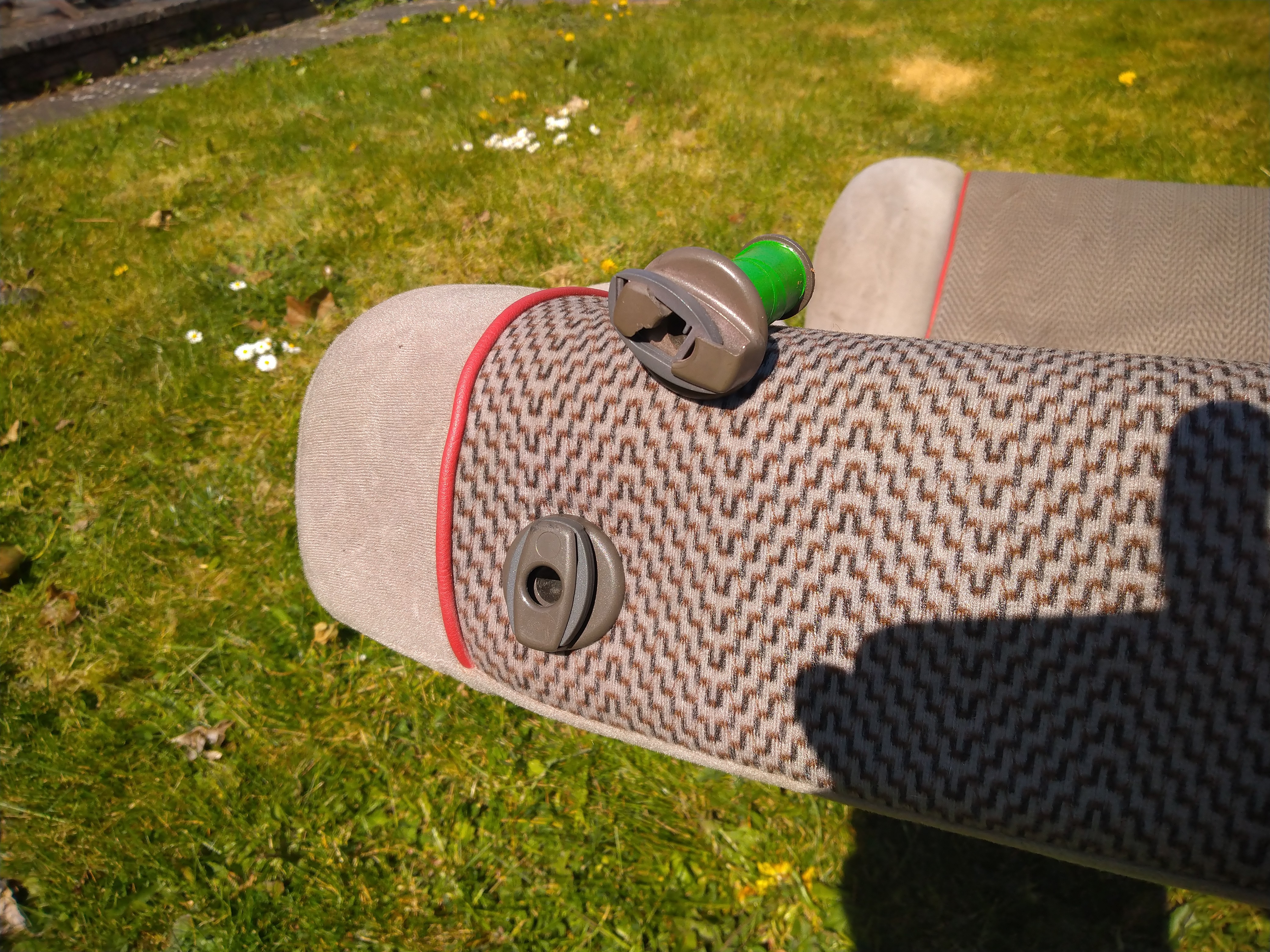

Little bit done today, glovebox is attached, all seats are now in the car and looking good. New number plates turned up today and they also look good. Electrical checking. I've now got all of the lights etc working but the front nearside indicator refuses to play ball, interior light now working but the central locking is continuing to be a problem, I have changed the actuator with a couple from my spares but still nothing, although there is power getting to it as it clicks so it should be working, cant be a fuse as its on the same circuit as the interior light . Will have to take my voltmeter with me next visit to check this and the front indicator. Unfortunately I may also have to remove the front bumper again as the horn also isn't working and its behind that, I did check all this prior to putting it on aswel and it worked then. Could possibly be the stalk at fault with the horn and front indicator so will find a replacement firstLast edited by Jeff Turbo; 23rd April 2020, 14:57.1958 Ford Consul Convertible. I love this car

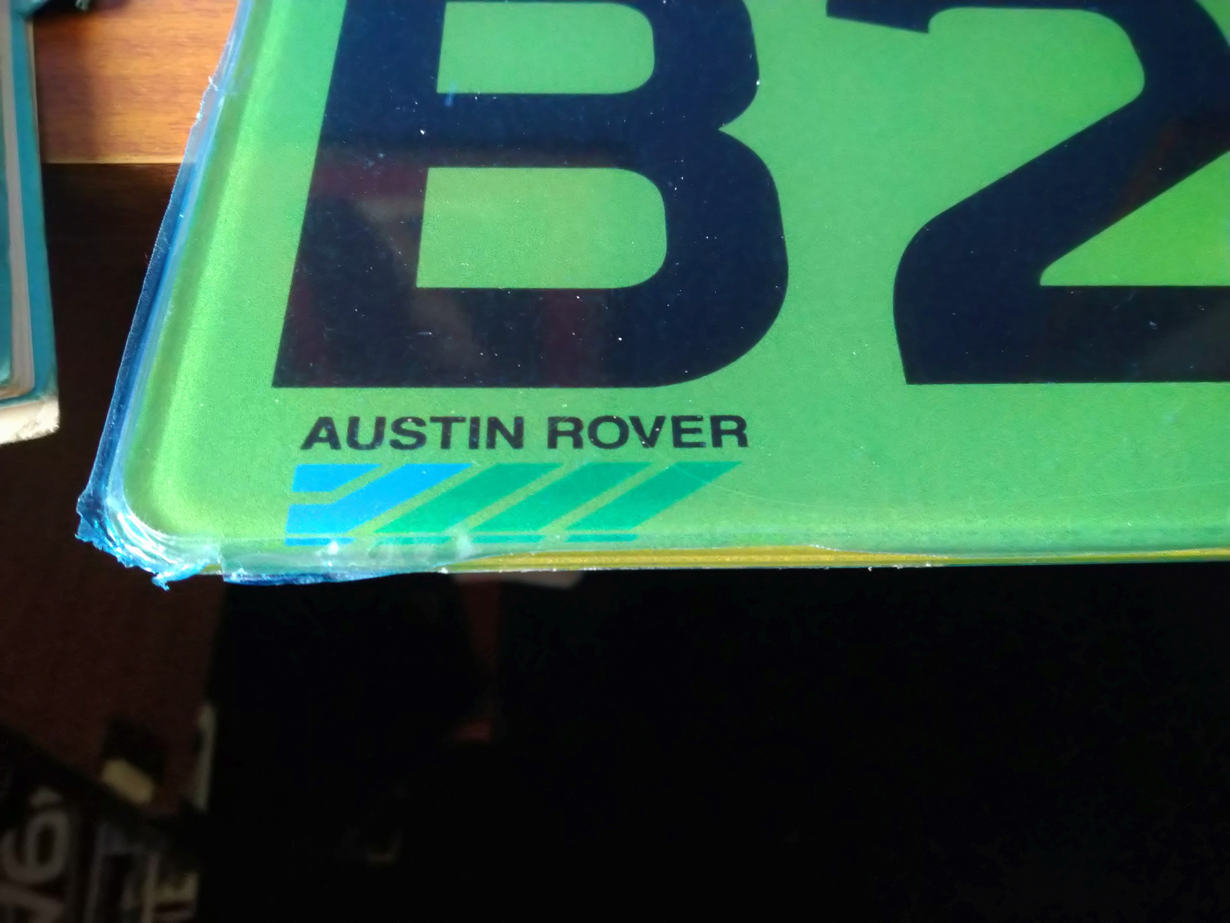

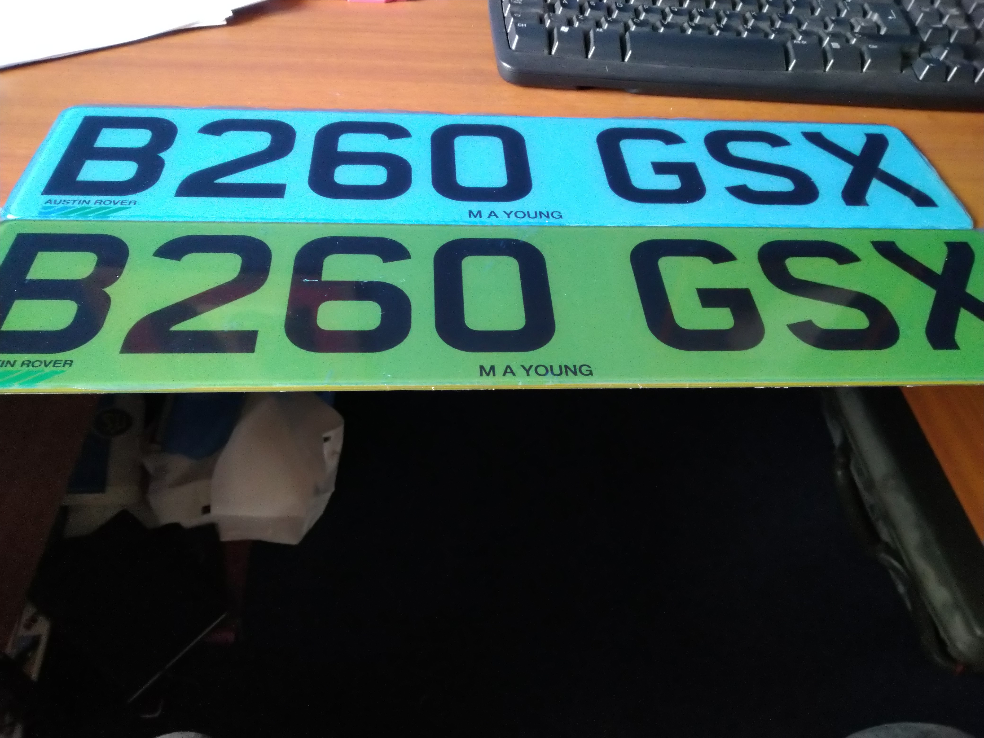

Made to order, might not be legal but looks good, in any case it's going on the car lolOriginally posted by efi 2.0 View PostLove the little "Austin Rover" script on the number plate!1958 Ford Consul Convertible. I love this car
