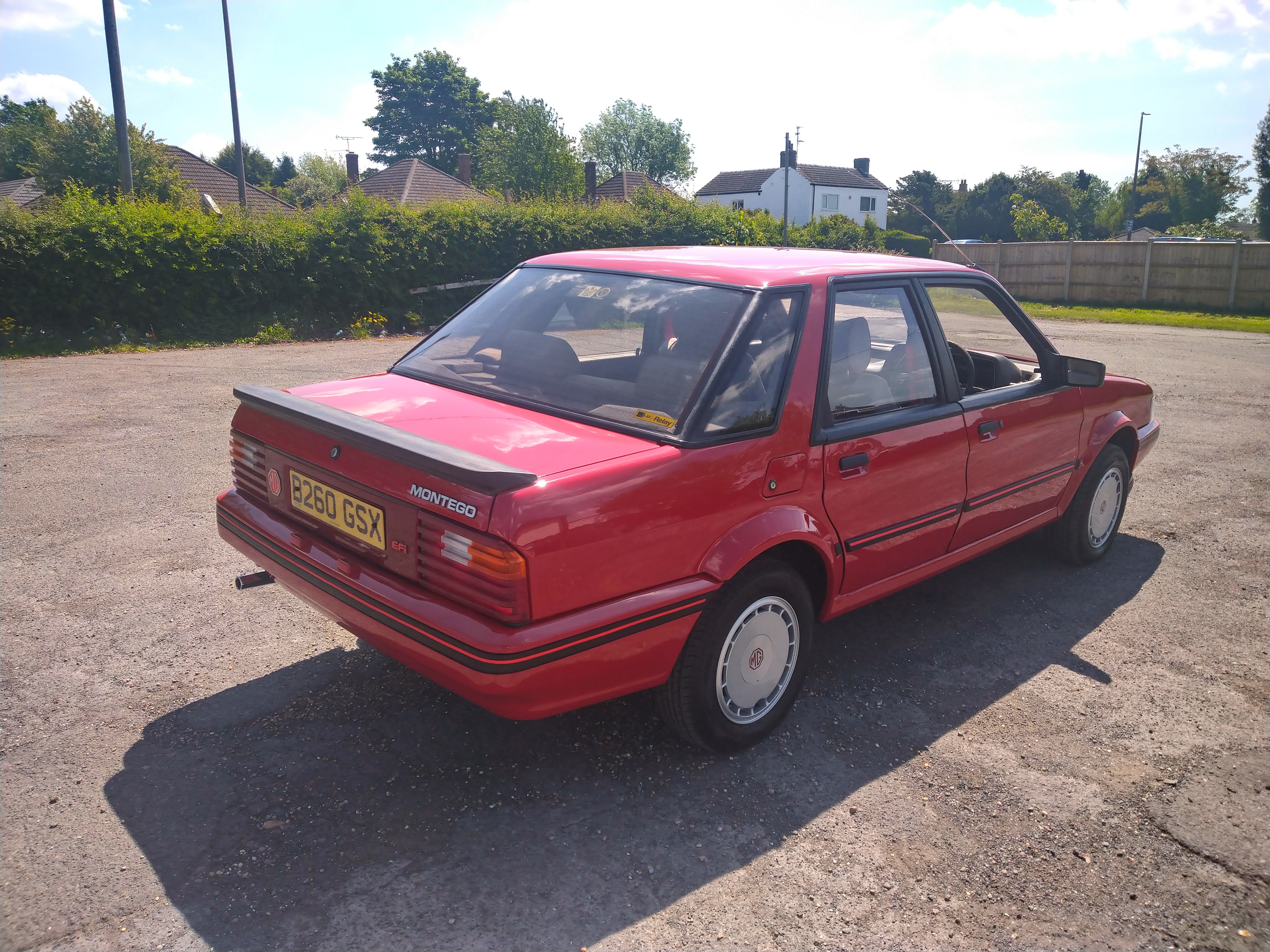

        • After 8 years the car has now been completed with an mot and no advisories. Had to adjust the tracking, front lights and emissions, but now sorted. Runs very smoothly too and a good possibility that it will be taxed at the end of the month to enjoy

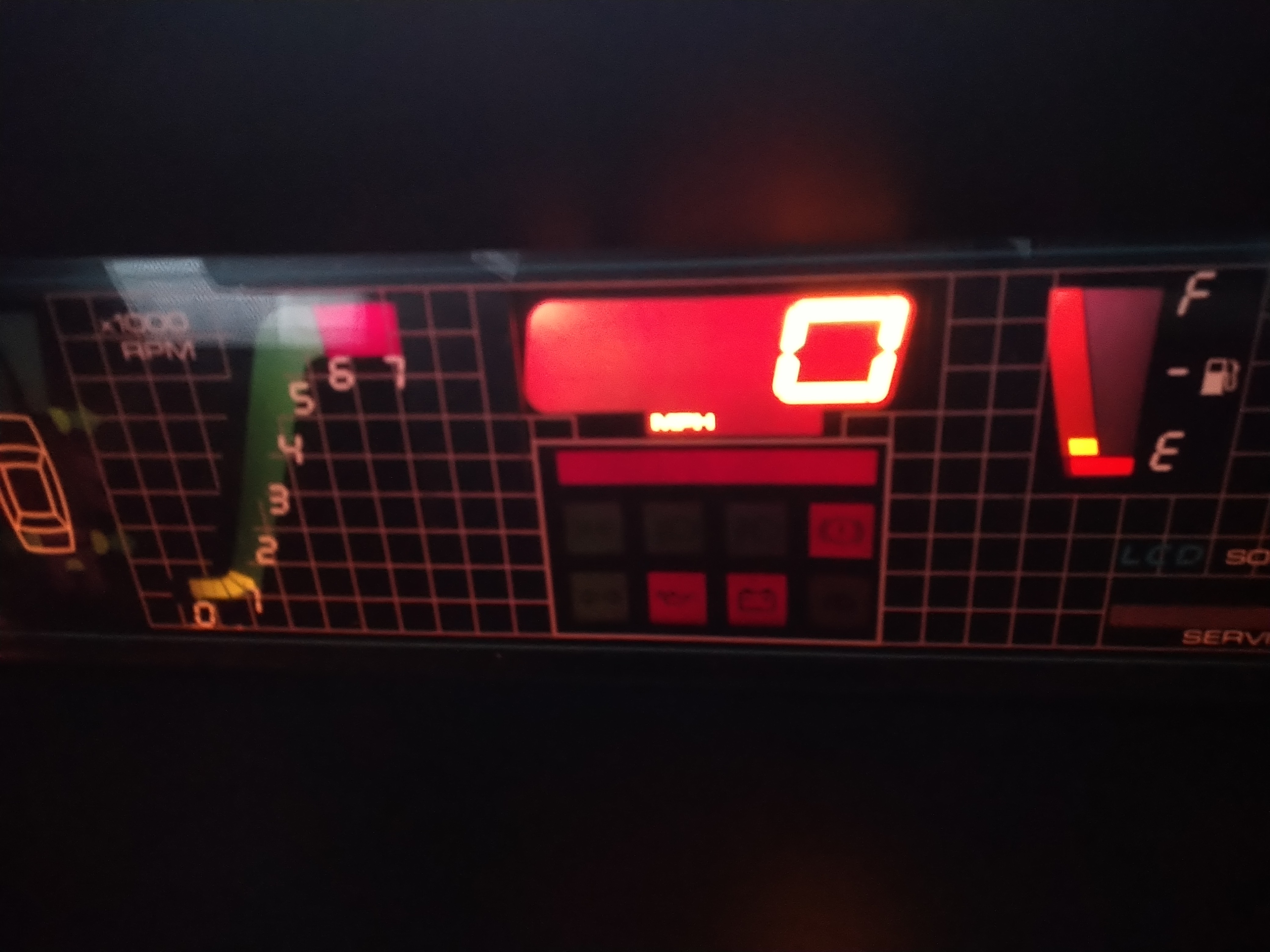

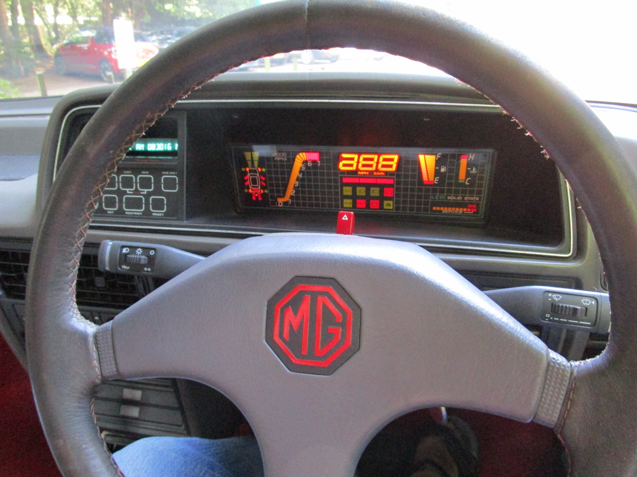

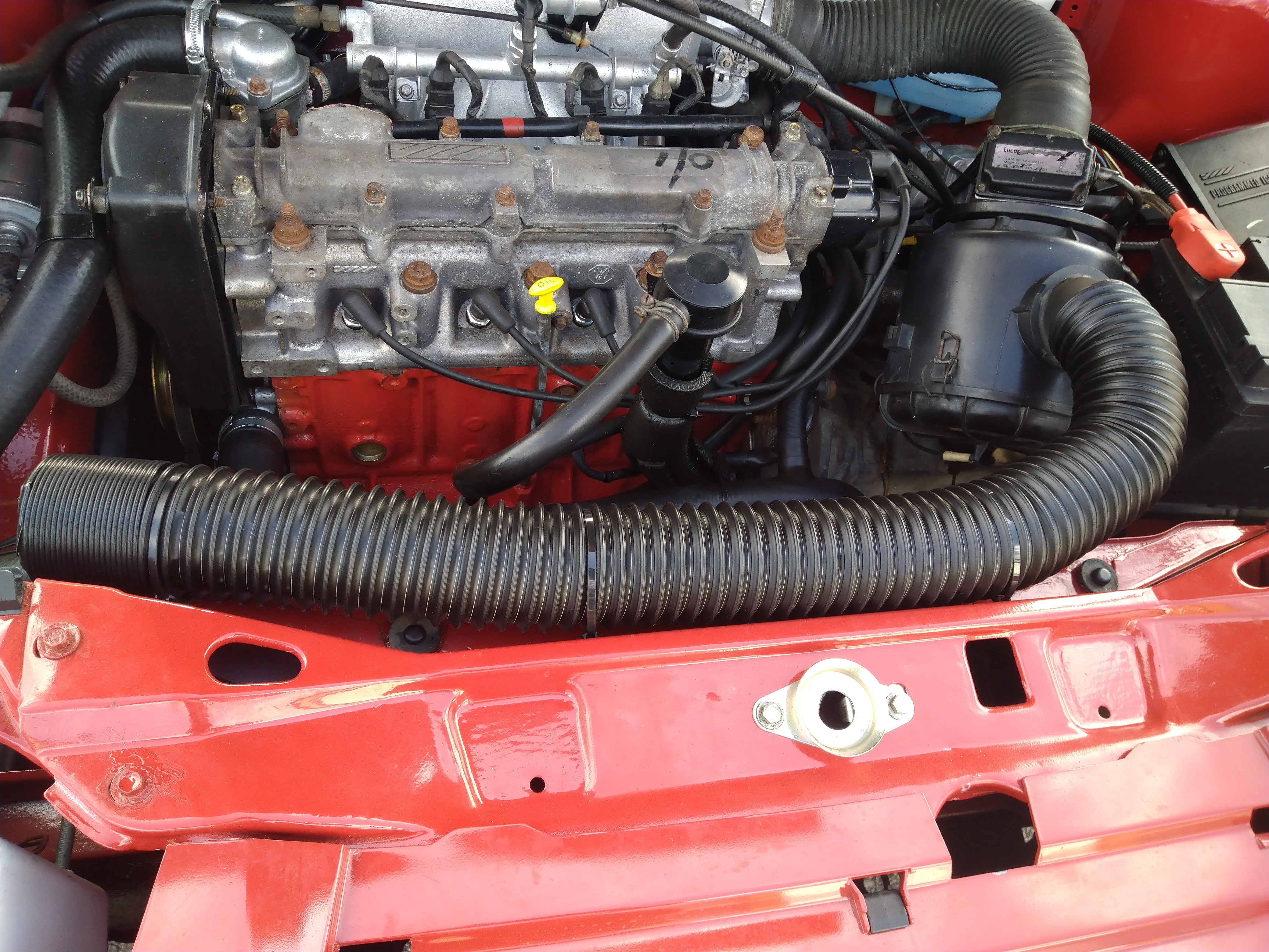

                • Air intake and holding clips arrived, much better than the old one. Couple of niggles also hopefully sorted, dash lights up properly now. Last thing to sort is a possibly faulty rear light sensor as the rear offside indicator isn't lighting up on the dash and it keeps say bulb fault but all are working

                  • Faulty rear light sensor was at fault, now changed and all working correctly and good job I have spares, insurance also sorted for 1st June, 80 with agreed value 10,000. Who would have thought it, and MG Montego efi agreed value 10k. My turbo was insured for that 5 years ago but it seems EFi's have caught up. Happy days

                      • Took the car out for a 50 mile shakedown today, few things need doing but nothing major. Steering wheel is a little off centre, tick over is 1000 rpm so a little high, clutch cable is a little low now and the speedo gets to 50mph then goes backwards to 0 the faster you go, I do have a spare speed tranducer so that will have to be fitted. Gave the car an Italian tune up down the A46 bypass and surprised a few cars overtaking them and giving it large. Car ride is very smooth so really pleased with only minor things to sort

                        • Troublesome speed transducer now replaced and working correctly, steering wheel centralised, clutch adjusted, tickover lowered, unfortunately I've found an oil leak coming from the head gasket after it's blast down the bypass. Very frustrating that so that to look at, can't understand why so will have to find out why. Don't normally get this after I've changed a headgasket so not a good thing. Teething troubles I'm assuming

                          • Measured the ride height as the nearside looked higher than the offside, And it was by over half an inch, so replaced the spring for one in my spares and now level. No idea why as both springs had the same markings. And the car is running really smooth and cant find the oil leak, so maybe a little somewhere I hadn't cleaned. Will keep an eye on it
