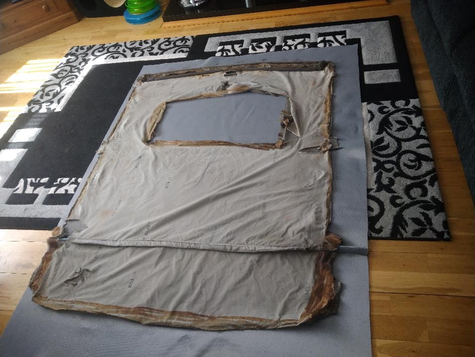

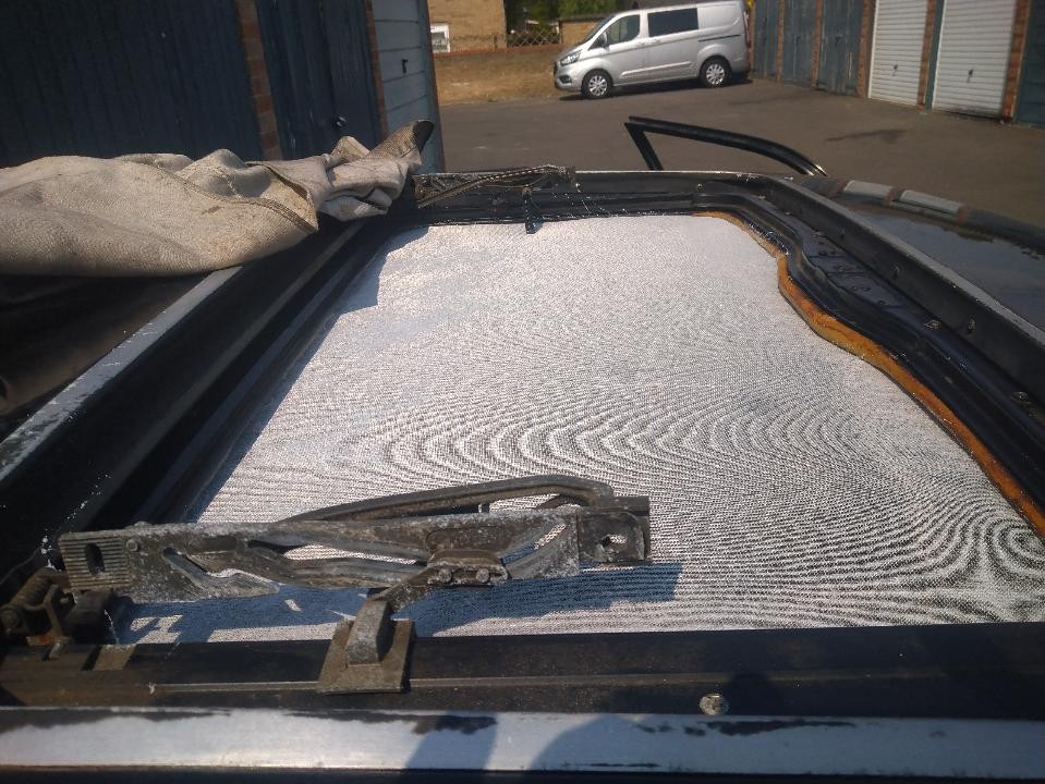

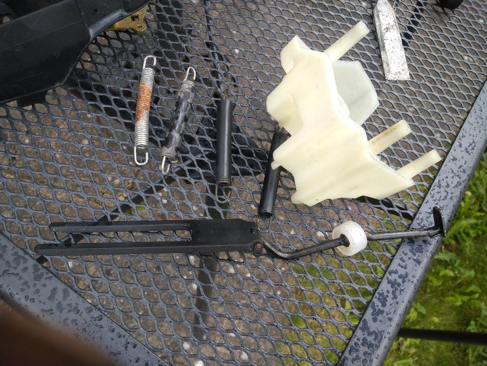

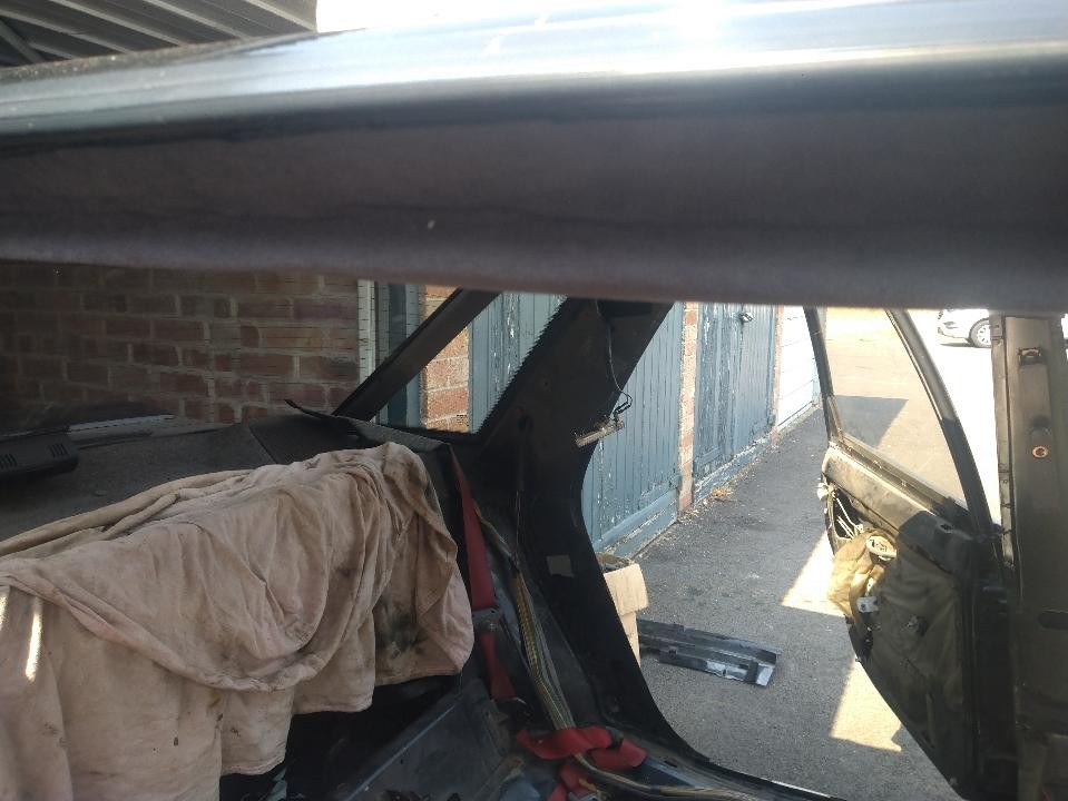

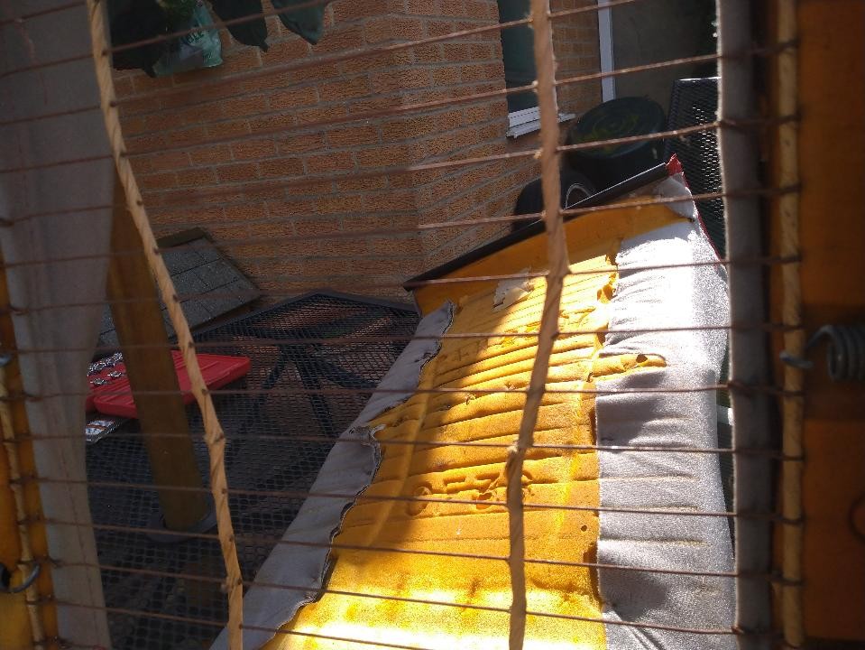

  • The main tray, got a bit messy but you don't see the back parts, Its back together now so the main headliner to do next, that'll be fun....not

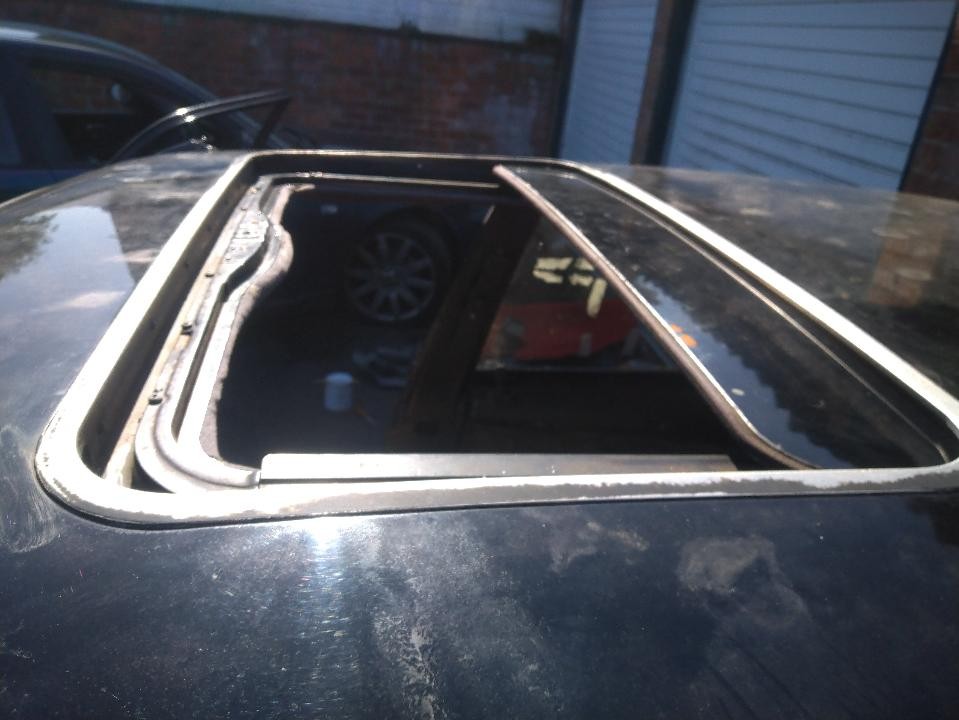

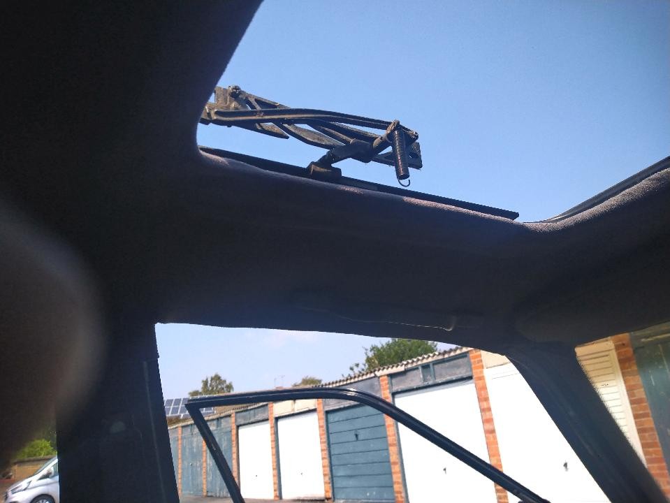

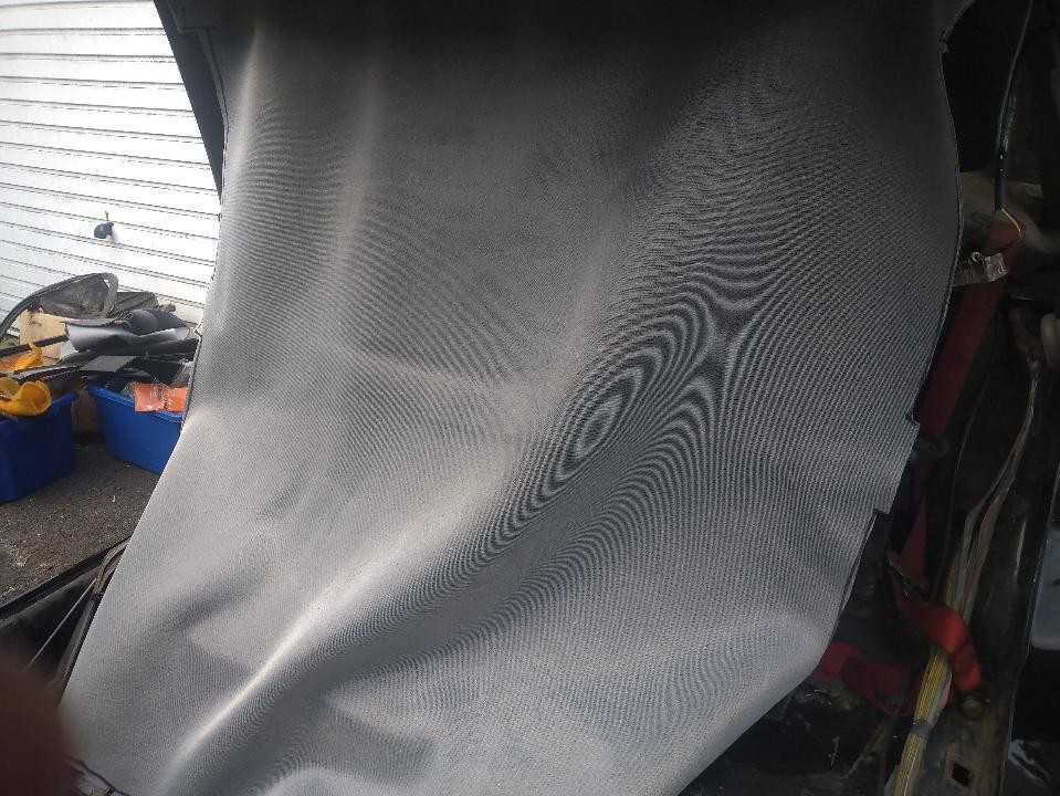

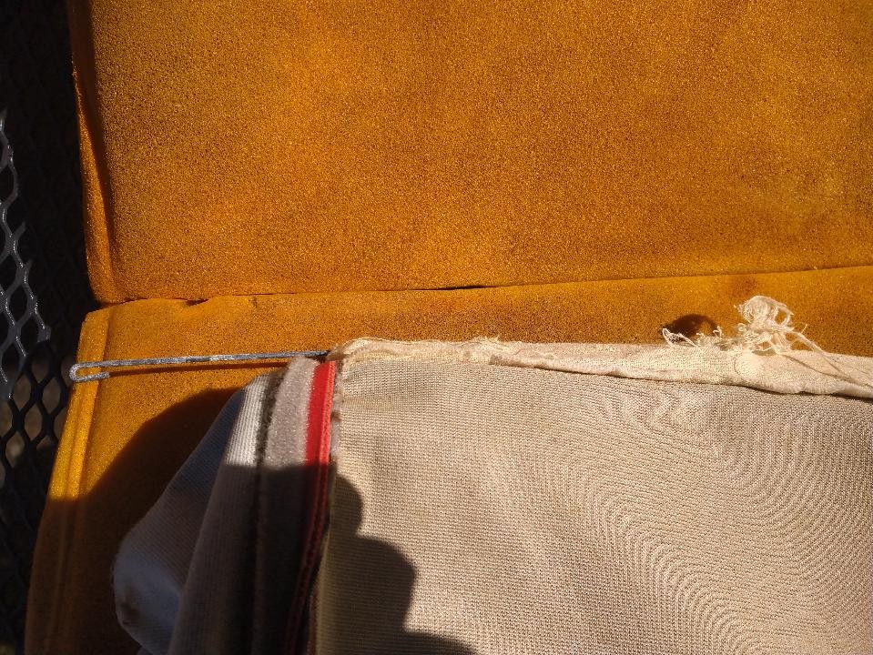

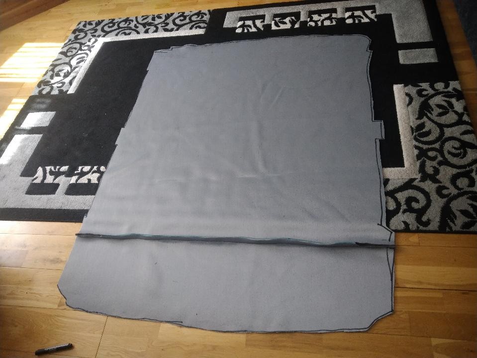

    • Measure a lot, cut once, next week will be putting it in..... If I've cut it right. The sunroof opening I will do once it's in

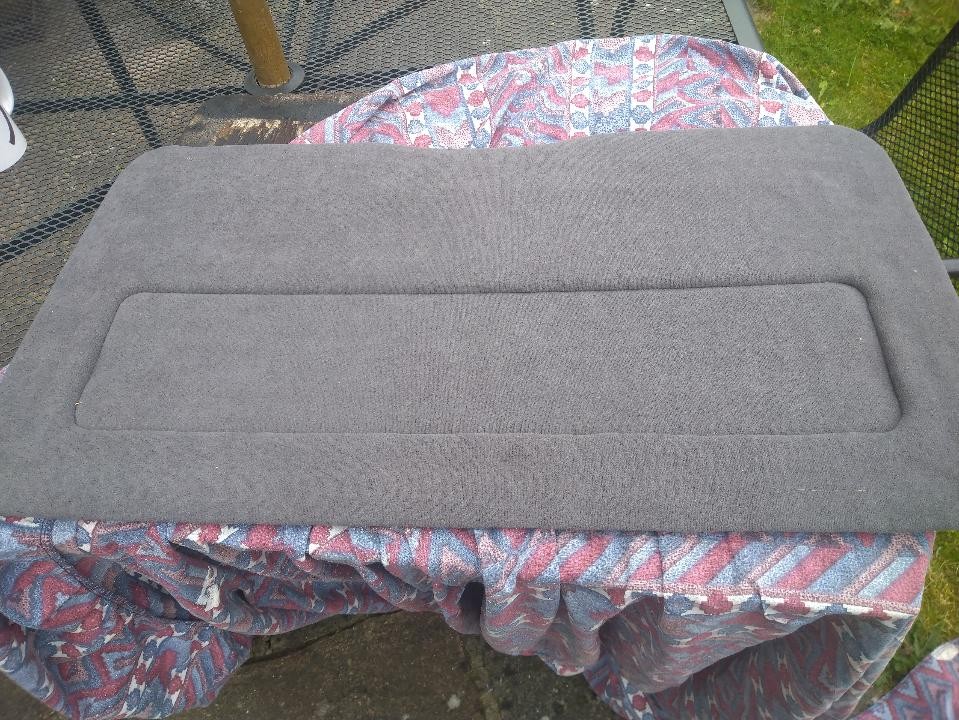

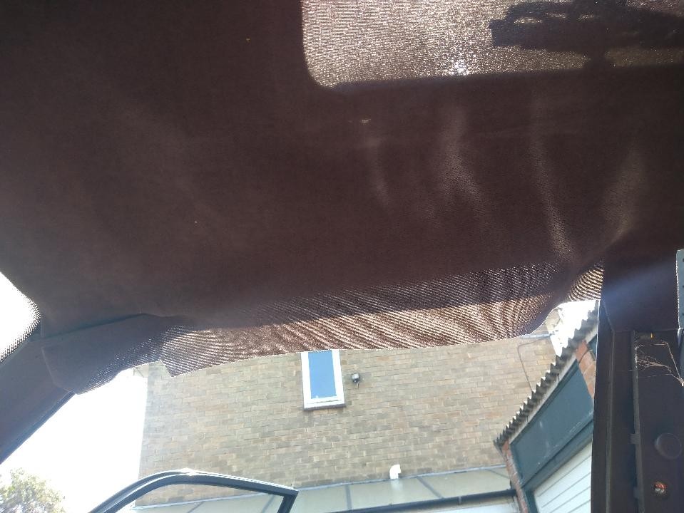

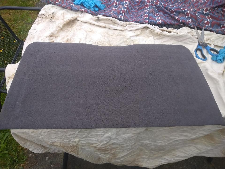

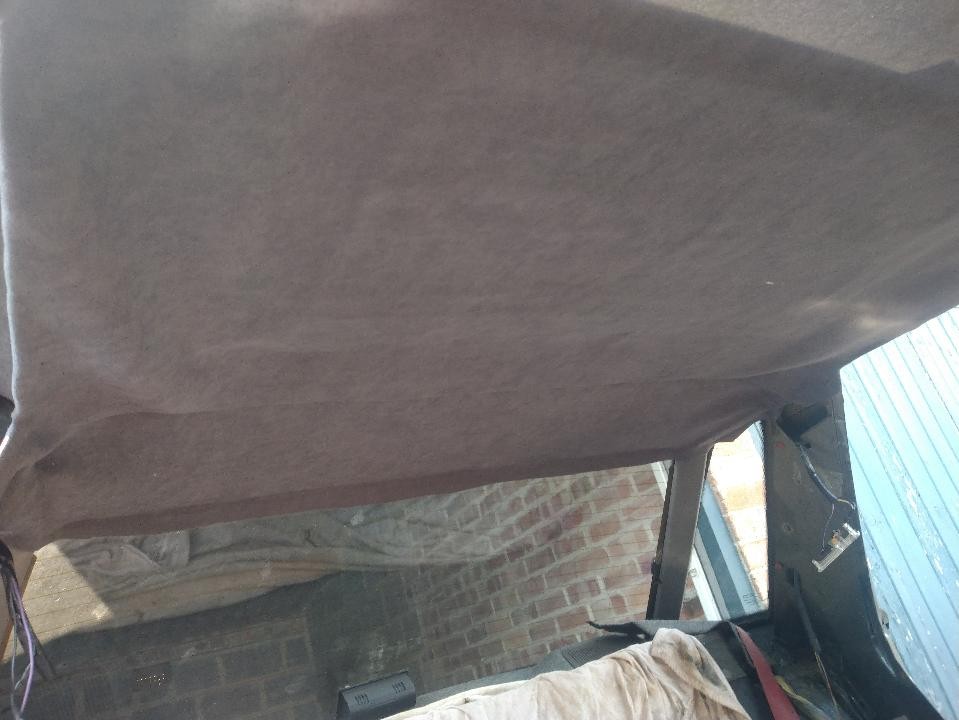

      • Last bits of the roof completed, new foam attached to the bottom of the tray and all tidied up, also been fixing broken door cards. As all of my good ones are gone now I'm having to fix broken, damaged etc. But not coming out too bad. Started the car up and mucho stale fuel smell so will put another filter on it and clean out the pump, fuel lines, tank and put fresh petrol in it and red ex ..... Eventually as its possible that's the problem

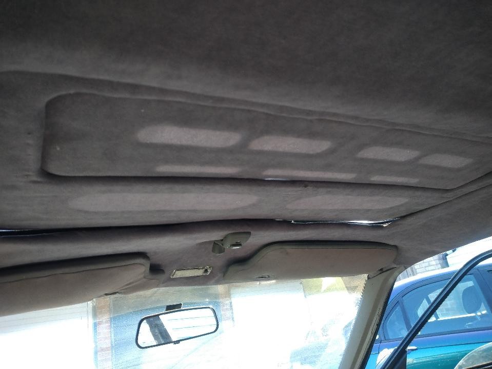

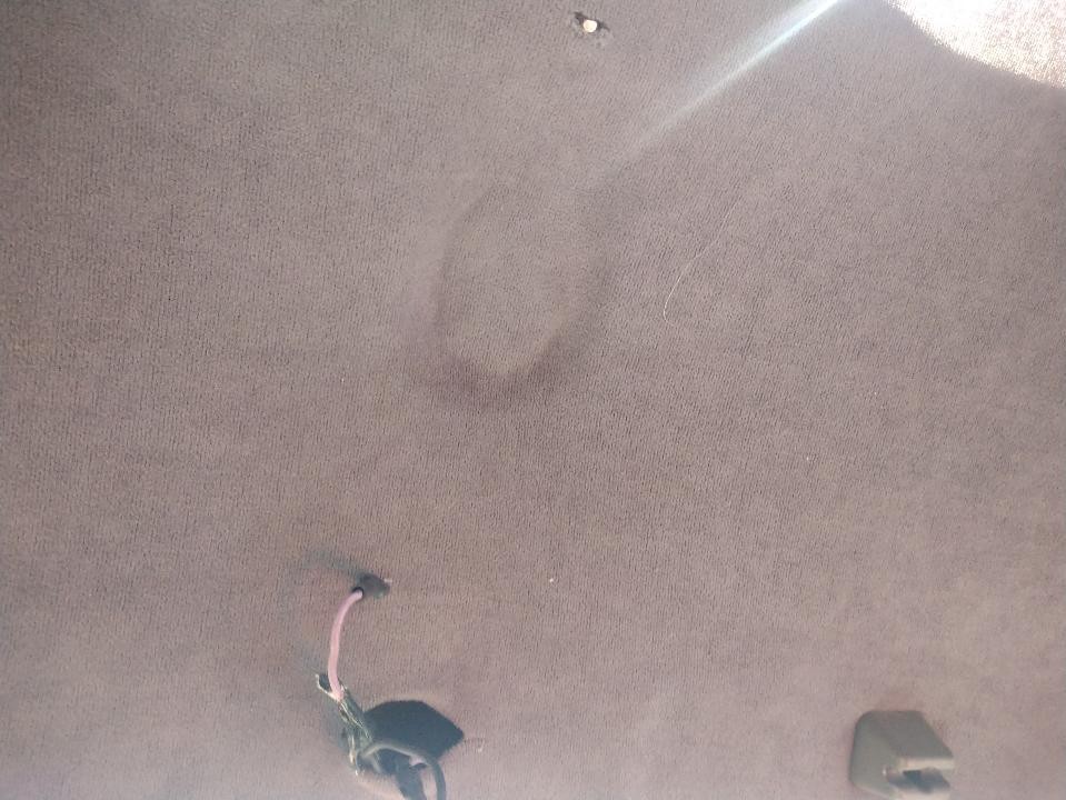

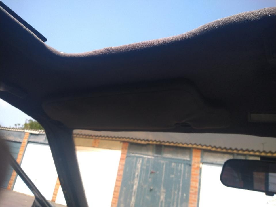

        • Headlining near complete and what a job without a headliner biscuit. Not the best i've ever done but its better than it was

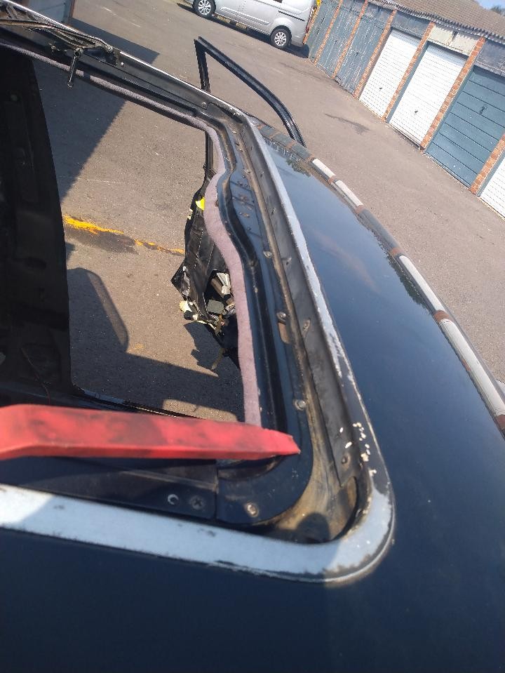

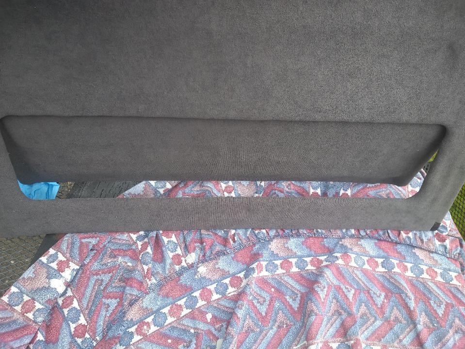

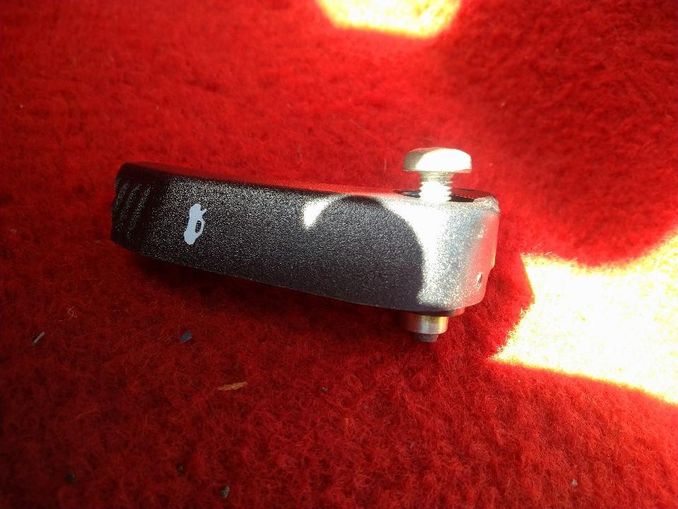

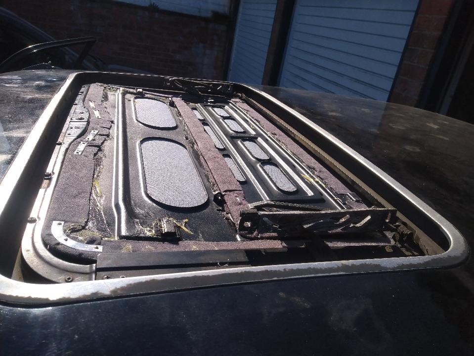

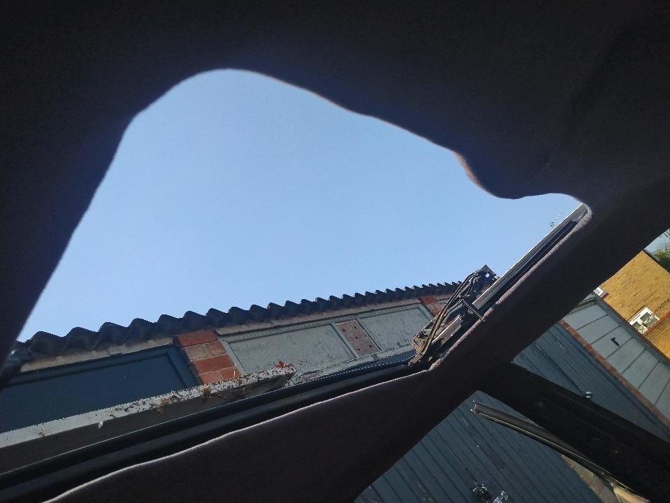

          • More, fabricated sunroof handle opening glued in, had to push the lining into the gap with one of my trimming tools then tighten all the screws

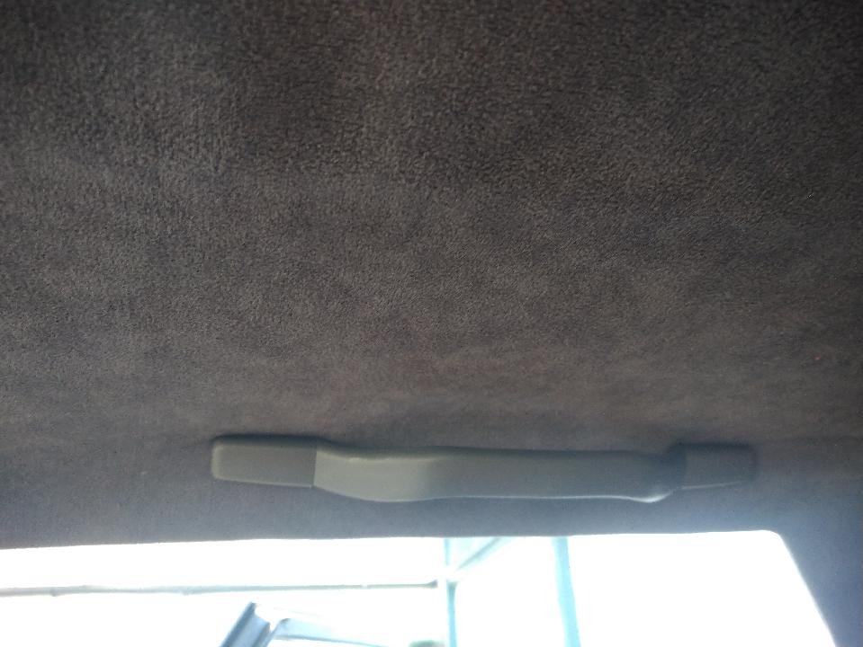

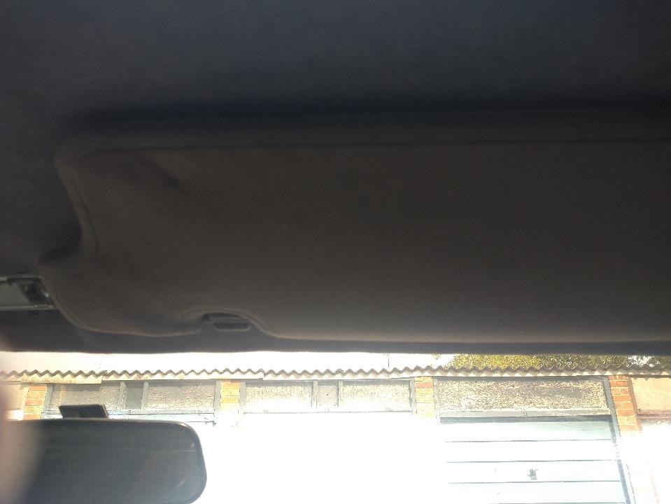

            • Grab handles back on as are the sunvisors. Also removed the knackered radiator and dropped that off to a fabricators near me who i've used before

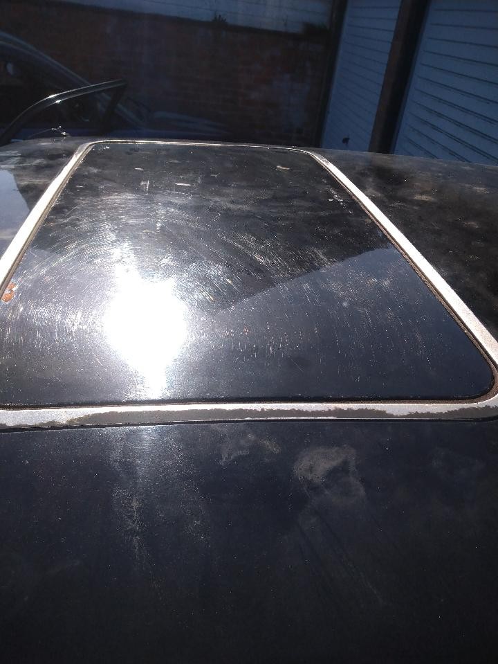

              • Sunroof now back in

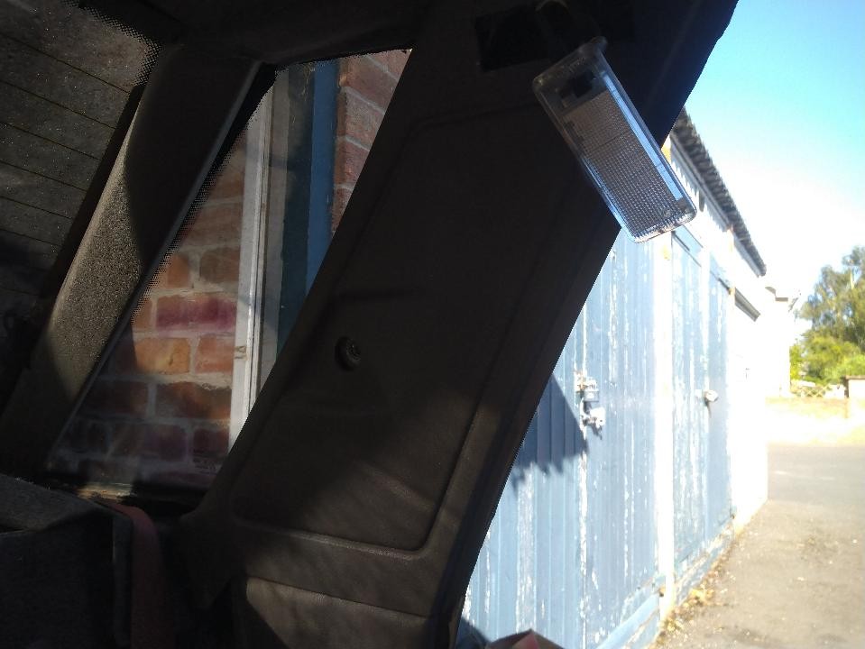

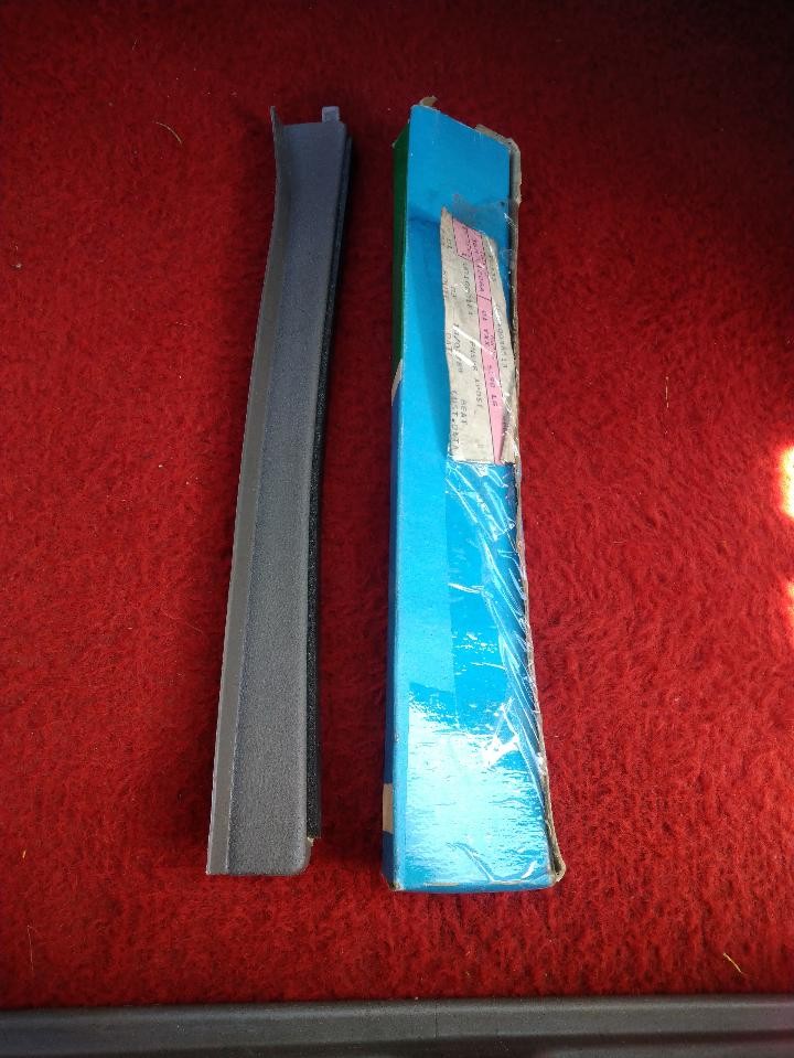

                • Pillar trims all in and rear interior lamps working, seat belts all in, doors seals back on, new parts going in, door seals on

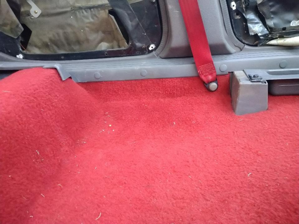

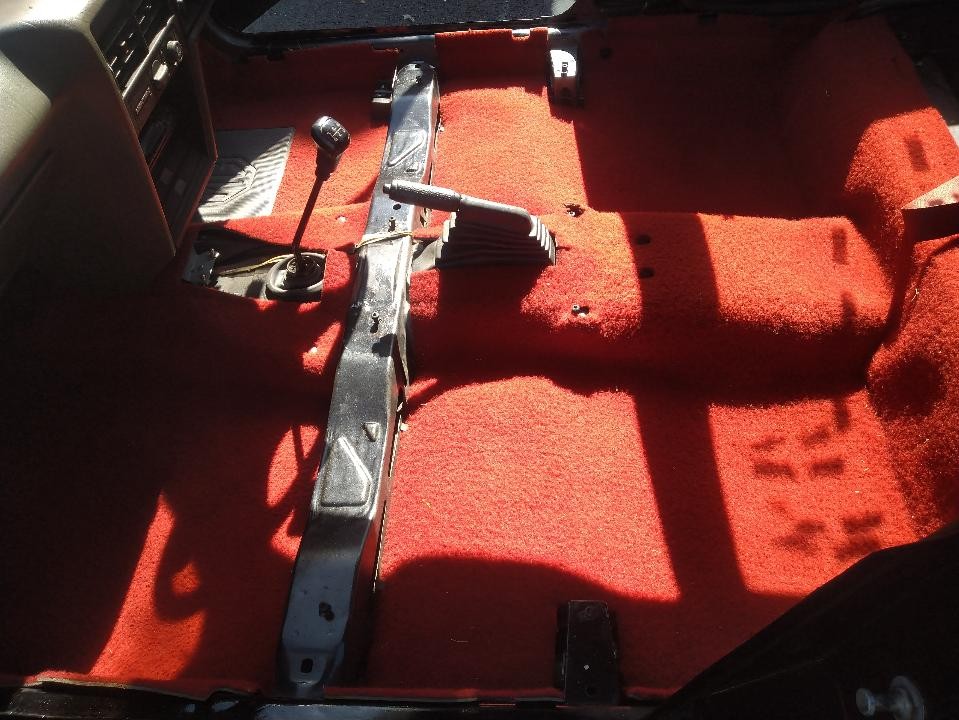

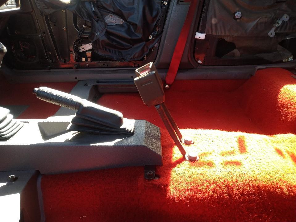

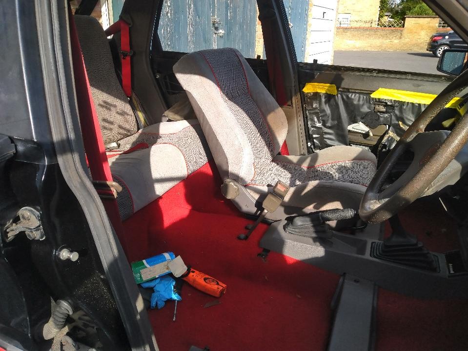

                  • Carpets in, centre console in carpet trims, seat belt stalks all back in

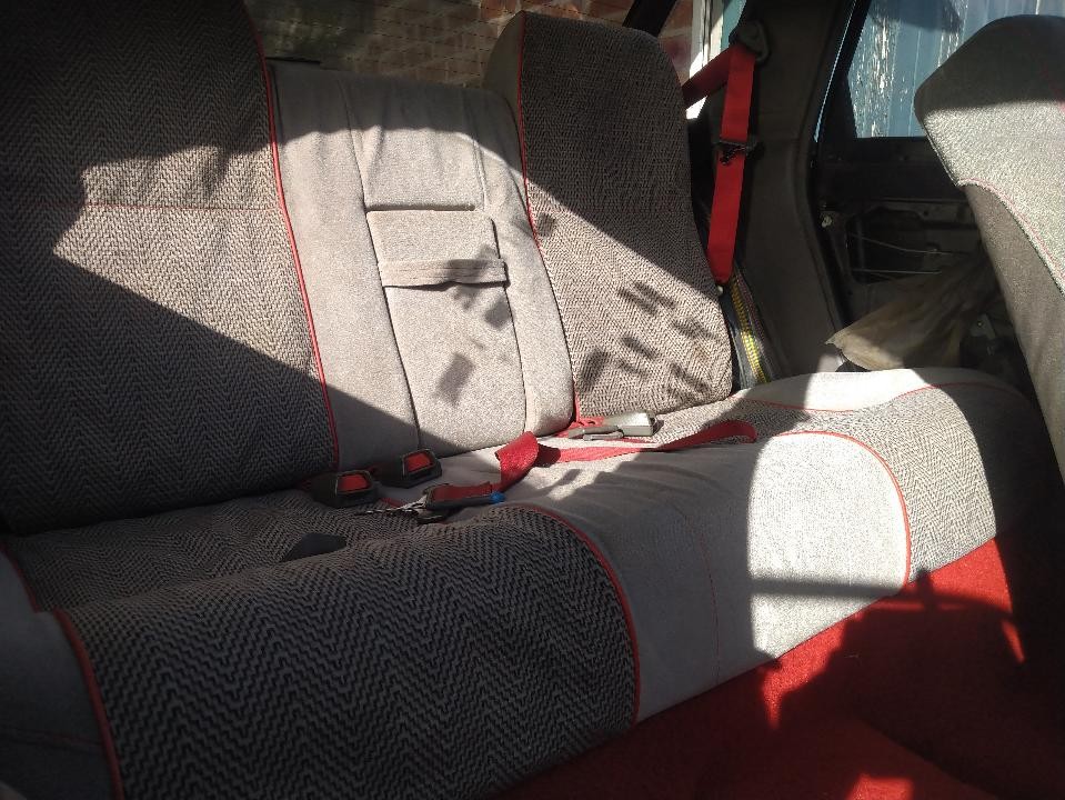

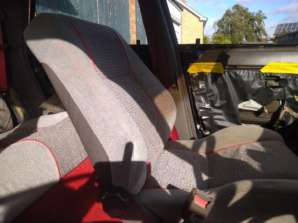

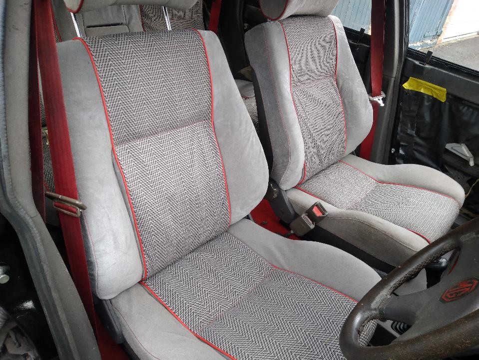

                    • Seats in,

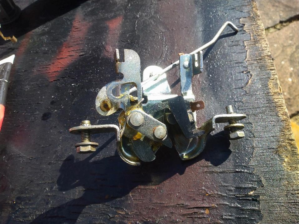

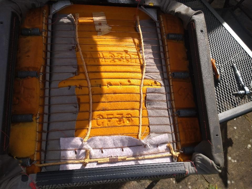

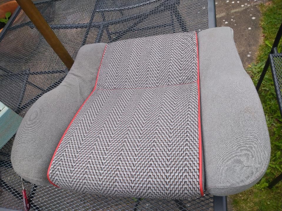

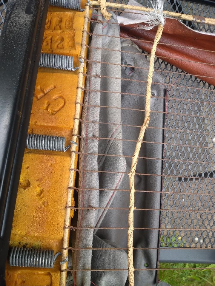

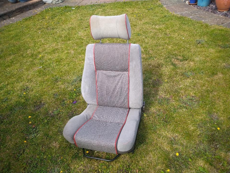

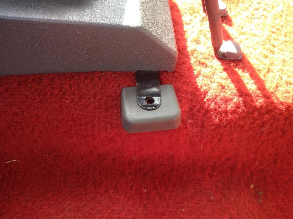

                      • The rear boot lock wasn't working due to excessive old grease, so cleaned that up and now all working properly, also started stripping the drivers seat base as I have new covers going on. These seat base caps are on early models only

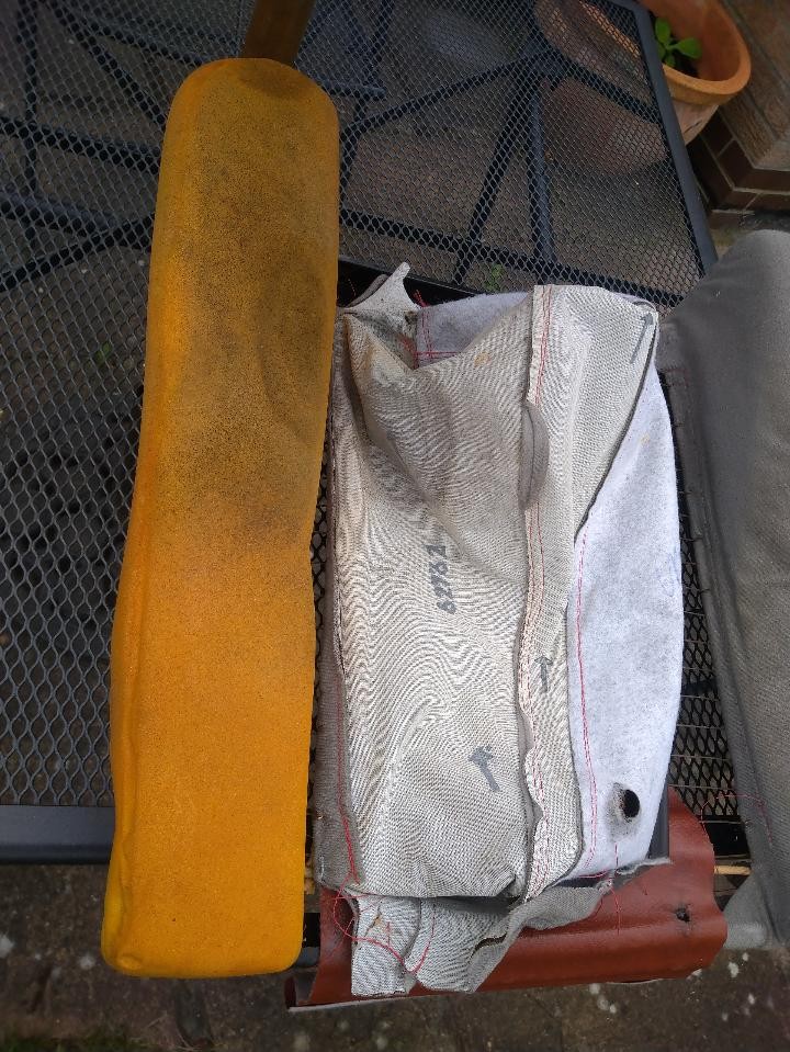

                        • More of the seat base
                          • All back together and in the car. The front drivers seat looks brand new and only one part of the seat base is old and needed cleaning. The seat back, escutcheons and rest of the base is new

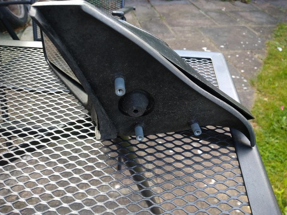

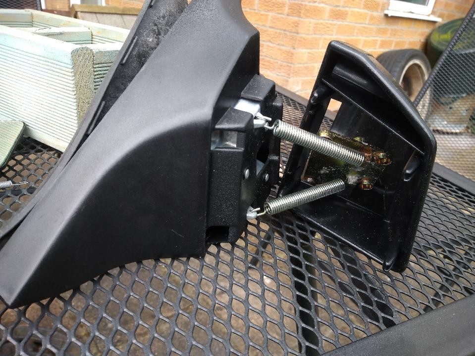

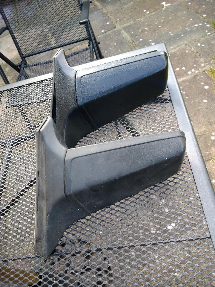

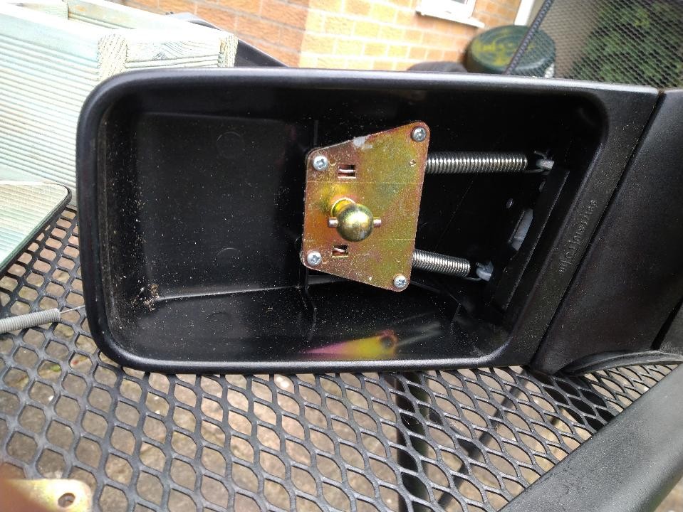

                              • Also sorted one of the door mirrors, my NOS ones are blank so i had to put a lever on from one of my old ones.
