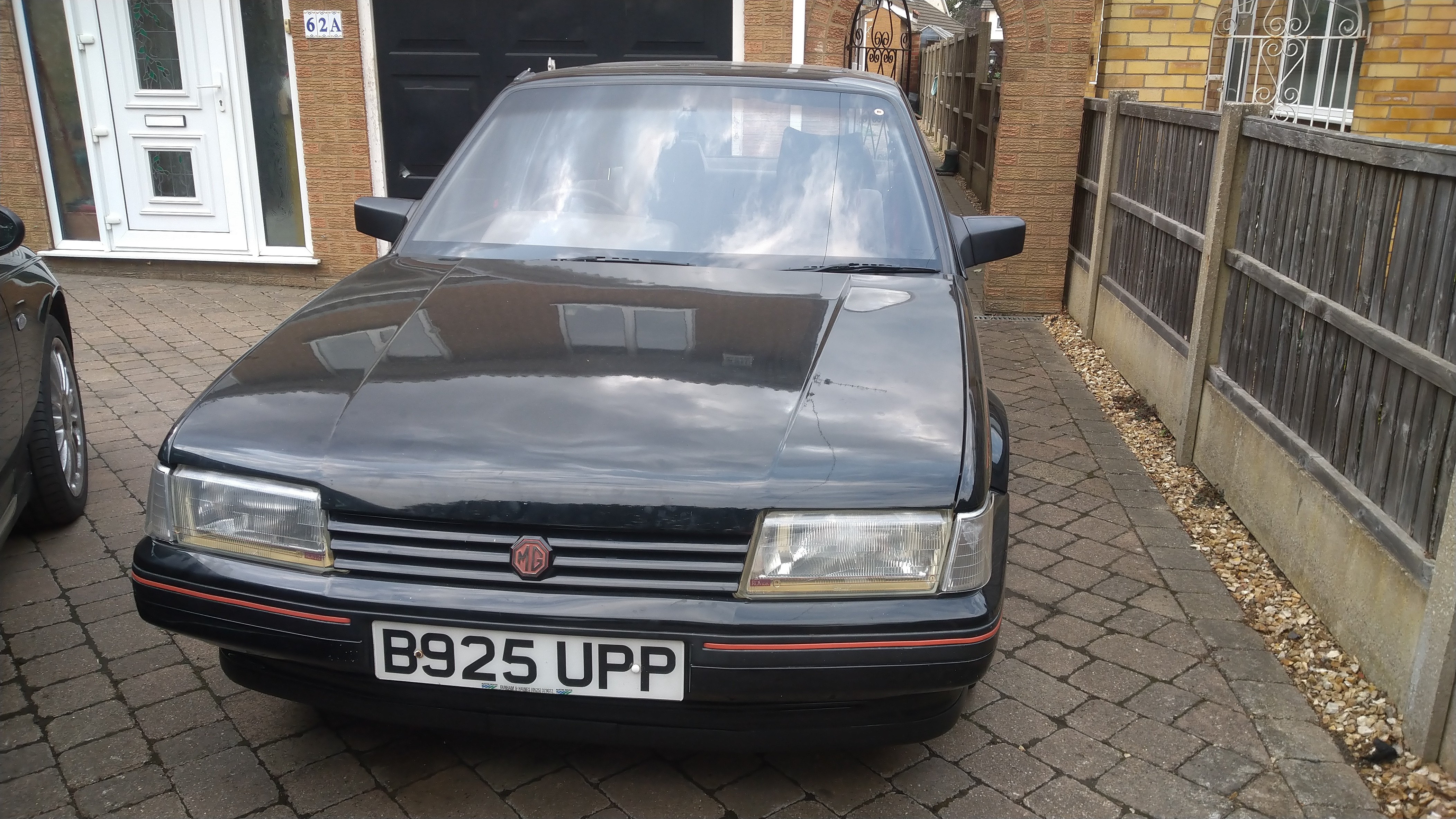

Also patched the mouse hole headlining, sorted the non working HRW, put the Rover headlight protectors on and started to clean out the interior of the car ready for its first MOT soon. Won't be needing this 2004 car tax either, that's the last time the car was on the road, also found this in the glove box. Everything is now working correctly so I should have time to MOT it next month with a bit of luck

Little more done today, sorted the non working offside windscreen washer, had to dismantle the non return valve it as it was stuck. Simple mechanism, cleaned and put back together and now working fine. Only had a couple of hours as some parts turned up for my consul that i was waiting for so had to work on that afterwardsLast edited by Jeff Turbo; 25th June 2022, 14:32.

Opened the boot and someones been keeping warm during the winter, right through my headlining buggar Removed the squatters house, sorted the boot lock, dash wasn't lighting up so sorted that, sorted the non working hazzards, fixed all speakers so they're now working. Not sure atm what to do about the hole in the headlining, I may just patch it as its at the back. The only things left to do are fill the brake fluid reservoir, drivers side windscreen washer is blocked, HRW, add more fuel, clean up and MOTLast edited by Jeff Turbo; 26th May 2022, 11:53.

Back on it today, attached throttle housing, put 3 gallons of petrol in it, connect battery aaaaaanndddd started up. Runs really nice and smooth now so I must have done something right, moved it out of the garage and drove it up and down the pathway to free up the rusty brakes etc. Can't believe it's been over a year since this I found this problem. I must get going on this car this year as I want to finish it. Does look good though and will look better after a major clean up. I may get the car detailed so it's spotless when it's getting near mot timeLast edited by Jeff Turbo; 27th May 2022, 15:49.

Well.......got the throttle back on and my fabrication worked but the breather pipe fell to bits when I tried putting it on, then it split half way down so that to change. Last day on this for a couple of weeks as I don't have the time after tomorrow but at least I've re-started the project. The only things left to do other than that are: changing the boot lock as it's very hard to move again, the rear speakers replacement, HRW tab to stick on, remove the paint on the rear spoiler, bit of paint here and there, put fresh petrol in it and hope it runs ok after that, iron out any problems, big clean up inside and out, polish etc then maybe an MOT in January. After that it's time to go and yep it's the wrong time after xmas so maybe in the spring

All done and waiting for the sealant to go off. Not the best fabrication but it'll work and you don't see it anyway. Luckily there was a guide hole so I drilled a small hole right through to match the other one then used a 7.5mm flat drill to about 5mm. Also undersealed the car so that was a dirty job, will be carrying on tomorrow

Project re-started today. Two rear tyres inflated and push out of its garage
Throttle body now attached, borrowed the battery from my 260 and after a while it started up but as the engine got warm I got the tell take signs of stale petrol. So I drained all 4 gallons out and didn't look at all good and the smell isn't pleasant. Pushing the car back in the garage with brakes that haven't moved for a year was interesting, good job i'm quite fit
As I hadn't looked at this for a long time I'd forgotten that the new throttle body only has 3 pipes coming off it, only found out when I connected it up, 2 water and 1 breather, there should be 2 so I will remove it again, drill into the body and make one.Last edited by Jeff Turbo; 23rd November 2021, 15:45.
