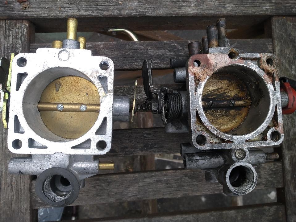

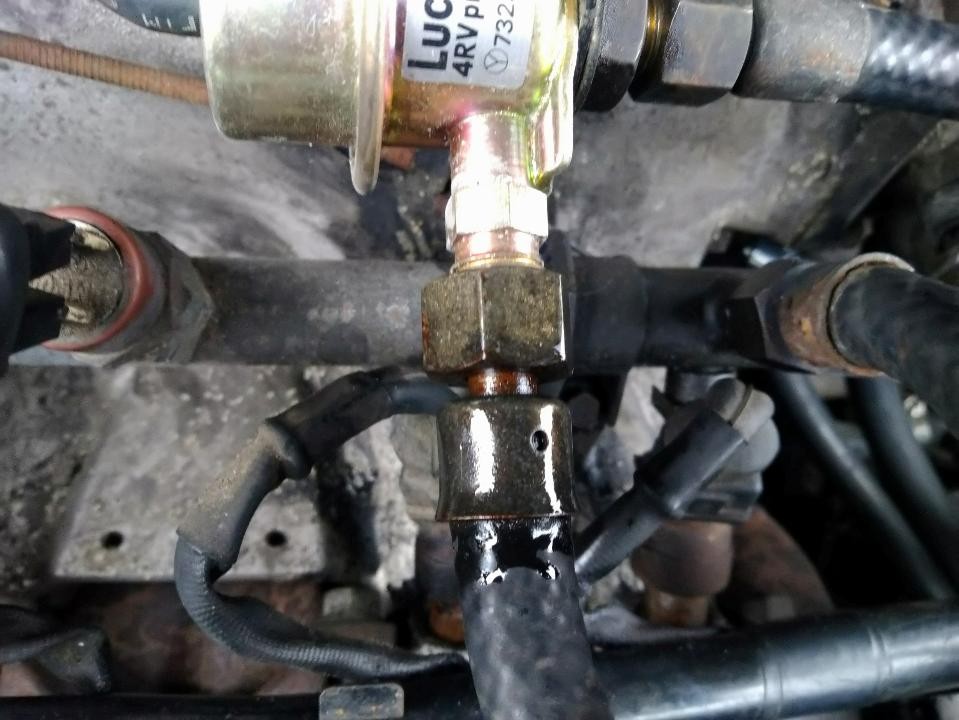

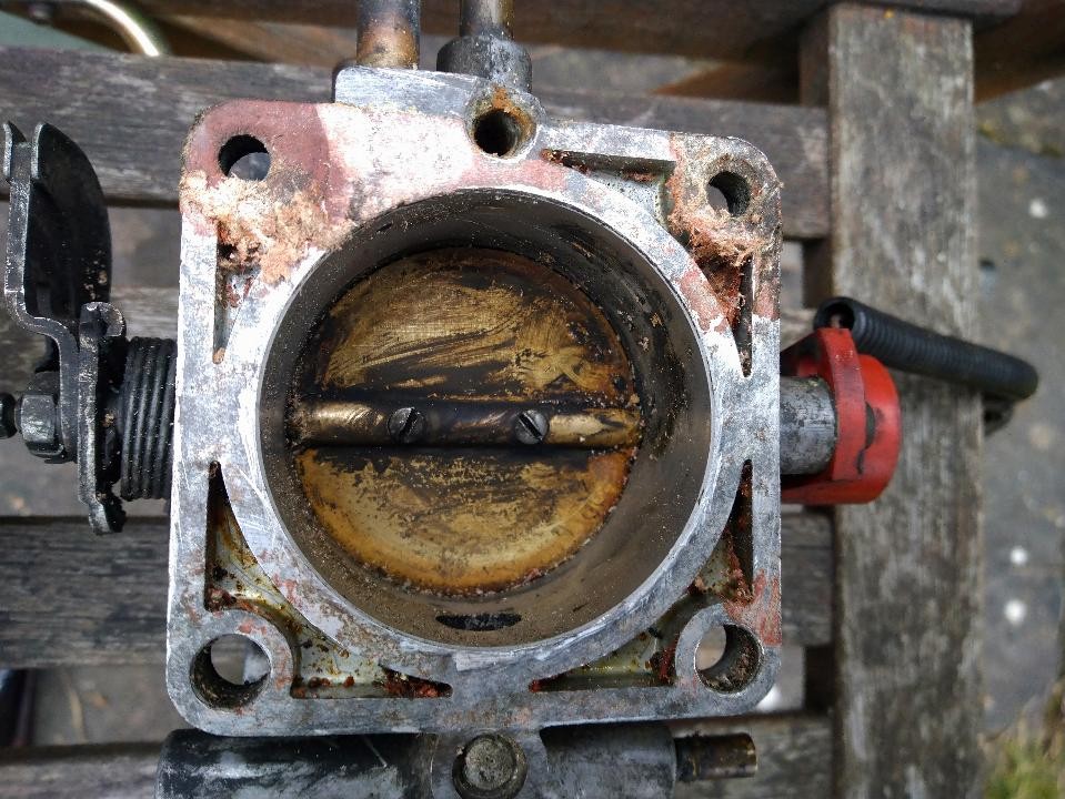

            • Finally back on it, Petrol flap opening sorted, door cards all finished now and tackling the non running. Put the jubilee clips on the car and put a donor fuel pipe into a coke bottle and found another leak so sorted that. The car started and revved freely for about 5 mins then wouldn't tick over. The fuel going into the coke bottle looked like thick urine so the fuel is also off in the tank. I also removed the crank sensor and cleaned it after that I connected up the return back into the tank and ran for a while the car wouldn't tick over again and starting to backfire Then I noticed water dripping out of the throttle body so I removed it, inside the whole thing was covered in black soot and black goo so I started to clean it and discovered a problem

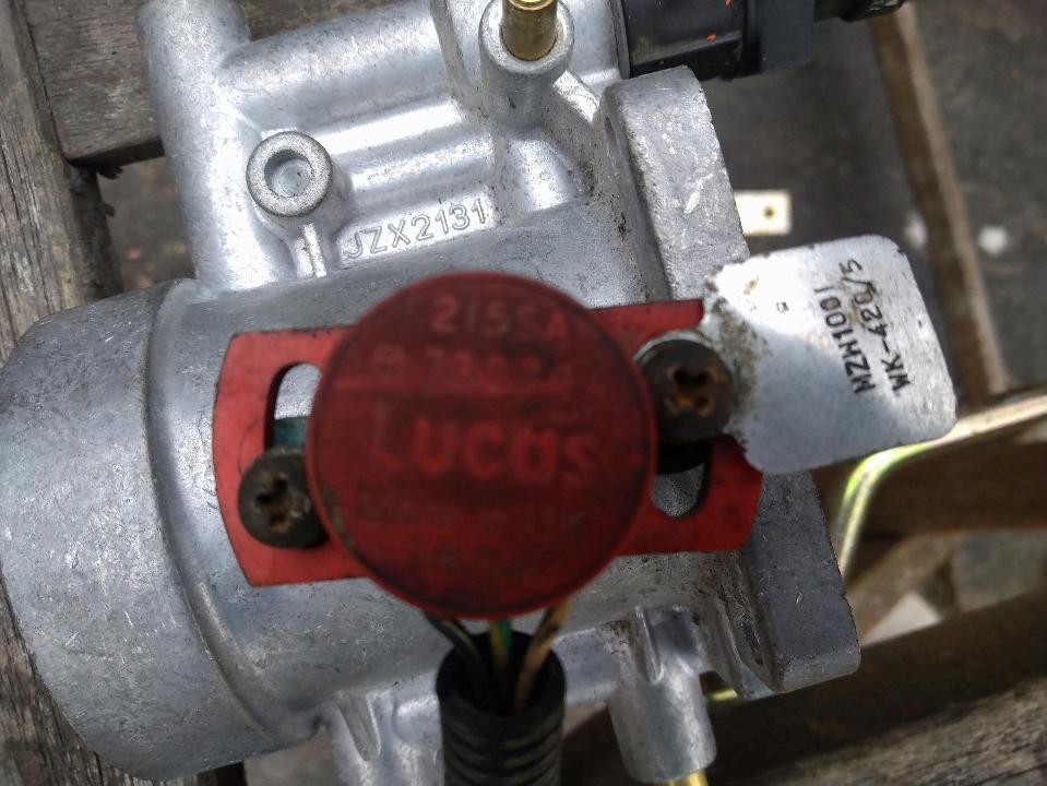

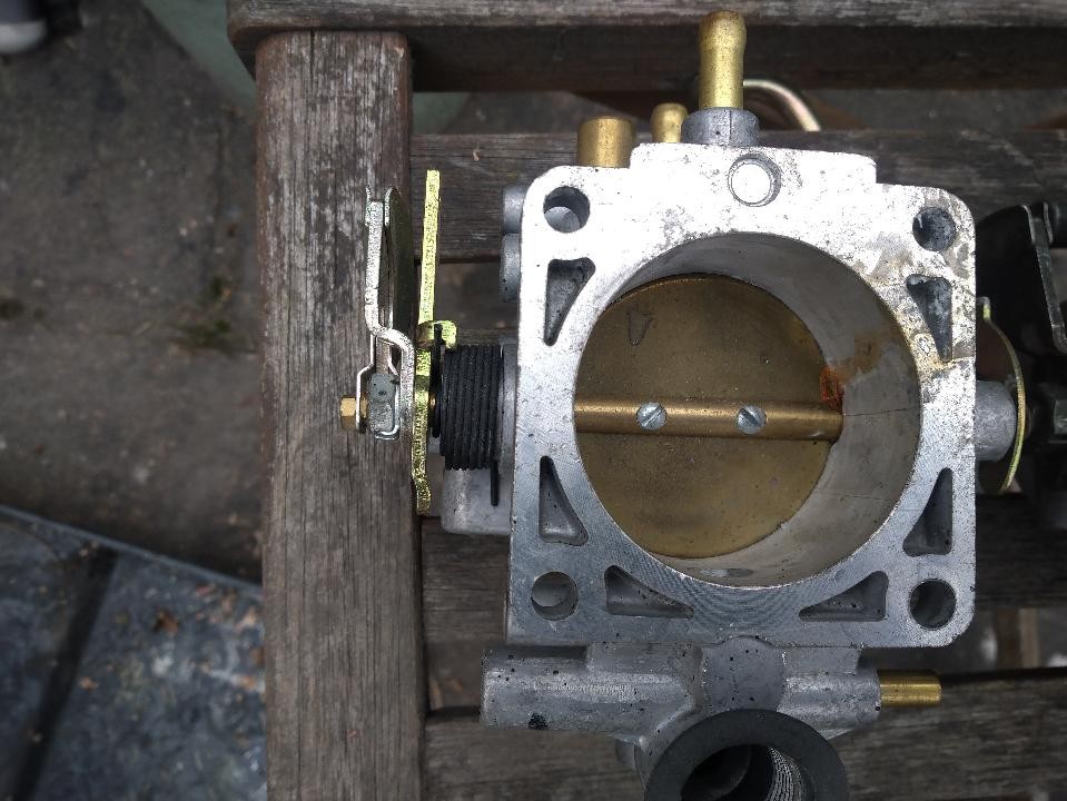

              • Spot the problem, the throttle body water blank has rotted out, luckily I have a spare but the potentiometer control has siezed in the housing and it snapped getting it out of the old one. I'm not sure atm if I have another potentiometer or throttle body somewhere so will have to search. There are two part numbers but both are the same thing, This one WZX1527 has poxidrive bolts and this one MKG10001 has allen bolts. Onwards and upwards

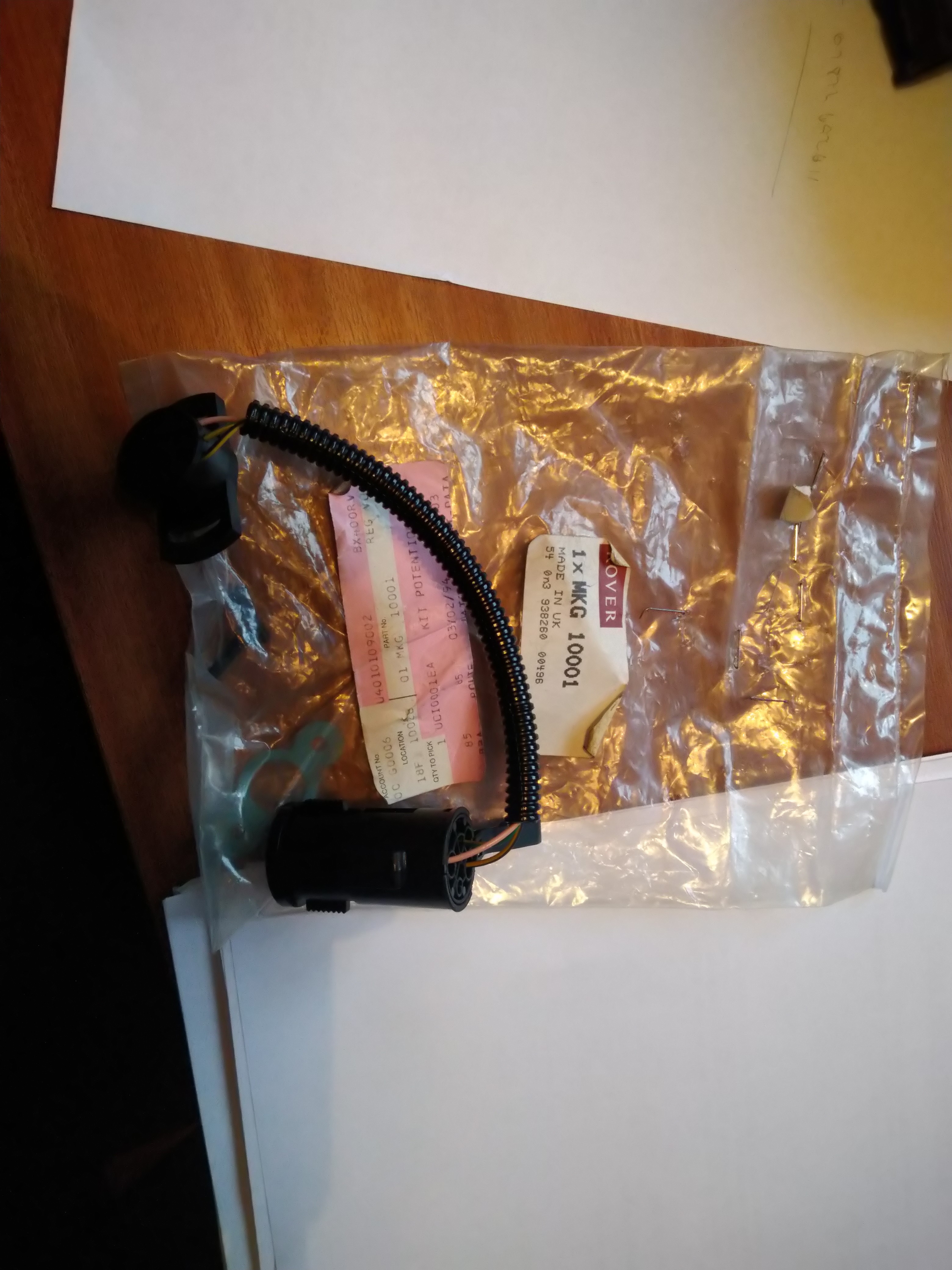

                  • Well I found a few of NOS ones in the end, one in Italy, couple more in Europe, another in Nottingham, Burlen also list one and one at John Wilcox in Wickwar using both part numbers. So after a long chat with John a new one is on its way up to me, always a long chat with John. Happy days. Next i will have to drain the old stale fuel and put fresh in it
                    • Arrived and very pleased as I can carry on
