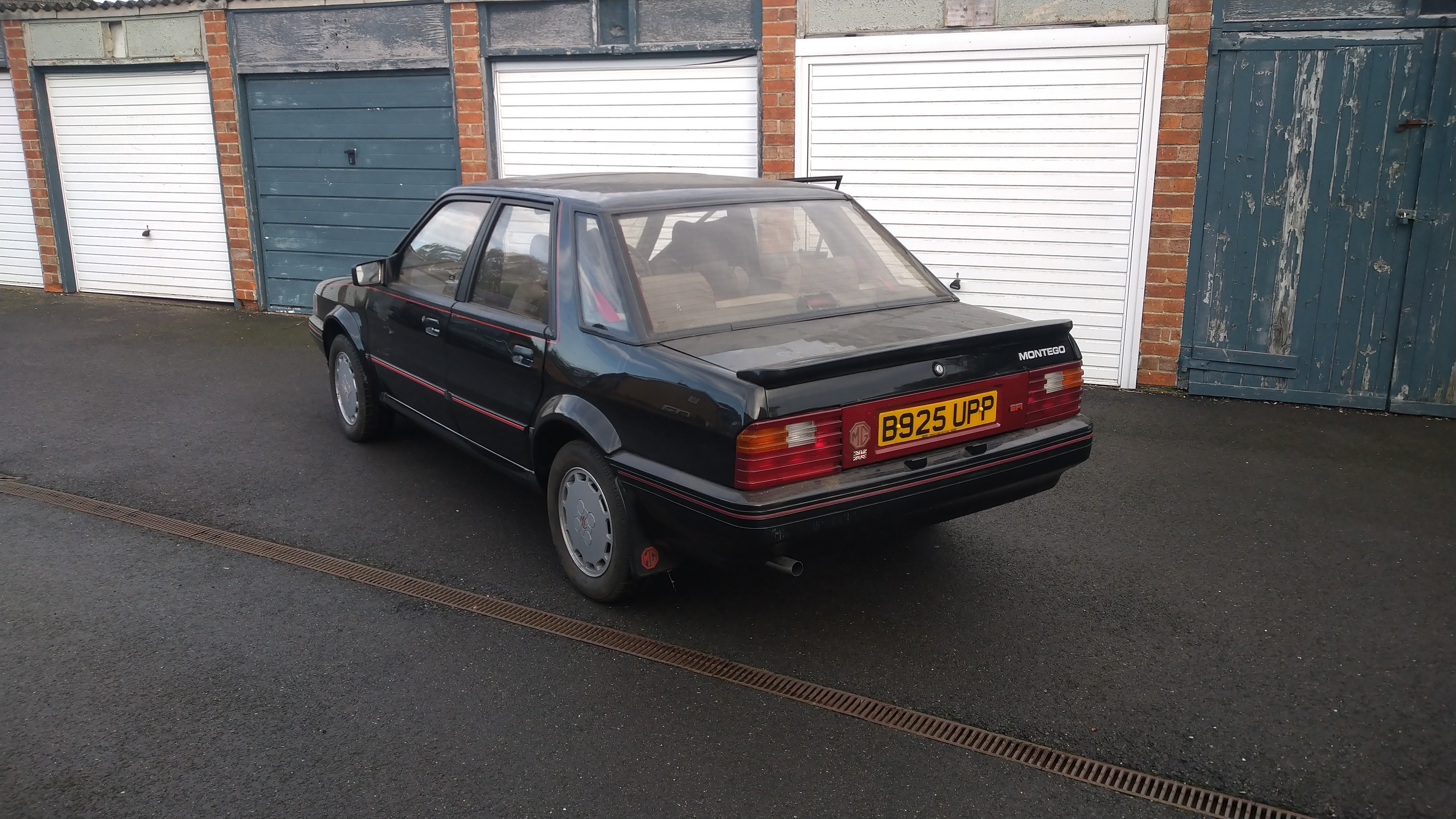

  • Took it up the road to free off the brakes again as it hasn't moved for a while. Checked all switches but the fog lamp switch and interior vacuum switch are sticking through lack of use. So a bit of on off on off on off freed them up a bit. Washers now working correctly as is everything else now
    Next is a major clean up and then booking in for its first MOT since 2003.

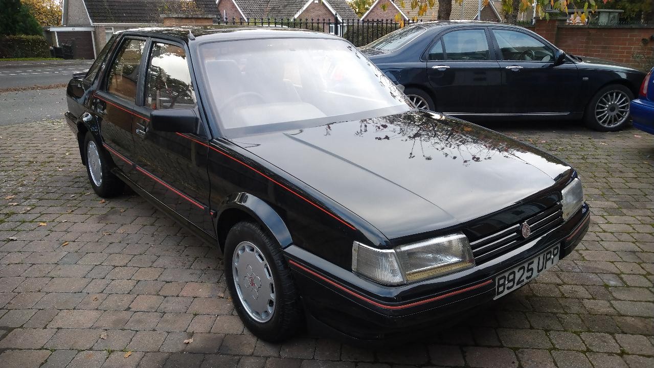

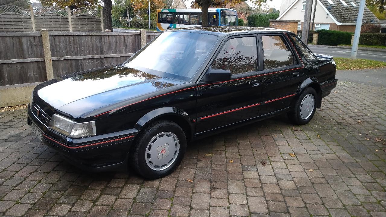

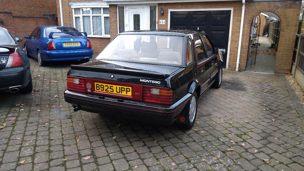

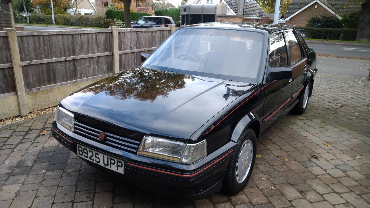

      • Now washed, polished and ready for its MOT possibly next week

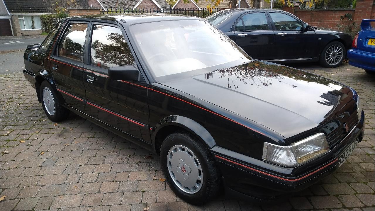

        • More while I'm at it, cleanest it's been for quite a while

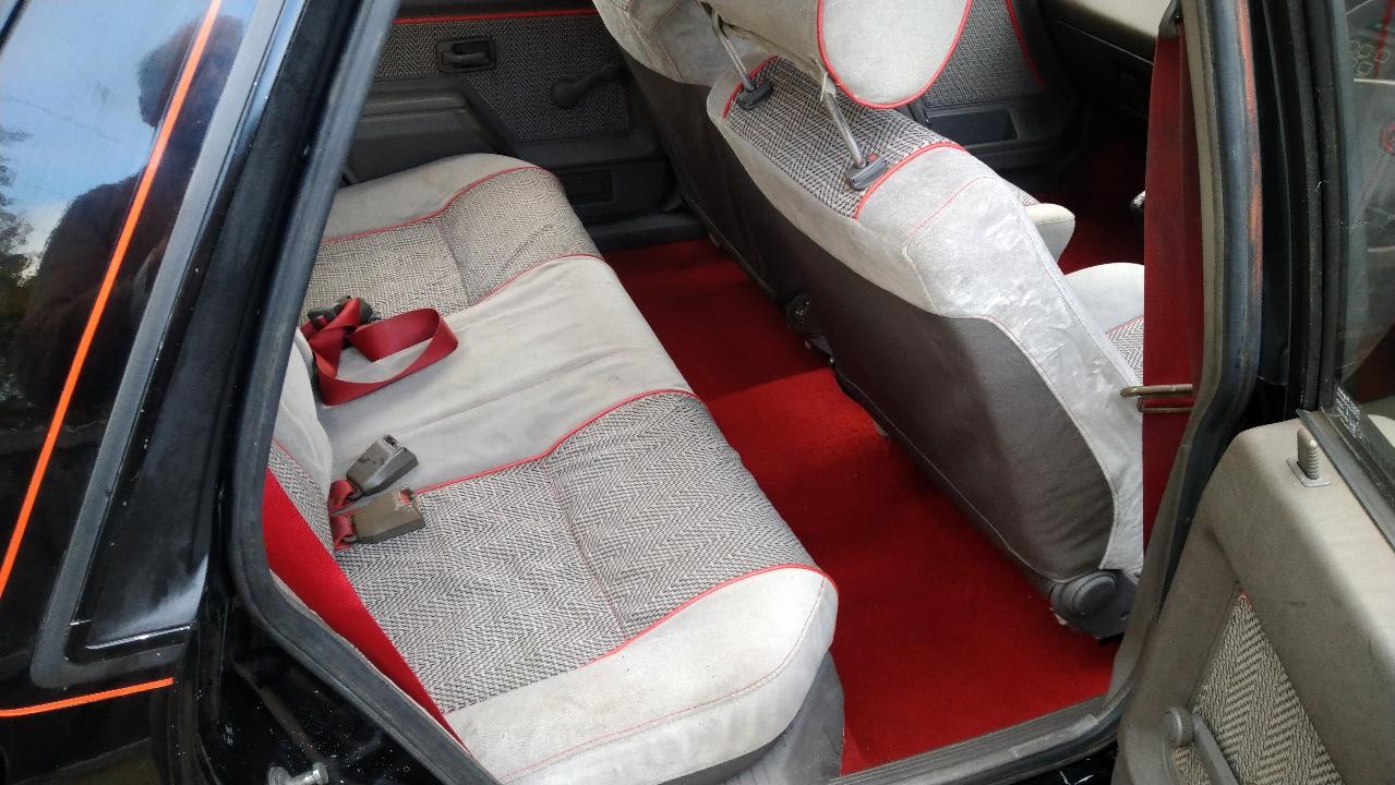

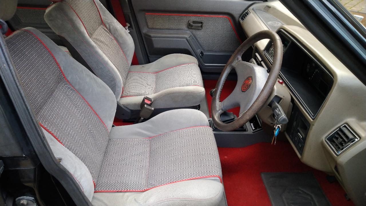

          • Interior hoovered and cleaned up, Date and time set, service interval also reset. I will clean up the steering wheel once it's passed it's MOT. Then I may use it for a little while to iron out a few things before it's up for sale

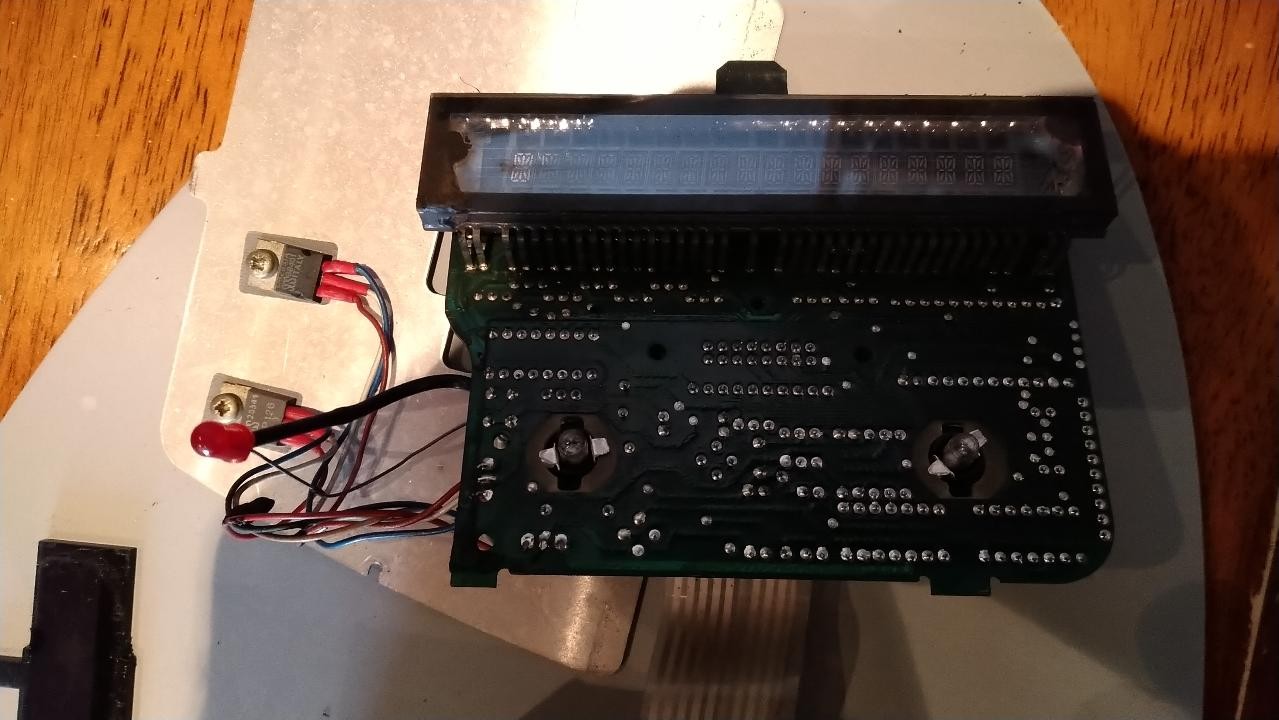

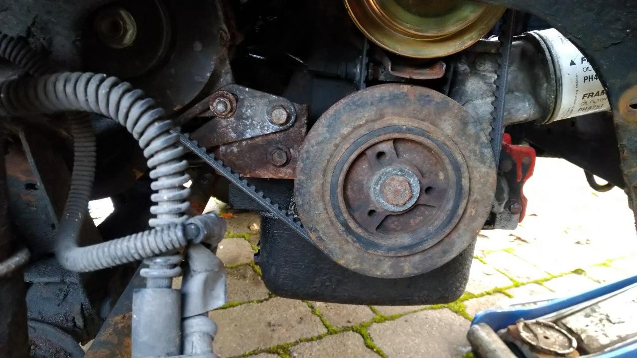

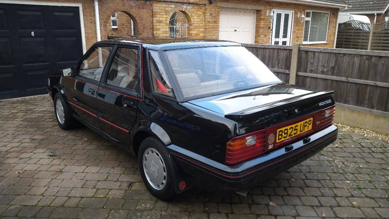

                      • And that's a pass. Car threw a hissy fit on the Lincoln bypass giving it an Italian tune up to the MOT bay. Milometer started flickering and the mileage wasn't moving forward but the trip was, then it stopped it's display then flickered, then stopped, nearside rear hand brake started binding again so I will replace the back cable this time instead of releasing the cable as before, HRW stopped working as the other side tab fell off and the alternator belt started to slip, as it's the same as an MGB I can got those quite easily. Both are available from Rimmers quite cheaply so those to sort next but at least it passed and i'm expecting a snagging list so this will be the start, won't be taxing it till the end of the month now so it gives me time to sort these few things

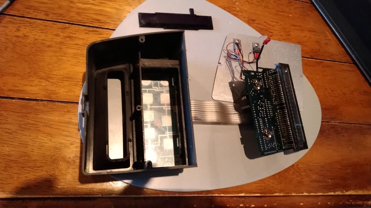

                            Yeah not too bad really, sorted the alternator squeal. As it's at the back of the engine you have to remove the front wheel and splash shield just to get to it. I Couldn't have tighten the adjustment nut enough as I replaced it when I did the cam belt and it was in it's lowest setting

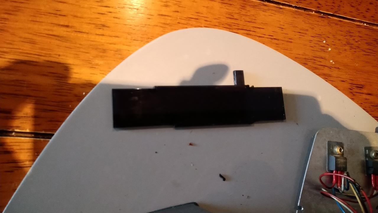

                            Also sorted the rear handbrake cable and replaced the mileage display.
                            I had another but it was missing the display cover so I had to strip both down, all done now and it's doesn't flicker atm but I won't know if its fixed until I drive it but the buttons do now work as before they had stopped
