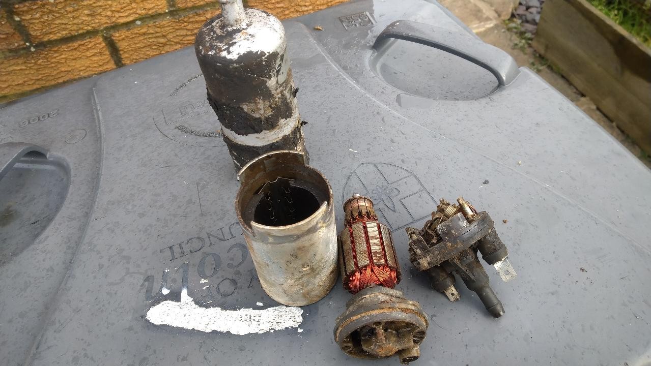

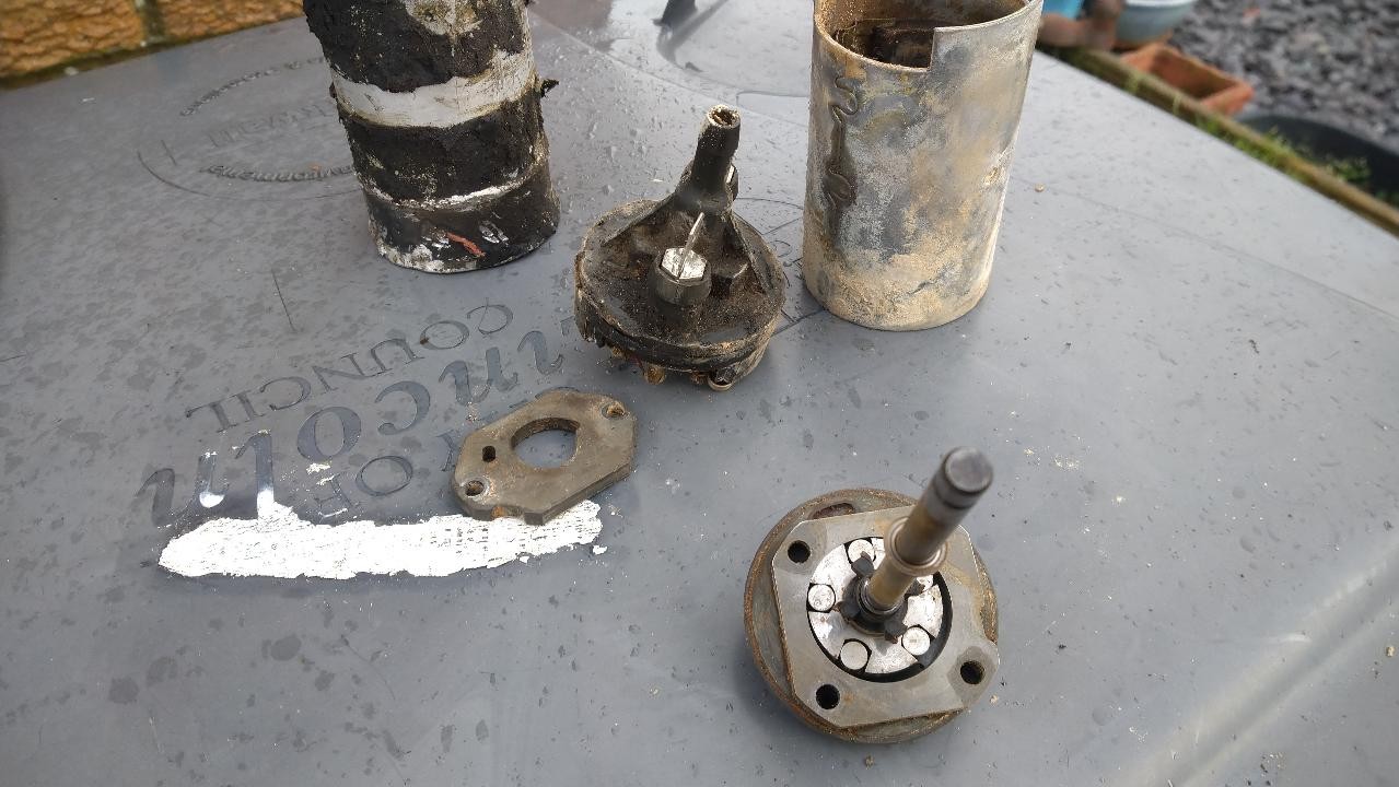

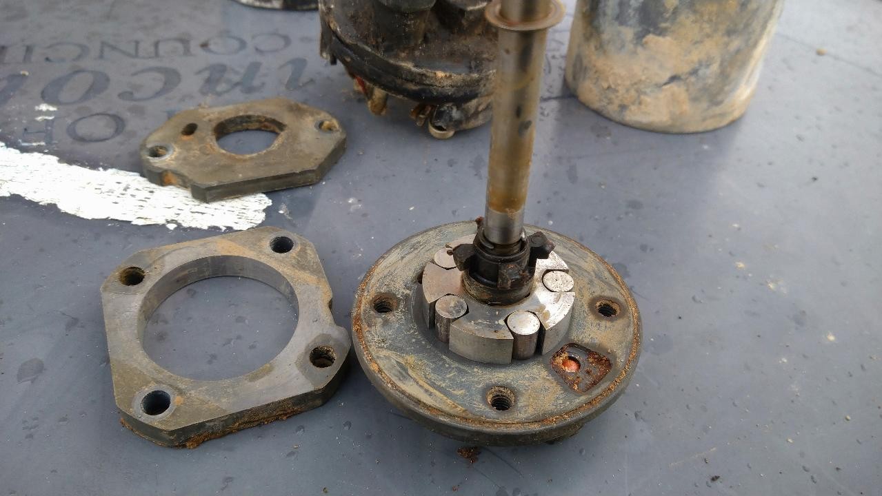

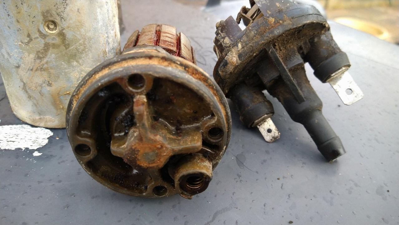

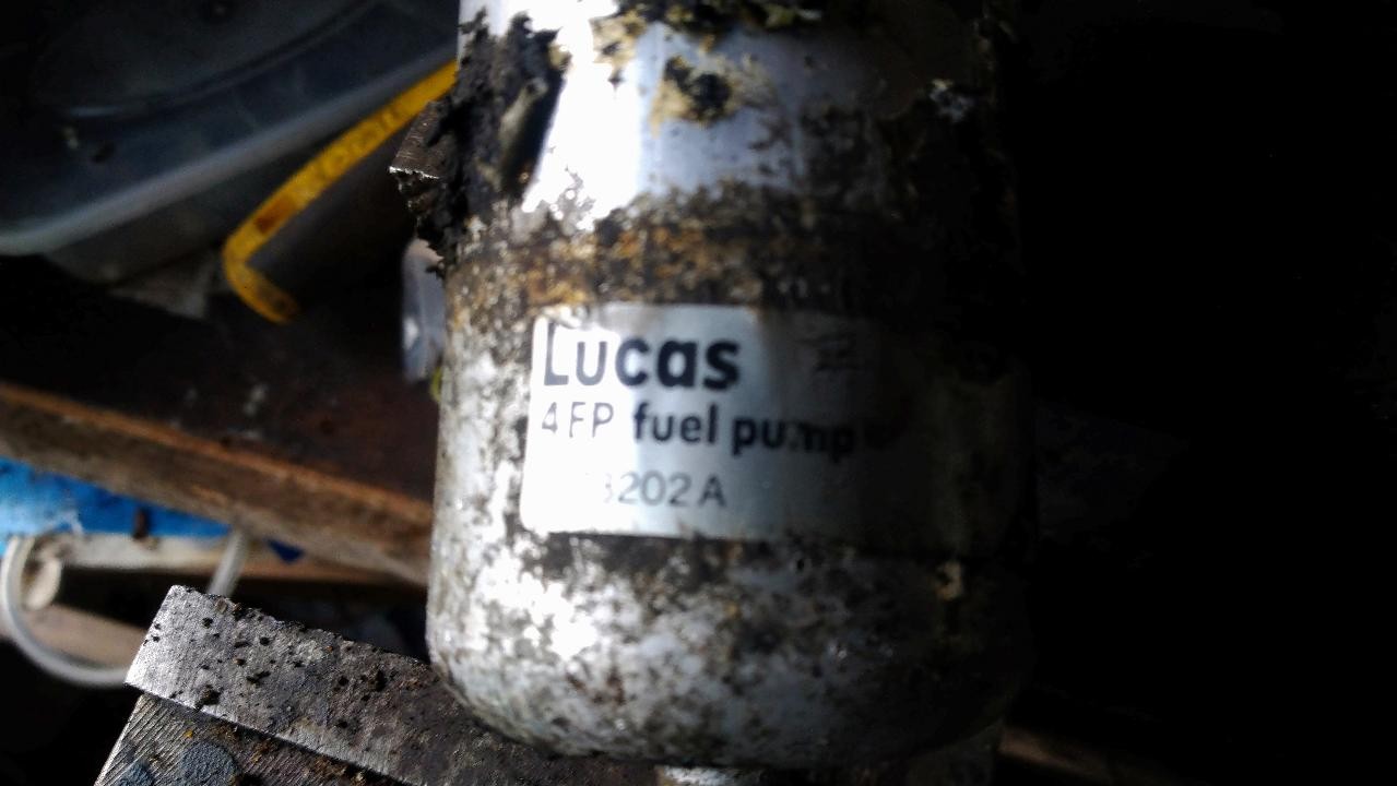

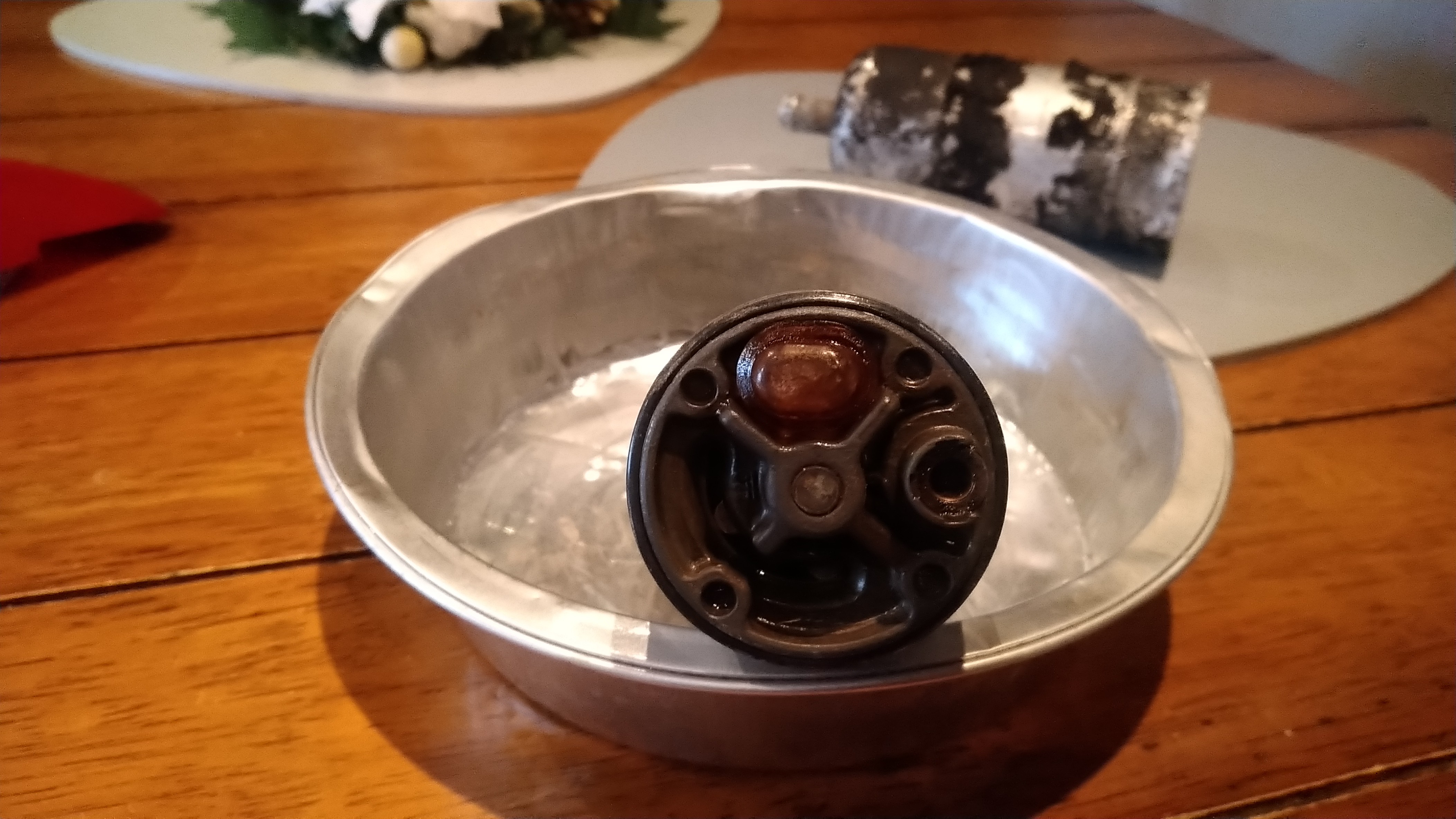

        • As I had a little time I decided to strip down the fuel pump that was seized. There was also a small plastic bubble that fell out so I will research where that goes but I'm sure its in the inner housing somewhere. I don't yet know what that does. The reason it was seized is its full of crap as you can see from deposits of rust from the tank in picture three. Once I started cleaning it all freed up so I will completely strip all down, clean and put back together as the brushes are in good condition and it looks like only dirt inside. When I've sorted this I will be adding a filter between the tank and pump

            • Cleaned and all back together and checked if working and it is but the top seal is perished and a tiny bit of petrol dripped out so I binned it but i do now know how to strip one down etc without having to buy another

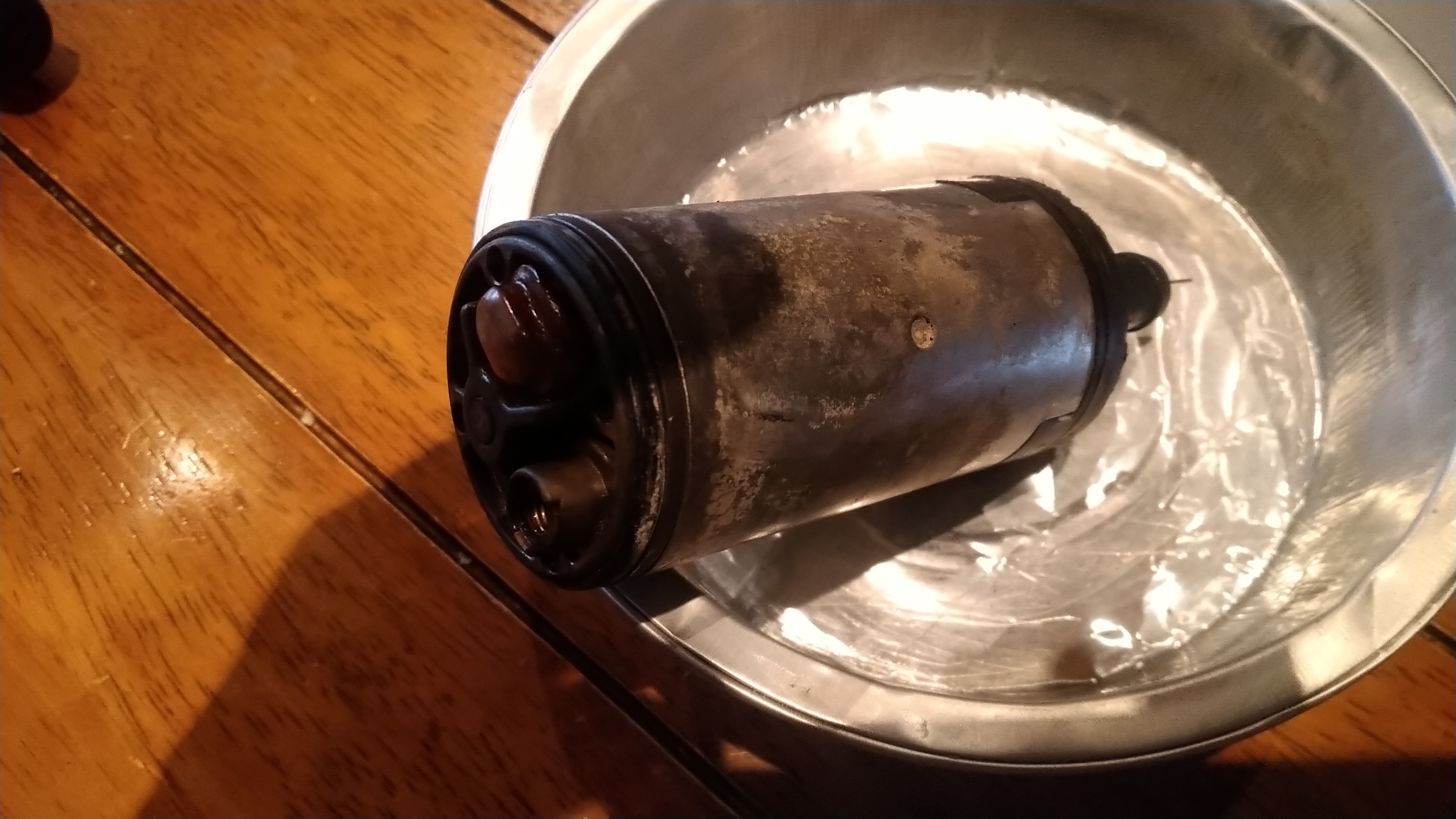

              Had a second look at the new fuel pump as i couldn't understand why it wasn't sucking up. Added a pipe to a clear bottle of coke with petrol in it and connected to a battery. blowing air back into the container so connected the other way and its working now. The connections on the pump are the wrong way round so I sorted the wiring out, connected up the pump and the car started so I took it up the road without any problems.

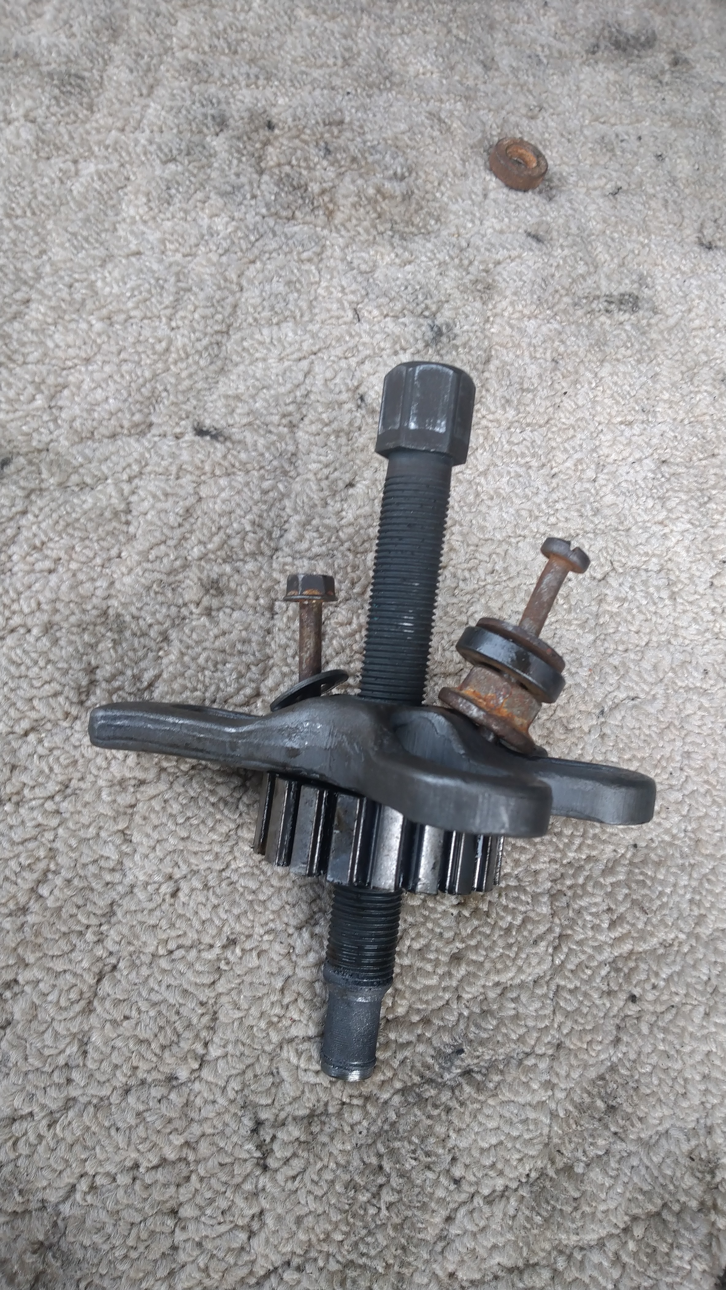

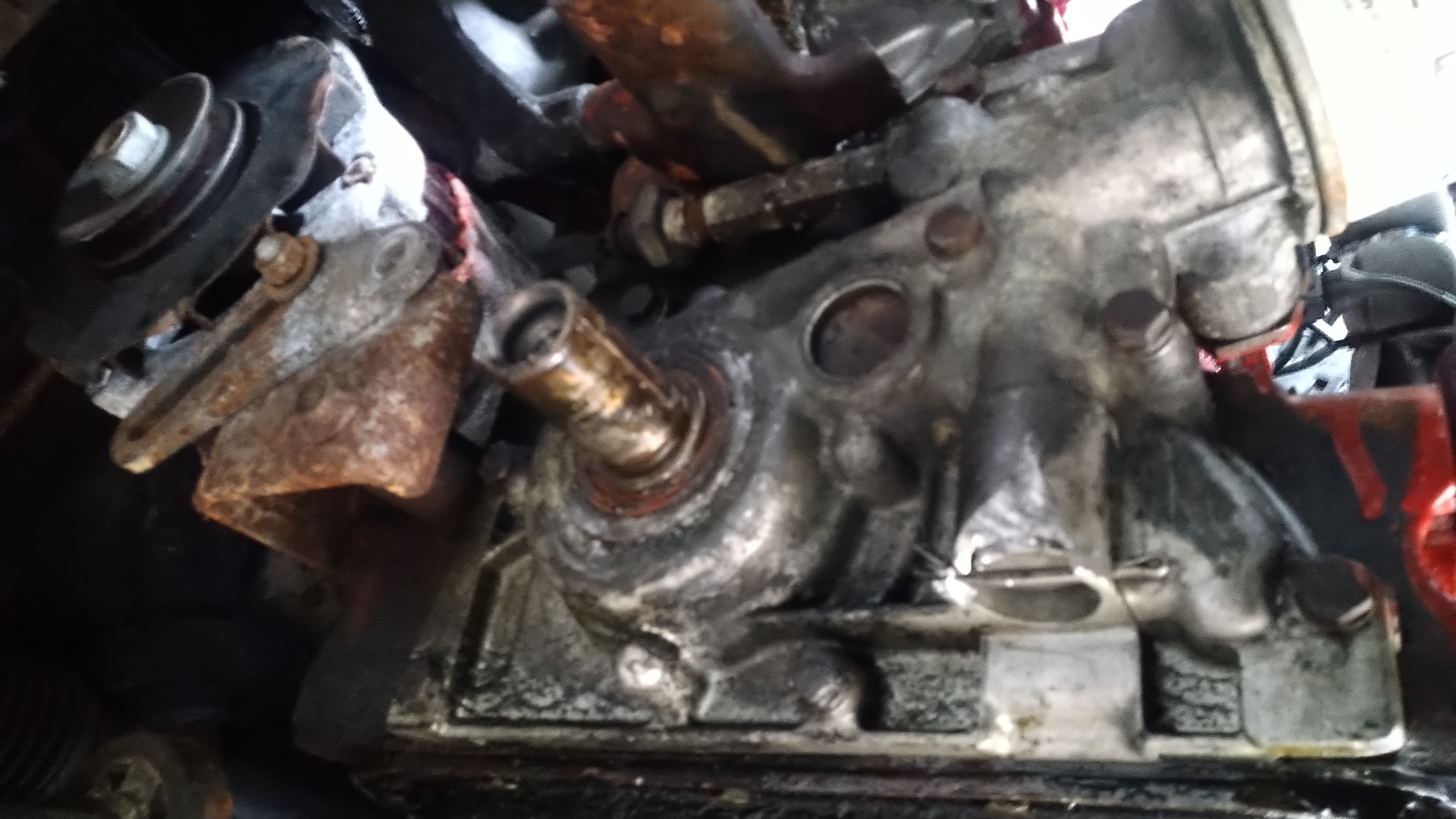

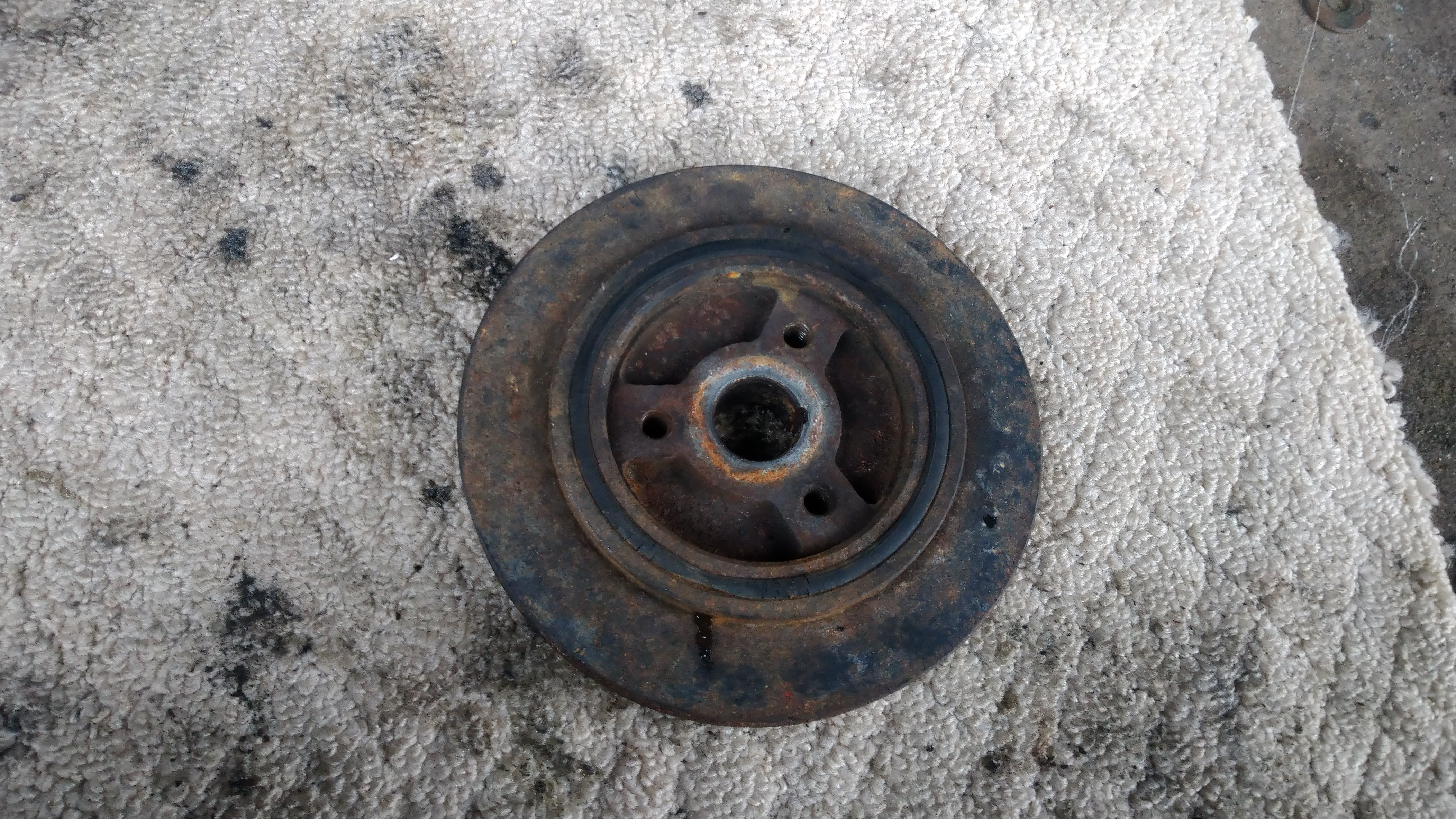

                            • Oil pump leak started and that was a pain removing those, now removed and also the oil pump. I've also cleaned up the block face. Have to add a couple of thing to the new oil pump do I will do that tomorrow as my hands are hurting. I also hurt my back pushing my sons car back into its garage over a ramp Monday and it's just recovering. I must be getting too old for this now and this is why it's my last montego
                              • Definately not the best time of year for fixing things outdoors...unless you are young & daft, in which case you are putting aches & pains in the bank for later Looks like the special tool made it see thē light in the end tho...
