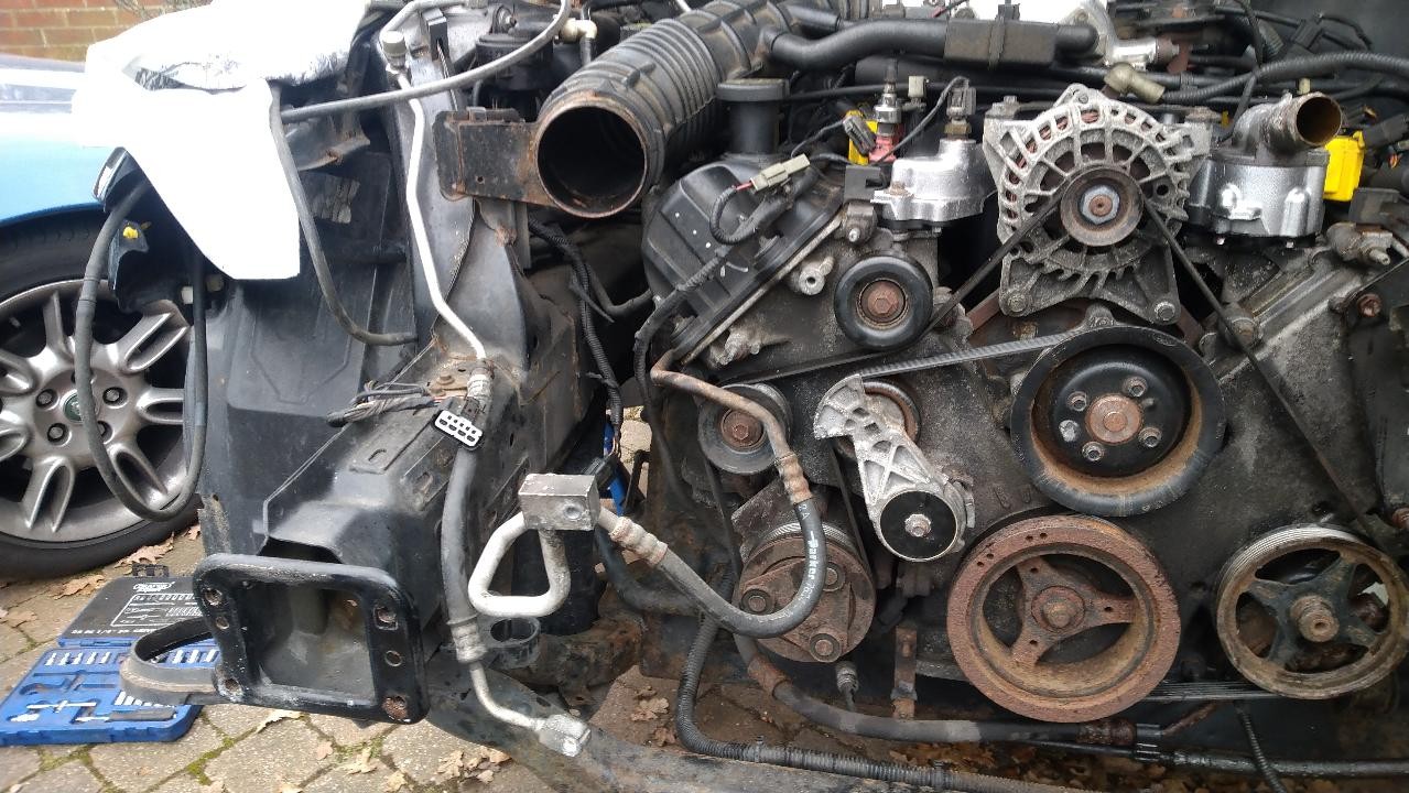

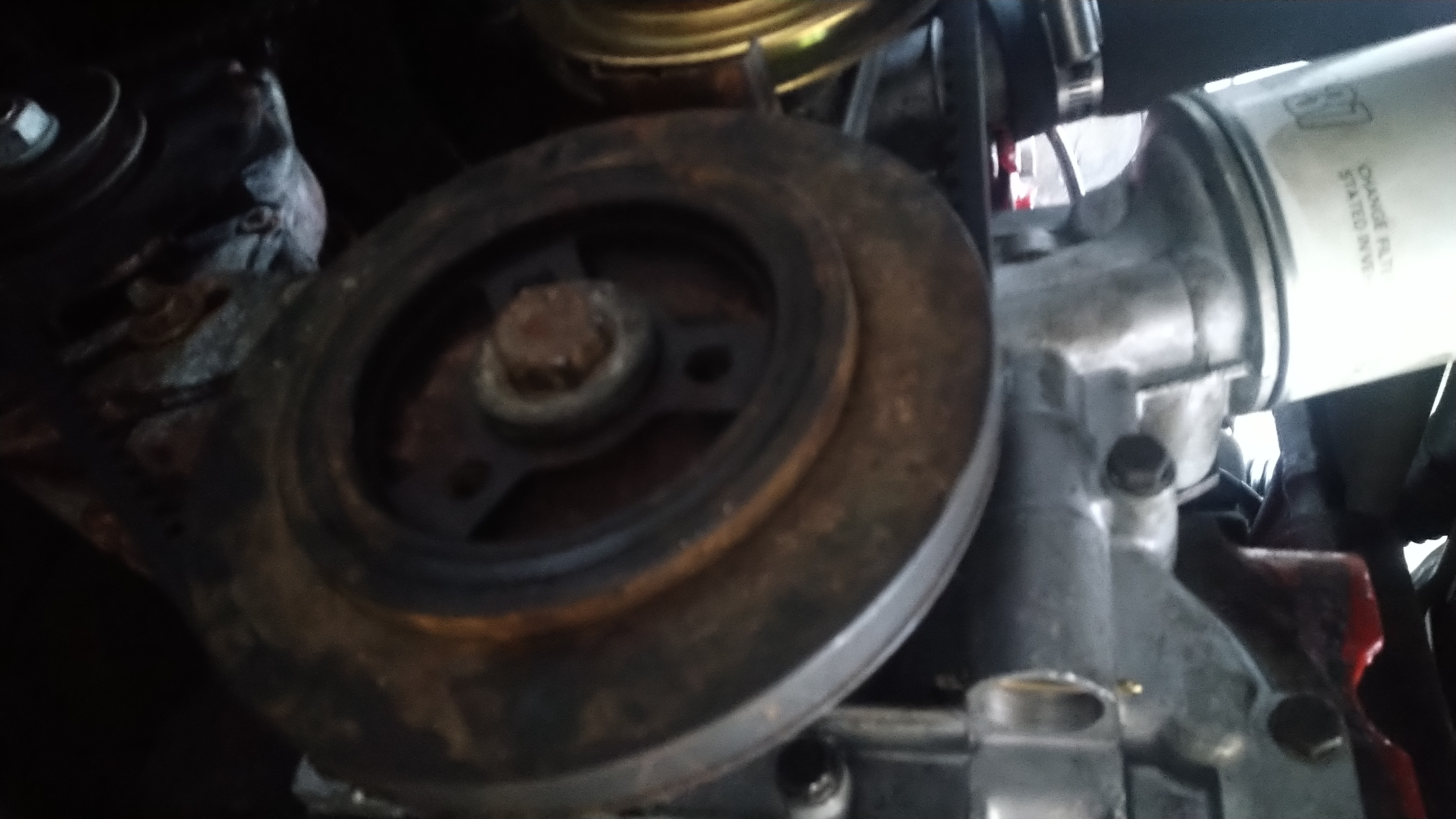

    The outer pulley I removed quite easily using that crank pulley tool but the inner cog took a bit more and I couldn't use the bolts from it as they were too large so I found a couple from a large box of nuts and bolts I have, I also had to use a large crowbar a bit at a time but its off now.

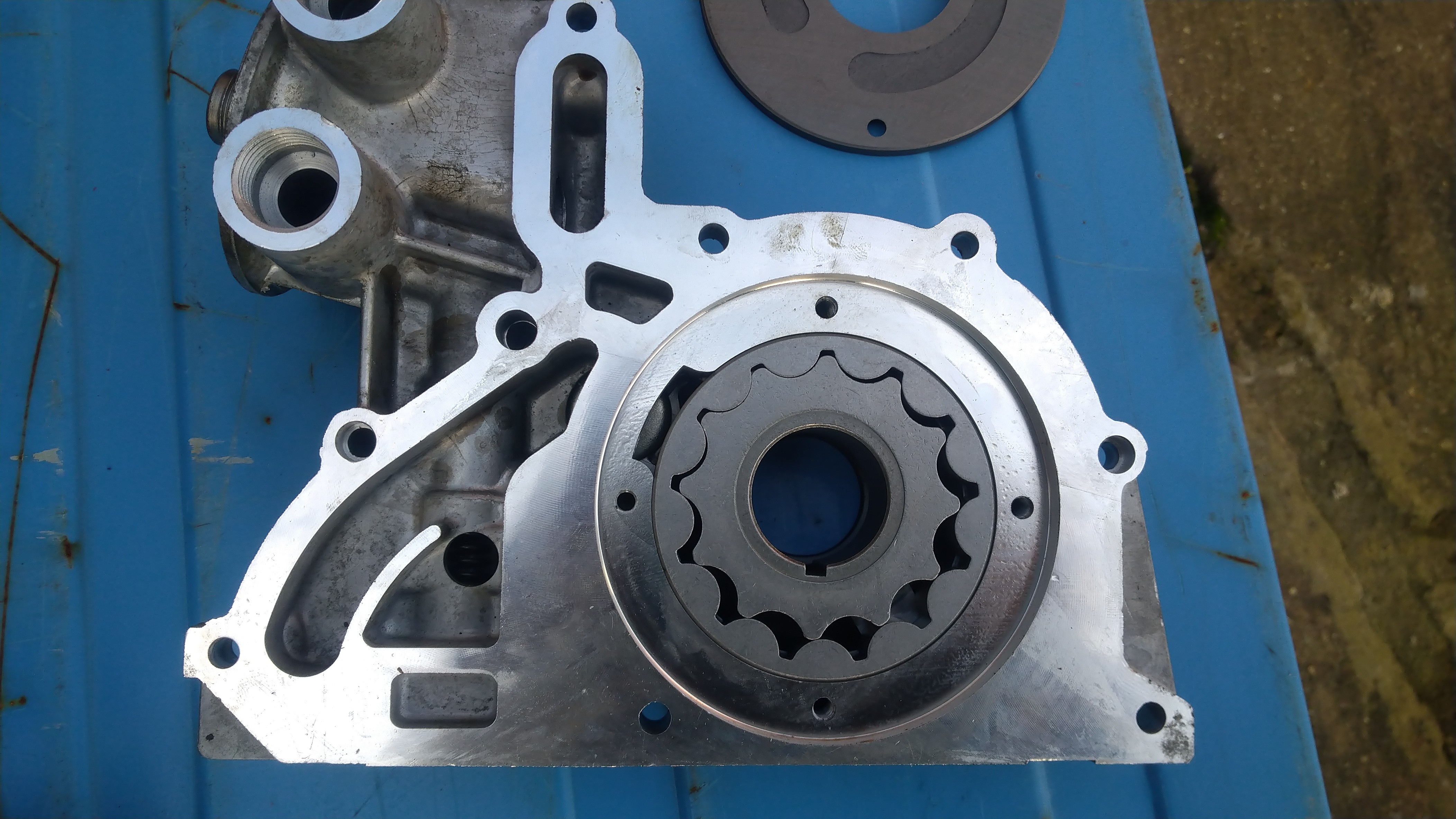

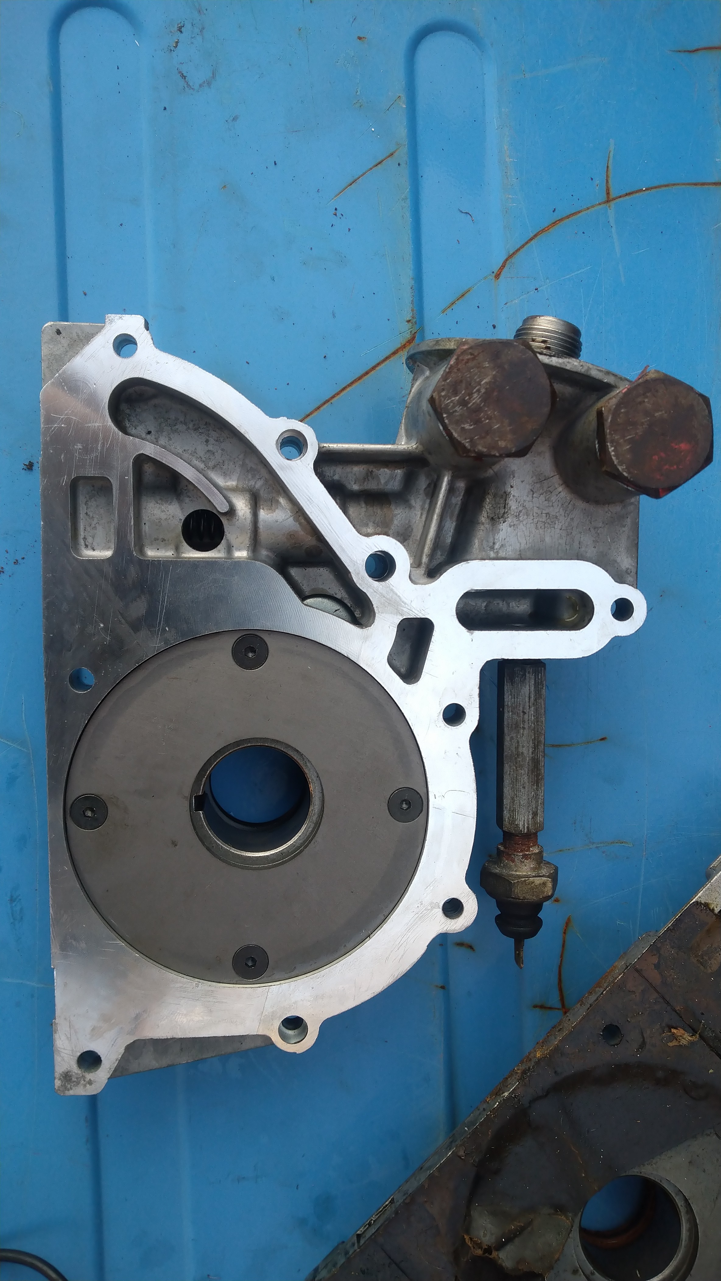

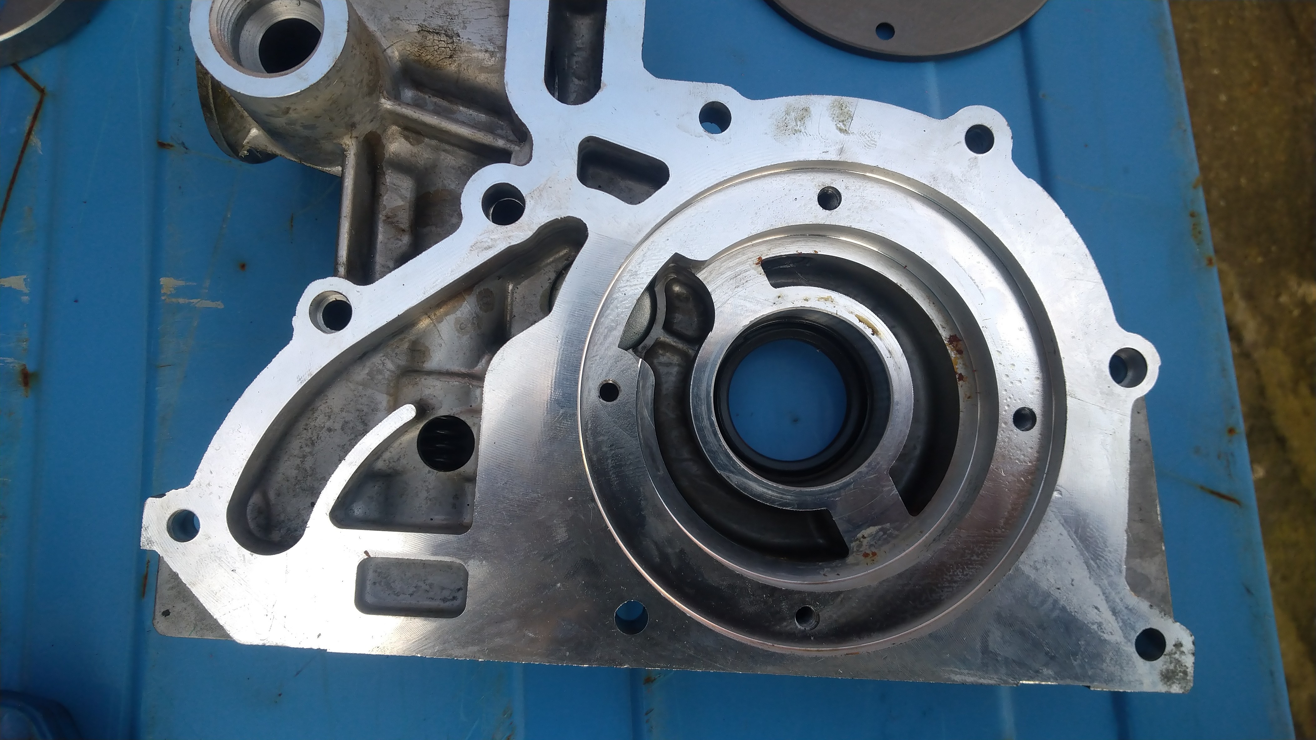

    • Had an hour to spare and as the pump cogs didn't move so I stripped it down. Bit of hard wax stopping it working and some iron filings on the cover, so cleaned, leveled off any burrs (there were a few) and put back together after lubricating the cogs. Nice and free now and waiting to go back on. Once on I will prime it first before putting the filter on so there's plenty of oil in it on start up

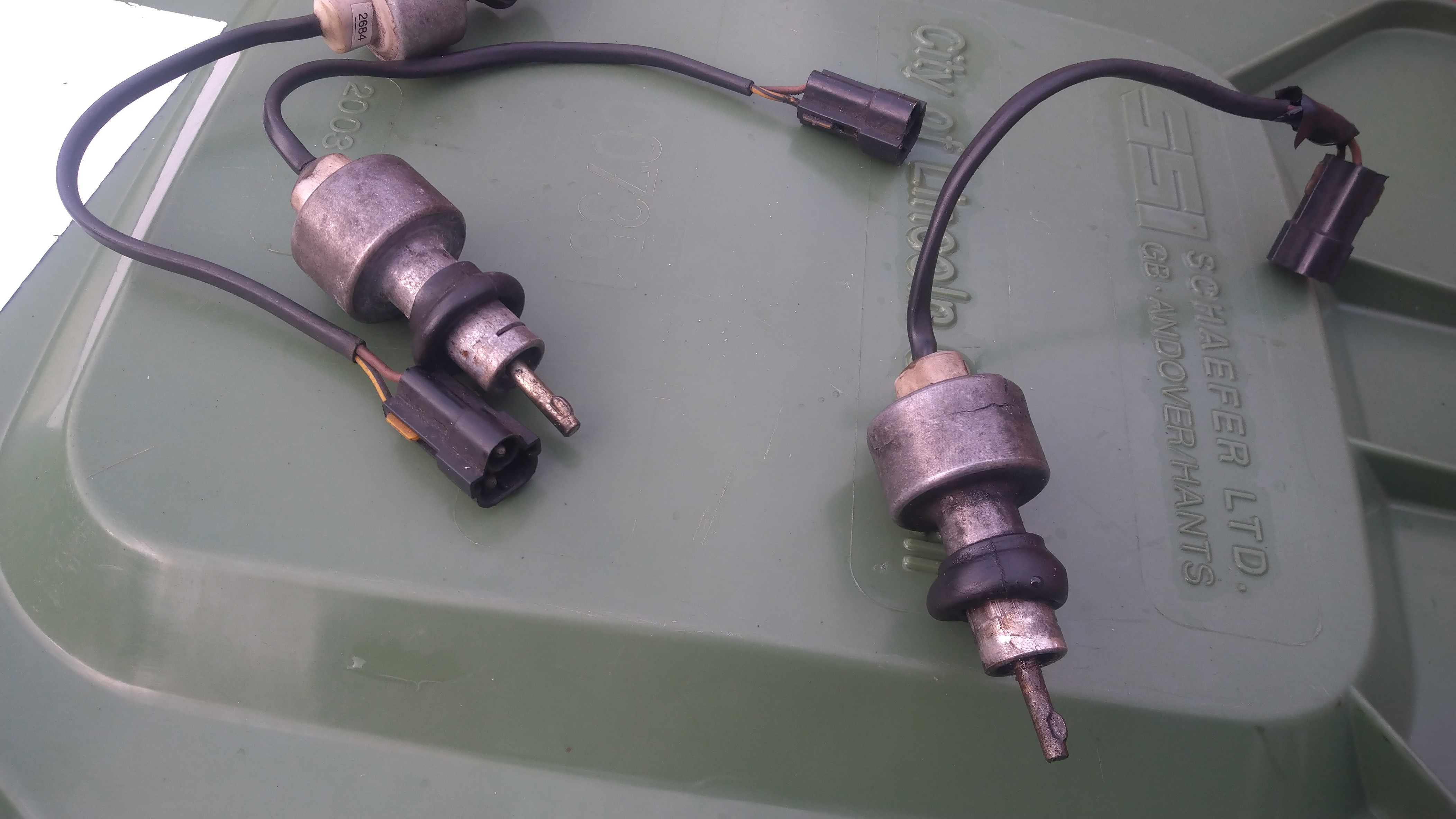

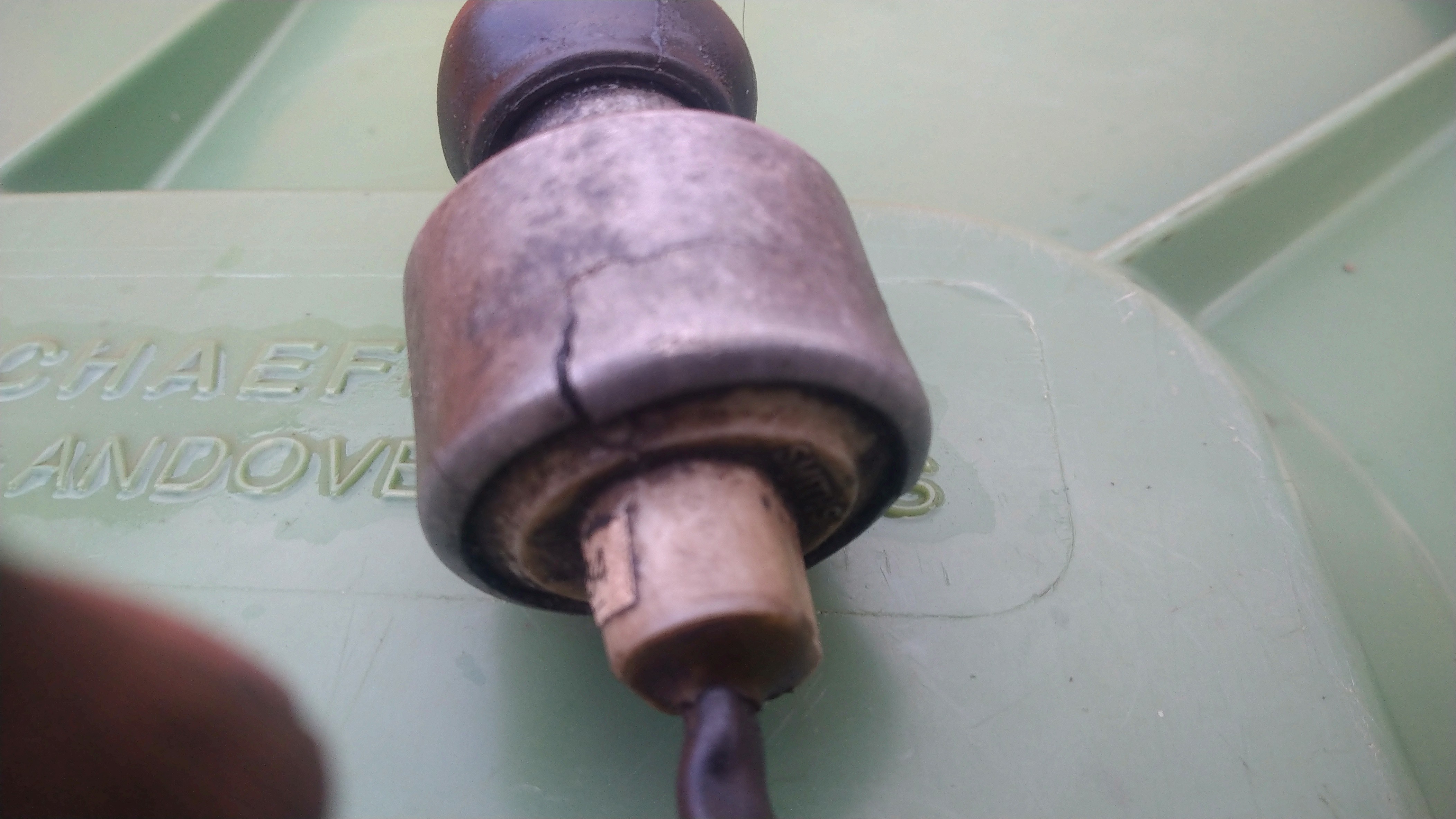

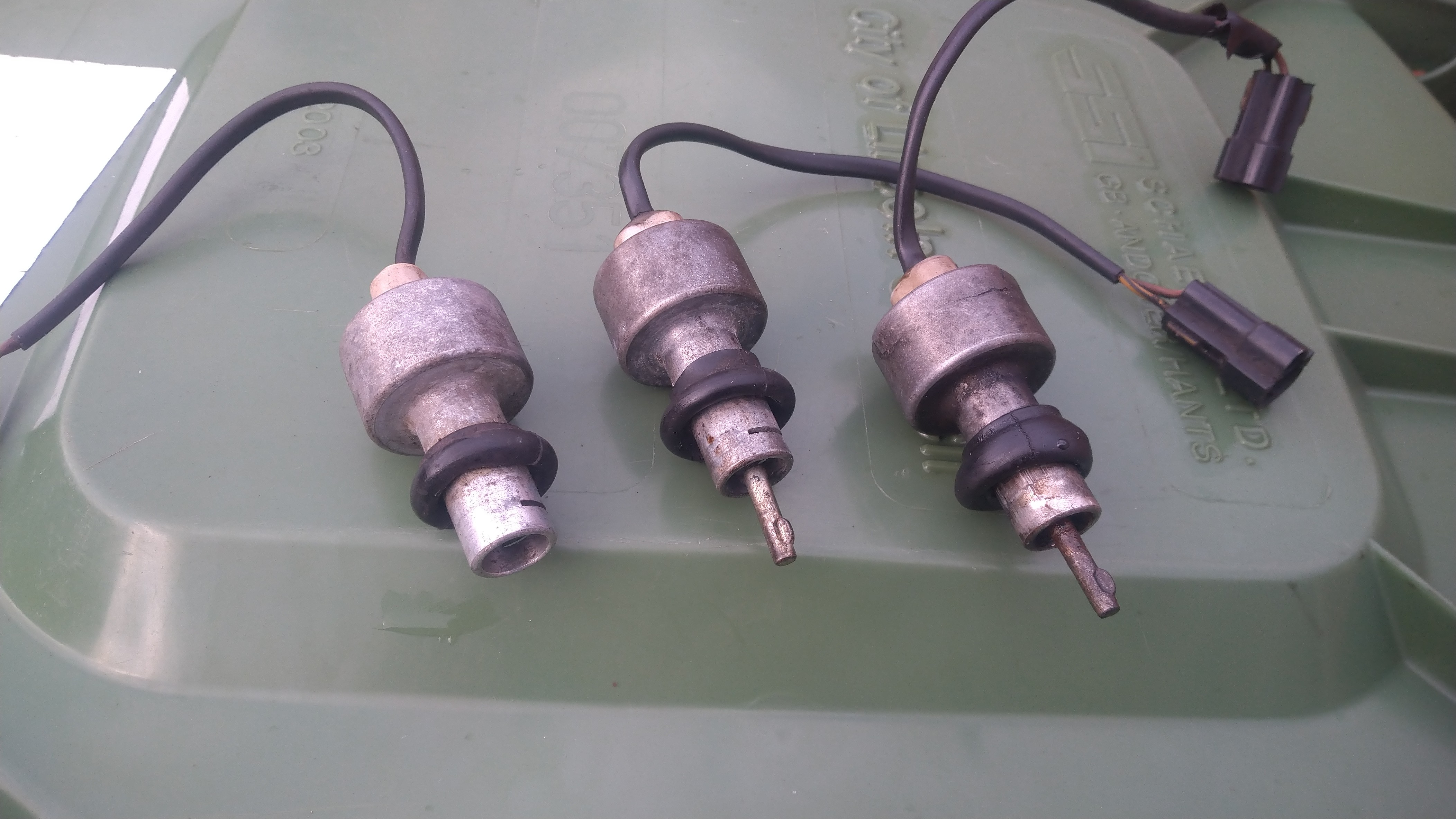

      • Pump back on and cambelt etc on, transducer has a crack in it and that's a possibility why it's intermittent so replaced, front brake pads replaced, carriers cleaned up and pins re-greased. Cars back on the floor waiting for fresh oil and a battery charge

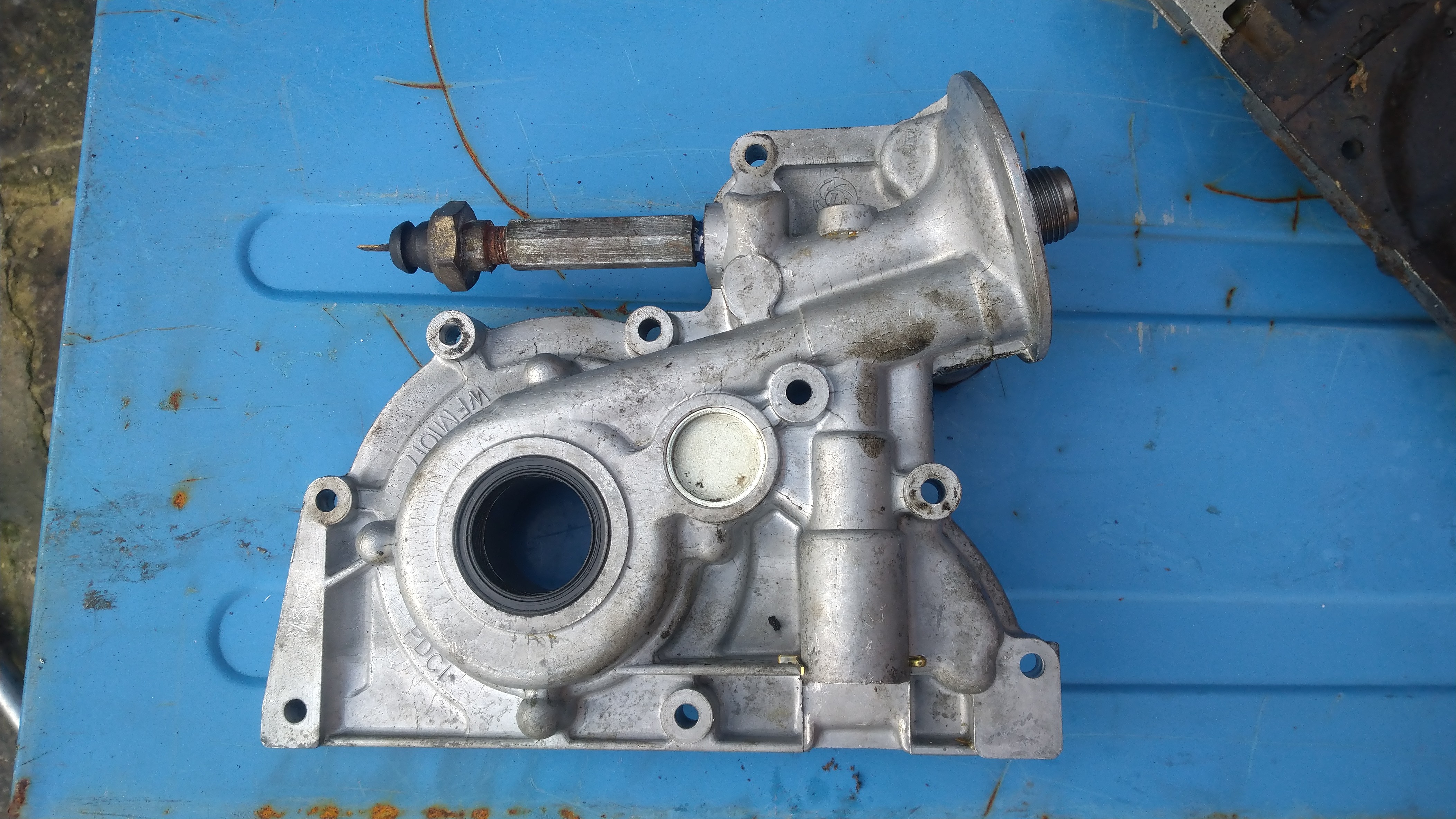

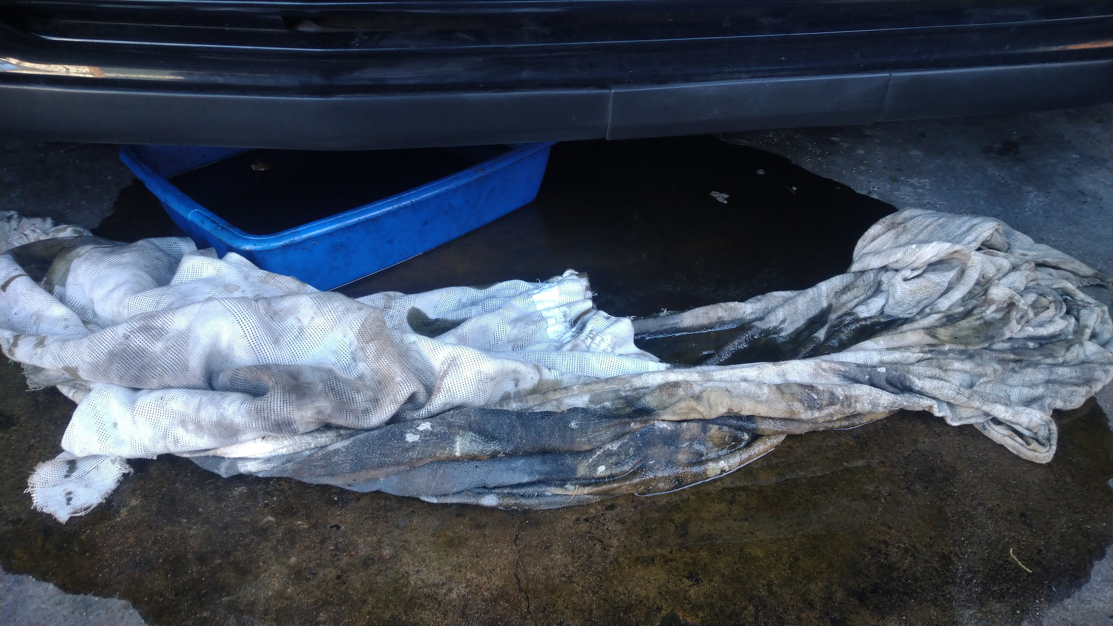

        • When it rains it pours. What a mess. Filled up the car with fresh oil, start up and oil rushing out of the oil filter a whole 4 litres of it in 30 seconds. Looked like a faulty seal on the oil filter so after putting down lots of sand to soak the oil up I put a new filter on it, fresh oil again and started it up when I was looking at the filter, the filter blew on the seal and started pouring oil out again. The only thing I can think off is the relief valve is stuck, this maybe to do with the cogs also being stuck with hardened wax. Removed the split pin, got the bottom out and yes its stuck and I have no idea how to remove it while its bolted to the car. It's not a big spring holding the valve plunger so shouldn't have must resistance. I put another filter on it and removed the coil lead and just turned the car over, the valve didn't move at all so it's well in there and isn't coming out.
          Unfortunately I will have to remove this oil pump and I'm not best pleased as I will know doubt damage it when removing the crank pulley and cog...again. AND the garage floor will need cleaning after the sand has done its job and soaked up 5 litres of lovely fresh oil. Not a happy chap today

            • Garage floor cleaned off and pump removed in 20 minutes, much easier second time around

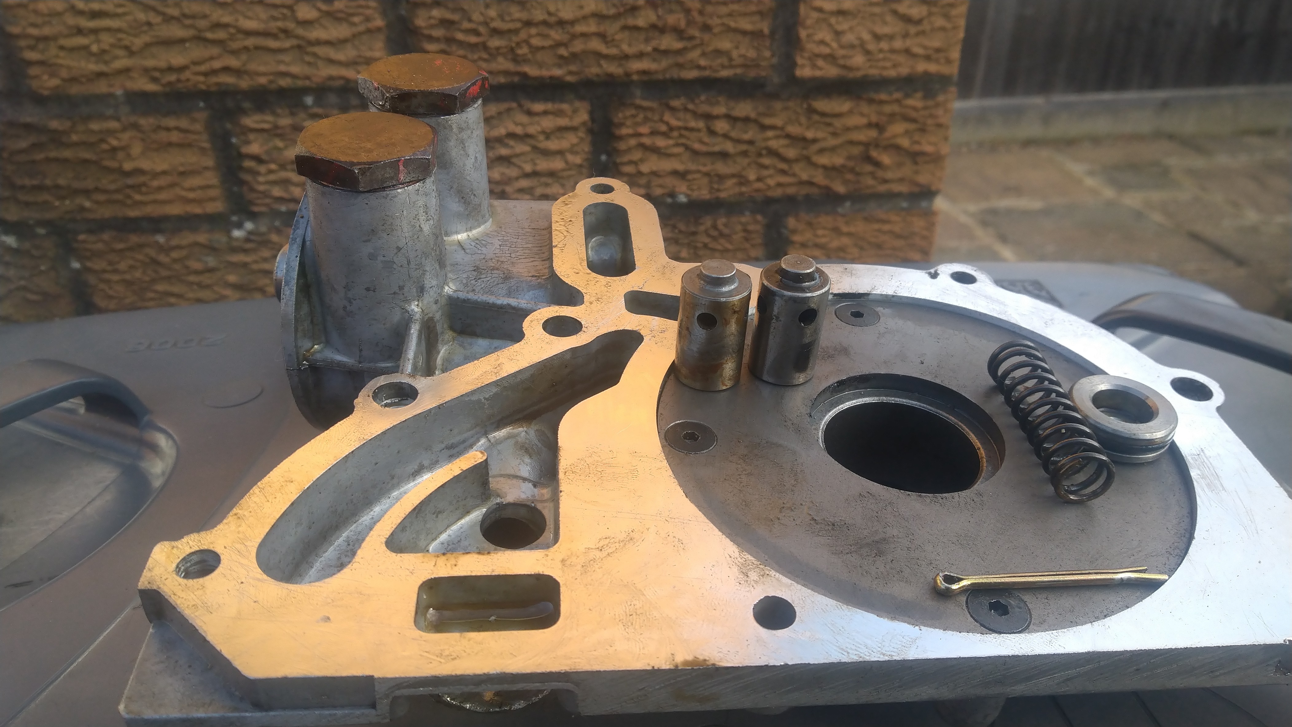

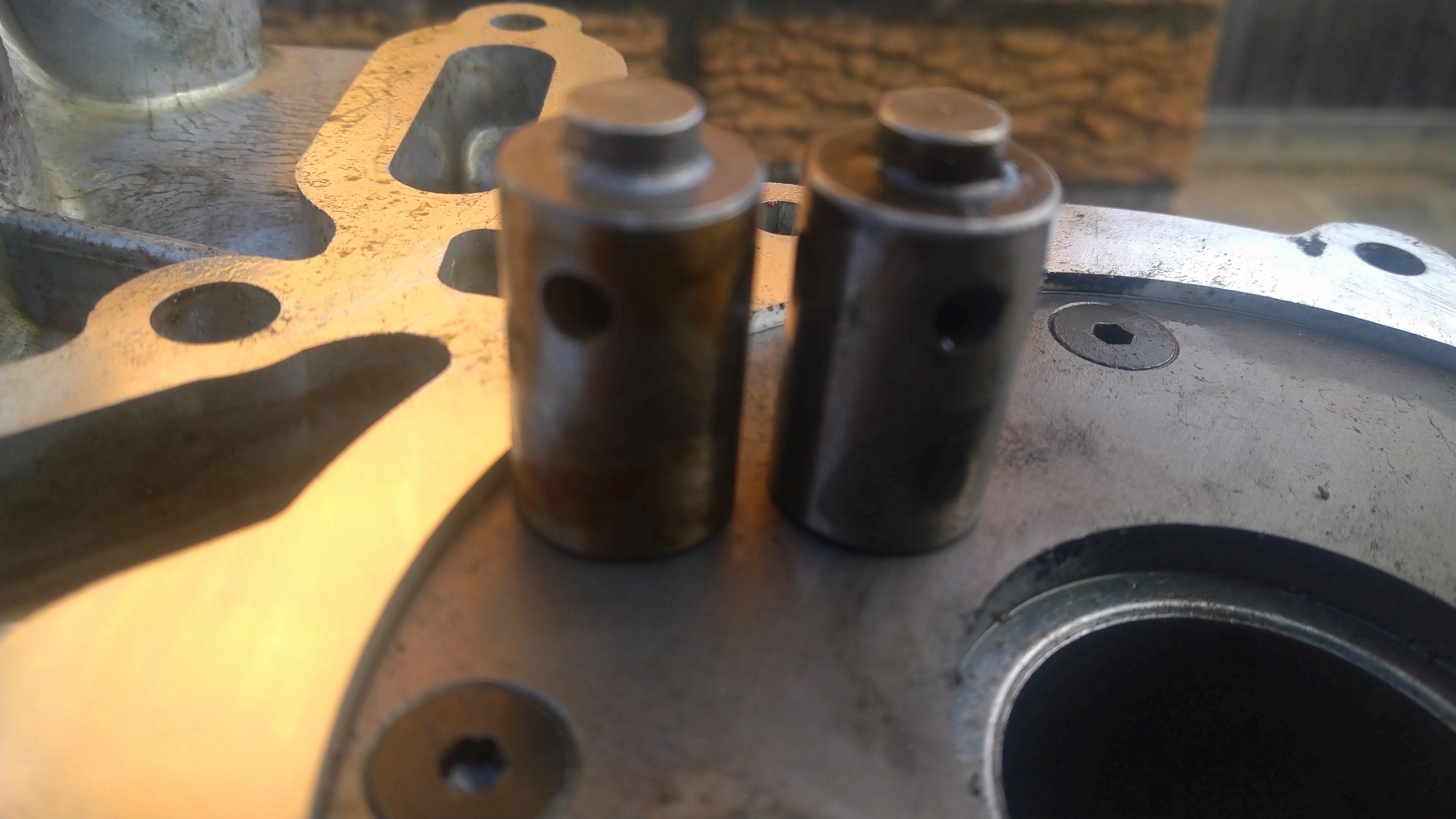

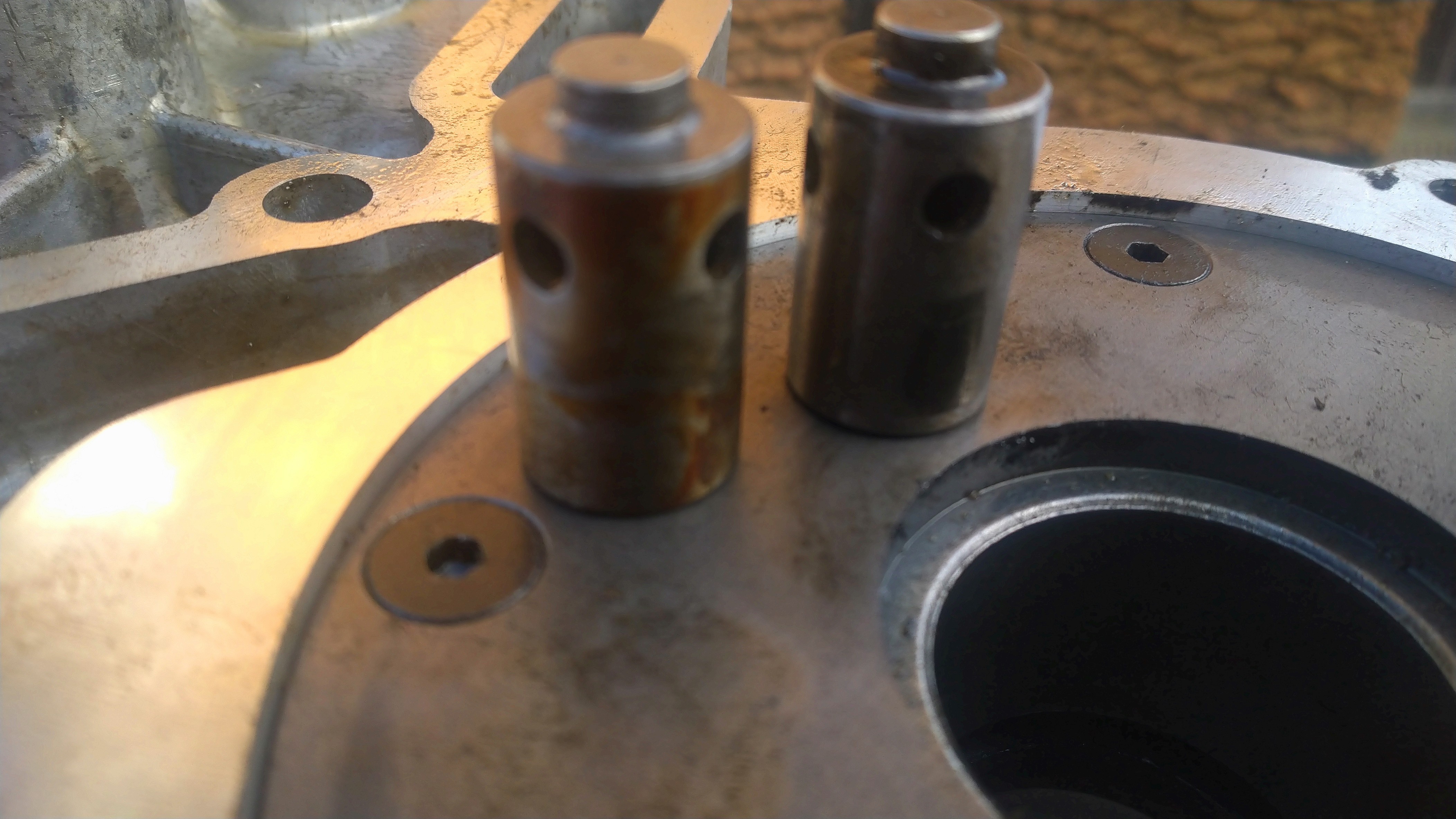

              Stripped the relief plunger/valve and that wasn't coming out easily. Heat, plyers, blocking off various holes and blasting with air. Eventually it moved with plyers after an hours trying and it was covered in the same dried grease or wax as the cogs. Compared to the one I removed from the old oil pump as you can see its not smooth at all and covered in dried something that had cured solid
              All cleaned up and put back in, now has a smooth motion and all back in the pump. Will wait for the pumps replacement before deciding which one to use. I have a dilemma now, do I strip the new pump down to make sure all's working or not

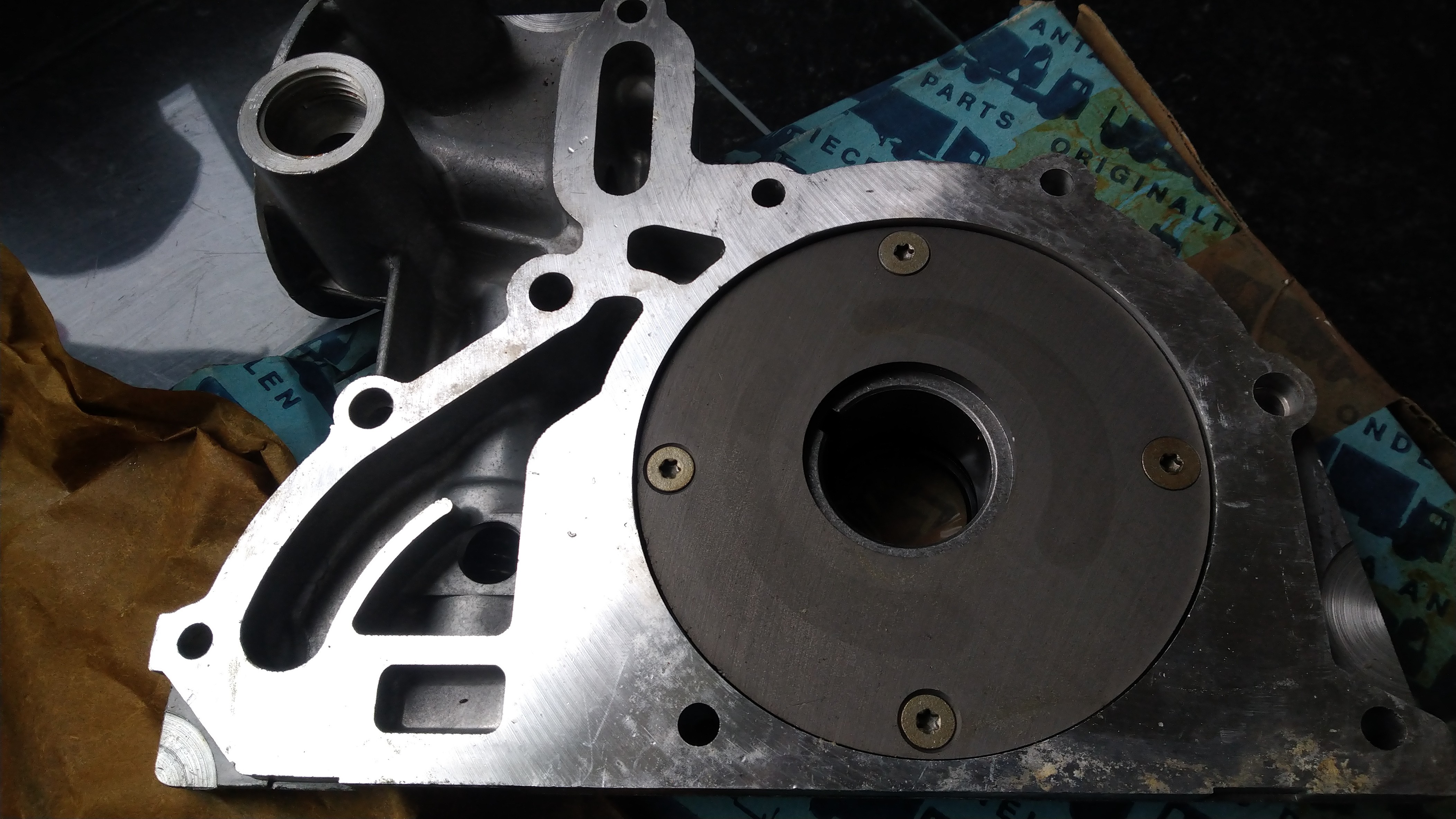

              • Replacement oil pump arrived, cogs move nice and easy and I've noticed the valve split pin has been opened and closed so I'm assuming it's been checked..Note the torx screws and not allen screws . As I'm busy working for a couple of weeks I haven't got time to put it on atm so it'll have to wait
