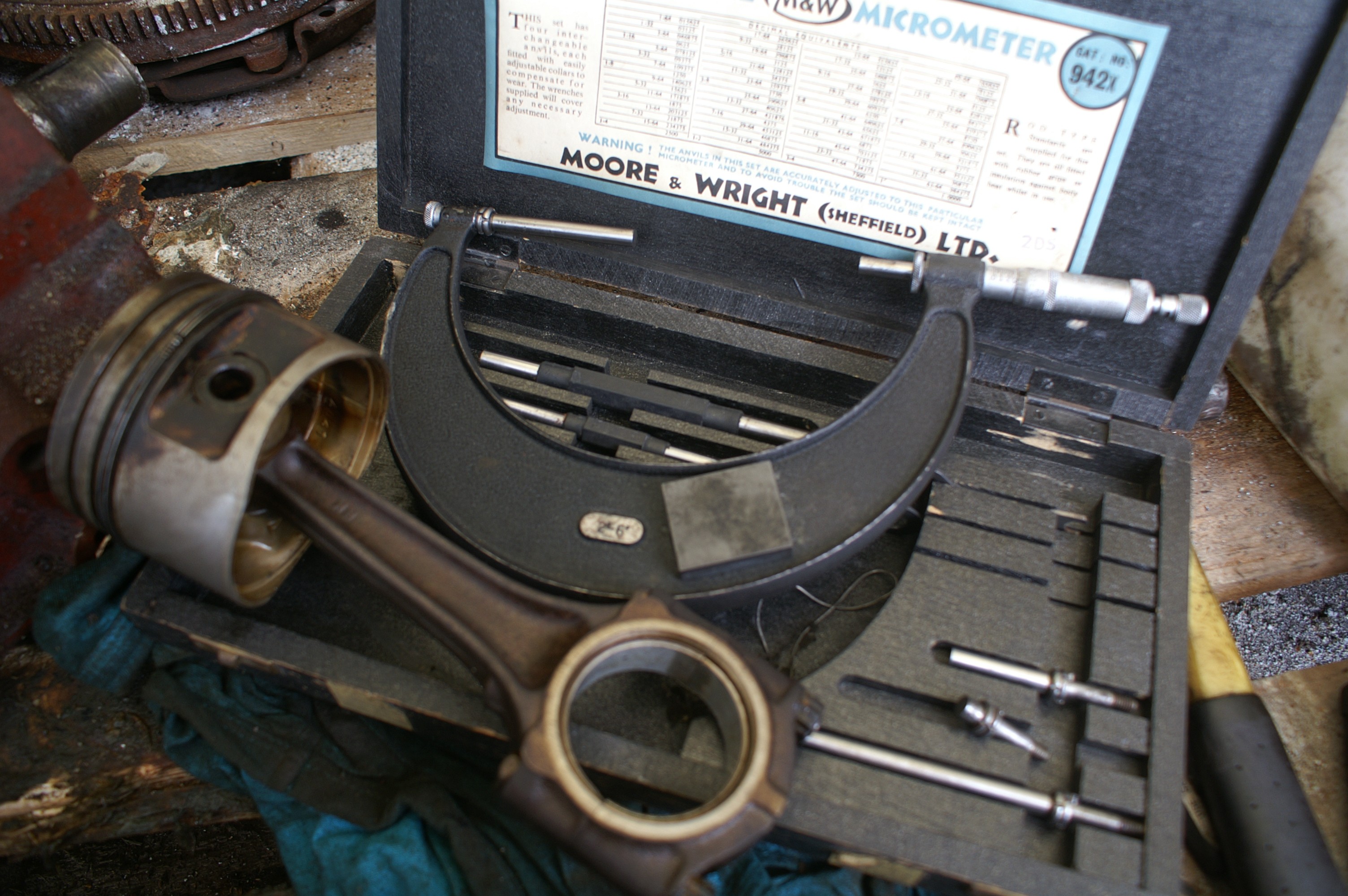

    replied

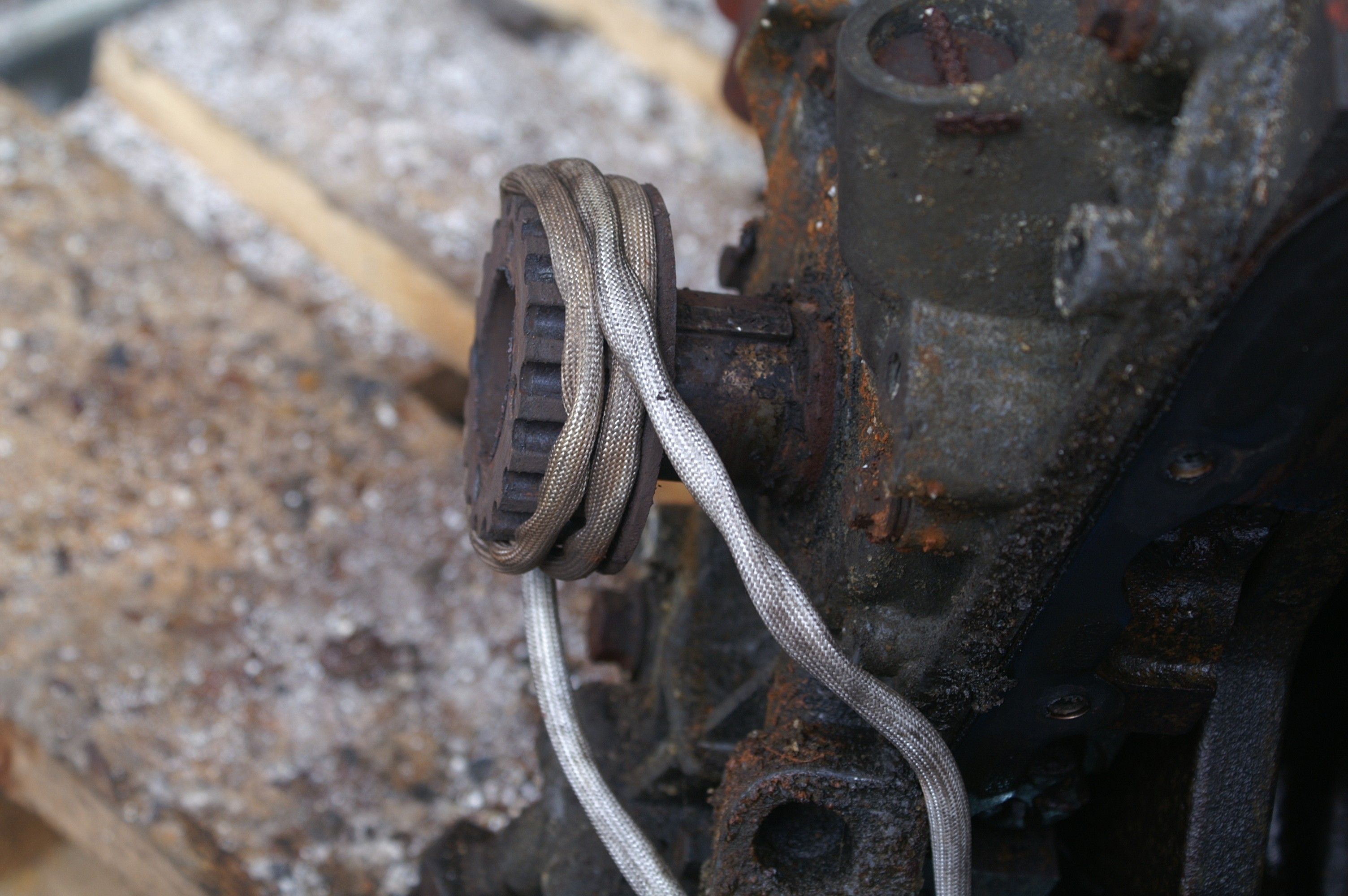

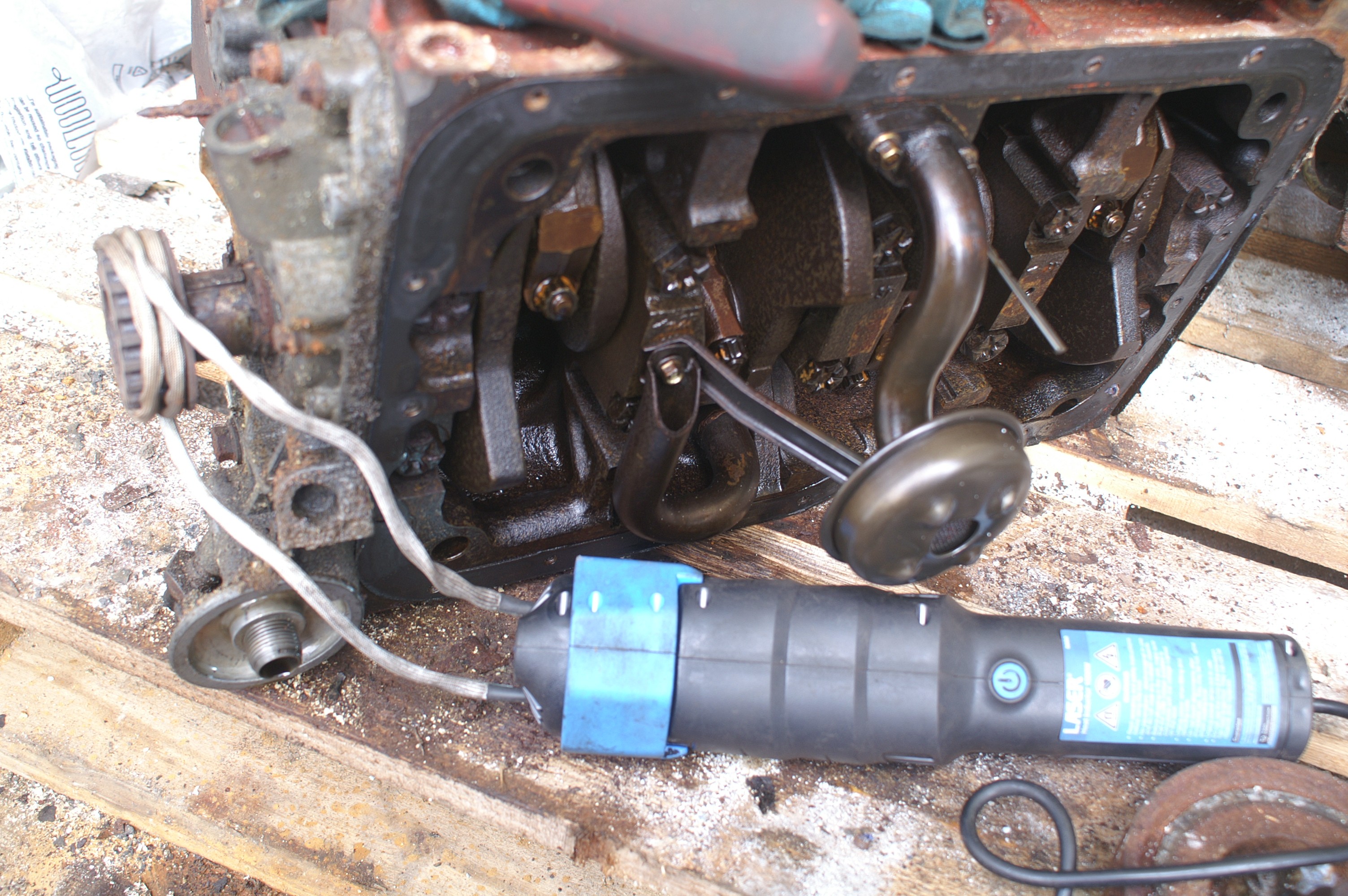

    Made a bit of progress dismantling engine, the induction heater came in very handy for getting the cam drive sprocket off, it seemed to have been loctited & came off very easily once heated past 300 centigrade. Piston-bore clearance seems to be at the tight end of the tolerances, ring gaps pretty much in the middle, so didn't really need to be dismantled. There seems to be a fair bit of sludge in the waterways though, a good clean out will do no harm. A good look beats a good guess anyway!

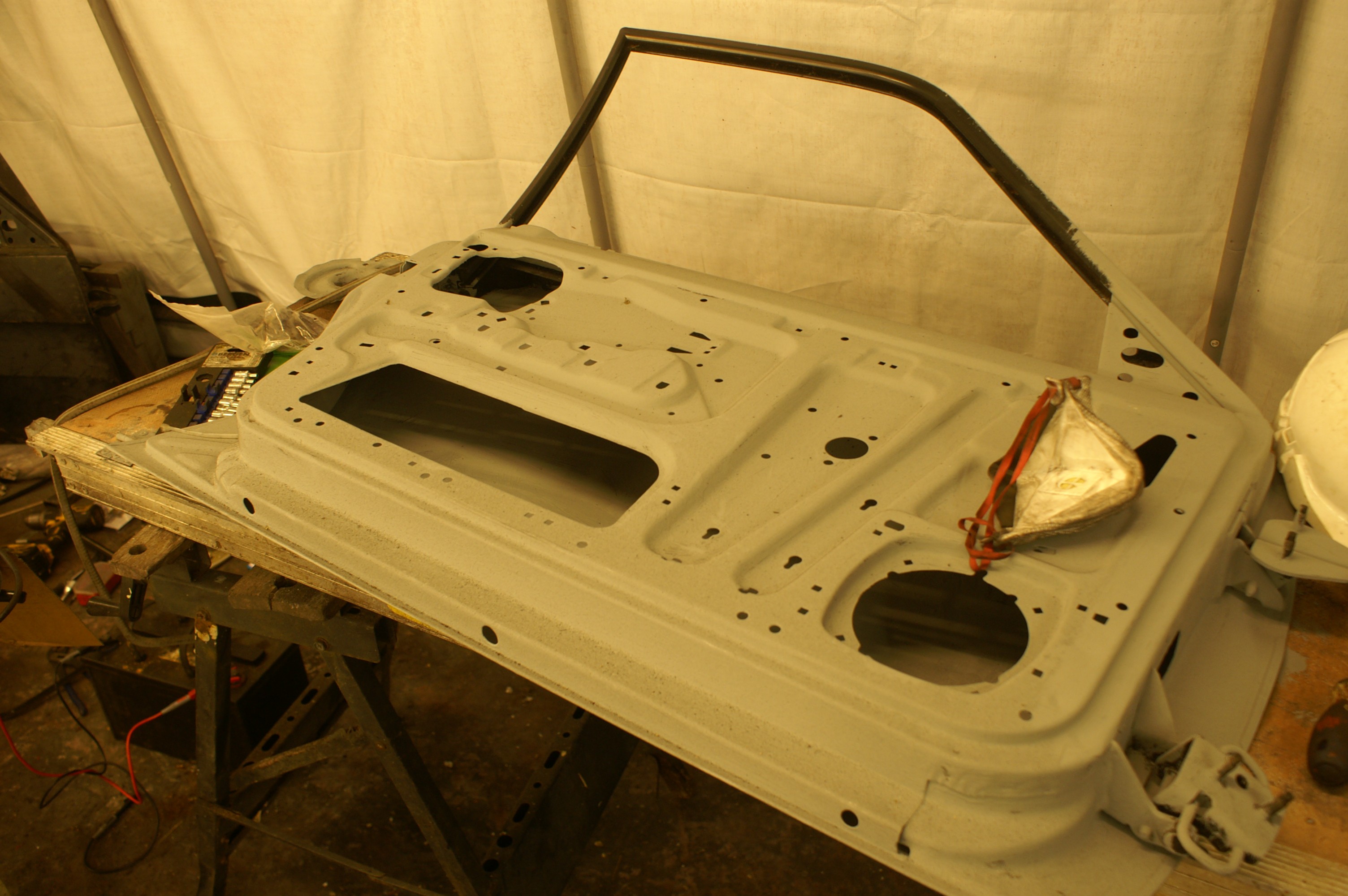

    replied

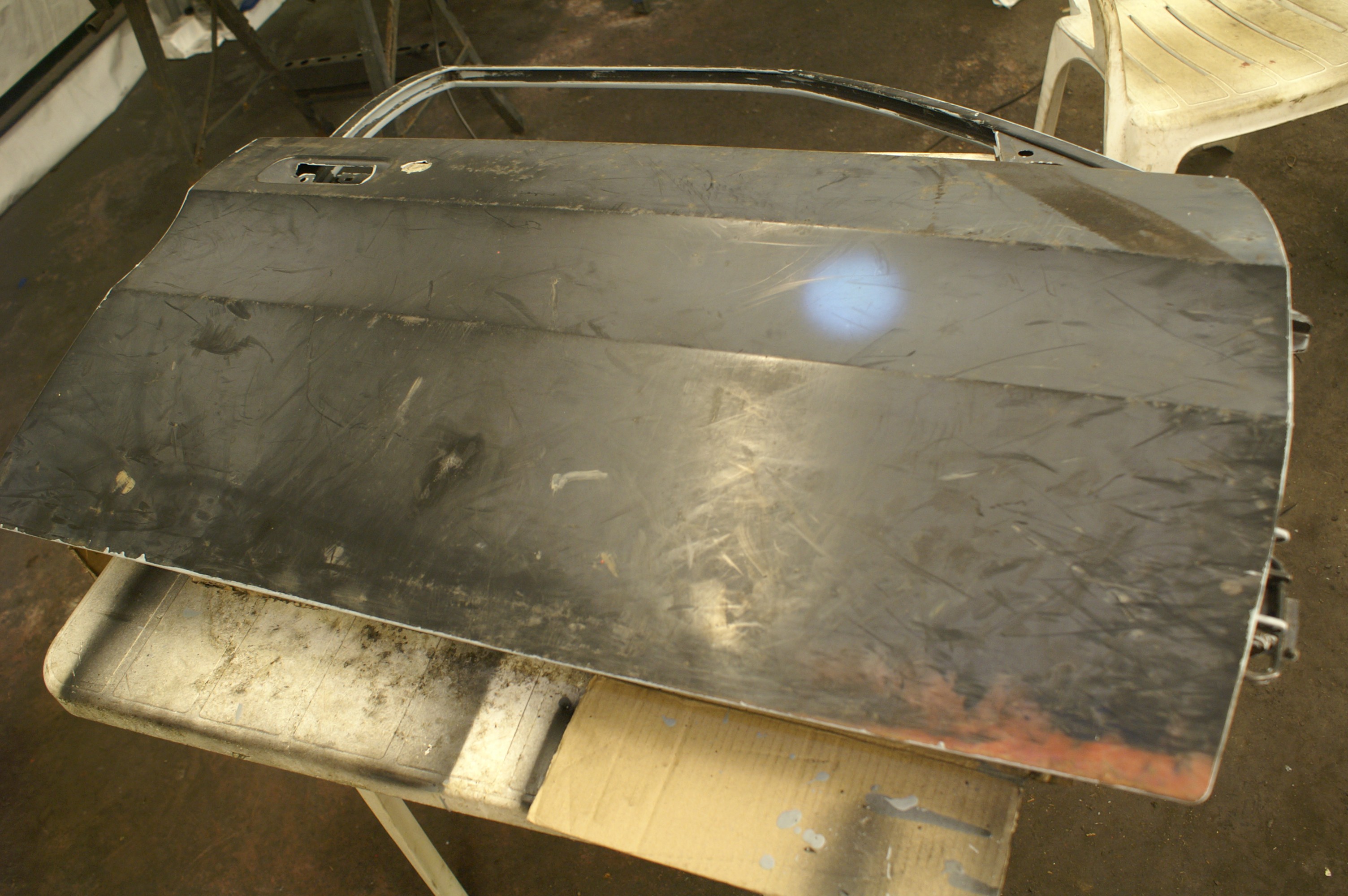

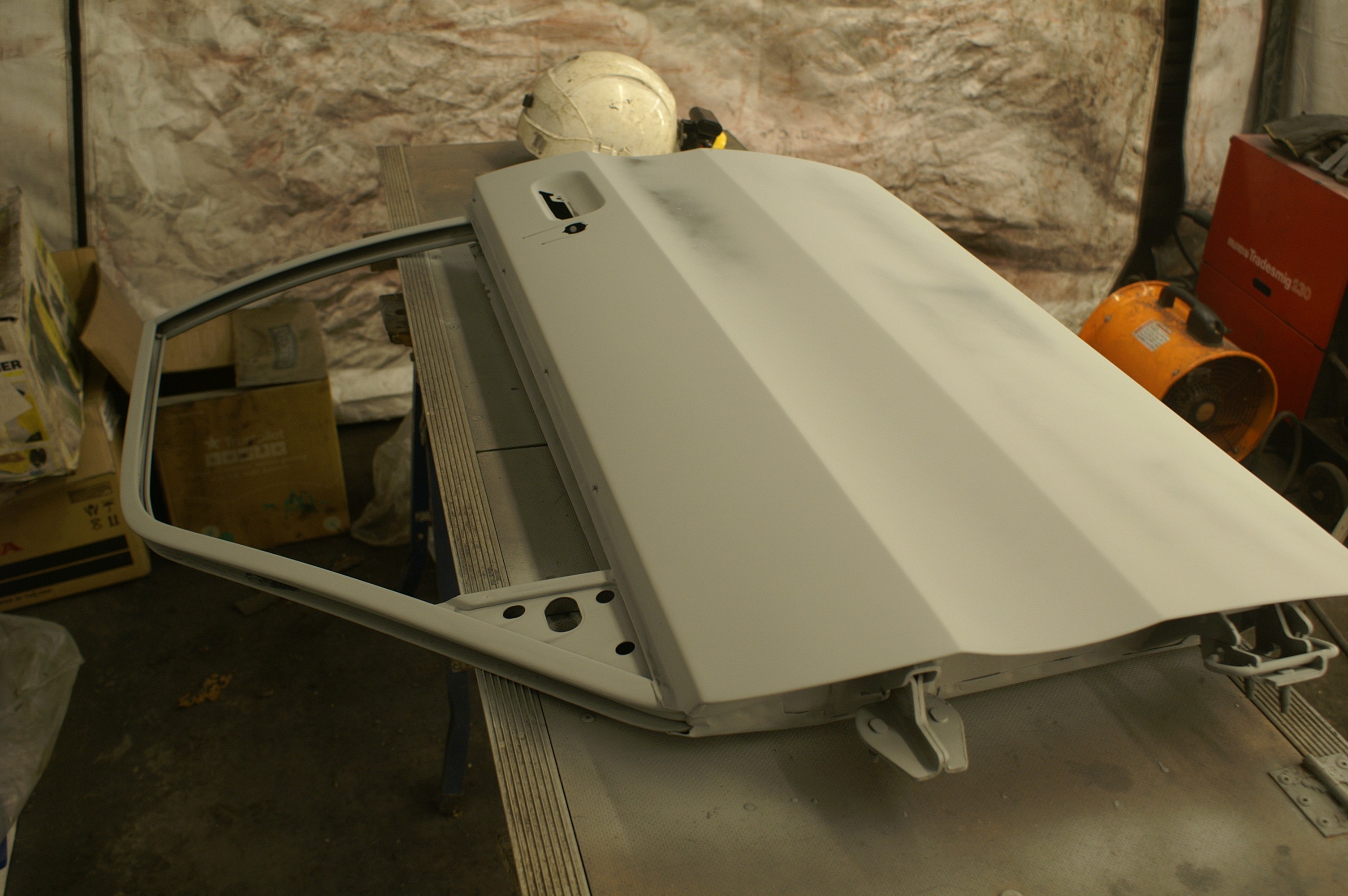

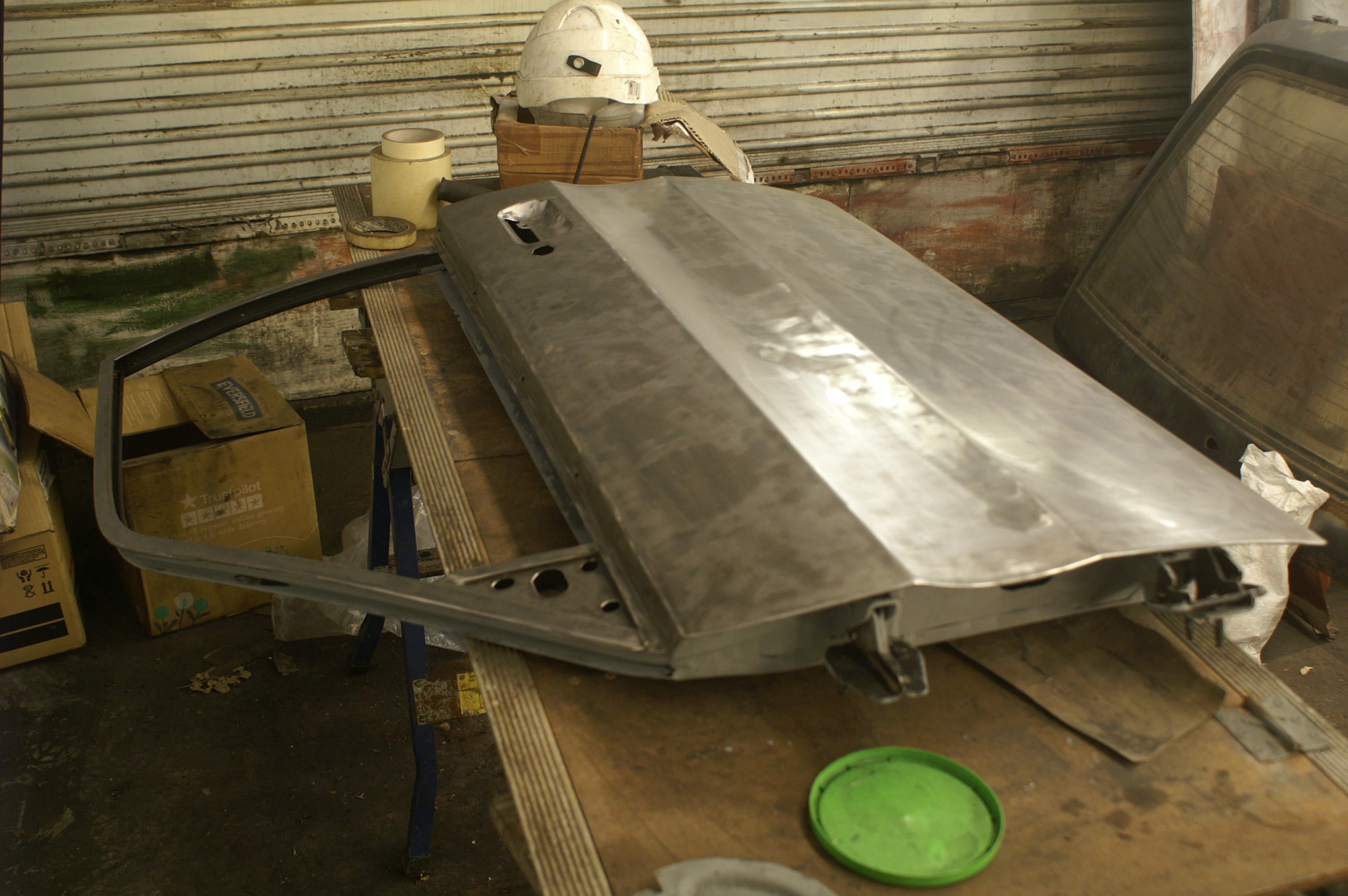

    Thought I'd get the front doors pained, couldn't decide whether to rub down the bits that showed signs of surface rust & leave the rest, or take it all back to bare metal. Lucky that I chose the second option, it involved a lot of hard work, but revealed that there was a lot more surface rust that there looked to be at first. Having removed the paint I decided to try a coat of 'rust-anode' cold galvanising, in theory it should protect against rust better than 'ordinary' paint, and should be easy enough to put ordinary paint over it. I'll know how easy it is to paint over very soon, but won't know how rustproof it is for a few years!

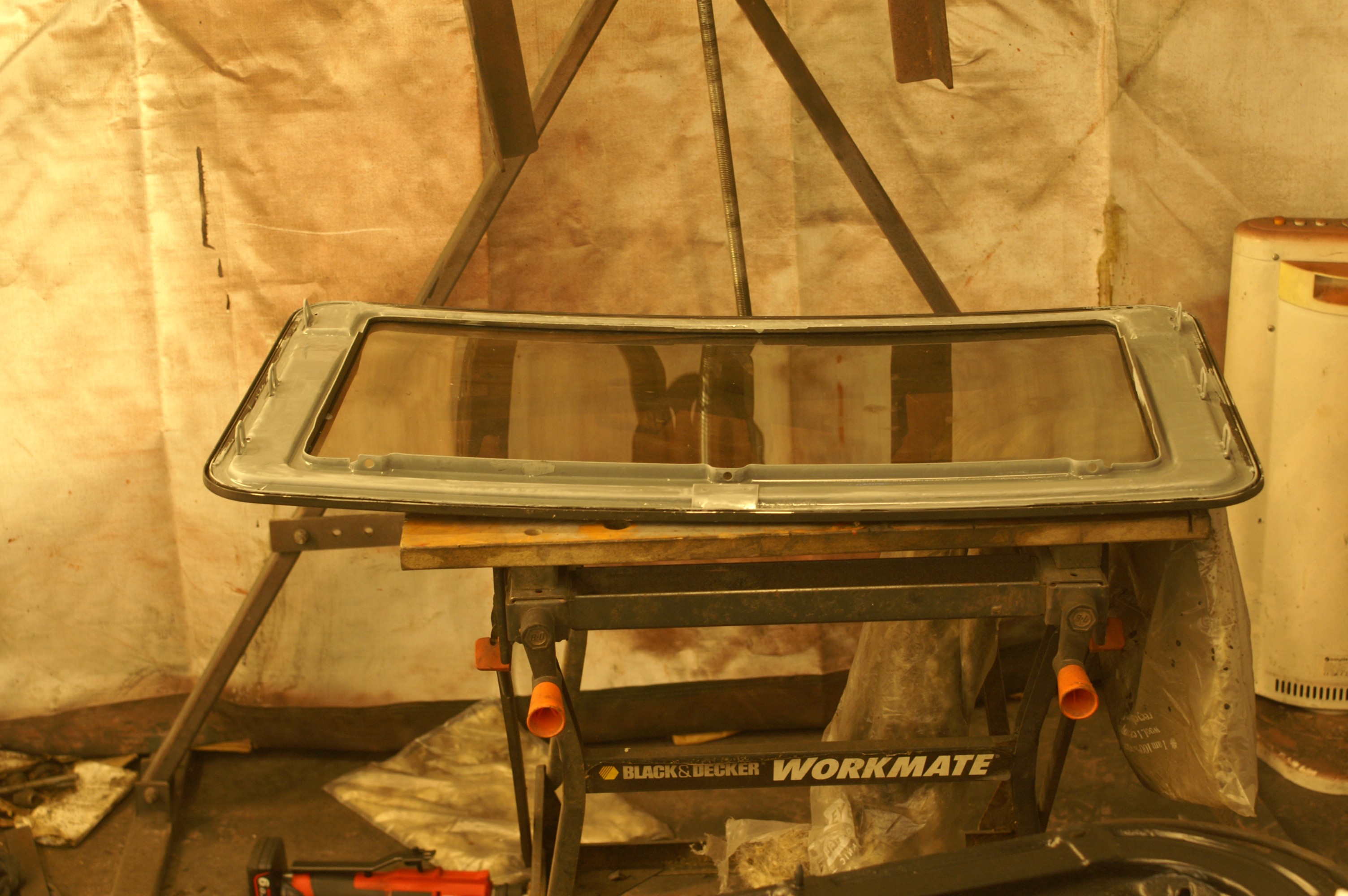

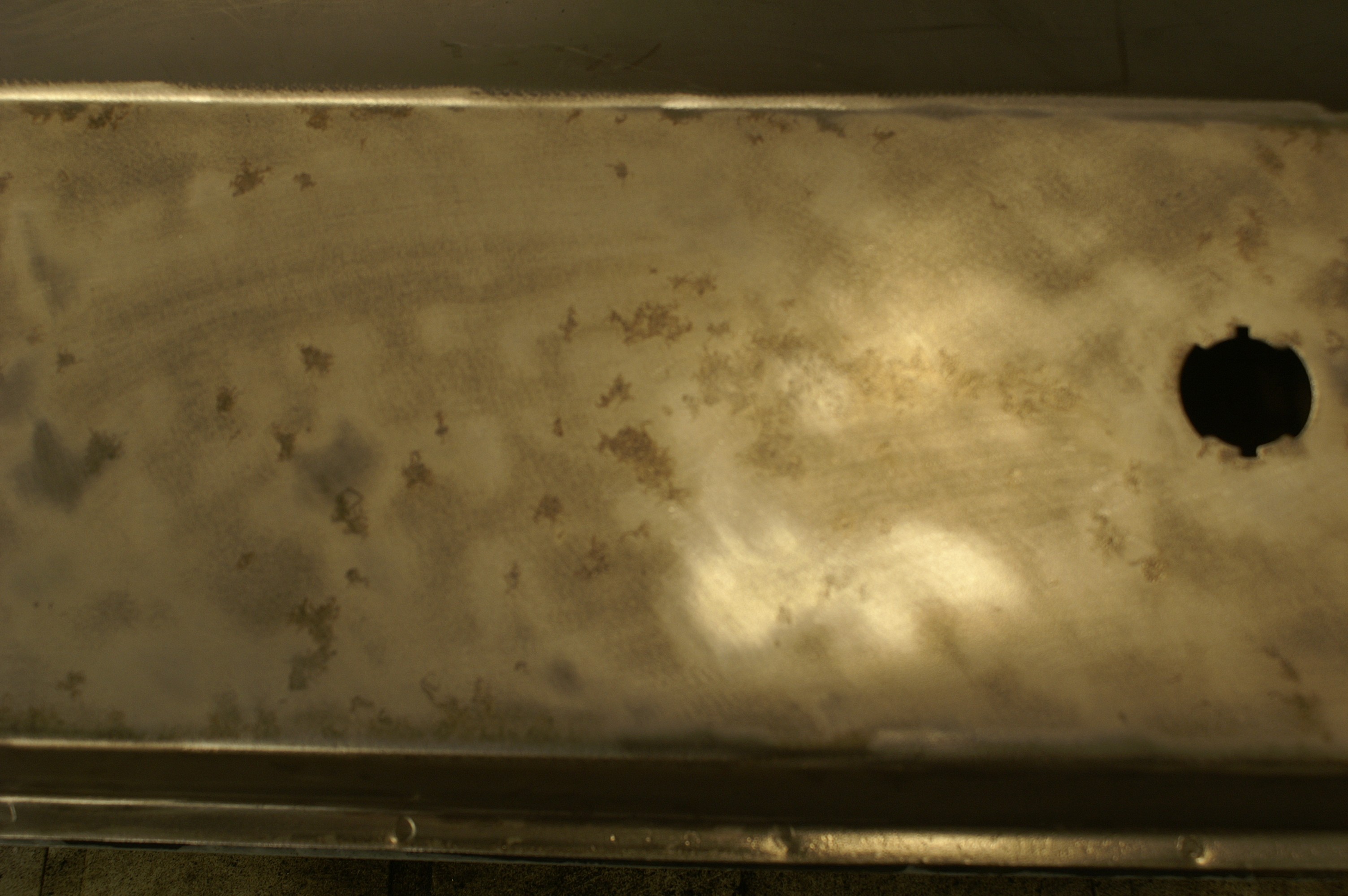

    replied

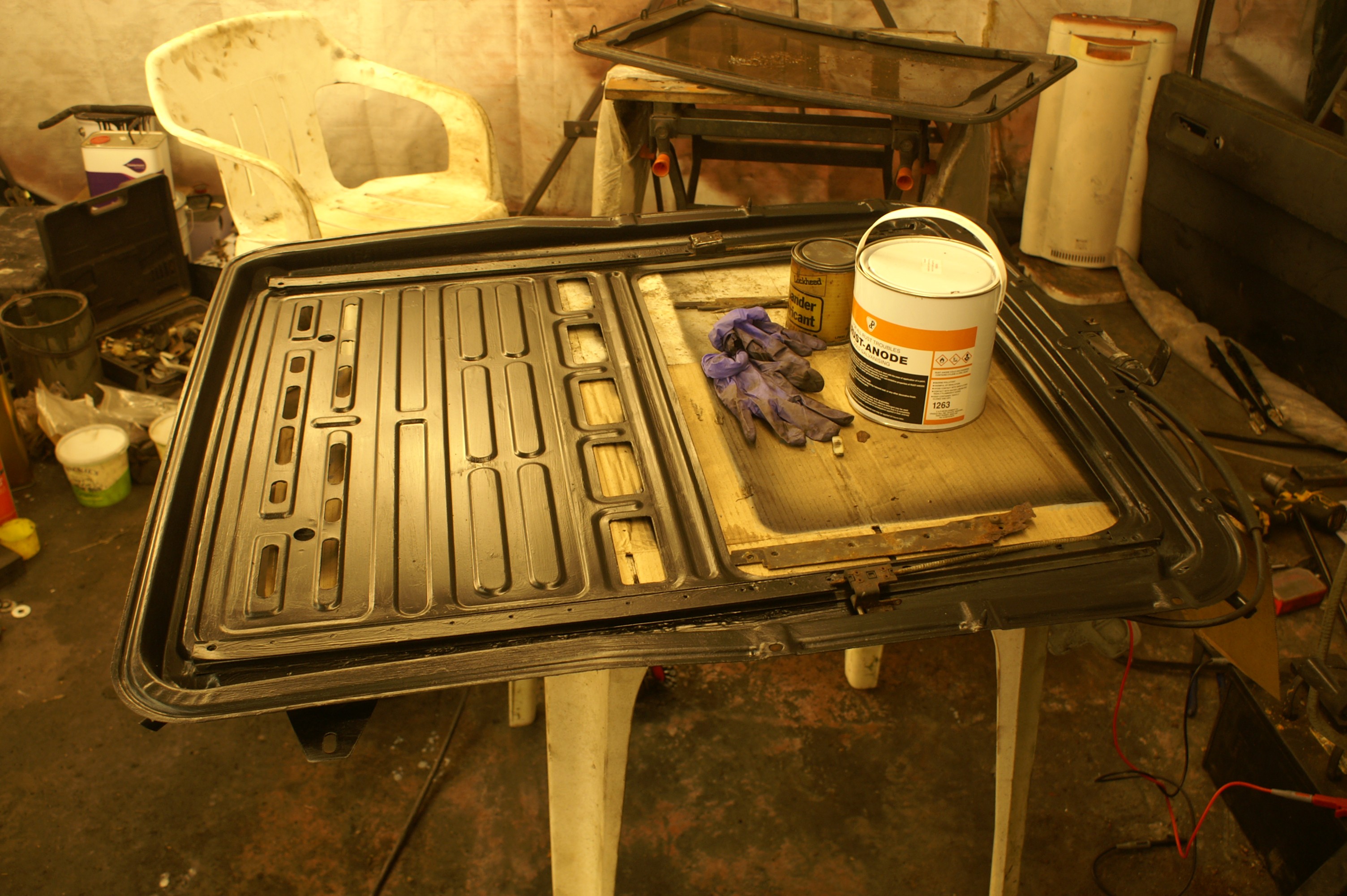

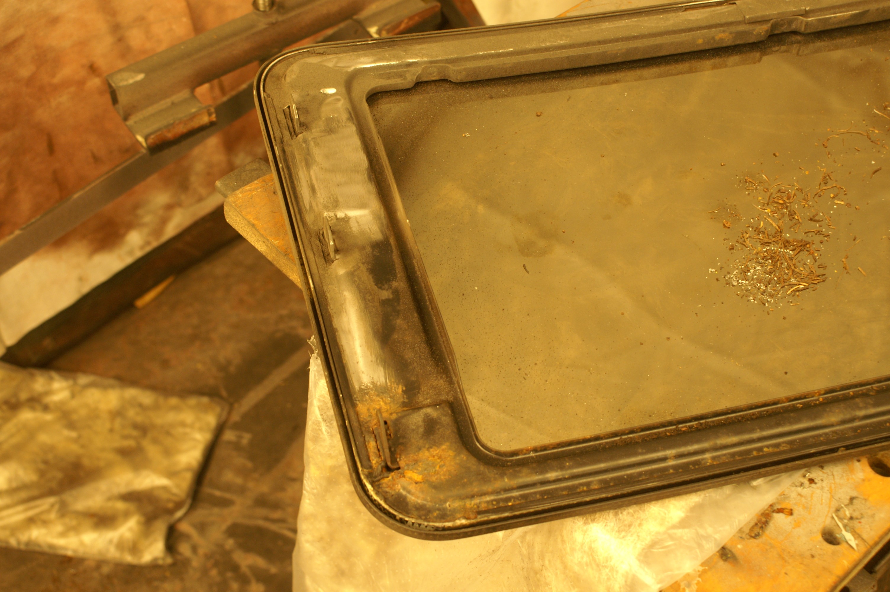

    Giving the sunroof a quick clean up & check over didn't go according to plan...think I've made one working one out of three with various faults! Amazing how much surface rust was inside the new old stock door, especially under the anti-drumming pads, hopefully "Rust Anode" will do what it says on the tin & make the door last for ever (or thereabouts)..
    Leave a comment:

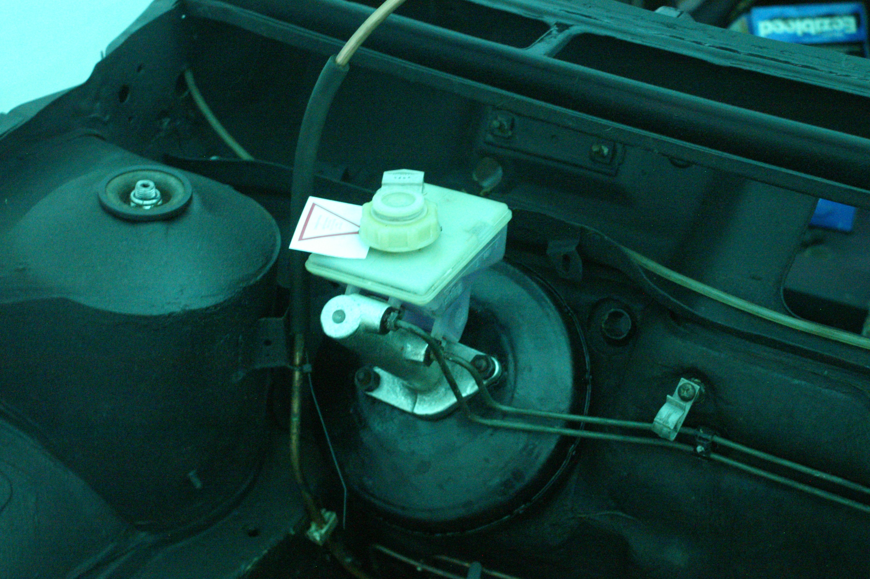

    Came up ok that didn't it
    Yes, I was quite surprised that the limescale remover was the only thing that shifted the deposits from the brake fluid, but will know what to use next time. It worked in seconds & doesn't seem to have harmed the plastic, definitely need gloves on though!
