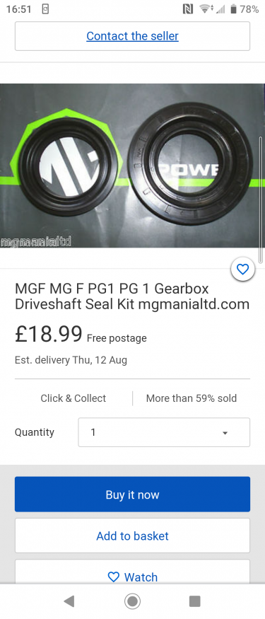

    Gearbox seals for driveshaft on a montego 2.0 are the same as an mgf, there's a smaller and larger one.
      There is an example

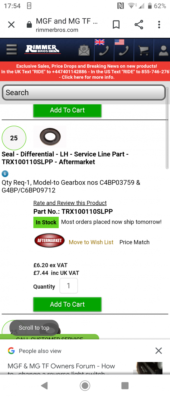

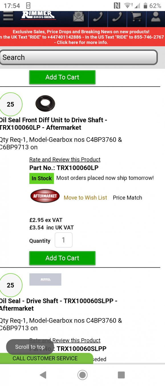

          Rimmer brothers deliver worldwide, check part numbers first via email if needed. The seals have a metal insert so I doubt if you buy in a hardware store
            As Jeff says, the seals are not standard, the seal numbers and dimensions are at the bottom of the list here https://maestro.org.uk/forums/forum/...arbox-bearings A bearing stockist might be able to find them, but I think unlikely. It is possible that https://www.ebay.es/str/recambiosbal...1437557&_pgn=2 might be able to get them, not all of their stock is listed on ebay, so may be worth asking?
