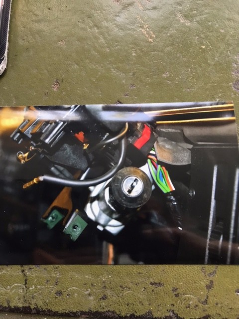

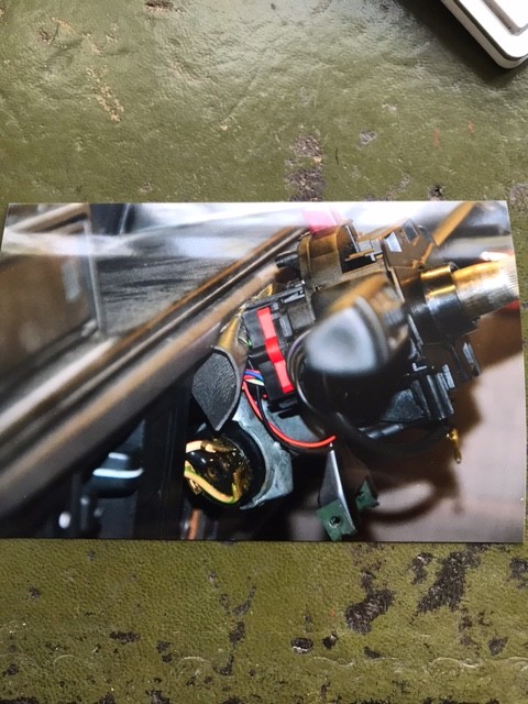

          Thanks for the pointer Jeff. I have got pictures, but not totally clear about the position of the switch assembly, just the red insert in the switch body.

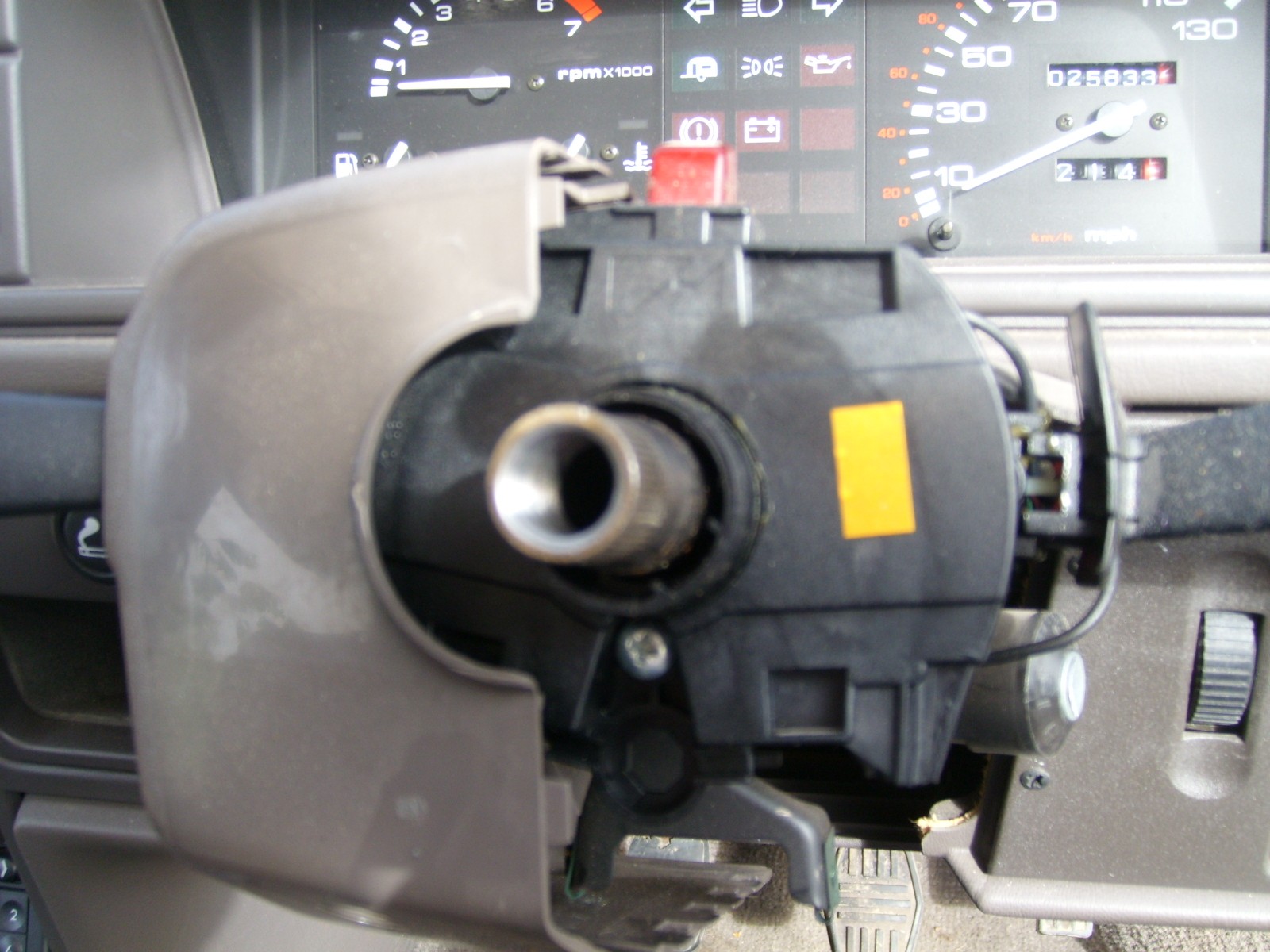

                With the main screw at the bottom loosened, but not too much, maneuver the switch plate until the hazard light top is vertical and the switches are horizontal then push, the switch assembly locks into the steering column then you tighten the bottom screw. I don't get what you mean about the red insert, do you mean the hazard light unit?
                  This appears to be the first sticking point. I am told that there is NO screw below the self-cancelling ring. Just a blank plate. The attached photos sent to me focus on this red insert rather than looking to where the clips are or should be. Removal of the switches is really of secondary importance as it is the alignment of the assembly that needs fixing. I can't think of how to help the guy if there is no clamp screw on the face of the plate.

                    Pete, can you get the guy to take a front view and not the side as those red parts are the clamps/connections for the main switches wiring loom and nothing to do with the fixing of the main unit to the steering column. That also looks central to me from those pictures and in the right place
                        Ah! The problems of telephone support with someone whose technical skills have probably diminished with age. Good point about the screw being missing, so yes, next request will be the front view and see where we go from there.

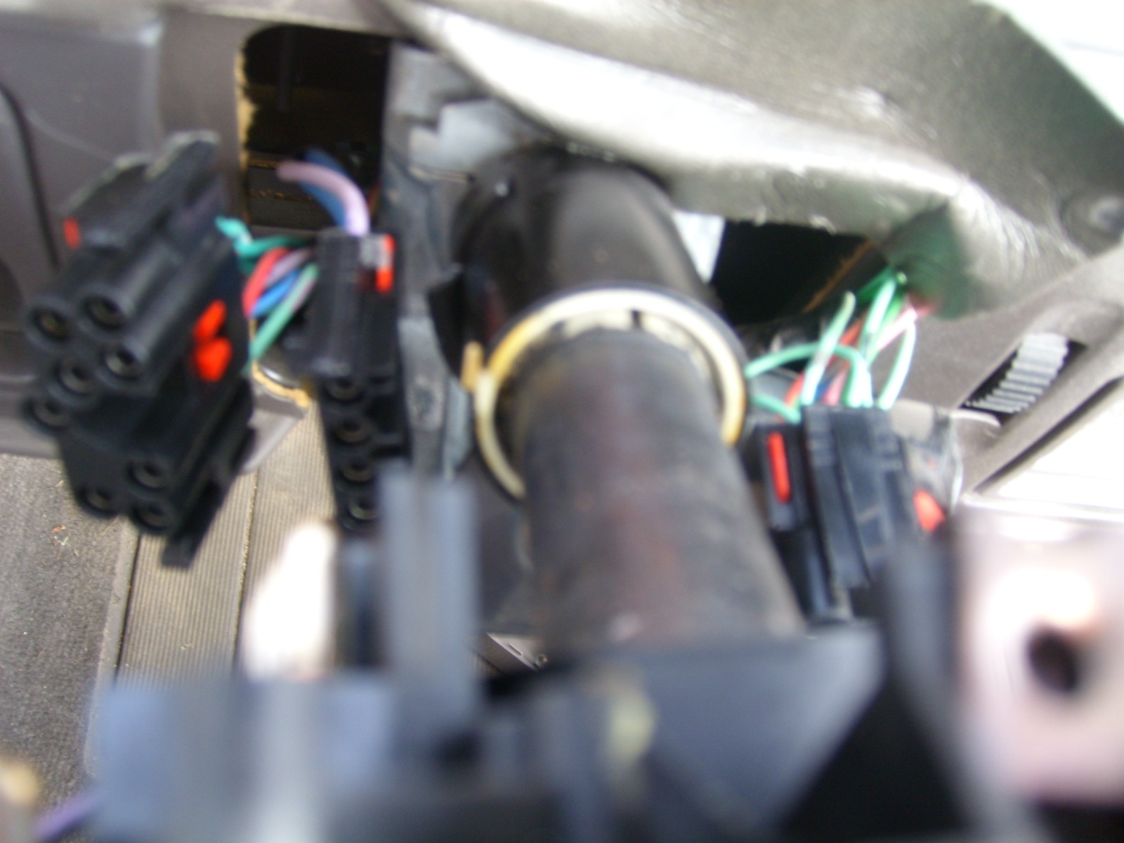

                          Yeah you can see them in petes pictures, all connections are the same throughout. The only differences as you know were in the early models that had a small light to light up the switches.
                            I did wonder if I'd missed something here, but now see that it does all look the same...that's a relief
                              Got some pictures of his setup. He does have the clamping screw, but even with this removed, he cannot move the switch assembly in any direction. Sounds like it's been forced into place at sometime in the past by a ham-fisted mechanic and now won't move. Thankfully it is only about ten degrees off horizontal so he will live with it as is. Still claims to not see the clips to slide the switches out of the holder, though....!
