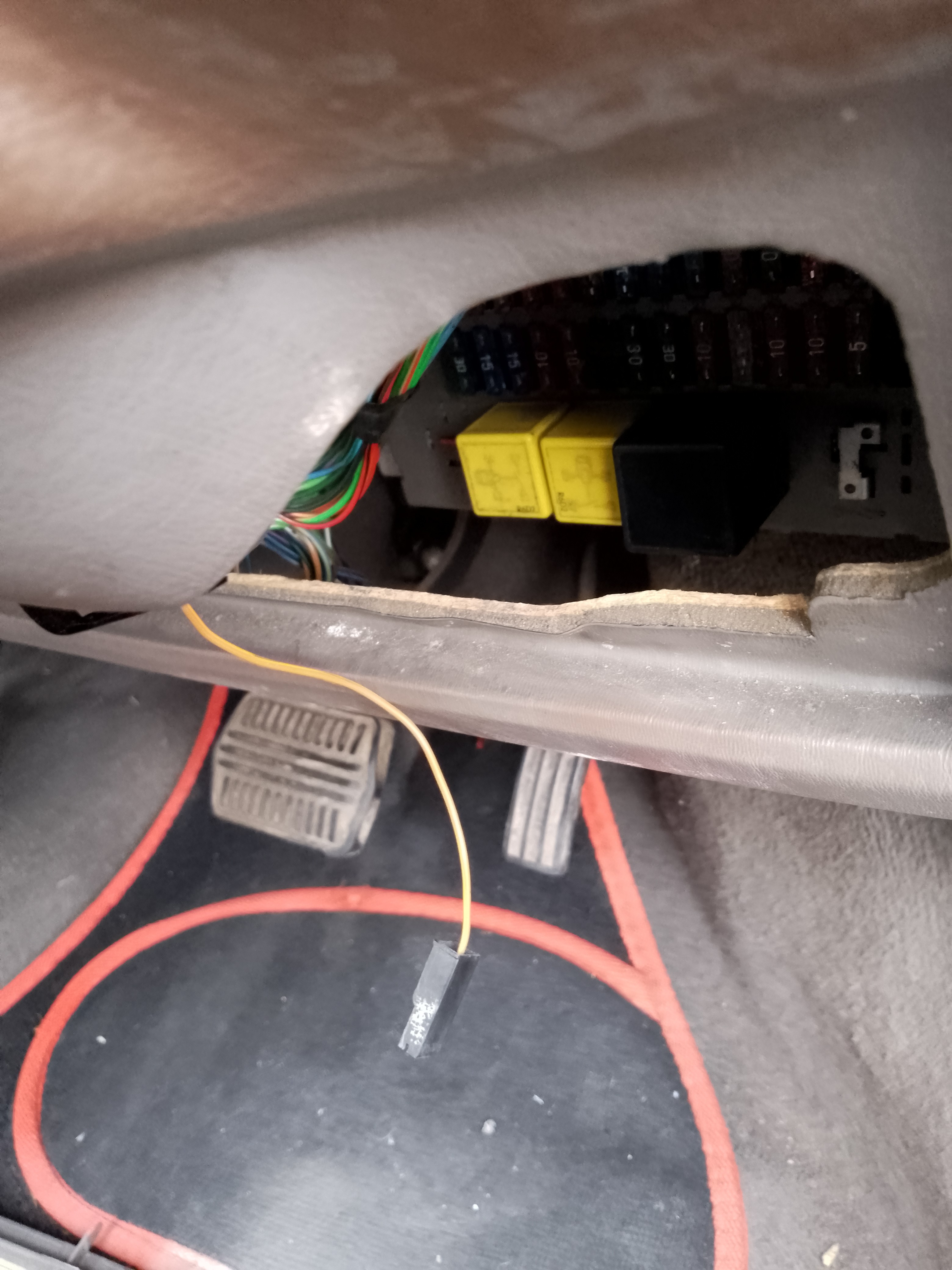

              My circuit tester at the heated rear window.....it showed no power. Likely causes, given fuse already changed are??
                The relay/timer or the switch, relay is in fusebox, so easiest to get at, if the switch is gummed up a bit of rapid switching on & off might get it working.
                  Is a replacement relay relatively easy to source?
                    Which is the heated rear window relay? Click image for larger version

                              It is just out of shot on that photo, top right (opposite the inside lights one) if it is the same as the one in the book. Probably worth checking on the fuse map though. The rear wiper controller is on the other side of the board, so not easy to get at/see.
