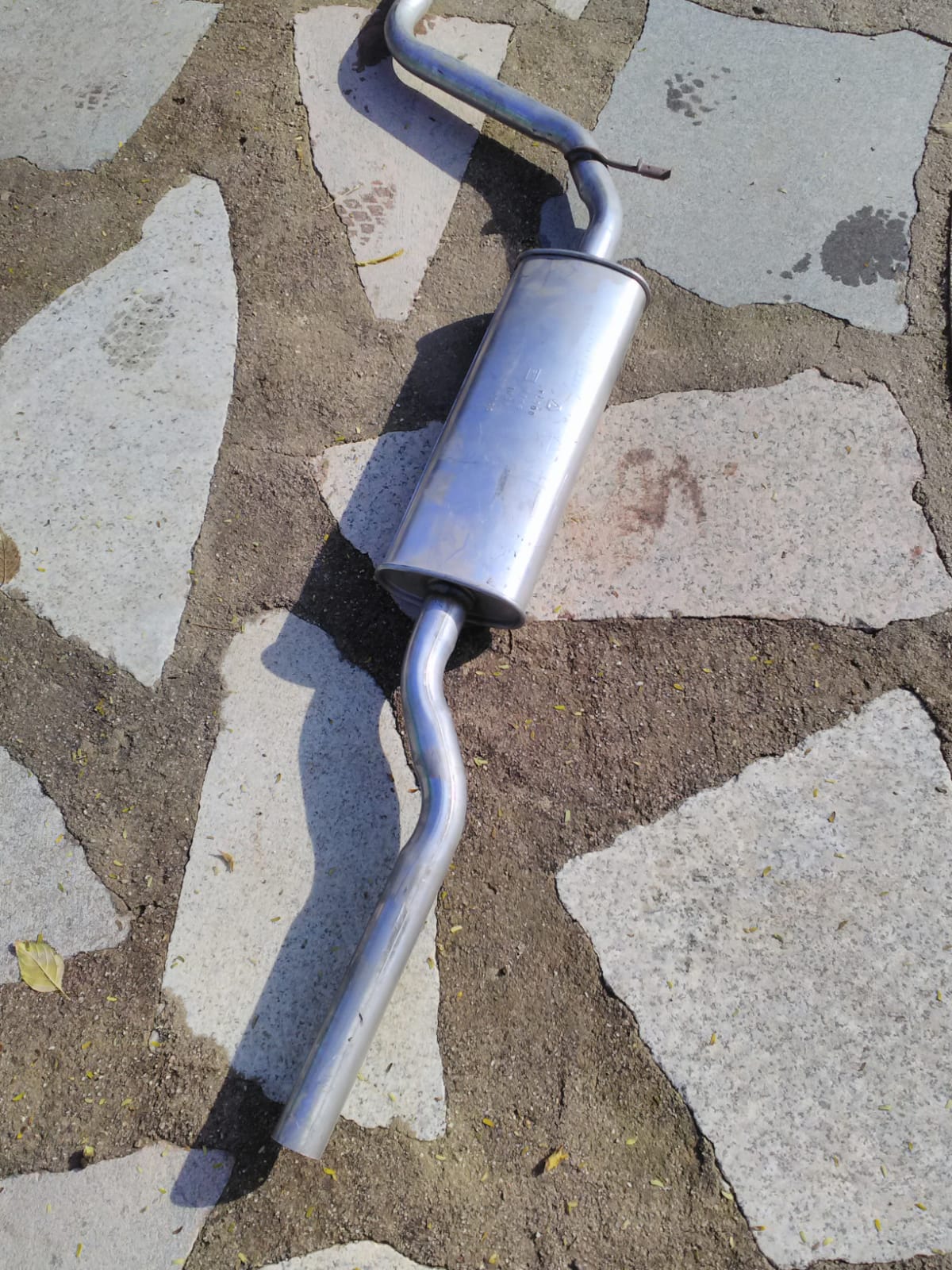

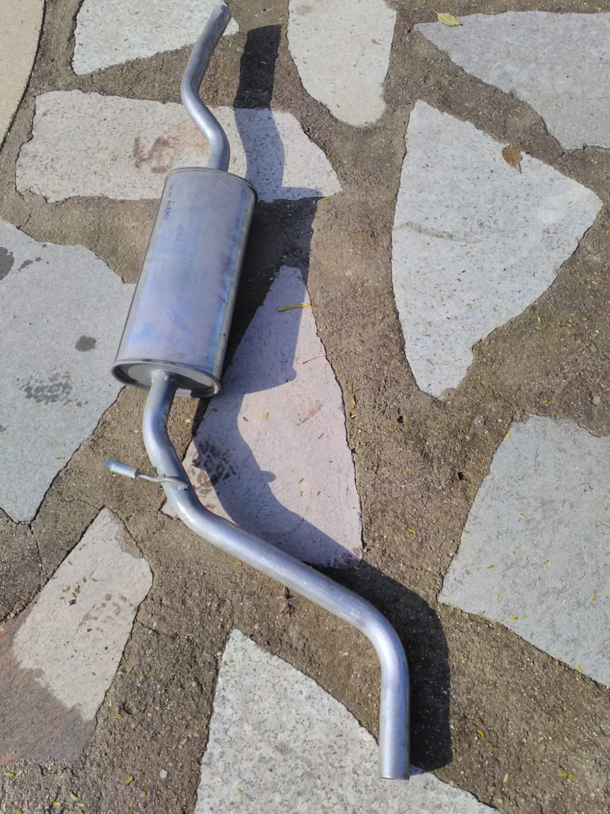

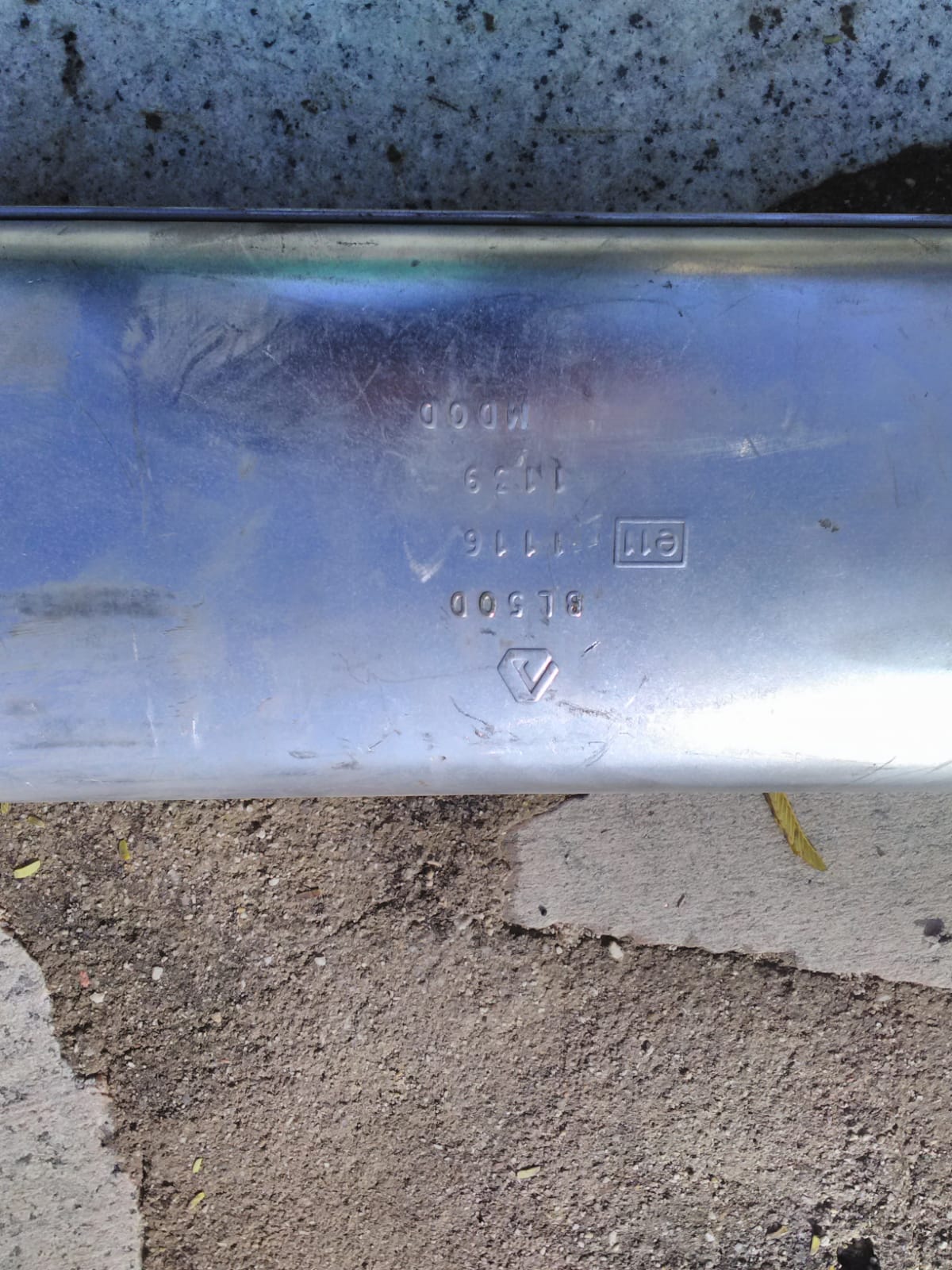

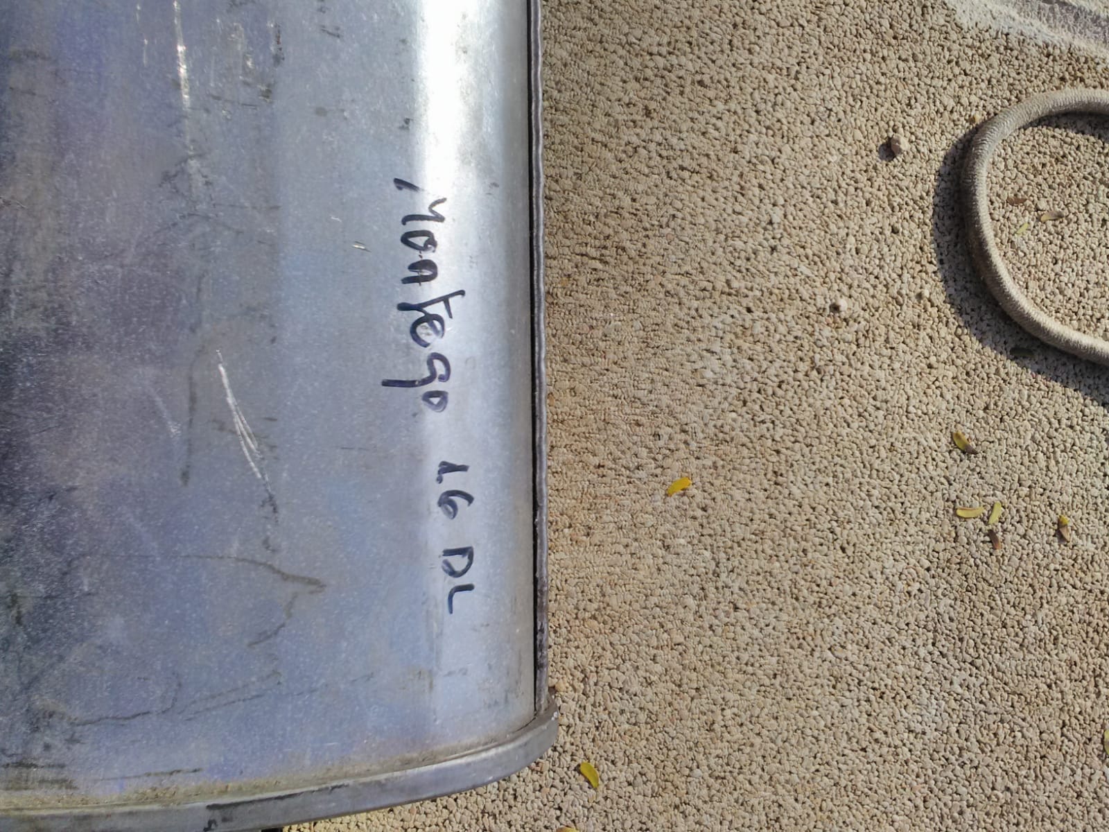

              I found these parts but the reference is not the original, someone knows if it is the intermediate silencer of montego efi
              in one silencer puts: ZARA 12806
              and in the other says E11.
              BL 50 D
              1116
              1139
              MDO D.
                I have also been given the reference number GEX33090 is it suitable for my montego efi?
                  Microfiche for GEX 33090 specifies EFI saloon Vin No 199838 to 265881. If your car is later Vin No it could be modified to fit.

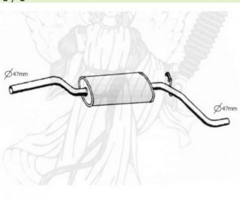

                              I bought the exhaust manifold with reference gex 11013 and the output is 47 mm in diameter. this muffler would adapt properly to form the complete exhaust pipe efi?
                              this is the referece
                              Intermediate exhaust silencer Austin Montego MG 2. 0i EFI - Vanden Plas - Family 1994 cc. 115 HP from 1985 to 1991 similar to GEX33090
