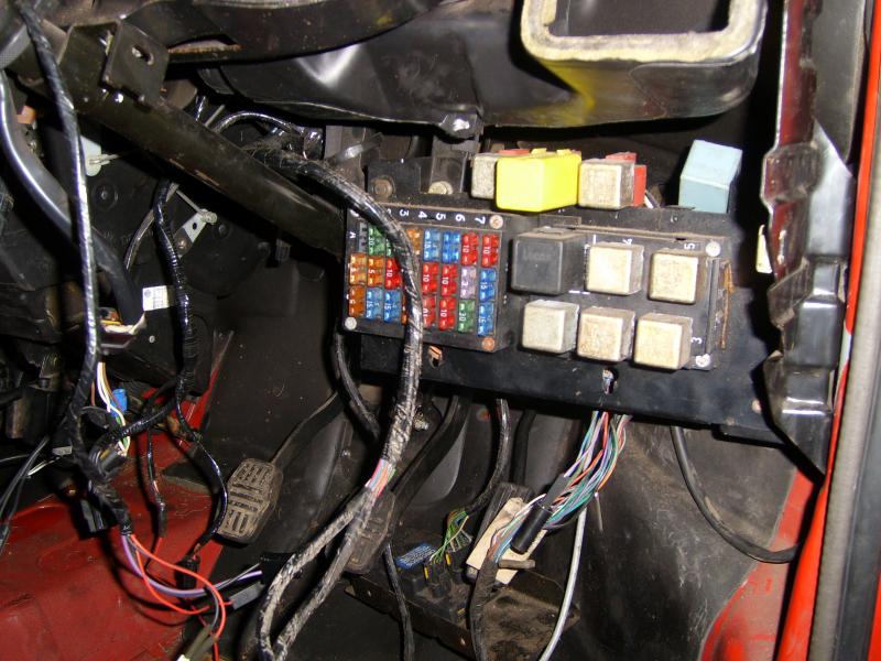

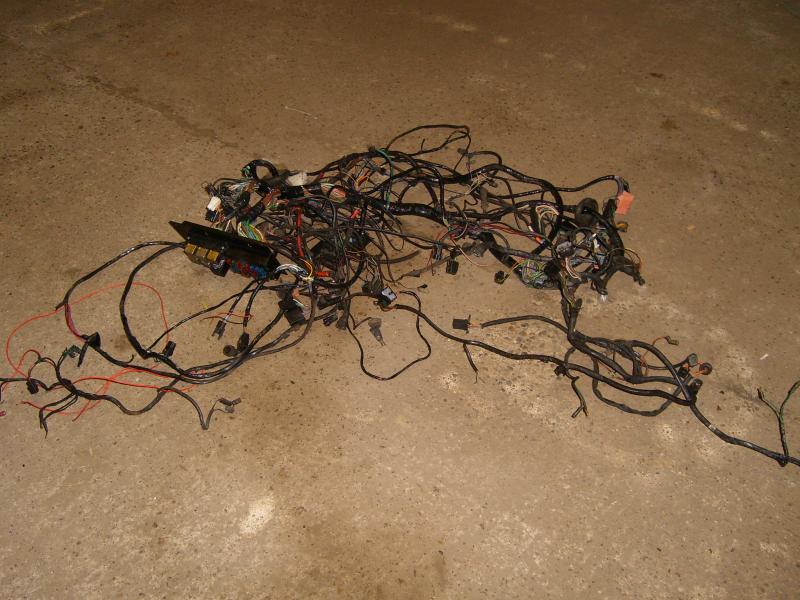

                  Troublesome wiring loom (pic) is out and the loom from the donor is in, all parts (pic)are now with the car and just need to be put on, when we can find the time that is.
                  The old loom was all burn't behind the fusebox so something was wrong there then.
                        Taking it's time but slowly getting there Jesus it's been ten months since I picked it up
                        yes jeff it was fryed that the only reson i sold it to you jeff,could not be ass-ed with it with the bodged wiring it had as you may see when removed it...last owner had it for its mot and there was some wiring doing for mot so they sorted it but how good where they??? not very good at all as things started not to work or work when it wants too
                          Wiring looked well bodged Andy, still it's all been removed now and replaced so hopefully should work ok now.

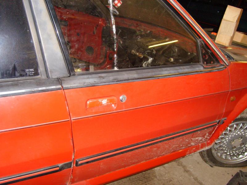

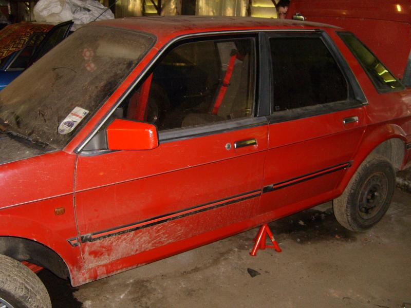

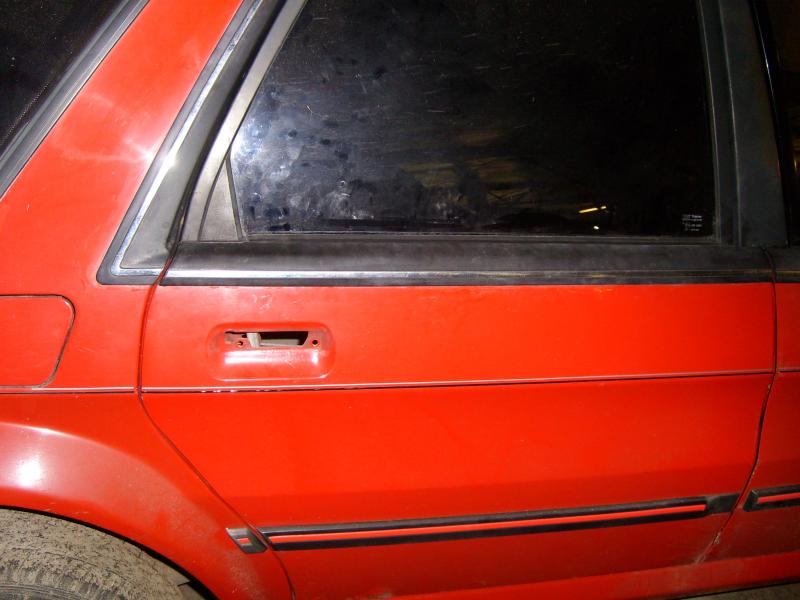

                            More done today
                            Couldn't put the tank on as the wires had been cut to the plug into the pump and tank, will have to remove from the sheddy.
                            Chris went with chrome so nearside door front and rear handles on
                            All central locking on
                            Nearside door mirror on

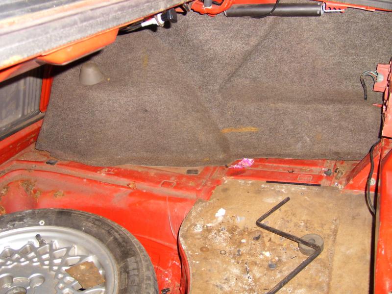

                            Boot loom completed and tidied
                            Rear parcel shelf on
                            Rear lights and number plate lights on
                            Rear seats in
                            Nearside rear door near completed

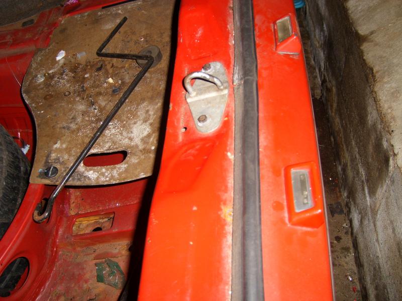

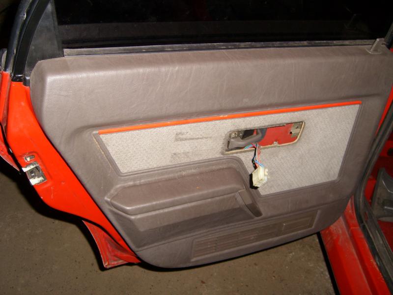

                            • #29

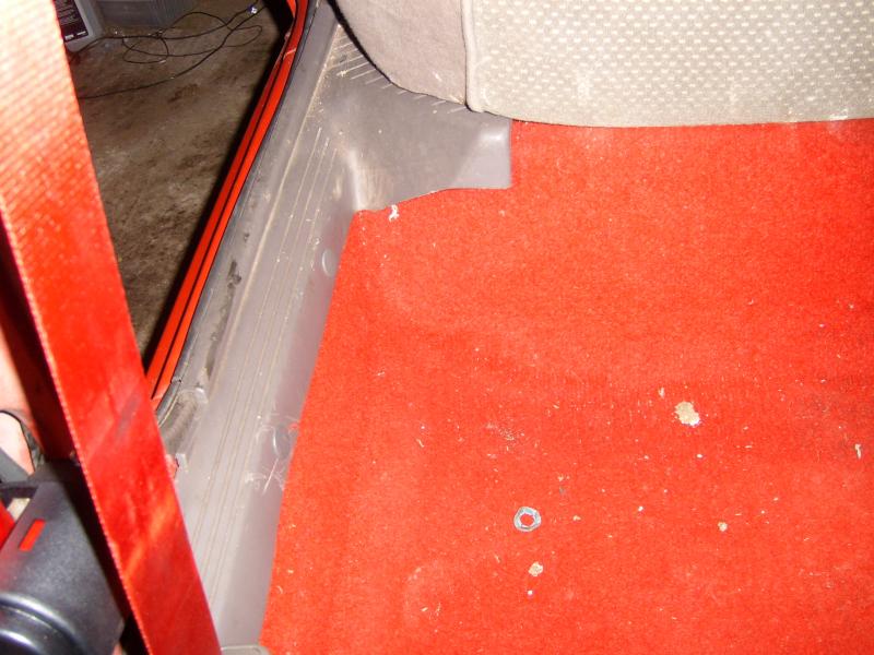

                              Rear carpet in

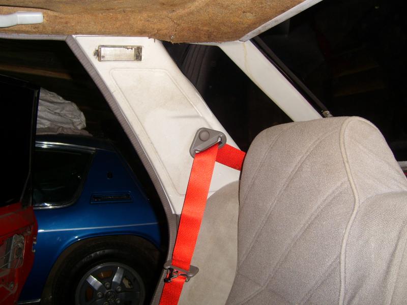

                              Rear seatbelts and rear internal lights in, both sides
                              Offside rear door top trim on
                              Offside front door top trim on
                              Fuse box bolted on
                              All internal light switches on
                              And much more, begining to look like a car now

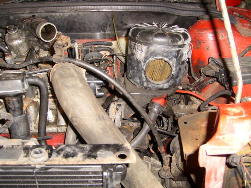

                              • #30
                                More done today

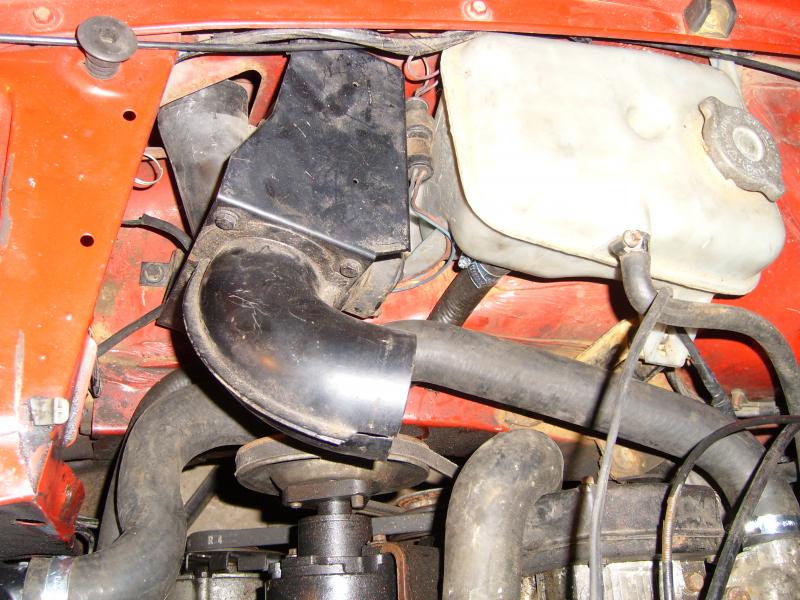

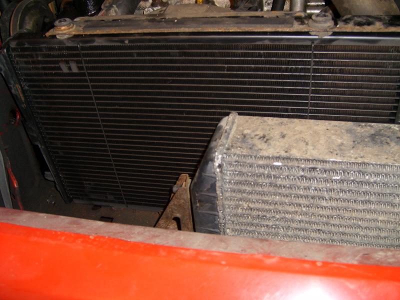

                                New radiator on, intercooler on
                                Air filter and assembly on
                                All coolant pipes on
                                Carb cooling fan and expansion tank on
